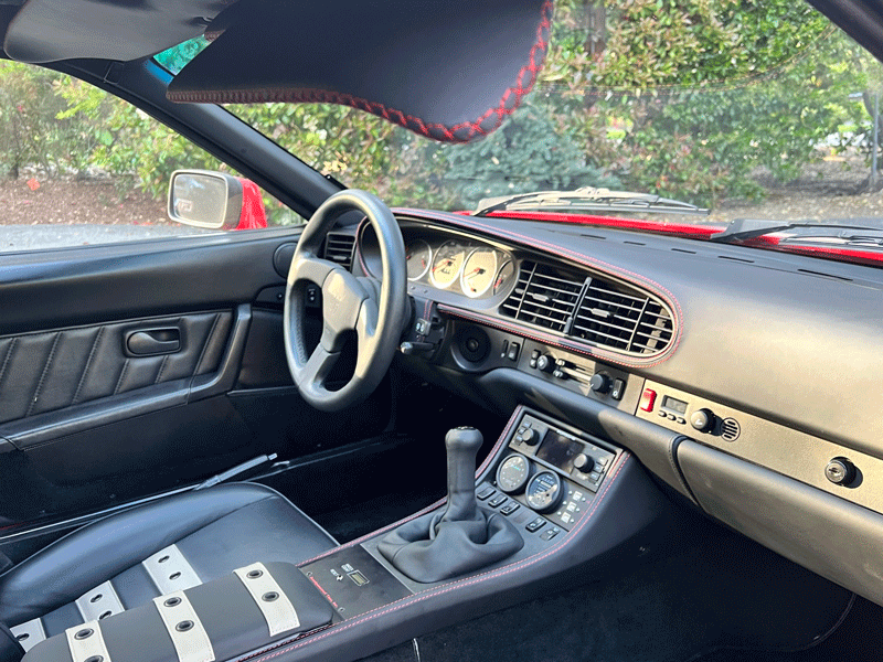

Hi! I recently went to an electronic boost controller and so I've removed my MBC that was on a panel under the radio. I've had a Zeitronix gauge there forever also but I've never really liked it so I'm looking to make a new panel for under the radio with new gauges. Question is - what gauges? Boost seems obvious, AFR seems like a good idea.. anything else? Wha do you guys run? Share your pics for inspiration, please?
here's what it looked like before I removed the MBC:

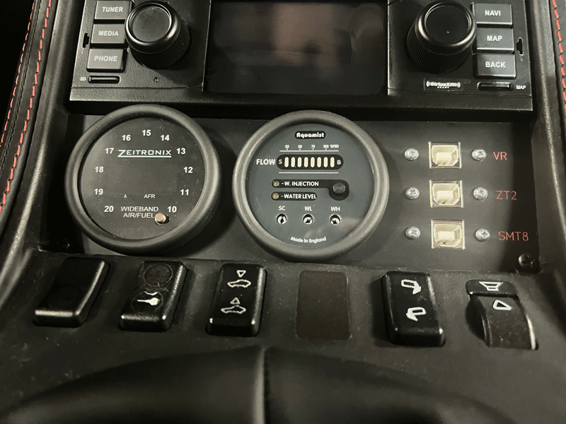

Here's my current set up. Have had many over the years. The gauges were mismatched for years (zeitronix and augamist) but I finally got an SLA printer capable of making new bezels for them that don't look 3D printed. One screws on like a bottle cap and the other is secured in place with little eyeglass screws, but I was able to make them both look identical as installed. The panel itself is from front panel express -- by far the best way to go for custom radio panels.

I love the matching bezels! that's always been one of my biggest complaints is that it seems to be impossible to find a single manufacturer that makes all the gauges I wantTom wrote: Thu Nov 10, 2022 5:06 pm Here's my current set up. Have had many over the years. The gauges were mismatched for years (zeitronix and augamist) but I finally got an SLA printer capable of making new bezels for them that don't look 3D printed. One screws on like a bottle cap and the other is secured in place with little eyeglass screws, but I was able to make them both look identical as installed. The panel itself is from front panel express -- by far the best way to go for custom radio panels.![]()

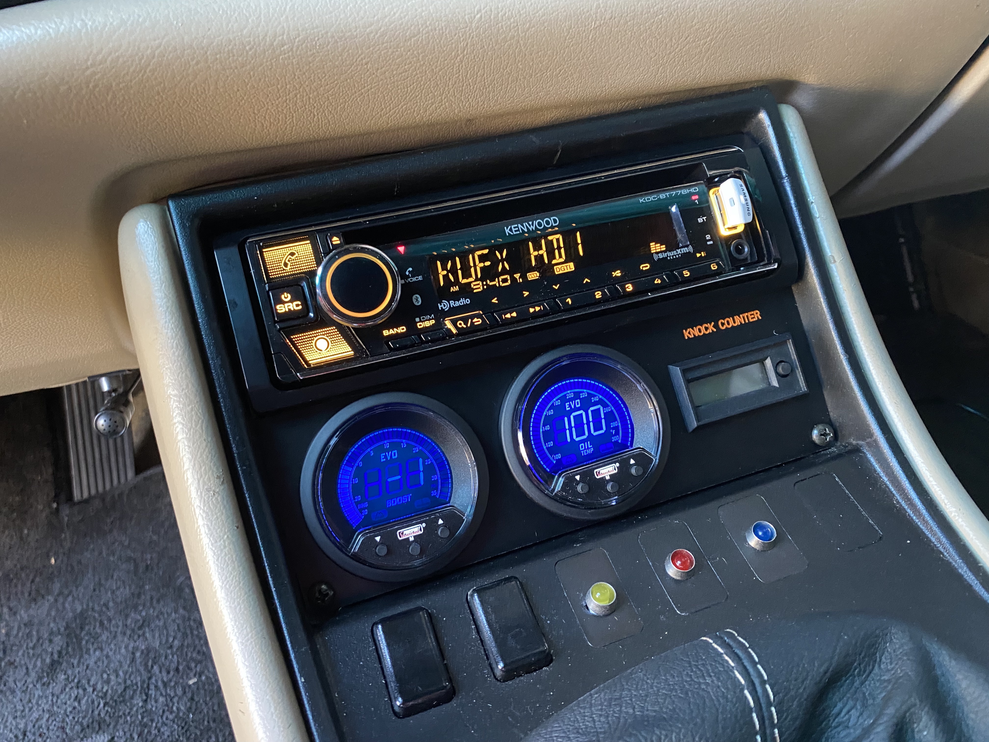

Prosport Boost & Oil Temp Gauges & Knock Counter
Front Panel Express
I like the max hold and warning beep on the boost & temp gauges.
Red and Yellow LED's wired to the gauge warnings. Blue is wired to the diag port near the DME/KLR.
Front Panel Express

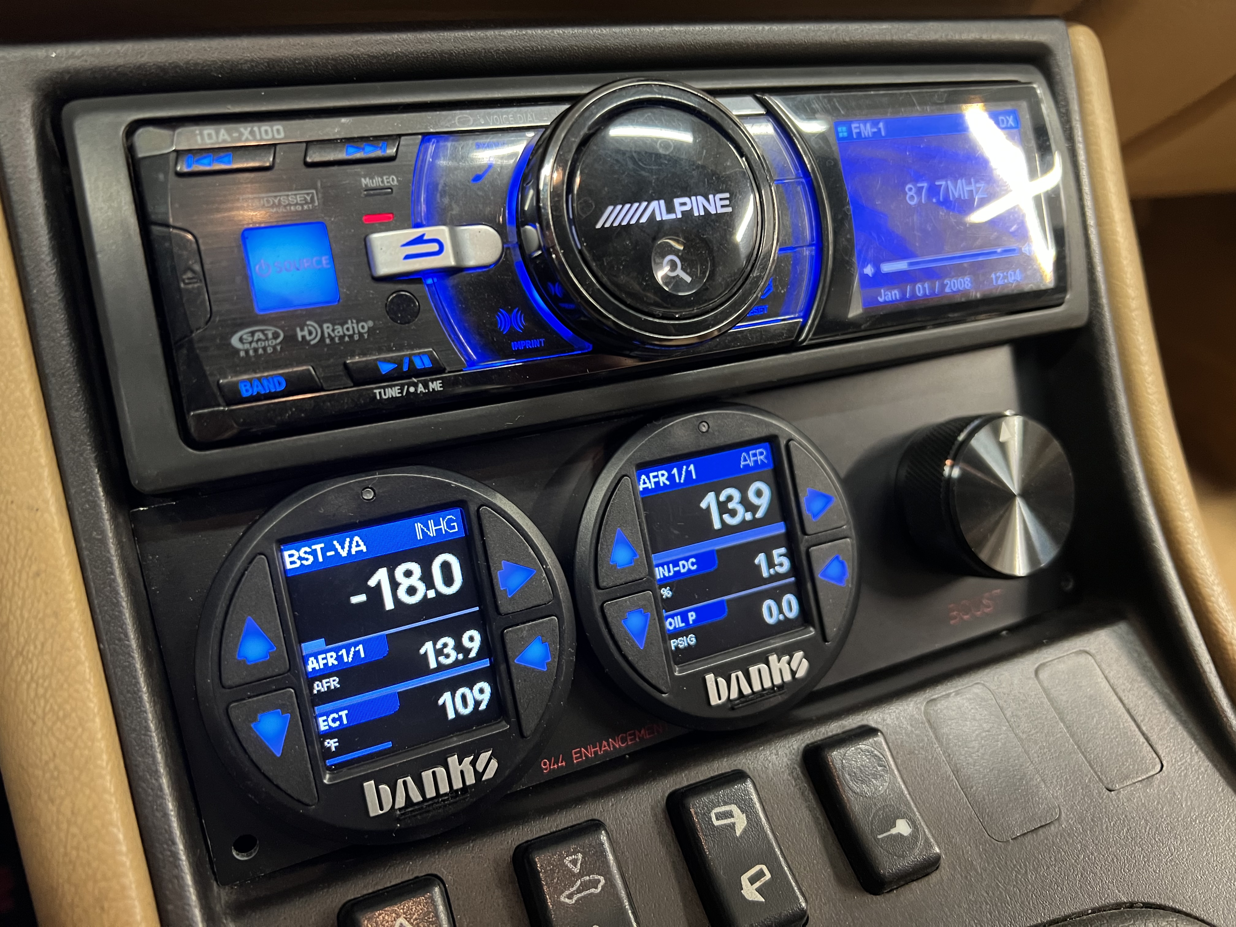

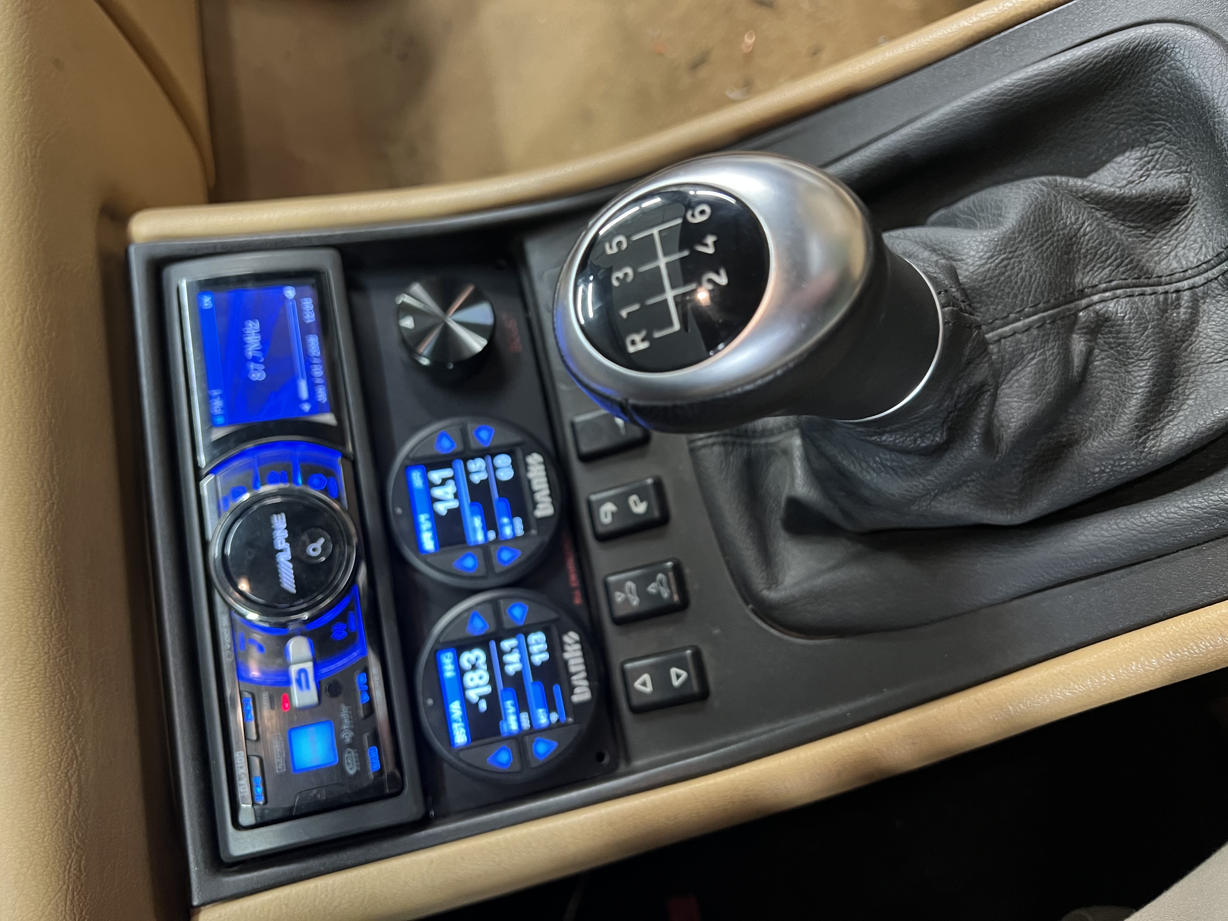

Can buss driven gauges, can be configured to display anything you want

Very slick!

Guitar knob actually! They make quite a few styles of knobs.
