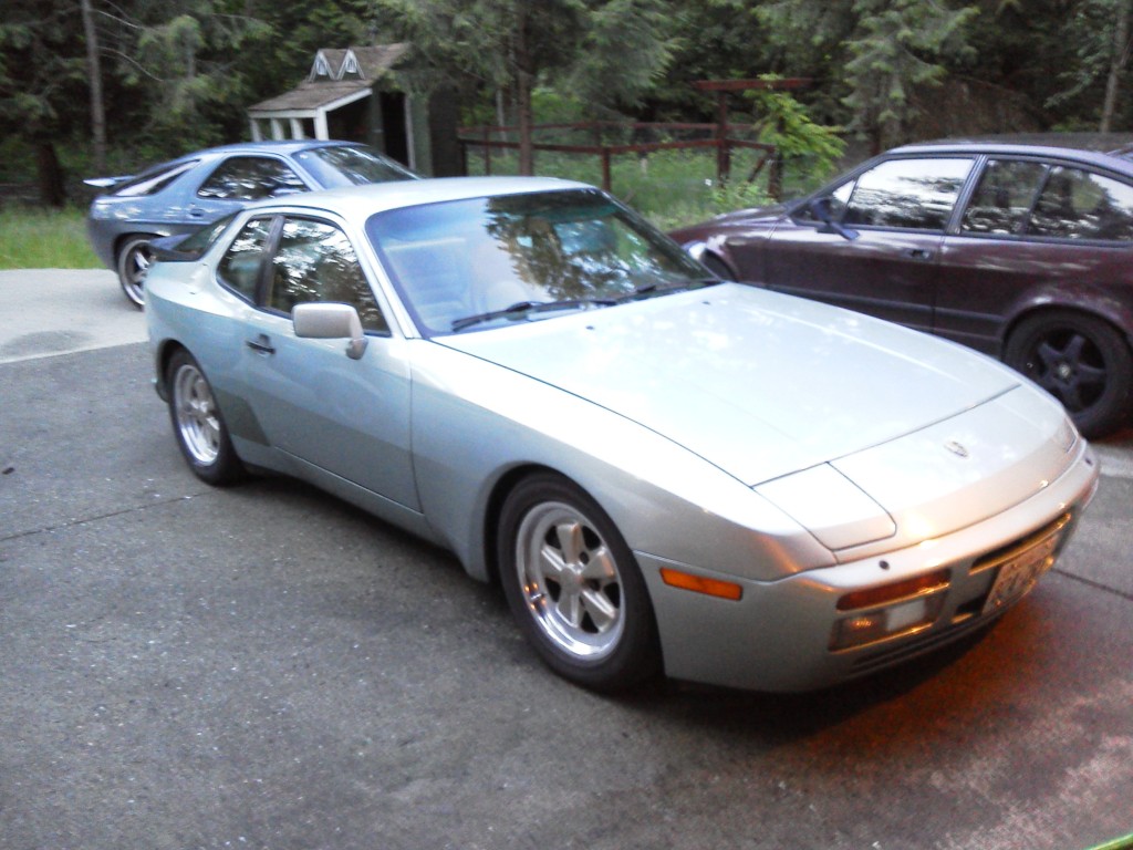

Back in the Spring of 2009, I brought this beauty home:

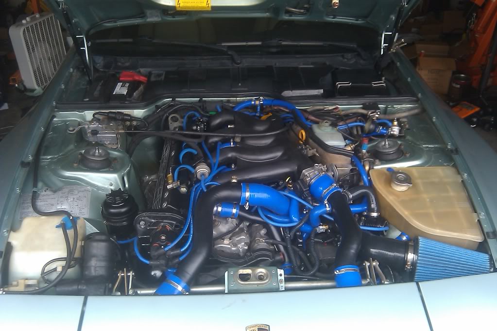

Everything was great! I drove it just like I bought it for about a year and then it caught on fire. It was a minor engine fire, as engine fires go, but it damaged a lot of stuff and so the engine had to come out and all the damage had to be handled:
I figured I'd jazz up the place with some paint and some blue stuff while I was in there and also replaced all front suspension bushings, engine mounts, etc. I also swapped out the Vitesse MAF for a first production run Rogue Tune M-Tune

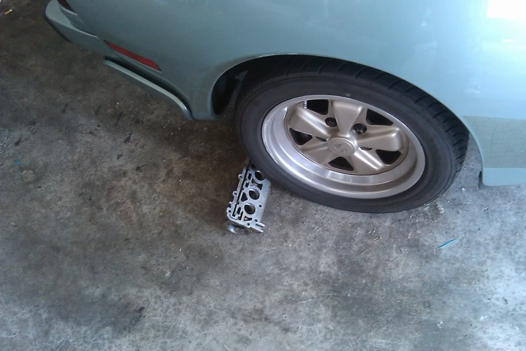

Like my wheel chock? (Don't worry, it's a cracked cam tower I got with a spare engine, I wouldn't abuse a useable one like this)

After those repairs, I just drove it for a good long time - got distracted with life stuff and other projects, moved a couple times, not a lot happened to the car. Then, I stumbled across a good deal on a set of 996 Hollow Spoke Turbo Twists.
Before:
After:
I didn't like it.
Tried painting them black:
Better, but still no. So the Fuchs went back on.

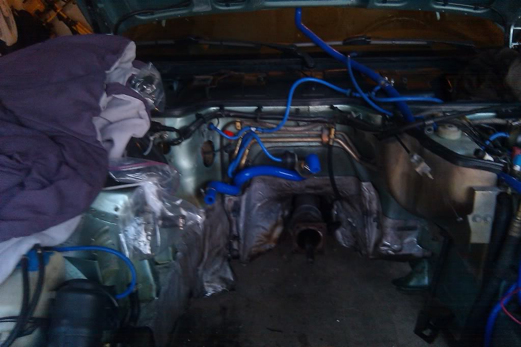

Some more time passed, life happened, I moved again and then I decided it was time to install this turbo I'd bought about a year before, it was built by Joshua (Rogue Tuning) and Sid (Blown 944) - If y'all remember those guys - It's an HY35 Compressor housing and wheel, an HX35 CHRA and an HY35 turbine in a Turbonetics replica Triple K #8 housing that's been ceramic coated.
hmmm.. will it fit? :lol:
turns out, yes, with a bit cut out of the alternator bracket here:
and a bit machined off the bottom of the throttle body there:
plus a creative solution for the secondary throttle return spring:
it fits!! look at all that extra room!

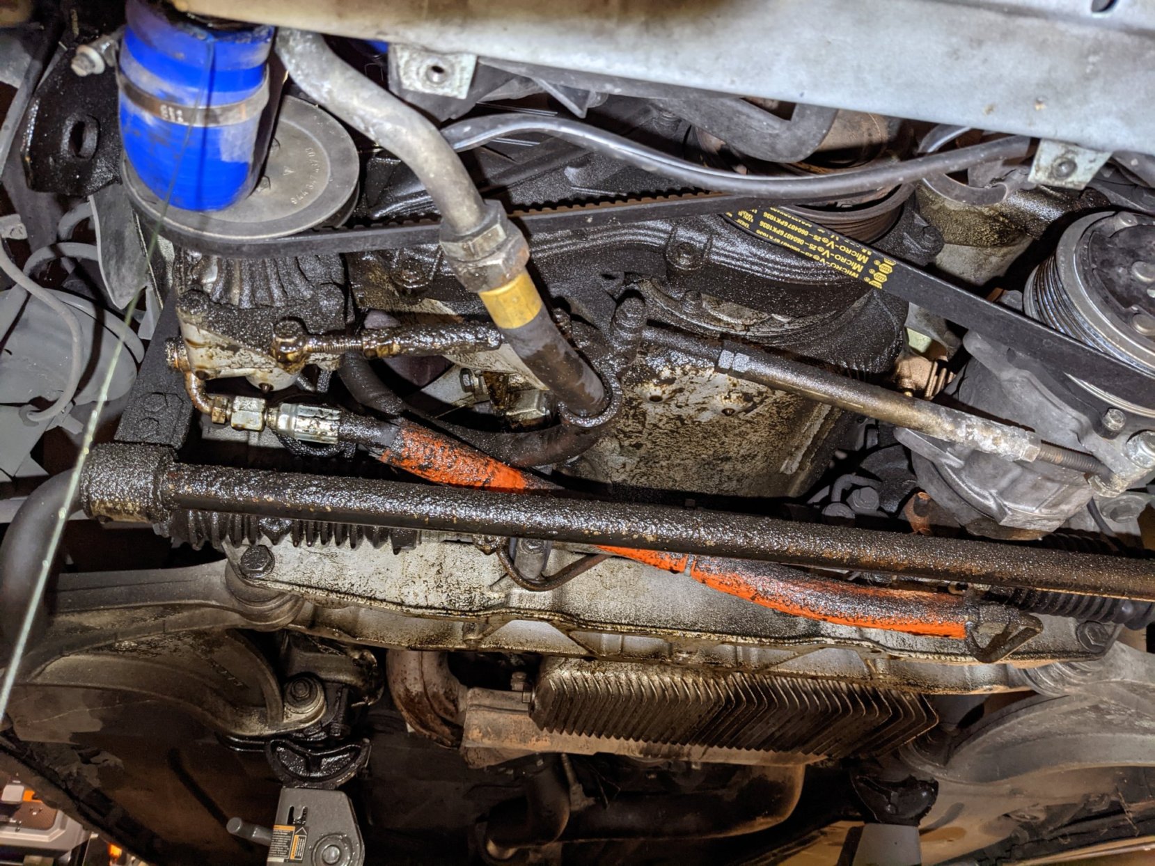

And then, about two years ago, I was driving it to a thing and suddenly the cabin was full of smoke! :shock:
Having experienced an engine fire in one of these before, I panicked, pulled over and grabbed the fire extinguisher that the previous experience had taught me to keep in the car. Thankfully, no fire, but the cam tower gasket had sprung a leak and was misting the exhaust manifold with oil.. what a mess!

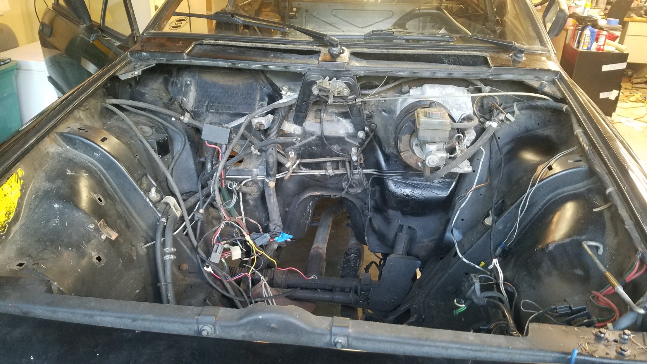

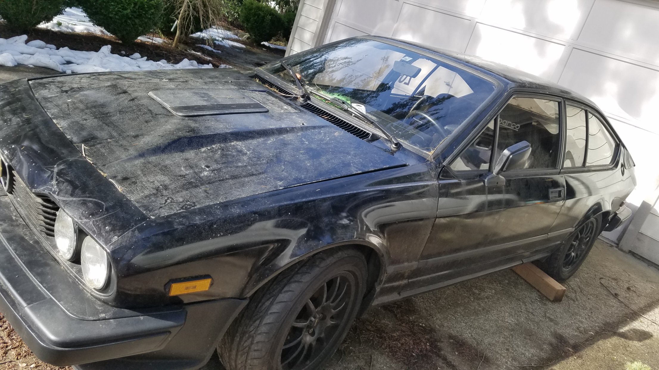

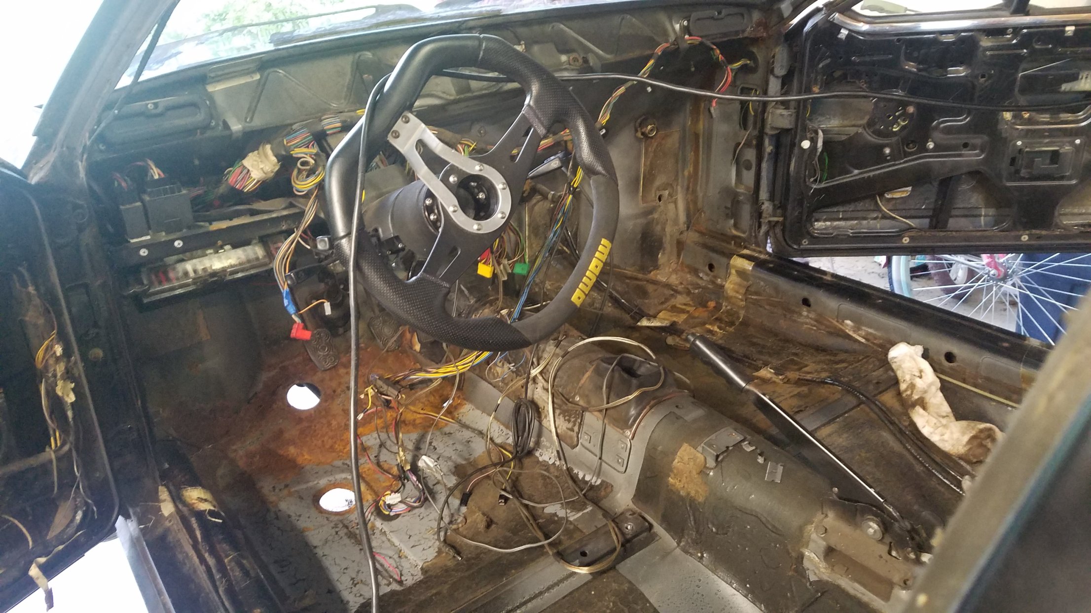

I also rescued my GTV6 from a scenario I can't even begin to describe and dug into it:
About a year later, lots of welding and many many parts, it was finally ready to fire up!
AAAANNNND, it had two dead cylinders :( Turned out the "totally good" used engine I bought had a couple bent valves.. so the heads came off and went to the machine shop.. they're still there. It's been almost two years.. Unfortunately, people who will do machine work on old Alfas are few and far between, so I just kinda get to wait. Oh well, it's given me an opportunity to get back to the 944

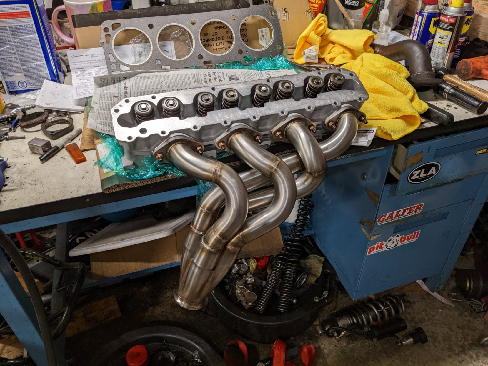

This was the beginning of the slippery "While you're in there" slope. So I dug out my spare NA head I happened upon years ago and sent it off to a very talented young machinist in California who returned it to me very nicely rebuilt and ported to flow 255cfm at 0.005" lift.
Re: Dave's Build Thread
Posted: Thu Nov 10, 2022 1:20 pm
by crackership
Then, while I had the head off, I noticed the exhaust manifold was very badly cracked in several spots :(
well, why replace with stock when you can buy fancy SFR headers (and wait several months for them)?

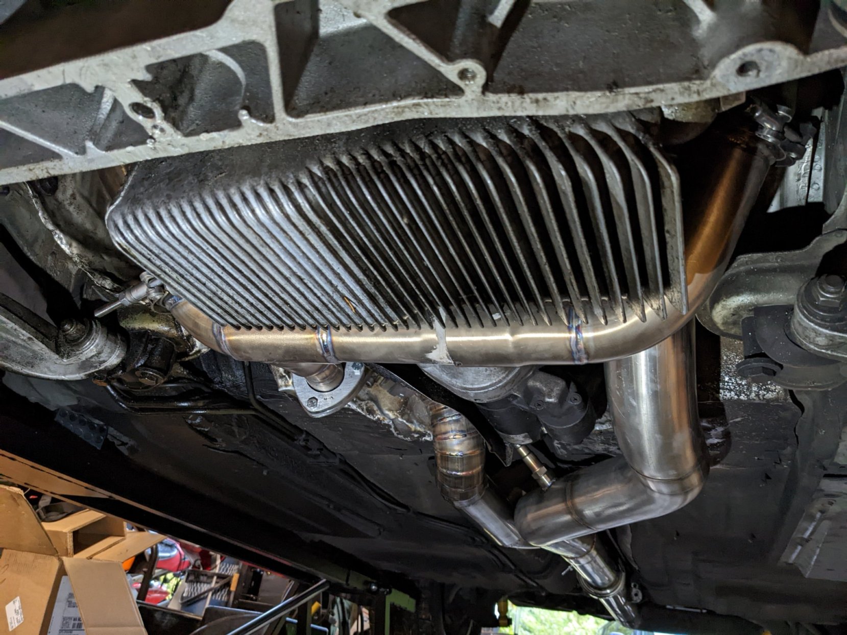

Also, I mean, while we're in there.. how about a downpipe? I can't find a picture of it, but I swear I put a 3" downpipe from M44 Performance on it :)
But.. if I have a 3" downpipe, and a 3" cat-back.. It "only makes sense" to do a 3" mid pipe.. right?
unfortunately the previously-modified wastegate dump didn't fit with this new pipe;
sometimes you have to make things...
ahh.. that's better..
