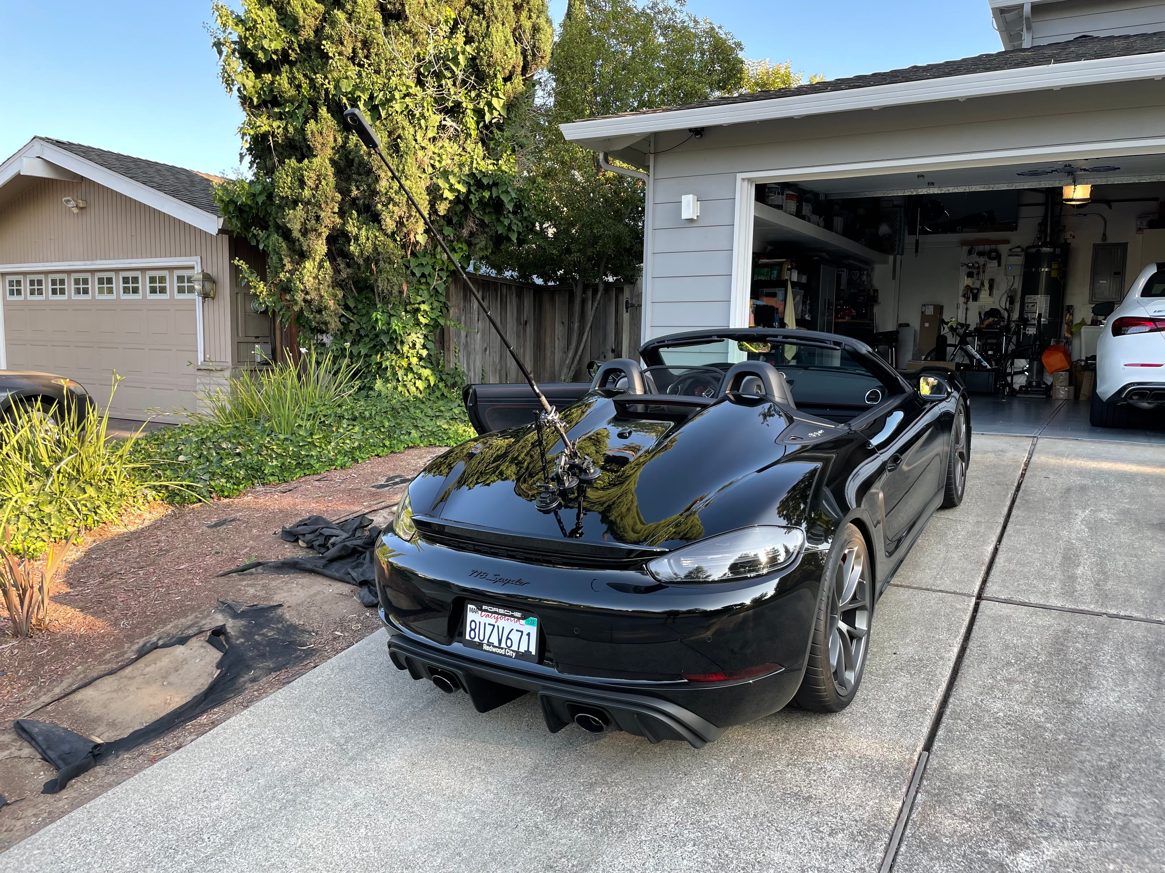

This video is an insta360 perched on a carbon selfie stick. Looks silly but it produces fun footage
