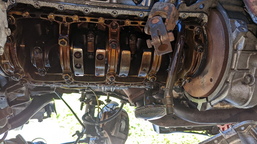

Underside for orientation - left side of photo is front of car
Notice the oil pickup tube (with the round mesh screen) near the rear of the engine.

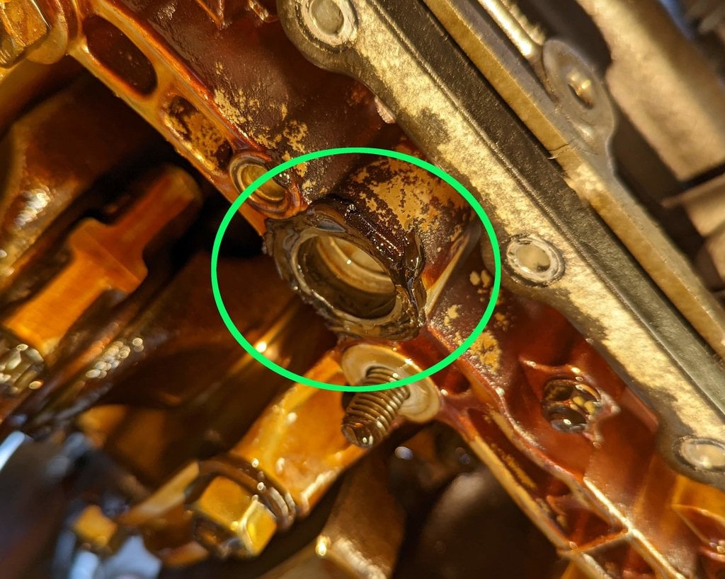

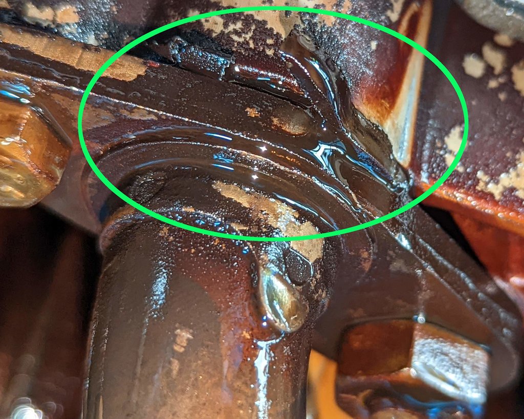

Close up of crusty looking seal between pickup tube and crankcase
It isn't supposed to be squishing out like that.

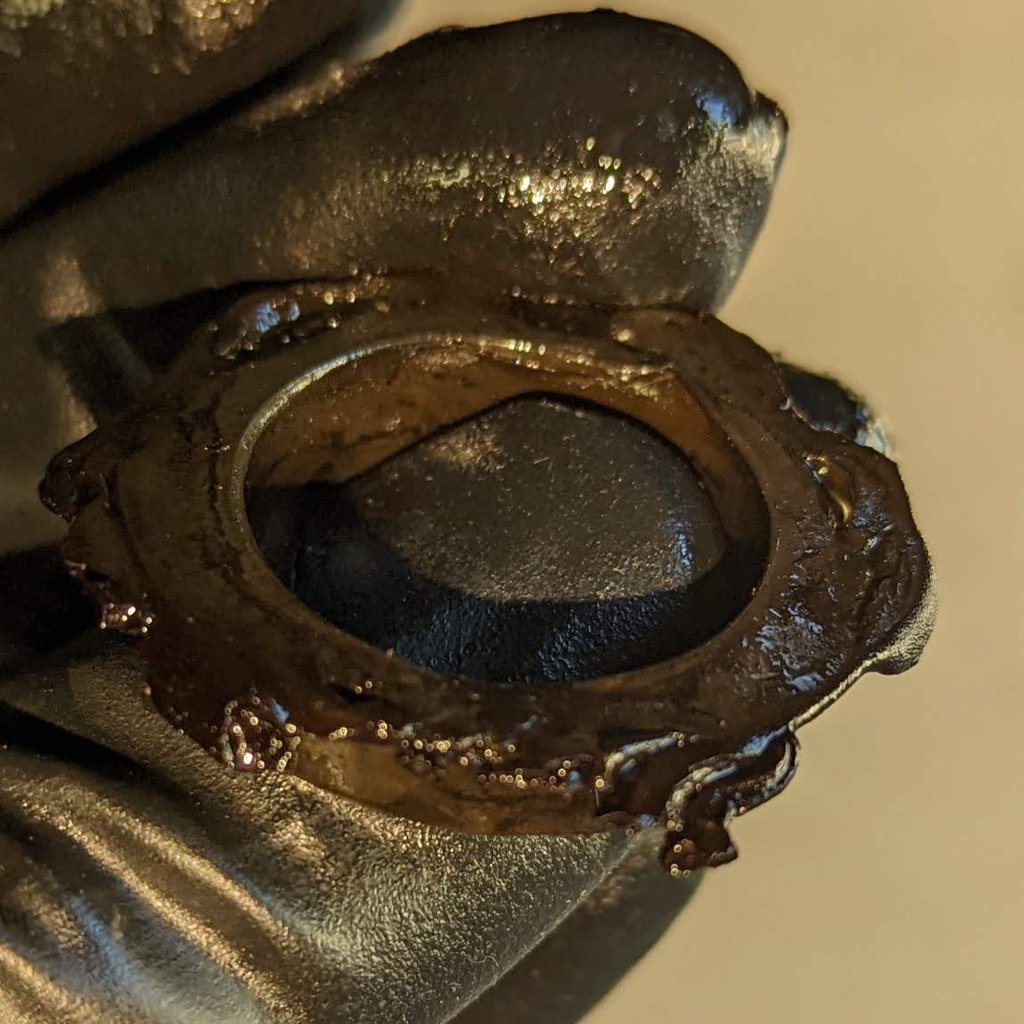

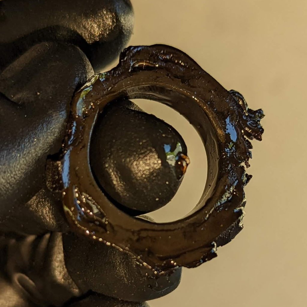

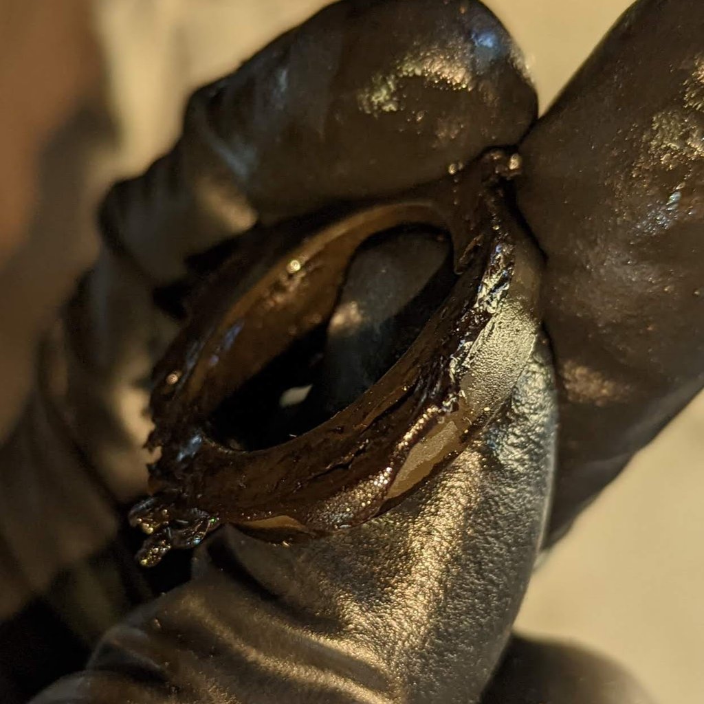

Close up of Seal Itself
It isn't very supple any more, and there are fine cracks along the inner diameter surface that contacts the oil pickup tube.
