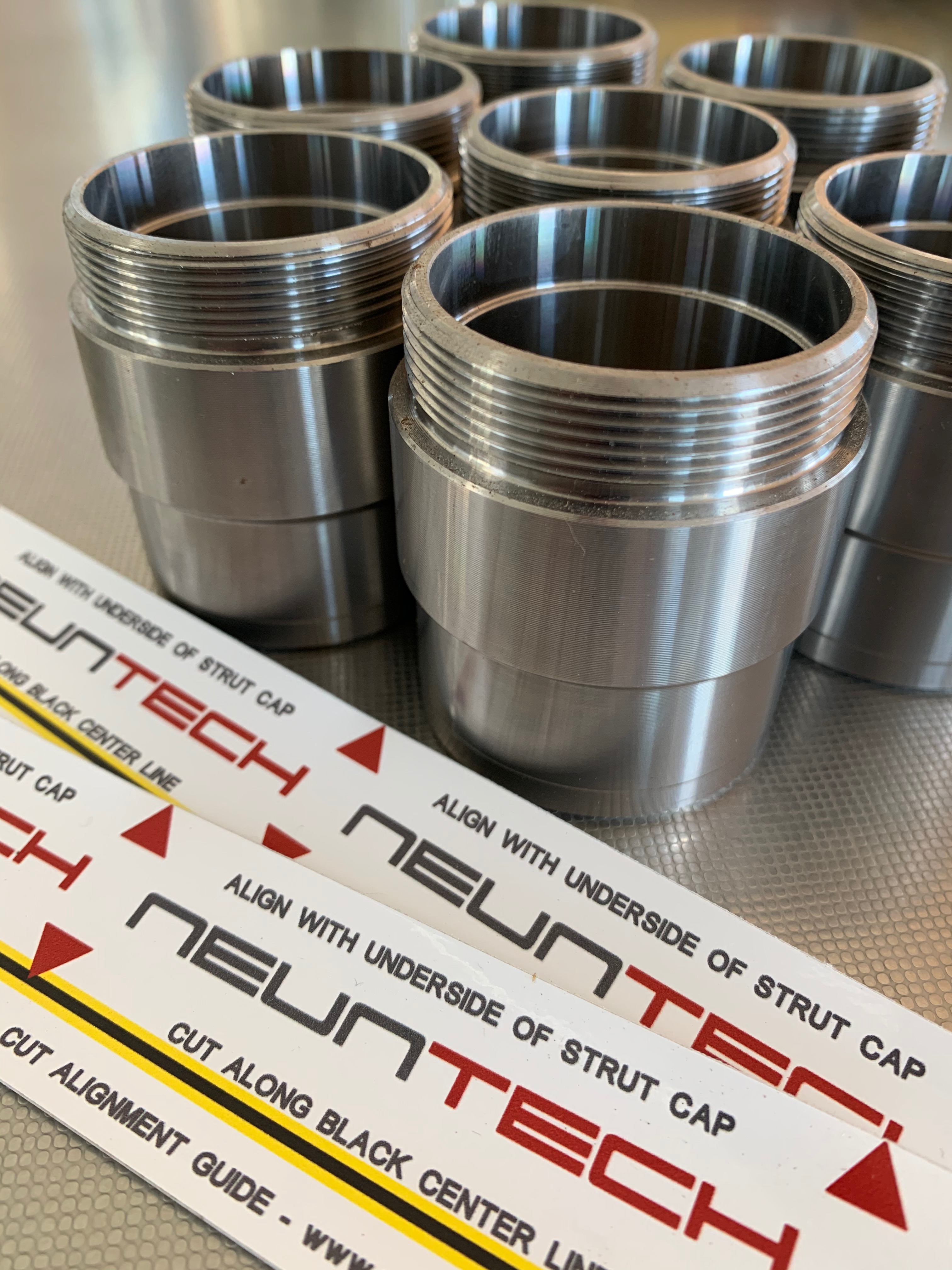

Hey Guys... Thanks Jae for the heads up and thanks admin for being so inclusive and allowing me to join the party!
Happy to provide the Bilstein conversion kits and advice and encouragement to anyone who wants to give it a go. I run cars with both the Bilstein and the Koni conversions and both are a great step up from the tired old Sachs. I personally find the Bilstein are a better design and better ride than the Koni's... but each to their own
The kit I have designed is similar to that shown in Jürgen's video but comes with a cutting guide that takes all the guess work out of the cutting, and is designed in such a way to negate the need to prise off the old cap (which is a pain in the a*se) and most importantly is machined to set the collars at exactly the correct height even if you are a millimetre or so out on the cut.
I've supplied very many of these kits to enthusiasts of differing technical competence and so far no one has failed. Only had positive feedback so far
. It is a pretty simple, fun procedure and I can cut and convert a strut in under 15 mins (excluding the time for my friendly welder takes to do his bit).
The procedure is somewhat simpler than the Jürgen video. Hopefully the step by step instructions are successfully attached to this post
They are $118 a pair including cutting guides etc and $29.75 for worldwide shipping (regardless of quantity ordered). I can also loan or supply ($20) the Bilstein tool for correctly torquing the gland nut.
If there is sufficient interest I'm happy to put together a group buy and a banner ad would make me feel like I had made the big time!
Bilstein Insert Instructions.pdf- (14.45 MiB) Downloaded 95 times
- IMG_1734.jpeg (1.88 MiB) Viewed 970 times
