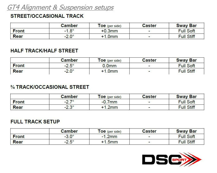

Swapped my GTS anti-sway bars for GT4 spec anti-sway bars this weekend. I don't yet know how much of an improvement they are, need to drive the car a bit more still. The rear bar was really quite similar and the front bar is quite substantially thicker on the Gt4. I now have three holes front and rear to be able to fine tune the ratio front to rear.

Don't know if this will help but, per recommendations from trusted sources for track setup 4+ years ago, I have mine adjusted Full Soft for front and Full Stiff for rear. It works very well for me. (The factory default setup is Middle for both front and rear.)
This GT4 setup chart and/or the attached PDF doc from DSC Sport/TPC Racing that I found later confirmed the sway settings. (Note that I have not followed DSC/TPC's alignment specs precisely although theirs are certainly in the correct ballpark and would be a good place to start.)

Interesting graph and thanks for posting as my GTS is in the shop getting wheel studs and GT3 front arms as we speak. I doubt I can get -3 degrees up front though as the GTS is more limited with camber adjustments.
