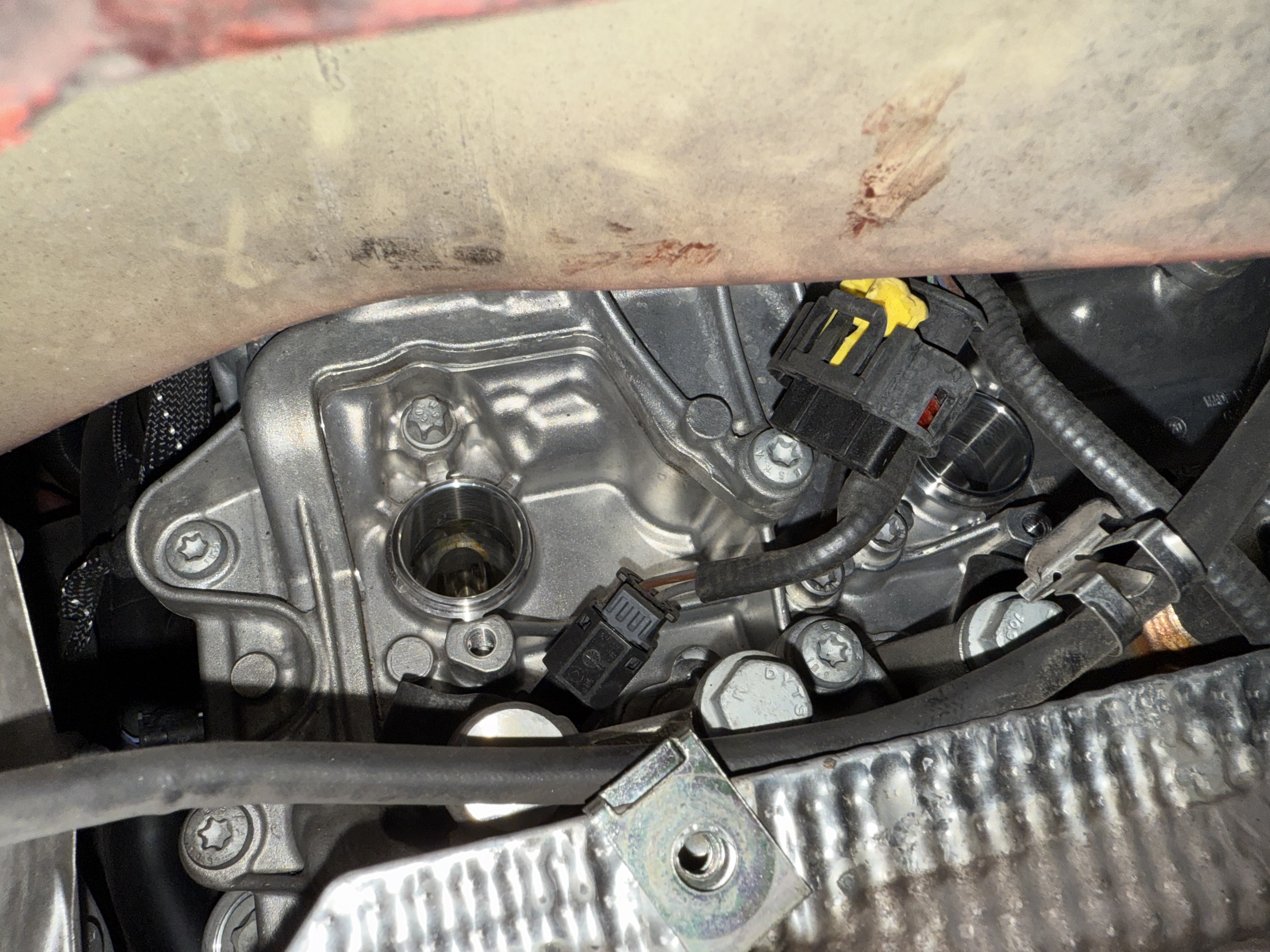

Changed my spark plugs tonight, it is a bit tight in there but once you get used to working in the space it is not that bad.
Remove heat shield, three trox screws per side.
Remove coils, one screw and one wiring clip per coil. To remove wiring clip first push back the yellow tab.
Remove and replace spark plugs.
I did use the special Porsche socket and the new NGK spark plugs also came from Porsche. I used an assortment of socket extensions, one with a wobble as shown below for 5 of them, the left rear plug required a slightly different arrangement of extensions as I had to add a swivel.
The spark plugs did have some discoloration on the threads but the electrode did not look worn. 18k miles but Porsche recommends changing them every 4 years. I would go longer next time.
Yes, that is blood on the edge of the body in the second picture. The sheet metal is sharp right under there.
