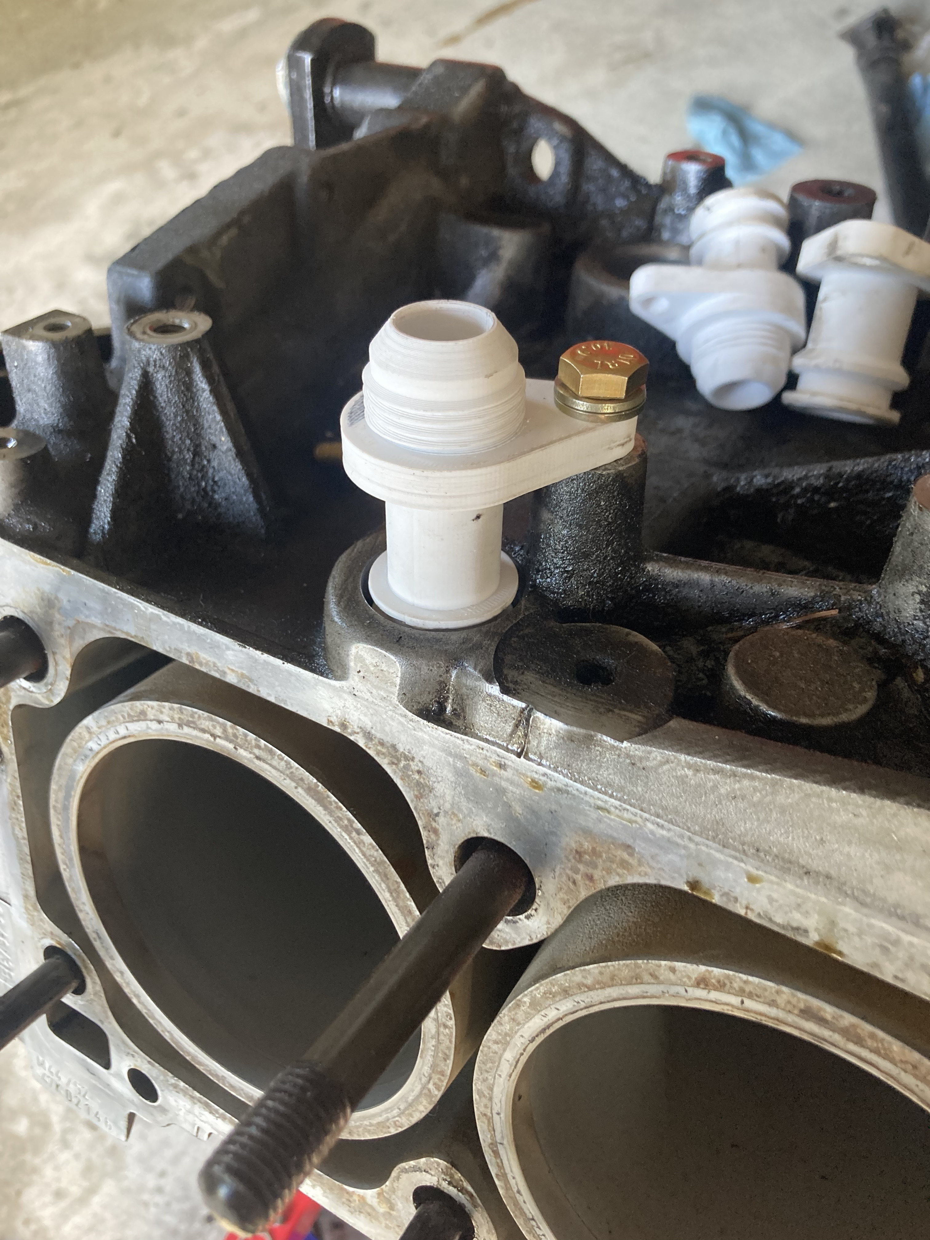

On a slightly different track (I swear I cleaned the other side of this engine...) - I've modeled up some AOS -> JIC-12 (my tolerance are nowhere near AN
- aos_adapter.jpg (2.41 MiB) Viewed 1572 times

Do you want to use Mahle pistons in particular? I'd think one of the nice parts of going to Nikasil is that it opens the doors to other pistons/rings?
As for the catch can idea -- nice work on the adapter and great resolution for what I assume is an FDM printer?
I drilled my AOS when I put in my catch can, and still don't catch all that much. But I drilled it because no matter what else I tried, heavy boost would blow my dip stick up out of its tube. Actual vacuum would do it, but if you rely on engine vacuum (?) I'd be worried about unmetered air throwing off the tune. Also, if you plug the bottom AOS port, how will you get oil in the motor?

I've already got them, so that's the only rationale.Tom wrote: Sun Jul 03, 2022 10:33 am Do you want to use Mahle pistons in particular? I'd think one of the nice parts of going to Nikasil is that it opens the doors to other pistons/rings?
Something that once was an Ender 3, yepAs for the catch can idea -- nice work on the adapter and great resolution for what I assume is an FDM printer?
Seems like it would be fine to feed it back before any metering? Probably not great for a MAF setup, but MAP or AFM shouldn't mind.I drilled my AOS when I put in my catch can, and still don't catch all that much. But I drilled it because no matter what else I tried, heavy boost would blow my dip stick up out of its tube. Actual vacuum would do it, but if you rely on engine vacuum (?) I'd be worried about unmetered air throwing off the tune. Also, if you plug the bottom AOS port, how will you get oil in the motor?
re: blowing out the dip stick...Doesn't the OE system (mine does, at least) have a one-way valve that vents to atmosphere under boost? I don't know why they didn't just use a one way valve, or plumb things to the pre-turbo intake, but I'm not an automotive engineer
And yeah, closing up the bottom port makes adding oil annoying: You could use the cam tower, or just plumb in a line that goes to a fill port rather than actually plug it completely.

I'm a MAF guy, so that was my reference point about the vacuum. I'd think the same would be true with an AFM, but suppose it depends how you plumb it?
As for a crank pop-off valve, at least in the US, there's been a federal regulation since the mid-1960's that crankcase gases be recirculated back into the engine. Most car did this with a PCV valve, but Porsche gave us the AOS plumbing with venturis and restrictors and who knows what else. But ultimately, I think they did do what you say -- plumb it back to the intake just before the turbo....
I can't remember all the details now, but I did try a basic pop-off valve, but the problem was the pressure couldn't get out of the AOS fast enough with the stock opening at the top -- so by the time any valve might open, the dip stick had already popped up. That's when I punted and drilled the top of the AOS....
