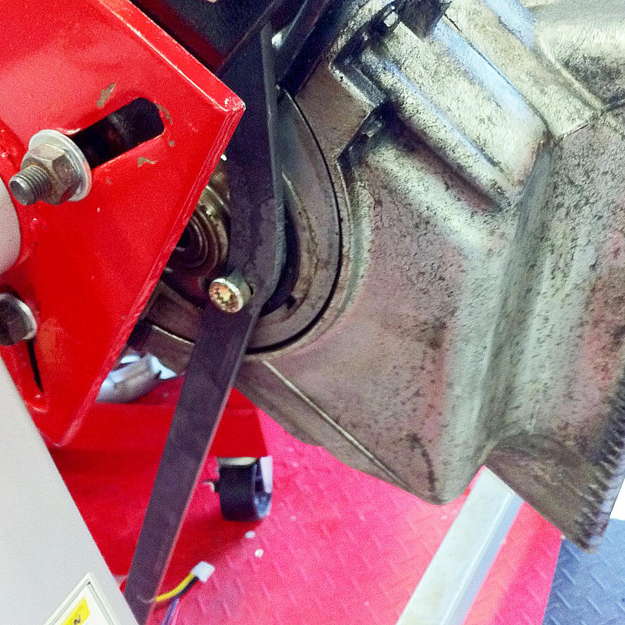

I'd probably just prime it the old fashion way. I once bought a 2 x 1/4" flat steel bar and drilled holes in it to brace the crank on the stand. I was trying to undo a stuck pulley bolt, so the torque was no doubt higher than 150 ft lbs., but it was a pain and didn't work. Engine stands aren't that stable, so someone needs to hold everything as you torque. In my case, I literally bent the steel bar (in the flat direction) and still couldn't get the bolt out.

Found an old picture of the bent bar....
Wow - I guess I’ll skip past the step of bending large pieces of metal.
