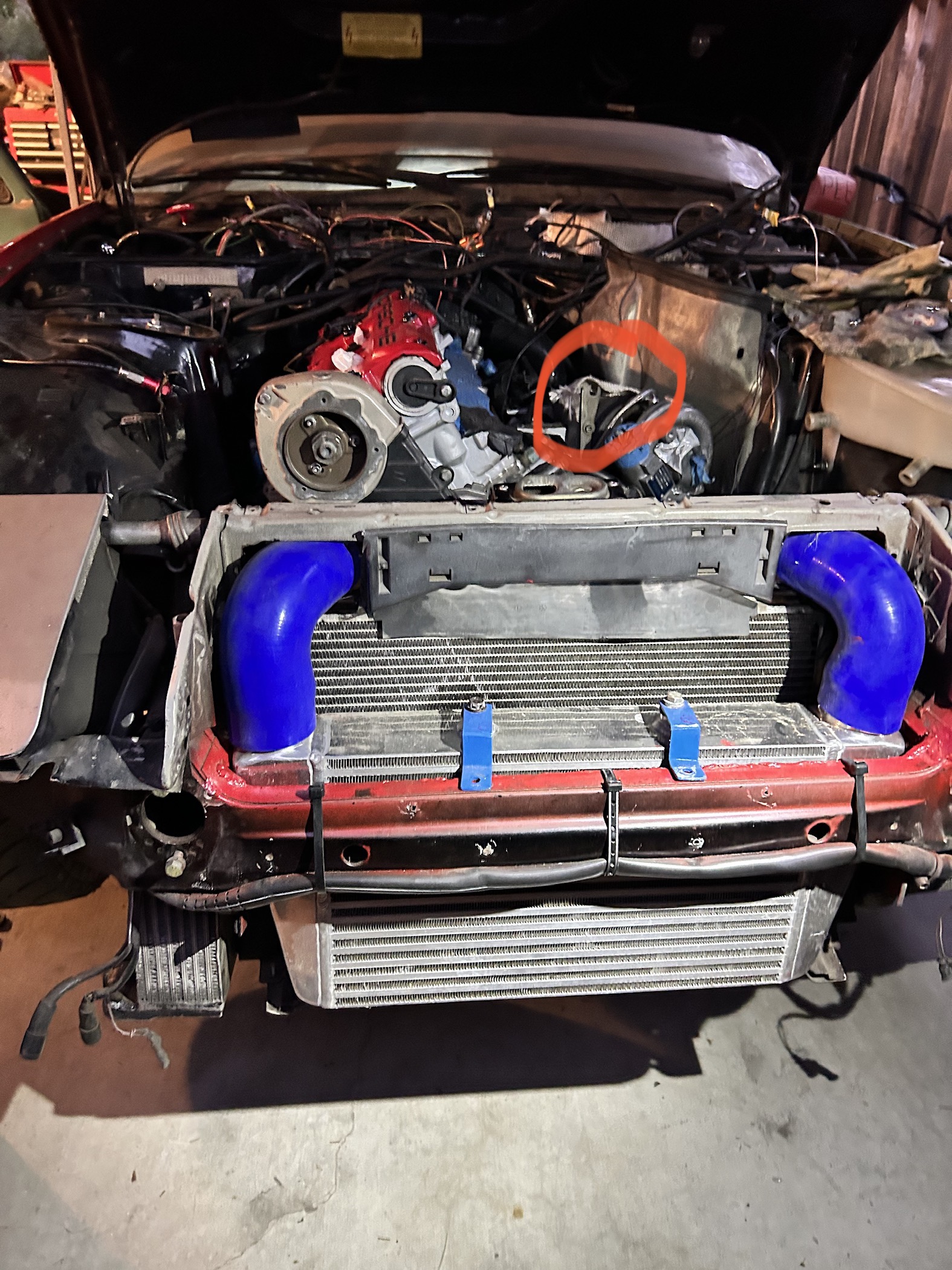

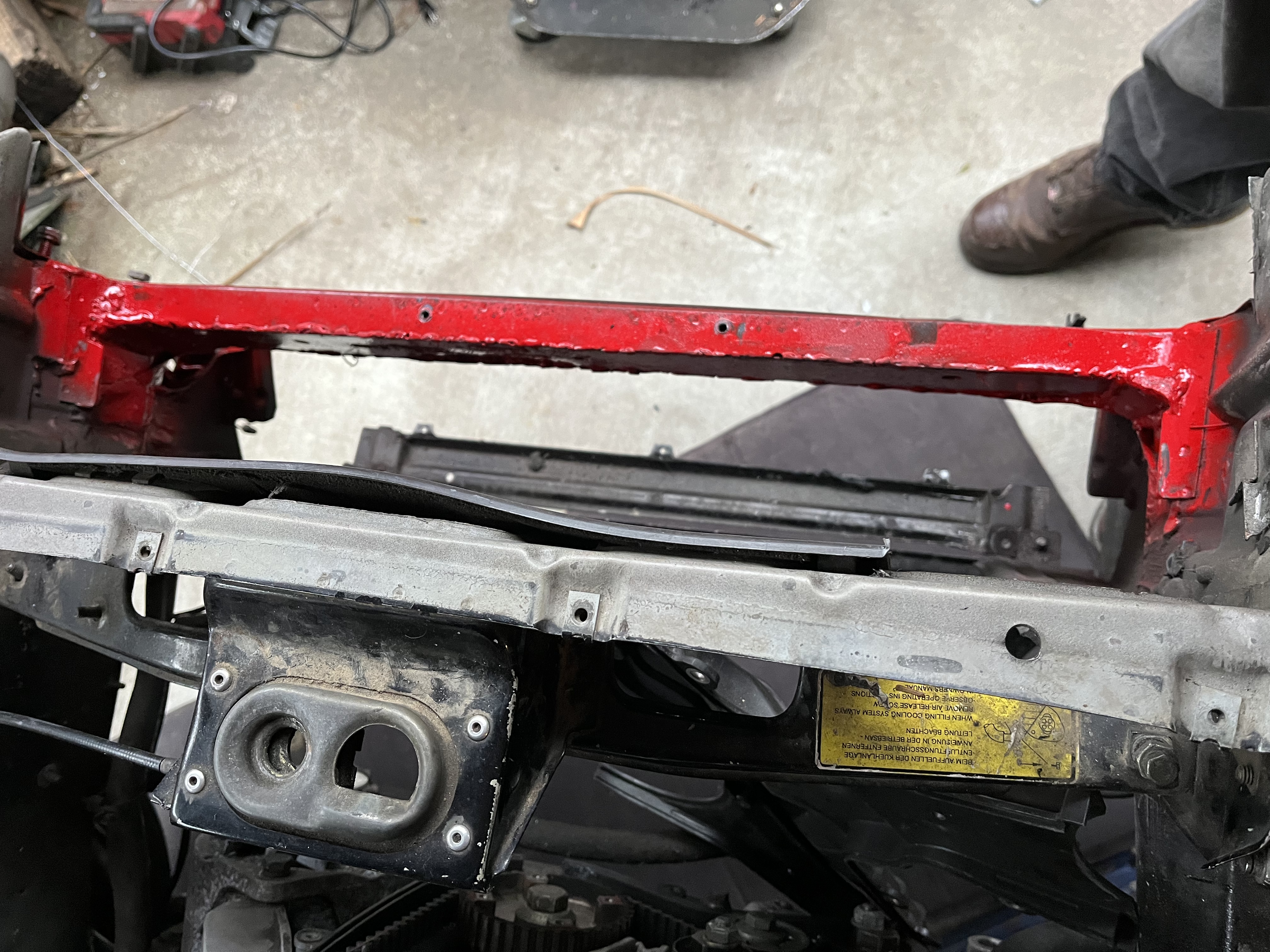

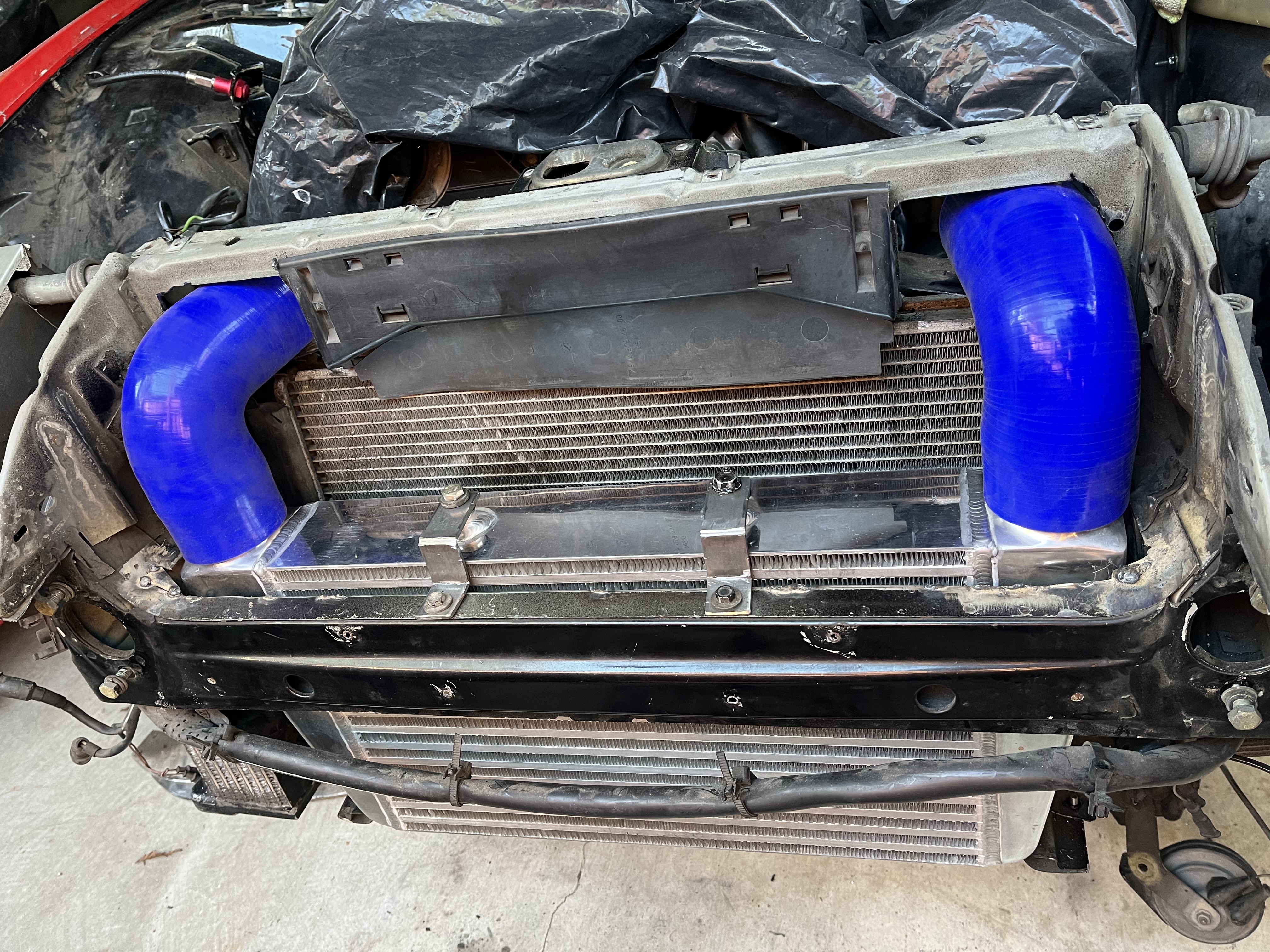

Did this last year and works great it was a speedforce eBay purchase used and while I first cut the bumper bar for in front of box frame I ended up cutting the box frame since it’s a full race car and mounted to protect from front bumps and bruises as it’s a endurance racecar.
2.5 16 valve turbo motor and makes 300ish hp

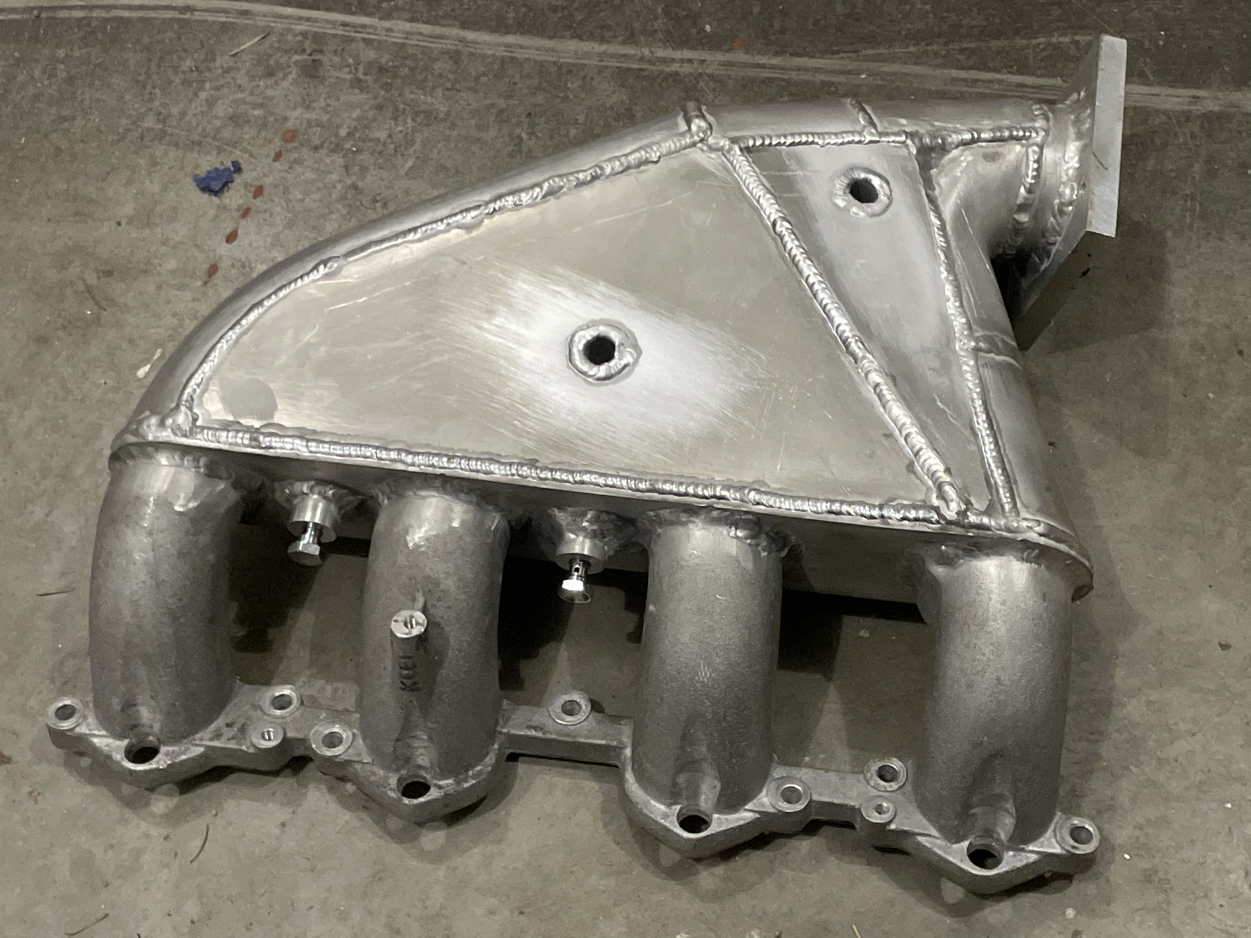

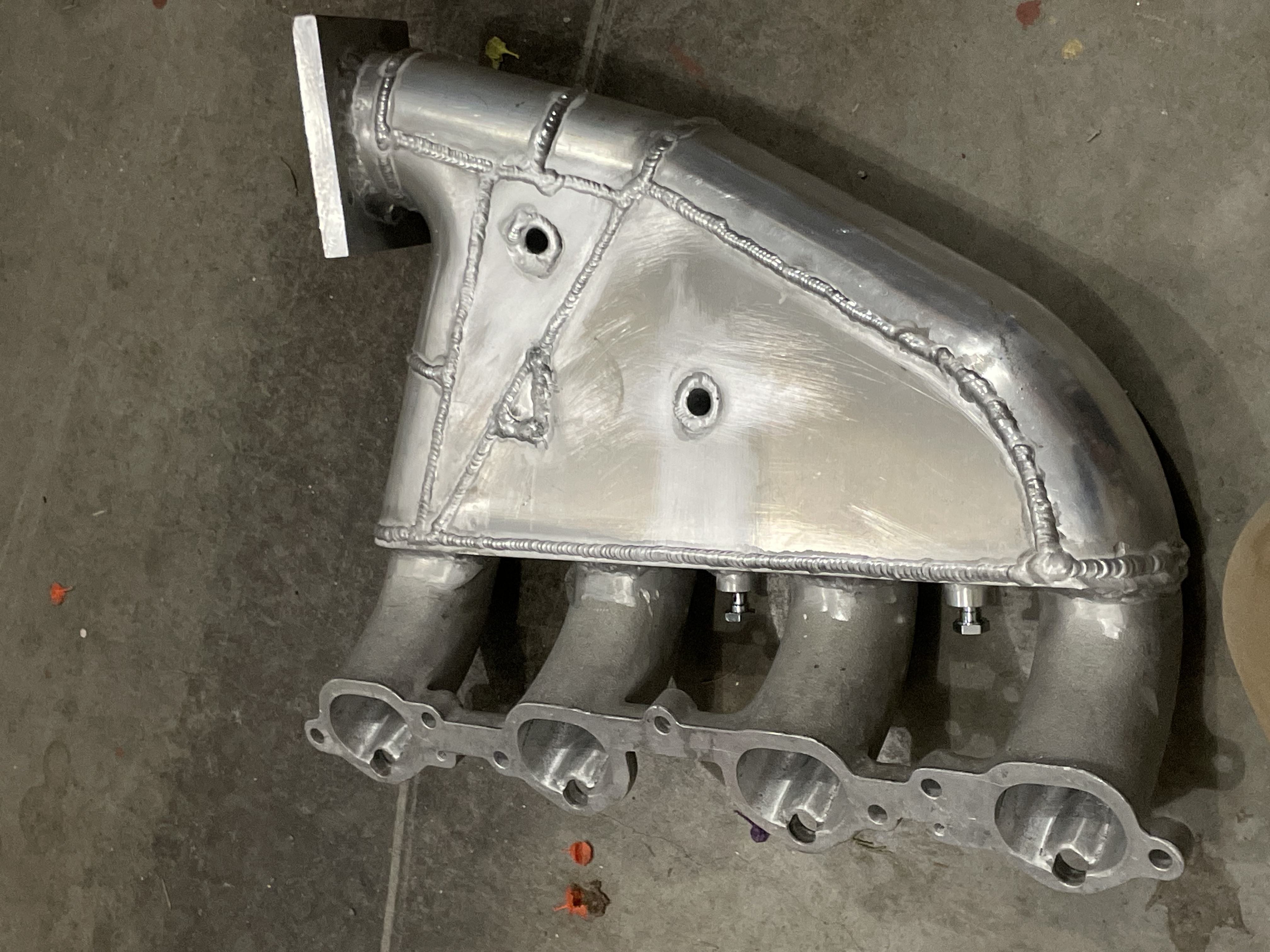

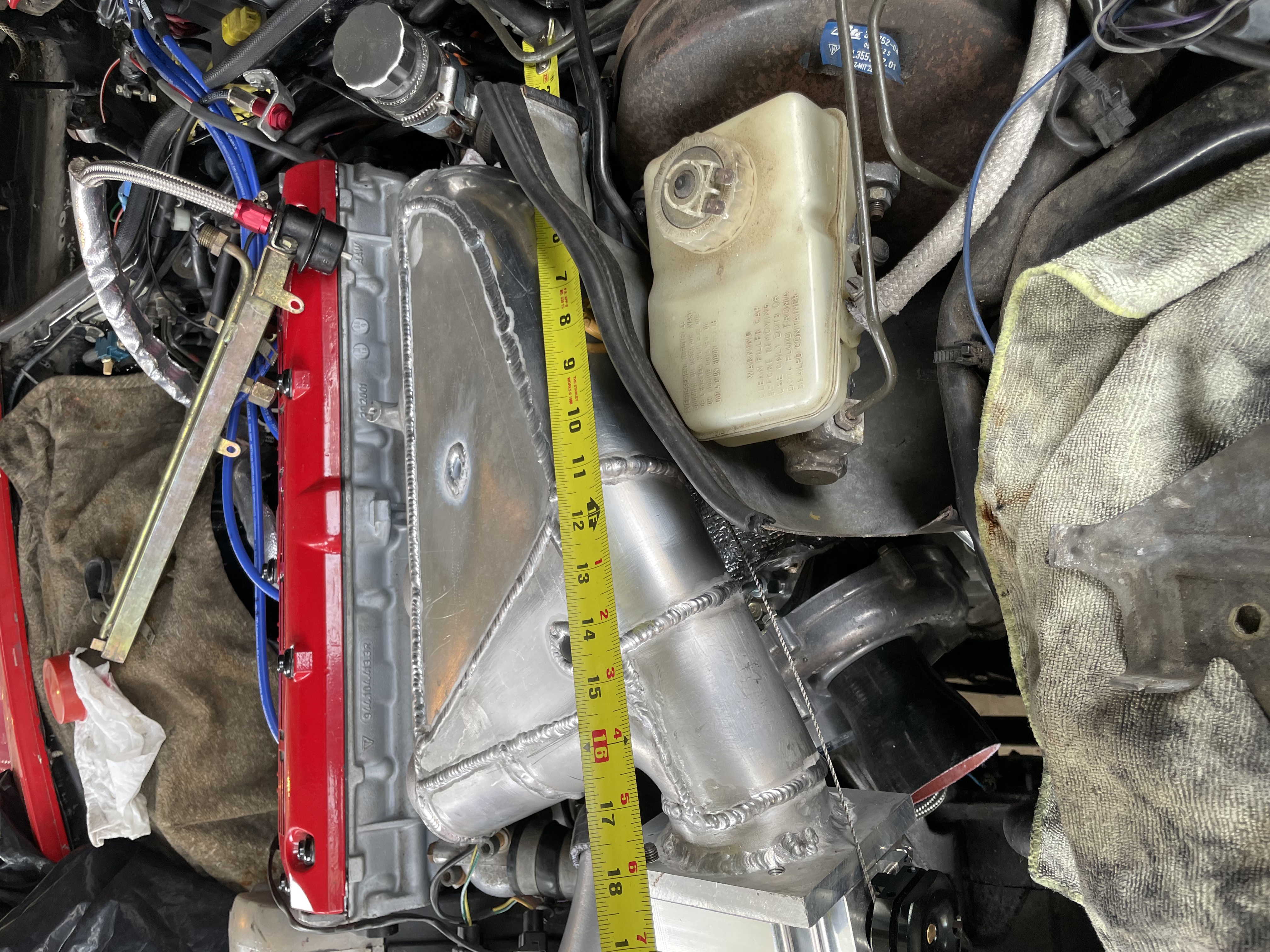

Intake with a s2000 throttle body and custom cable

Good job. That should flow pretty well for a 2.5 engine.
