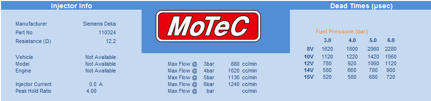

The car felt like it was running well, but felt like my warm idle AFR was still to rich at about 12. Kept playing with VE and timing but nothing really worked. Then came across injector dead time. After some reading I realized I was using a Nissan Quest alternator, which gives higher voltage than stock at about 13.5v per the ECU reading. This in turn opens the injectors faster. (I think).
My setting is 1.6ms with Deka 80s, which seems to high and “might” be why my AFR is a little rich. Will be playing with changing it this evening. But thought I’d ask what folks have for this setting?

Most injector manufacturers provide a dead time table for a certain fuel pressure with values to compensate for voltage. You'll need to find this data and properly configure you injectors before you go to much further with tuning.
Fancier injectors have a characterization table to compensate for non-linear flow, especially at the lower end. This can really help with idle with big injectors.
I’ve found several posts mentioning that folks can’t seem to find this information for Siemens Deka 80lb injectors. I’ll keep researching.
I have found a few ways to calculate it. Still trying to wrap my head around it though. But from what I’ve surmised so far, you can just adjust the settings and see what happens to AFR.

I saw a post somewhere that said Ford Motorsport rebadge the deka injectors and have a datasheet but I didn't follow it up.944m3 wrote: Sun Jul 06, 2025 7:44 pm I’ve found several posts mentioning that folks can’t seem to find this information for Siemens Deka 80lb injectors. I’ll keep researching.
This is the exact reason why I paid more for Injector Dynamics, even a lot of the other modified Bosch injectors don't have great data
