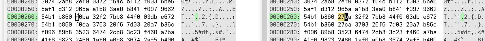

OK here goes. Stock 1987 KLR bin file with over/underboost error handling removed (I think) is attached.

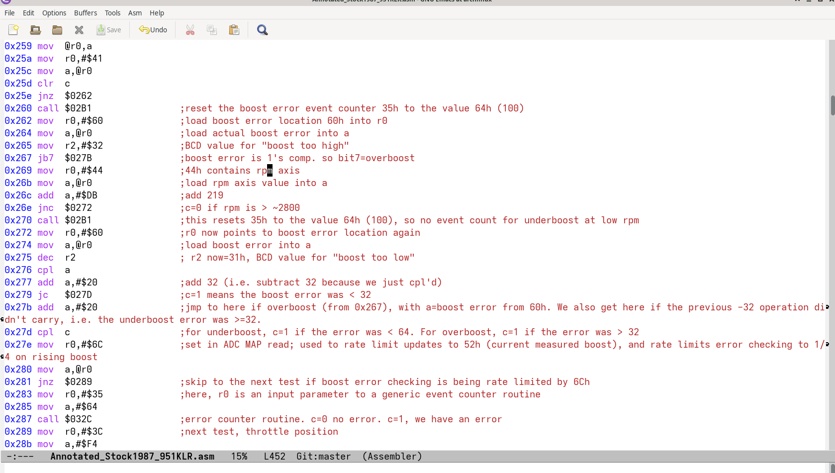

I'll post some screenshots of what I'm doing here for the sake of documentation for anyone who's interested. I'll put something more comprehensive on my KLR site later, or here if anyone wants.
First here's the most relevant bit of the original code but with my comments to explain what's going on

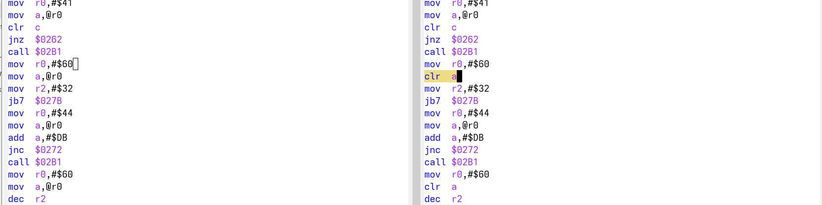

Now I can't assemble it from that version because I have added those hex addresses in the column on the left to help me keep track of things. Here's the original on the left and the change I'm making on the right:
So instead of loading the boost error (that was calculated elsewhere in the PID routine) into the accumulator, I'm just setting the accumulator to zero. So the error routine now thinks the boost error is zero. It gets loaded twice so I changed both.
Double checking the assembled BIN file to make sure my change is what I expected:
That 27h is indeed the opcode for "clr a".
If anyone is in a position to test this that would be really helpful. Obviously the usual use at your own risk must apply but I can tell you I didn't make any other changes, and I'm very confident that this change does only what we discussed in the lat few posts, for what it's worth.
