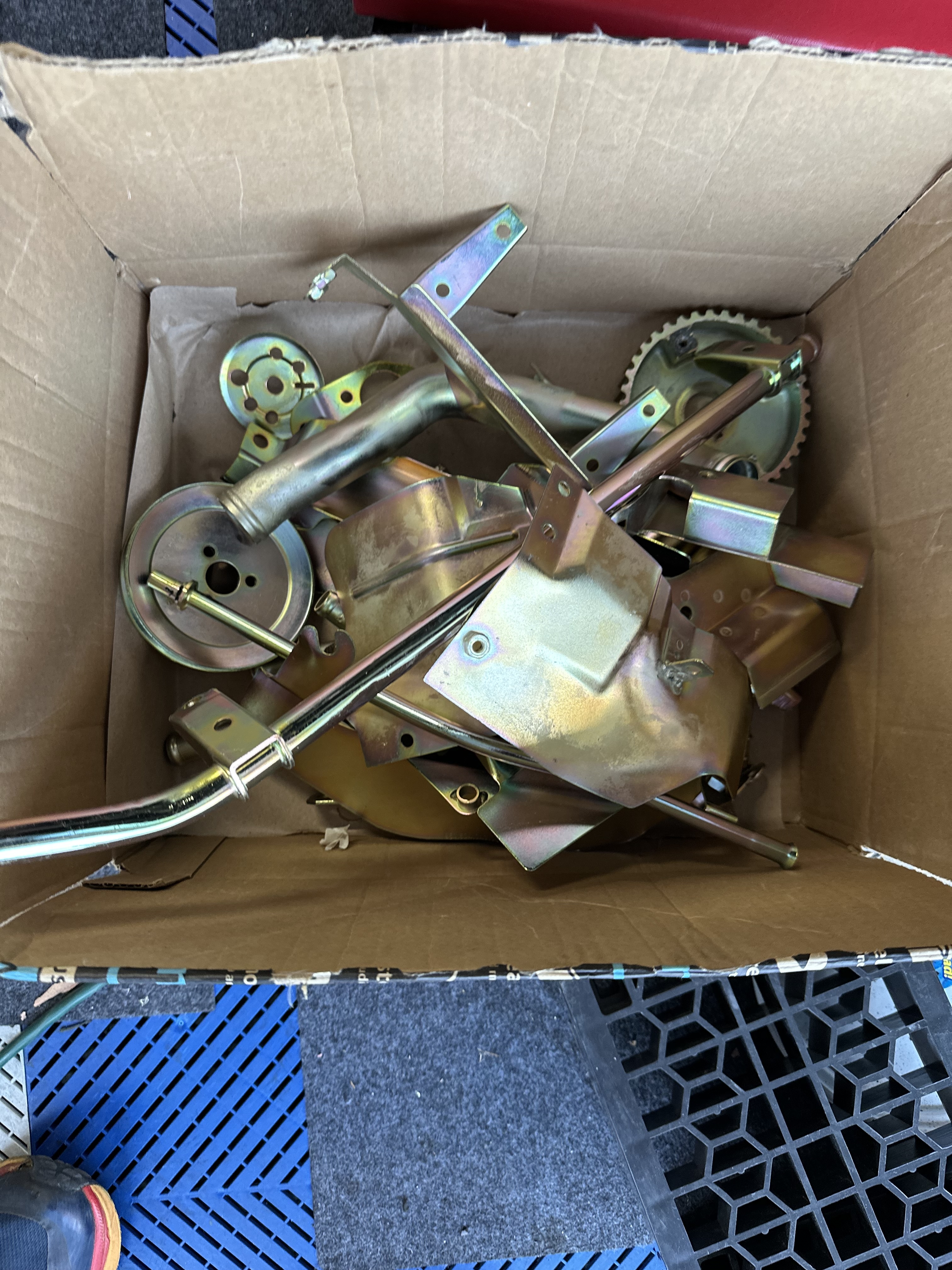

Re: replating. I'll post some pics later, but the folks at 4d metals in Santa Clara did like 190 fasteners/hose clamps + 20 larger parts for a very reasonable price.
As barnwerks predicted, some pieces came back unplated (water neck parts, speed sensor bracket, brake vent shields, motor mount shields)
They were all coated with gray or black dust, so it confirms they weren't good for plating (they didn't say anything when I picked it up - wrapped with paper).
I did get all the parts cleaned up, but some of the threads we nearly gone. Probably due to the acid bath followed by my wire brush cleanup. I was able to helicoil the speed sensor holes, but I was not too keen on that idea for the water neck parts. I found the used water neck parts at DC auto. The shields are just fine after cleaning.

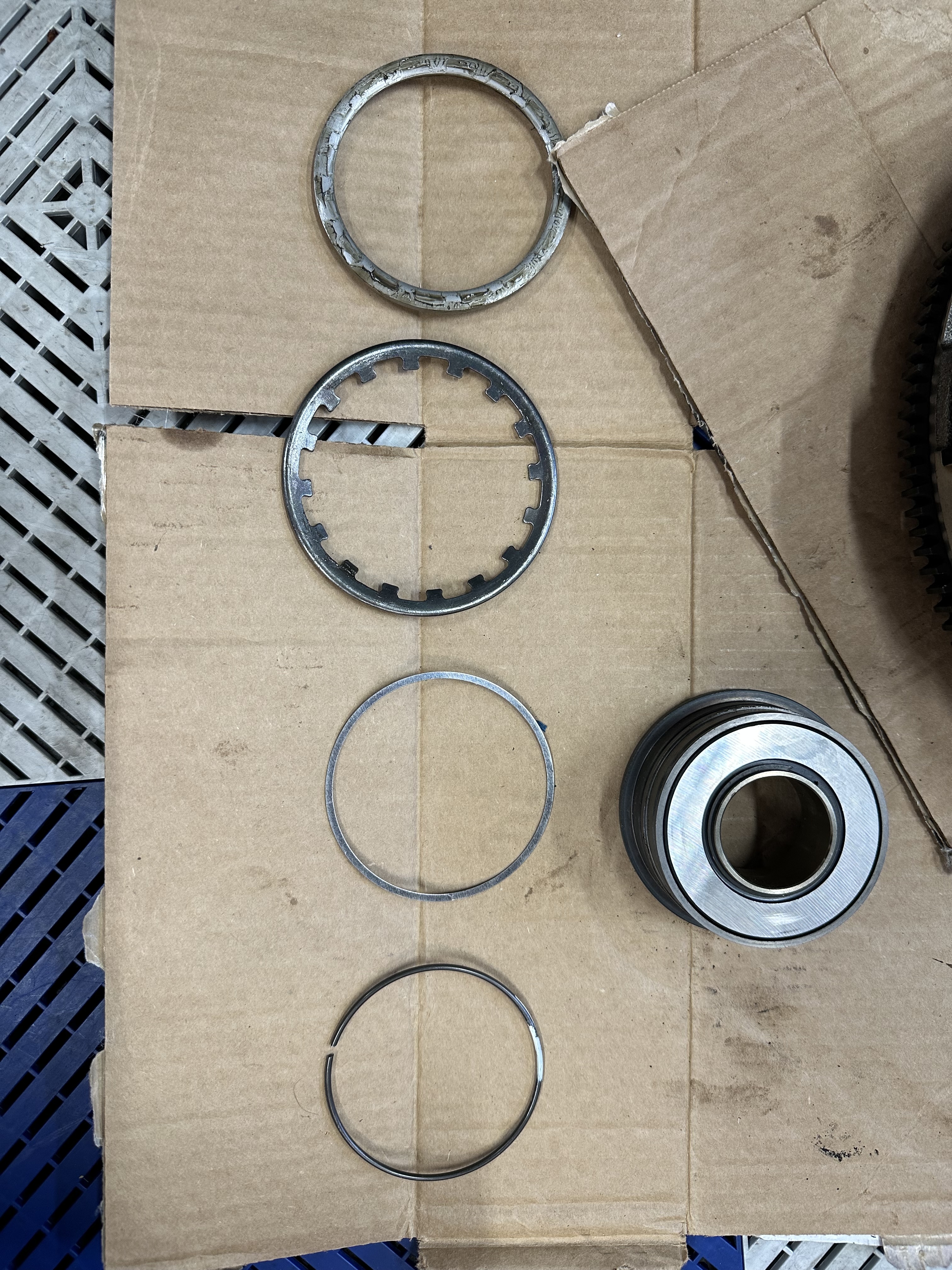

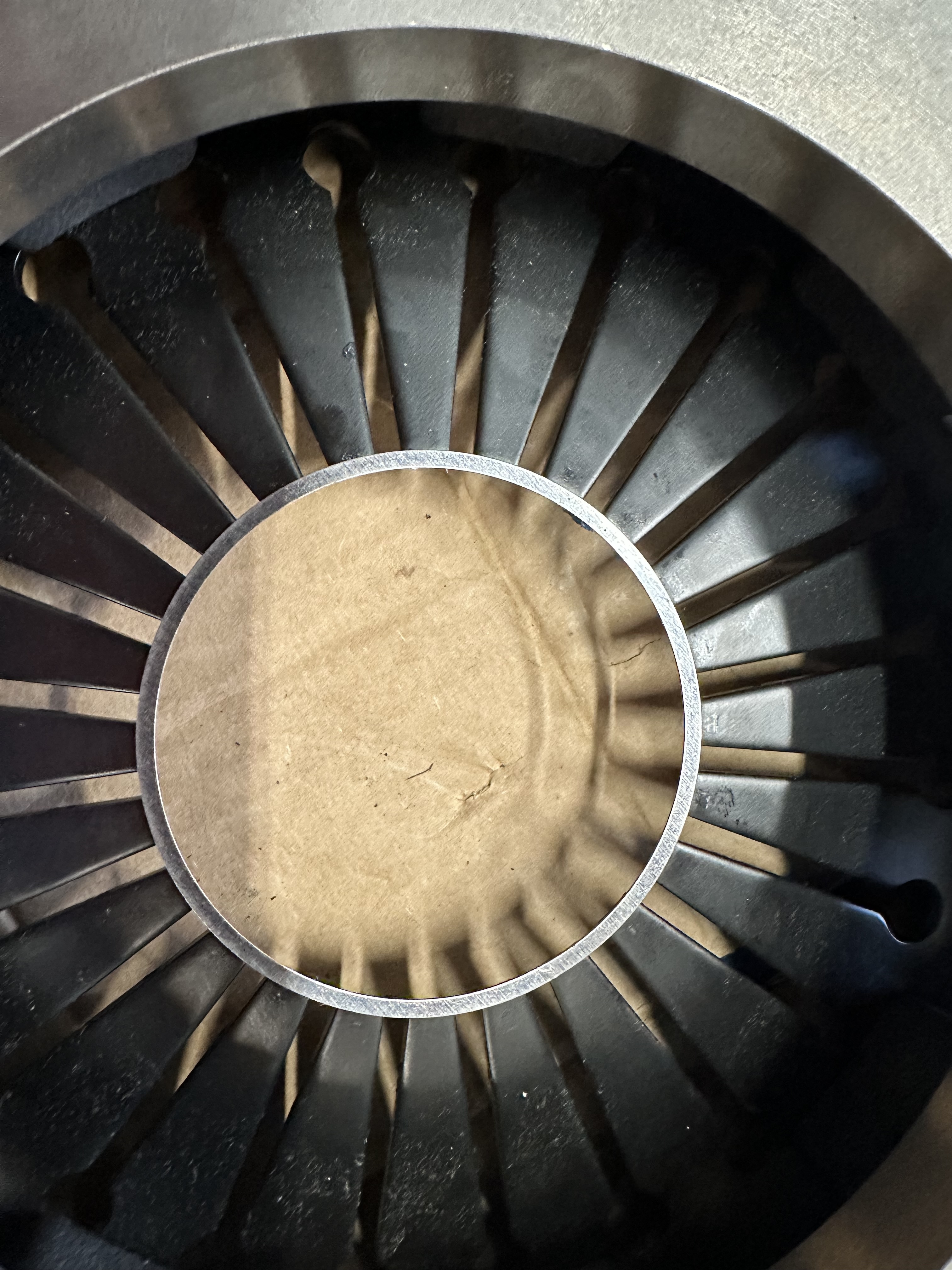

Putting together the new clutch - something isn't right here...
Clutch is a Sachs KF-248-01
In the attached pics - see that the final retaining ring (2nd from the right) that goes under the circ clip is very narrow and barely cover the fingers of the pressure plate. Result is that I can pull off the throwout bearing with little effort.
Most of the online videos show 3 shims, the spring shim and a much wider, beveled retaining ring.
What am I missing?
1986 951 - Silicon Valley

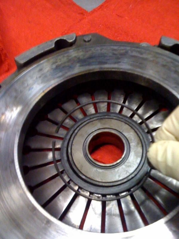

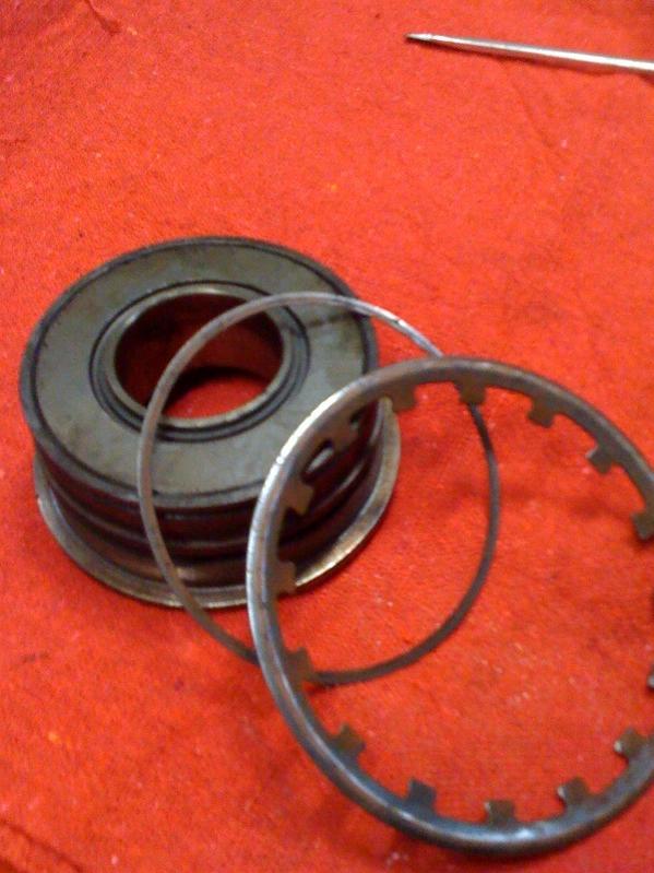

I think you may not be stacking the part right. That ring doesn't ride on the fingers. From my old posts back in the day:
Start by putting the throw out bearing down as shown, then slide the flat washer on, then slide the spring washer on with the tangs pointing down as shown in this picture.
throw out orientation.jpg (60.93 KiB) Viewed 4224 times

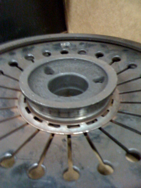

Once the washer and spring washer are on the throw out bearing, put the pressure plate on top of the throw out bearing with the friction side up. Then push down on the pressure plate to install the retaining ring.
throw out retaining ring.jpg (61.45 KiB) Viewed 4224 times
Once the retaining clip is fully in the grove, the throw out bearing is installed. It looks like this from the other side.
throw out assembled.jpg (117.06 KiB) Viewed 4224 times

Before your post - I took apart the old clutch and it had the exact same parts.
My assumption that the thick ring went under the pressure plate was wrong. It's the retaining ring and the one I was worried about is the single shim ring.
Sorry for the interruption, but there weren't any internet references or included info with the clutch.
So as Tom says, the correct order is
bearing
shim
spring ring
pressure plate
thick retaining ring (flat side against the pressure plate
circ clip
