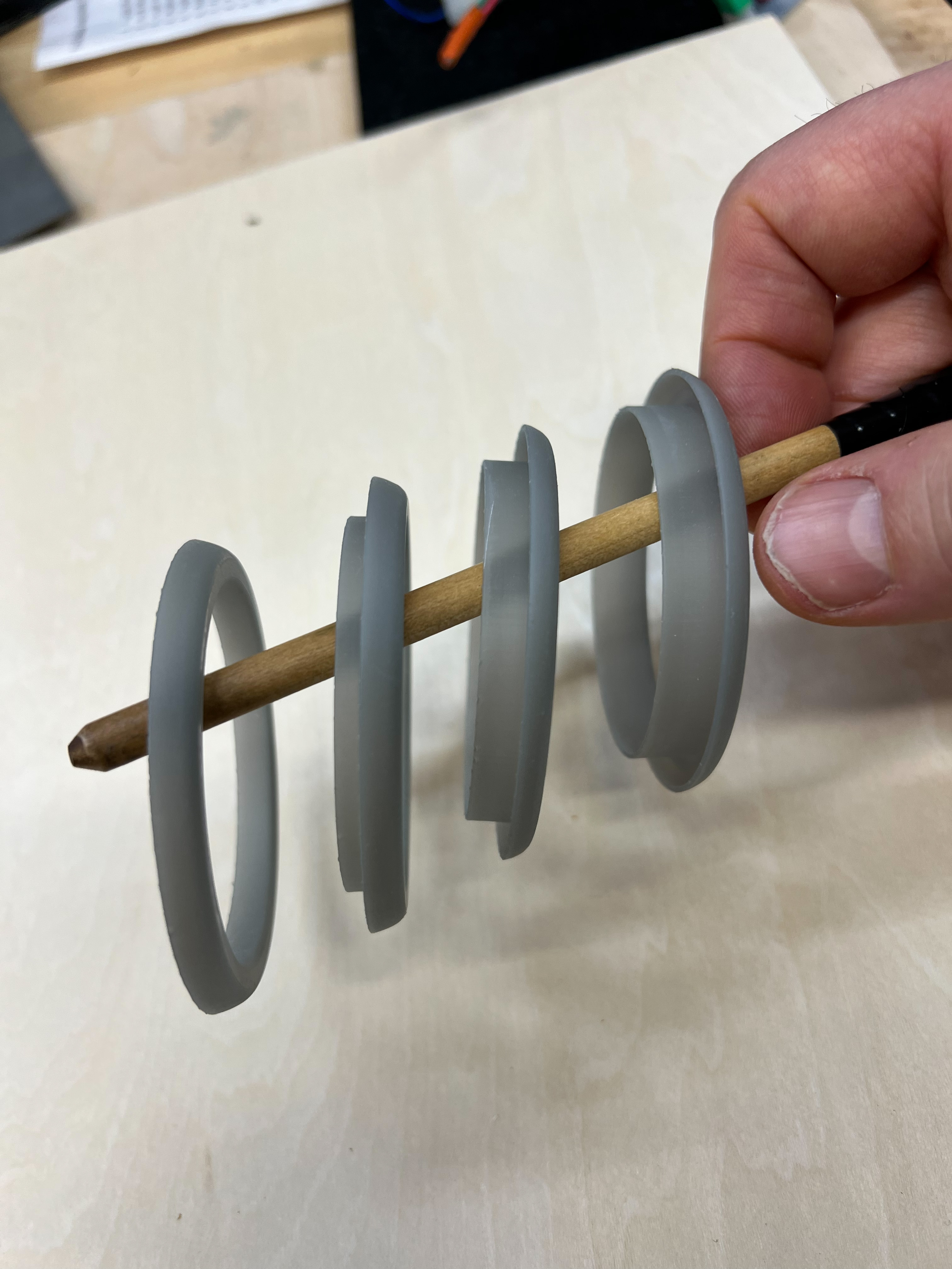

BzzzBom summed it up nicely. Getting the cover to clip on the 718 bezel was relatively easy off the car, but getting it just right on the car itself is taking a bit more effort, especially through the mail without my own eyes on it. But, we're getting a little closer with each try. Fresh set of test rings fresh off the printer...

And once those are done it seems making a snap on solid cover will be easy, for those that want to totally cover it for night driving if they do not like the ones with a hood/eyebrow - nice work as usual!

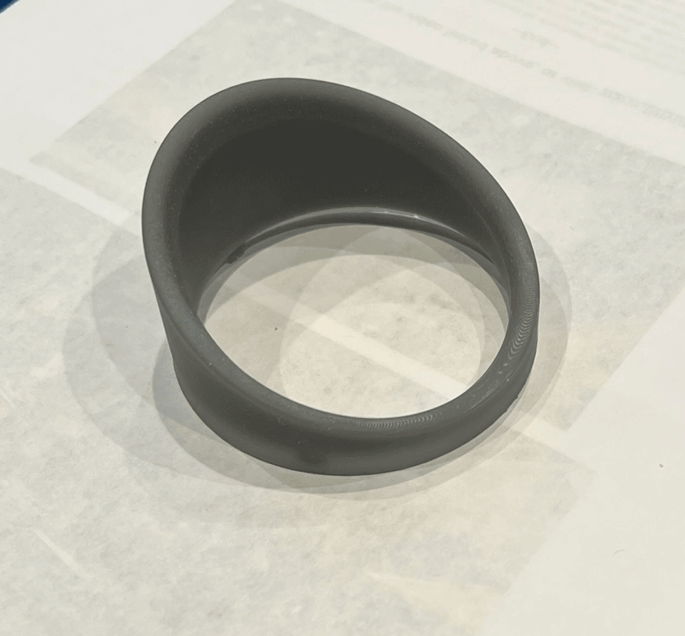

In the meantime, I printed this hooded version for @Bob Z which gets installed in lieu of the factory bezel. Bob wanted both sides straight, and I was worried it would look thick and weird, but I put a deep chamfer on the facing edge and have to say I think it 'works' visually.... This was a proof of concept print, so rougher than I normally print them, but I think by far it's the best looking hooded version we've tried....

Another work of art Tom! I do have to agree though - go back and look at first hooded versions you made, which were good but this one is great! FYI all: in order to block the SC reflection on the interior glass at night the top hood/eyebrow would need to be 2 1/2" long, which does not look good, or even close to OEM. It is due to the angle of the SC in the 718s. Therefore we thought it best to design one with an attractive hood that is Black - Tom nailed it!

Tom wrote: Tue Feb 01, 2022 7:01 pm bobs-straight-cut-bezel.gif
Wow, that actually looks very nice! Really like the rounded bevel edge of the covering. Excellent!
