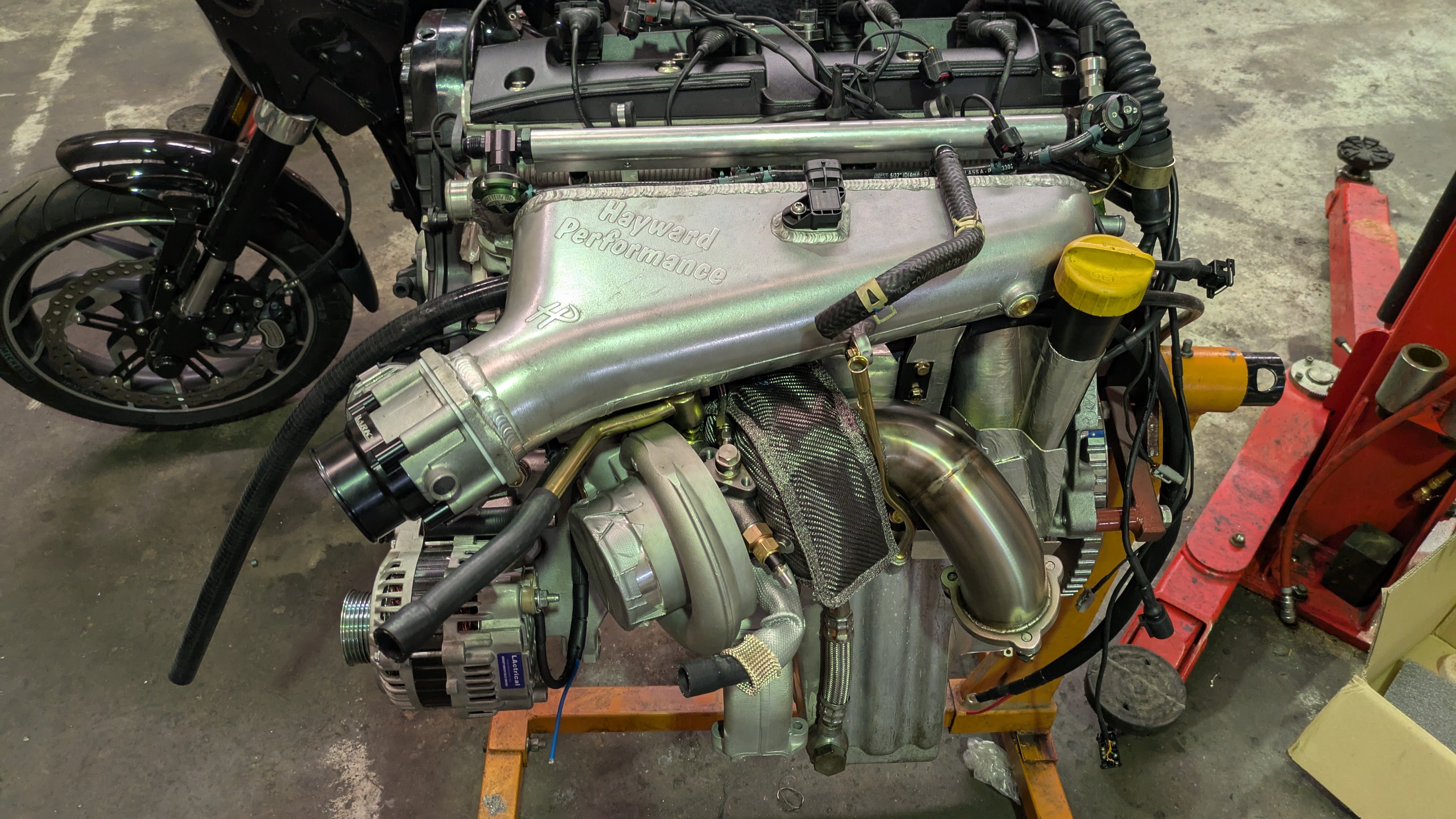

Bergerac wrote: Sat Dec 07, 2024 6:50 pm Well I've had some good news for once, we found a welder who specialises in exotic alloys who is confident he will have some success repairing my cross over cracks. Apparently heat treating before welding is the key, if this works it will buy me some time to get the car running until I can get something fabricated.
New oil pickup arrived (not sure I needed it but its cheap insurance) The sump is finally on and timing/balance belts all done. It took a little while to get our heads around timing the 968 cams but we got there in the end.

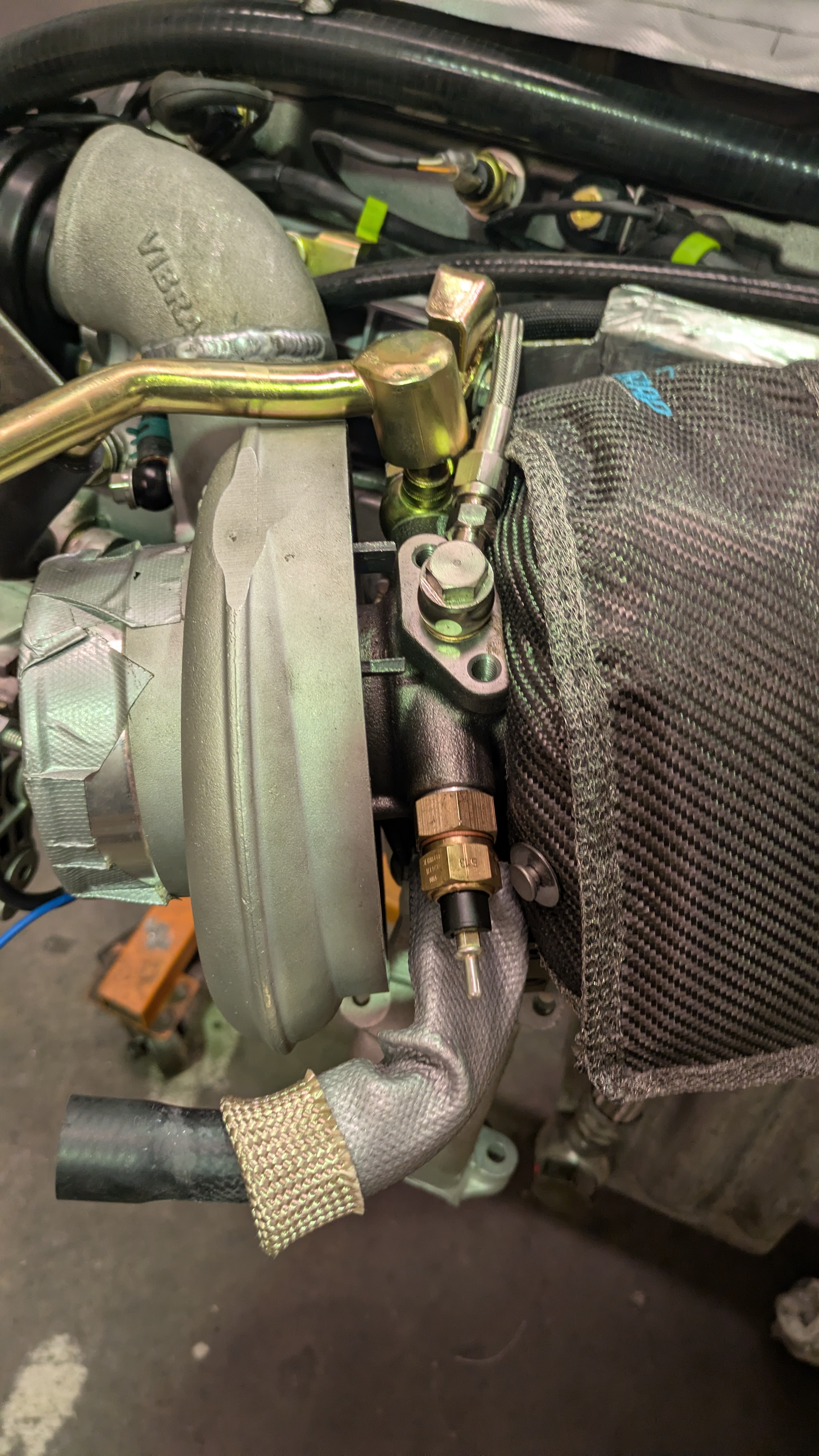

I had to employ a unique strategy to mount the turbo temp switch. Its not vital to have this switch as my pump is controlled by the ECU not the stock relay but knowing when the turbo is sufficiently cool after a run can only be a good thing.

Even if there are occasions when the fans keep running for a short while after the engine is turned off the turbo's CHRA will keep radiating heat that only coolant can absorb and circulate, thus the need IMO to keep this function enabled. At least this has been my experience with either of the 3 engines I have had in my car, especially if the car is parked under the sun. I am not sure how you control this with the ECU if it is turned off.

The ECU has a power hold function, you use one of the outputs to hold the ECU relay in, or in my case the PDM powered up which the runs fans and pump. Its on a timer ATM, but I have some ideas about how I can setup it up to stay on as long as required with some logic and virtual outputs.

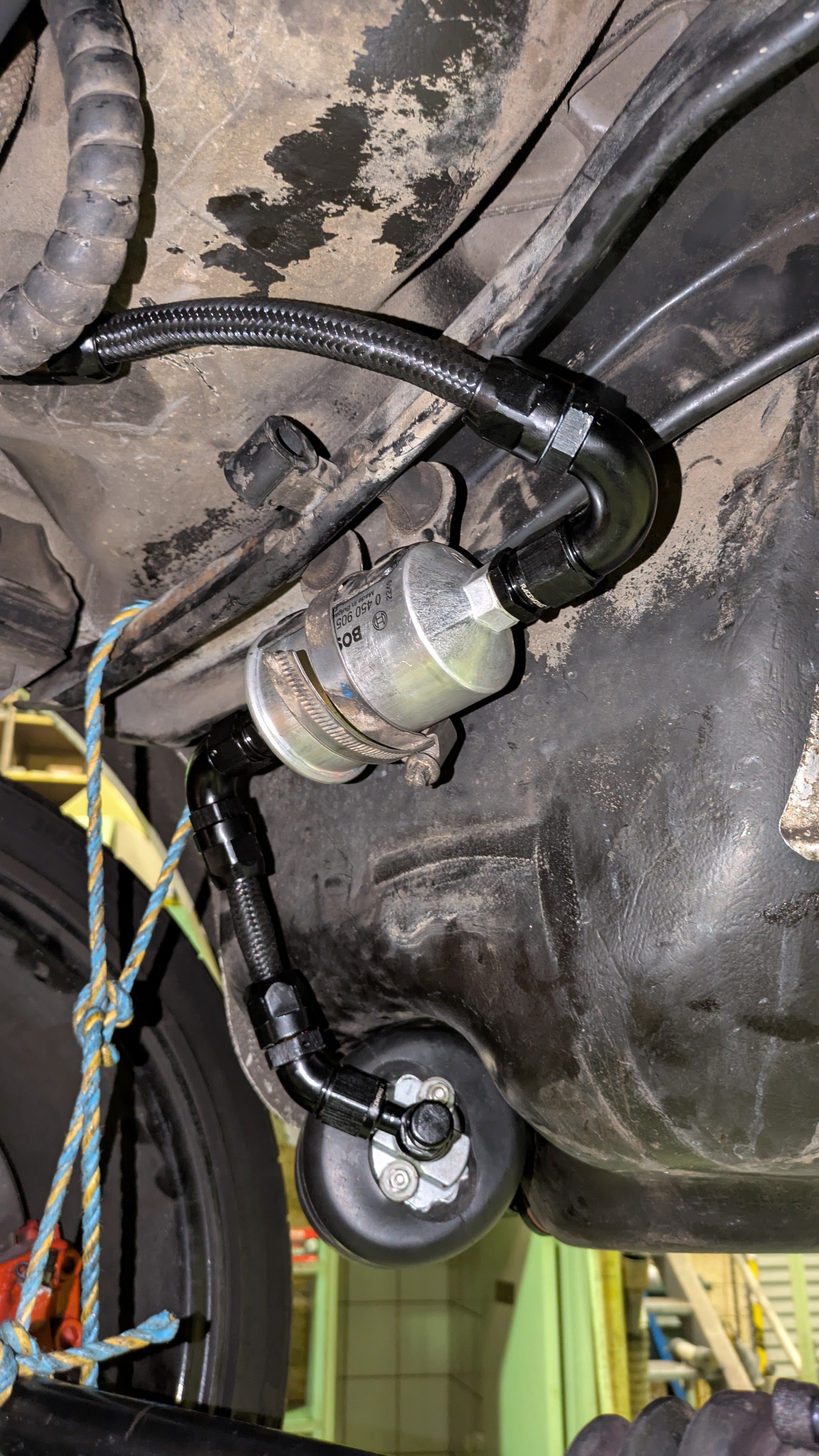

by Bergerac

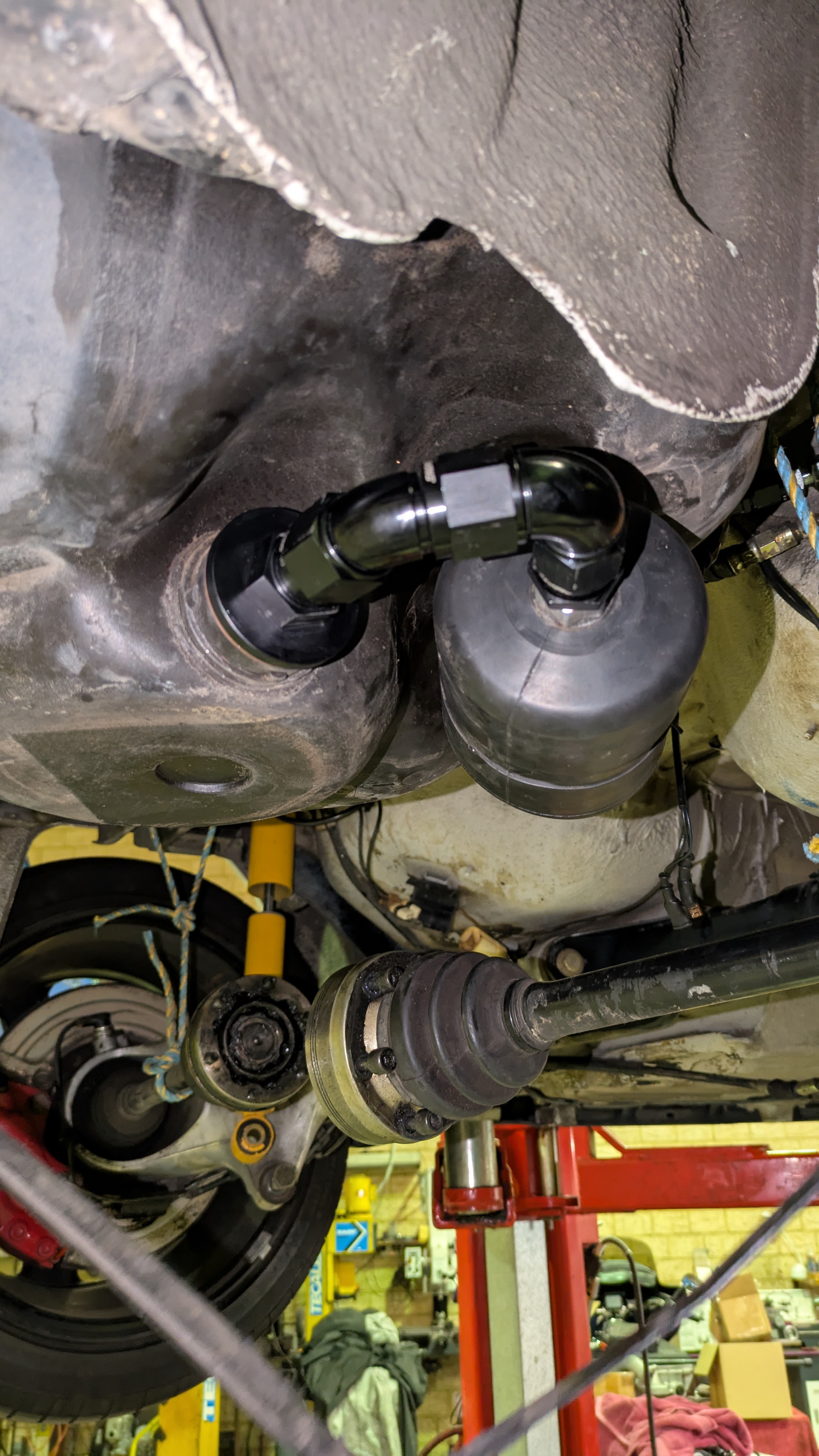

Bosch '200' fuel pump installed with stock sleeve and fuel lines finally finished. It seemed like none of the fittings were going to work but I just ran with it and everything lined up with the stock mounting plate. I've got to wonder what the hell Porsche were thinking with this design.

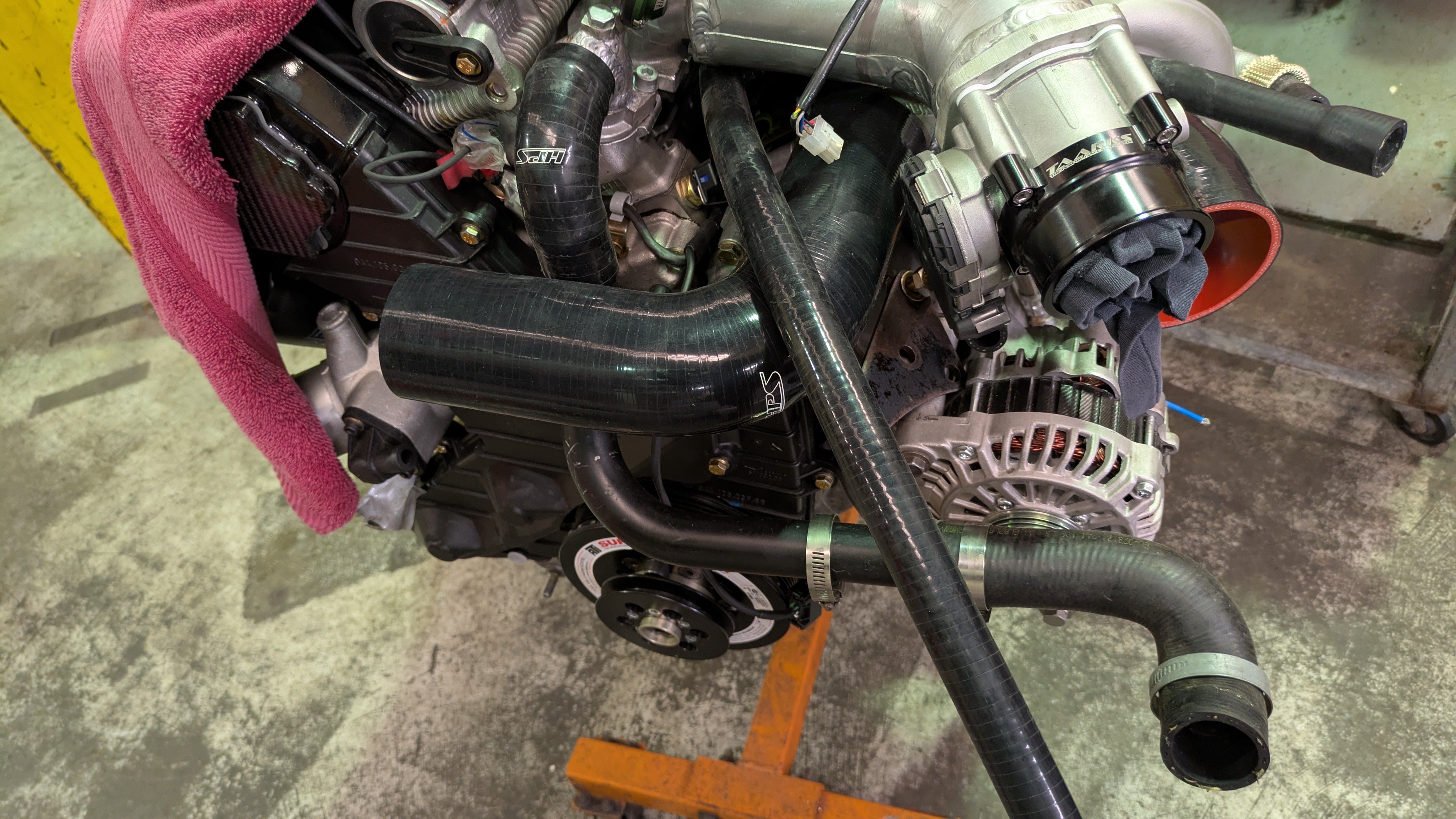

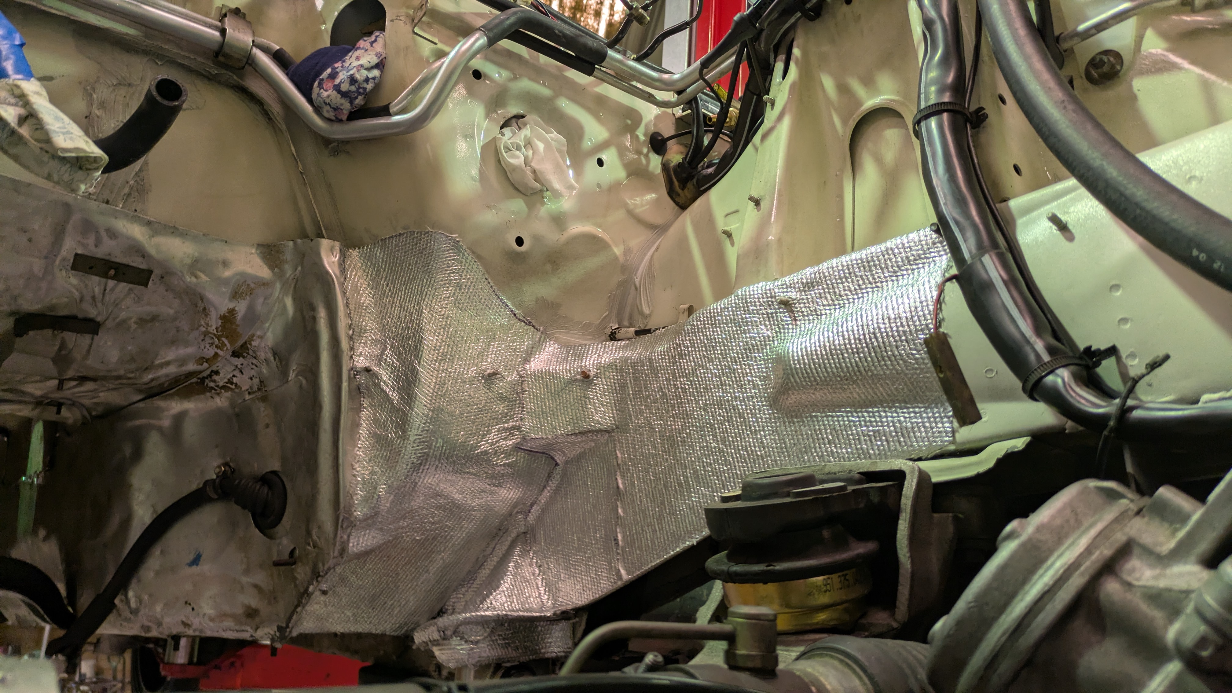

I'm pretty happy with the way the routing for the front coolant line and charge line has played out, the silicone bend will be trimmed a bit but this should look nice and clean in the car.
I installed some heat shielding to in the spots the S2 didn't have it compared to the turbo, I had to also replace the A/C line with one from a turbo, the stock one was going to clash with the compressor housing

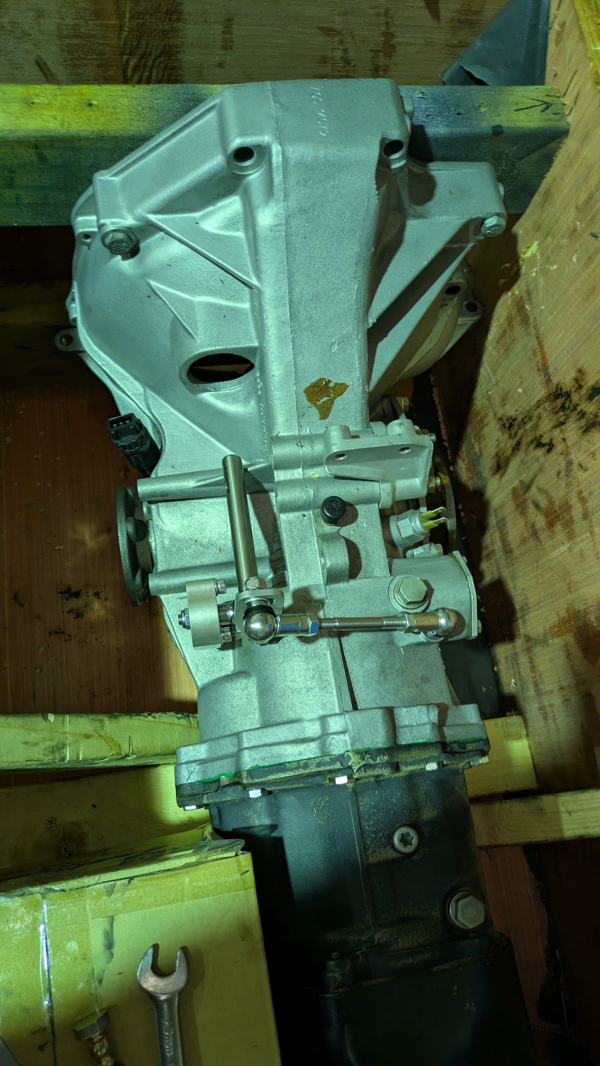

Transaxle with LSD installed is back and Only 944 short shifter added. Sean Buchanan said it one of the best condition boxes he'd seen for a while so only the diff bearings and a few seals were changed. Hoping it will hold up well but I managed to pick up a spare S2 AOS trans cheap just in case.
Thanks Thom, I'll look into the flywheel, I was hoping to have the engine in this week but the crossover pipe and headers were held up again with the guy doing the coating ending up in hospital.

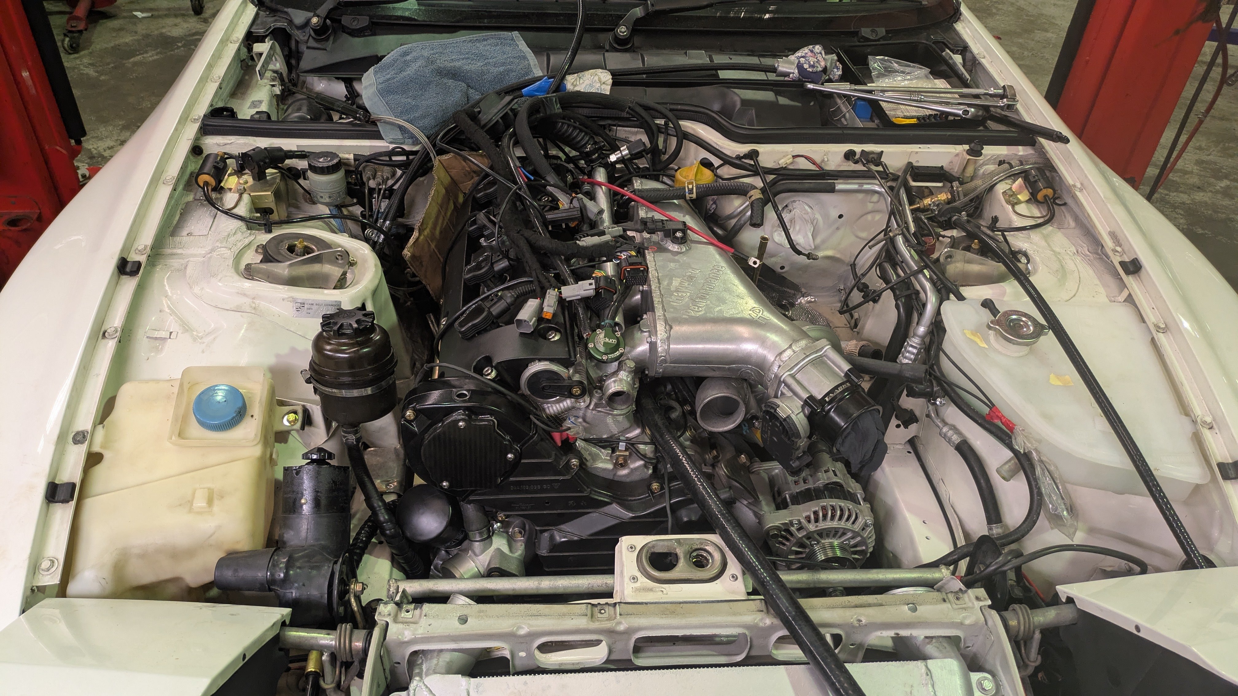

It's in! :D
TT and transaxle went in today too, apart from an exploding release bearing it's going fairly smoothly.
