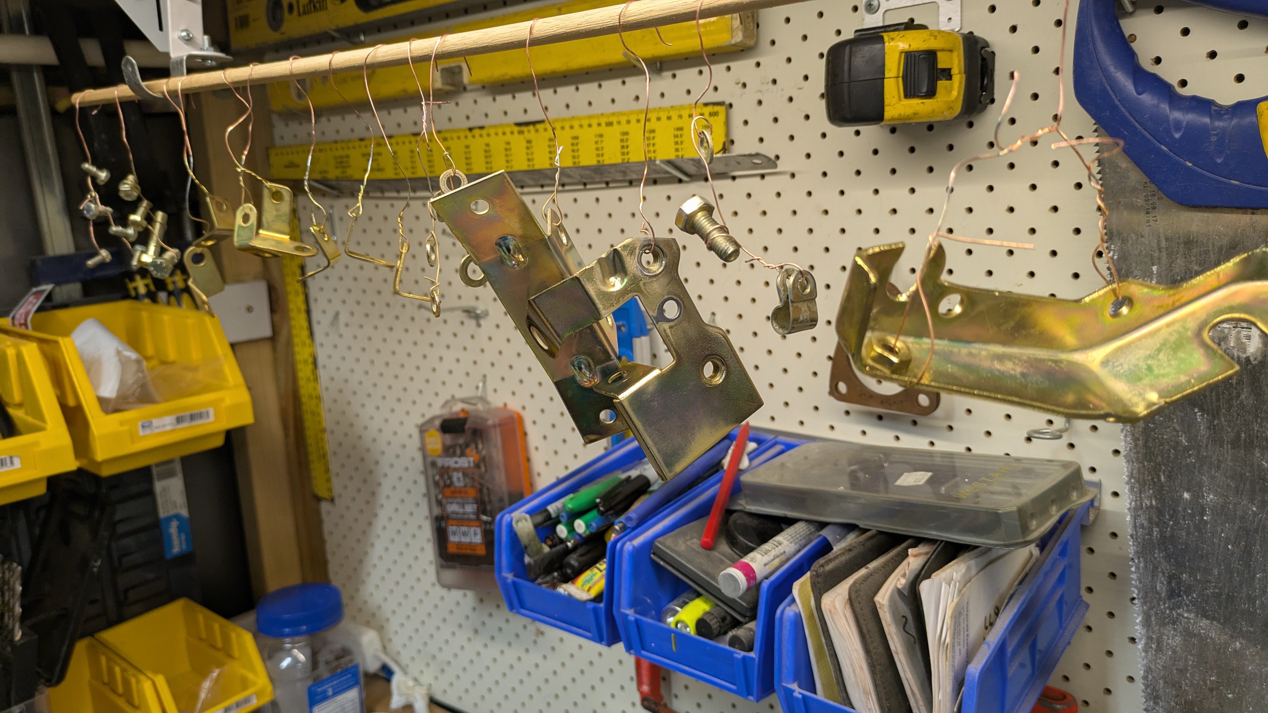

Did a bit of zinc plating today, it's not perfect but it's came out surprisingly good. Only a few pieces had to be redone.

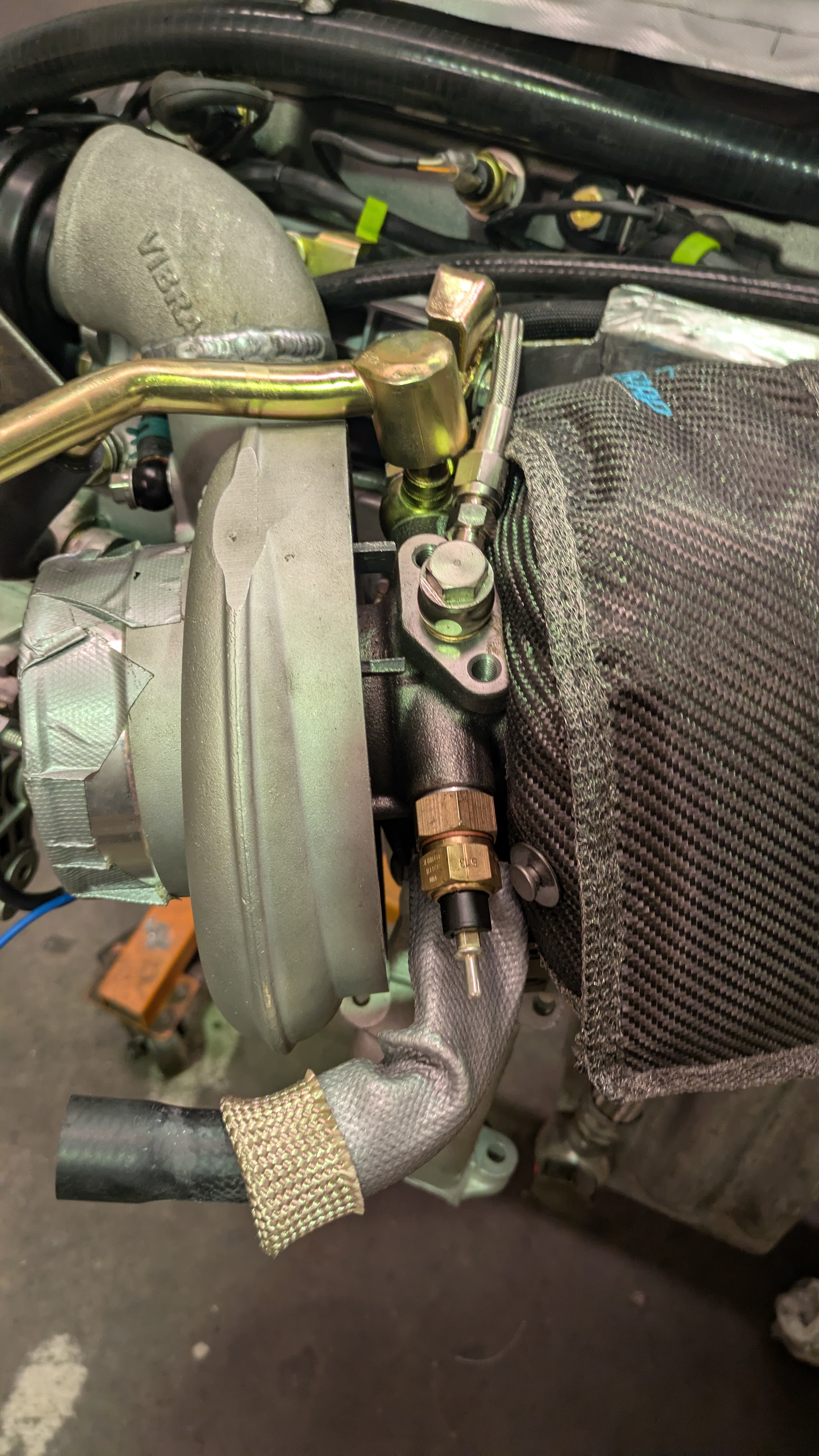

I had to employ a unique strategy to mount the turbo temp switch. Its not vital to have this switch as my pump is controlled by the ECU not the stock relay but knowing when the turbo is sufficiently cool after a run can only be a good thing.

Even if there are occasions when the fans keep running for a short while after the engine is turned off the turbo's CHRA will keep radiating heat that only coolant can absorb and circulate, thus the need IMO to keep this function enabled. At least this has been my experience with either of the 3 engines I have had in my car, especially if the car is parked under the sun. I am not sure how you control this with the ECU if it is turned off.

The ECU has a power hold function, you use one of the outputs to hold the ECU relay in, or in my case the PDM powered up which the runs fans and pump. Its on a timer ATM, but I have some ideas about how I can setup it up to stay on as long as required with some logic and virtual outputs.

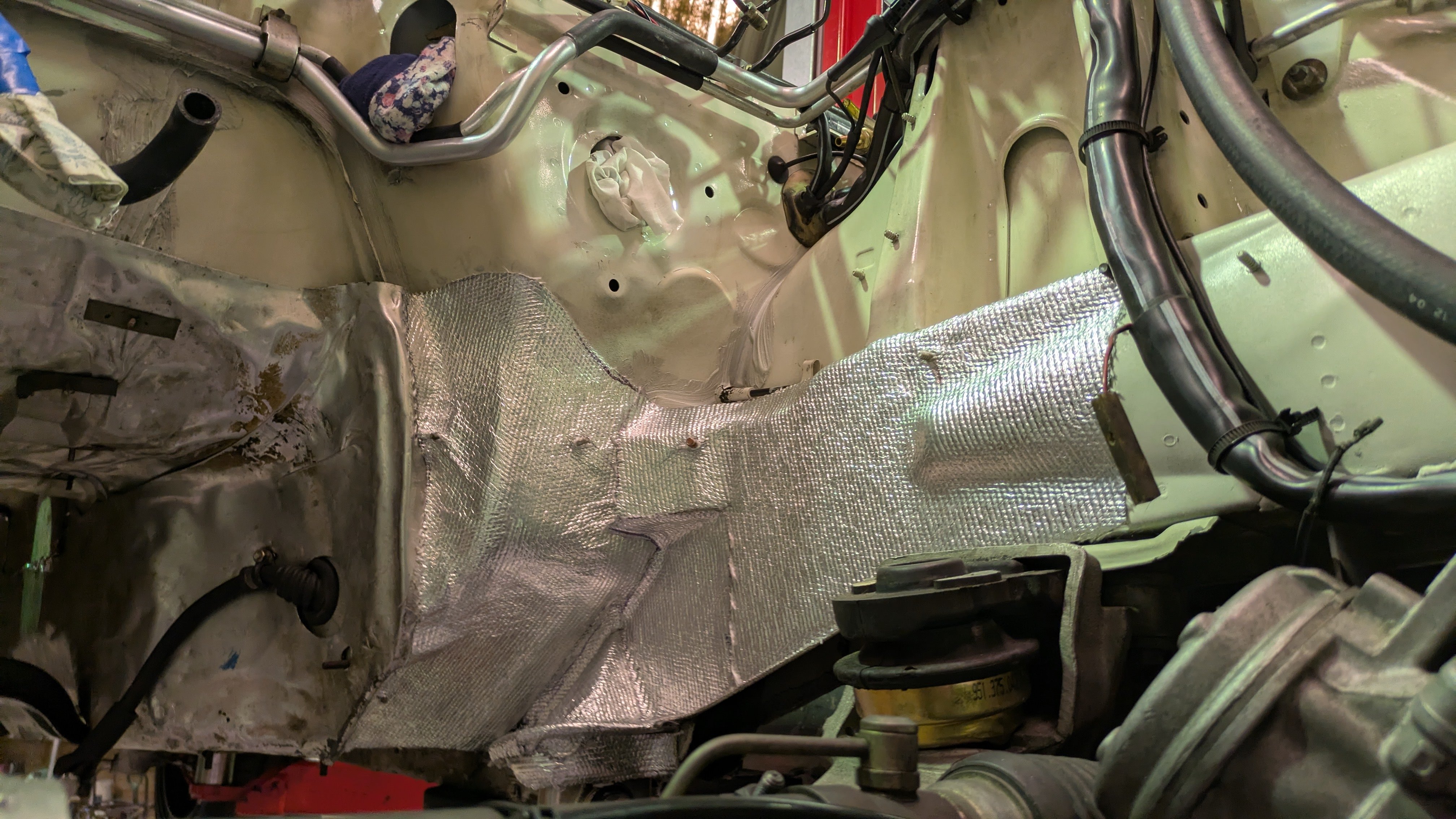

I installed some heat shielding to in the spots the S2 didn't have it compared to the turbo, I had to also replace the A/C line with one from a turbo, the stock one was going to clash with the compressor housing

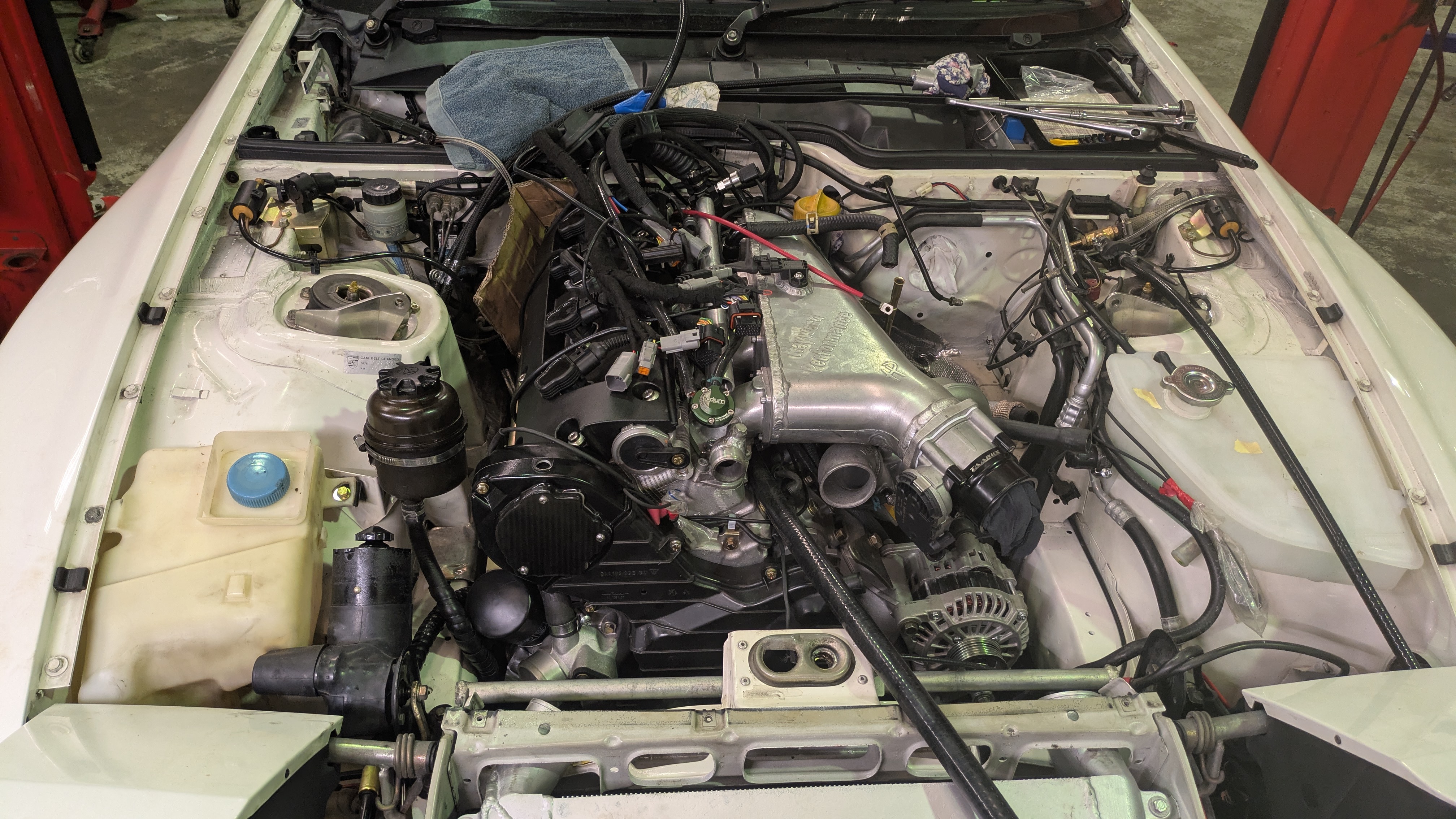

It's in! :D
TT and transaxle went in today too, apart from an exploding release bearing it's going fairly smoothly.
