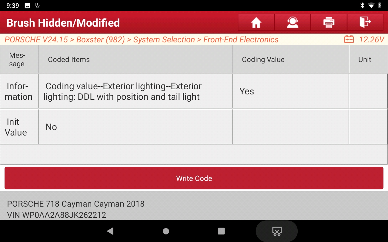

Can I add only the tail lights (in addition to front DRLs) when DRLs are enabled?
I don’t care for turning on side markers, and I’m not interested in adding the gauge lights. I’d just like DRL to mean having some nice-looking indicators both front and rear.
Entirely possible this is covered by some of the earlier posts about gauge lights and a combination of enabling scandinavian DRLs and disabling NA side markers.

julianm wrote: Thu Jul 20, 2023 11:35 am Can I add only the tail lights (in addition to front DRLs) when DRLs are enabled?
Hmm. I don't recall seeing anything like that, but I'll look next time I've got mine connected.
In my case, I added the what X431 translates as "markers" to DRLs. What I got was the taillights, license lights, side markers and gauges. (I found it odd that the front parking lights were not included.) The side markers can then be defeated, but it's an 'all-the-time" fix. No side markers even after dark...
Yes. No side marker, gauges or license lights. The parameter for this one is:
SYSTEM SELECTION> Front End Electronics > Coding Value--Exterior Lighting--Exterior Lighting: DDL with Position and tail light = Yes
{Default: No}
- Arne

Arne2 wrote: Mon Jul 24, 2023 11:39 am
Wow this is great thank you. I really want to pick up an X-431!
