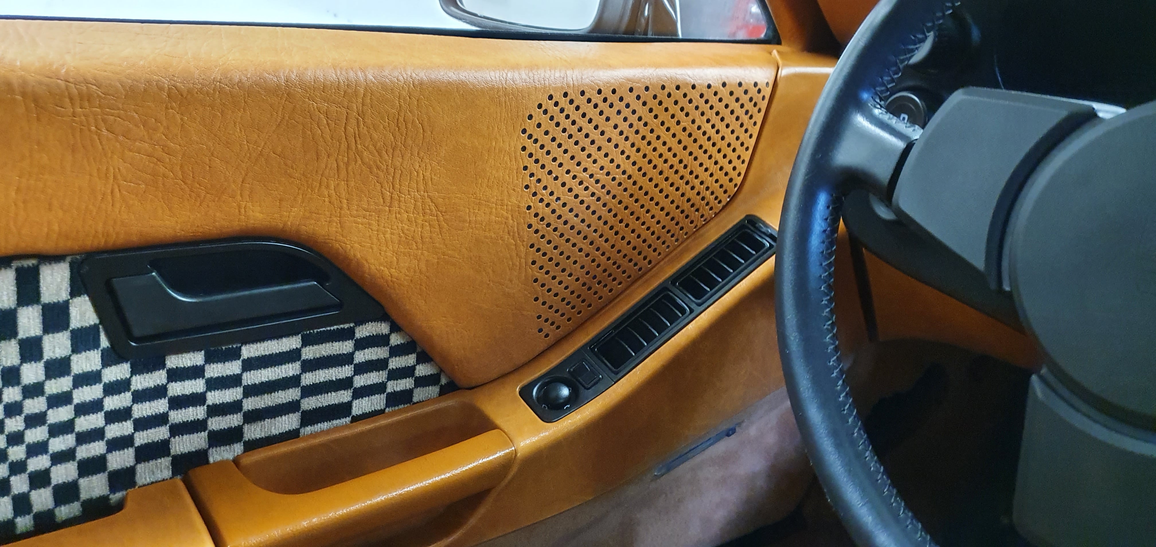

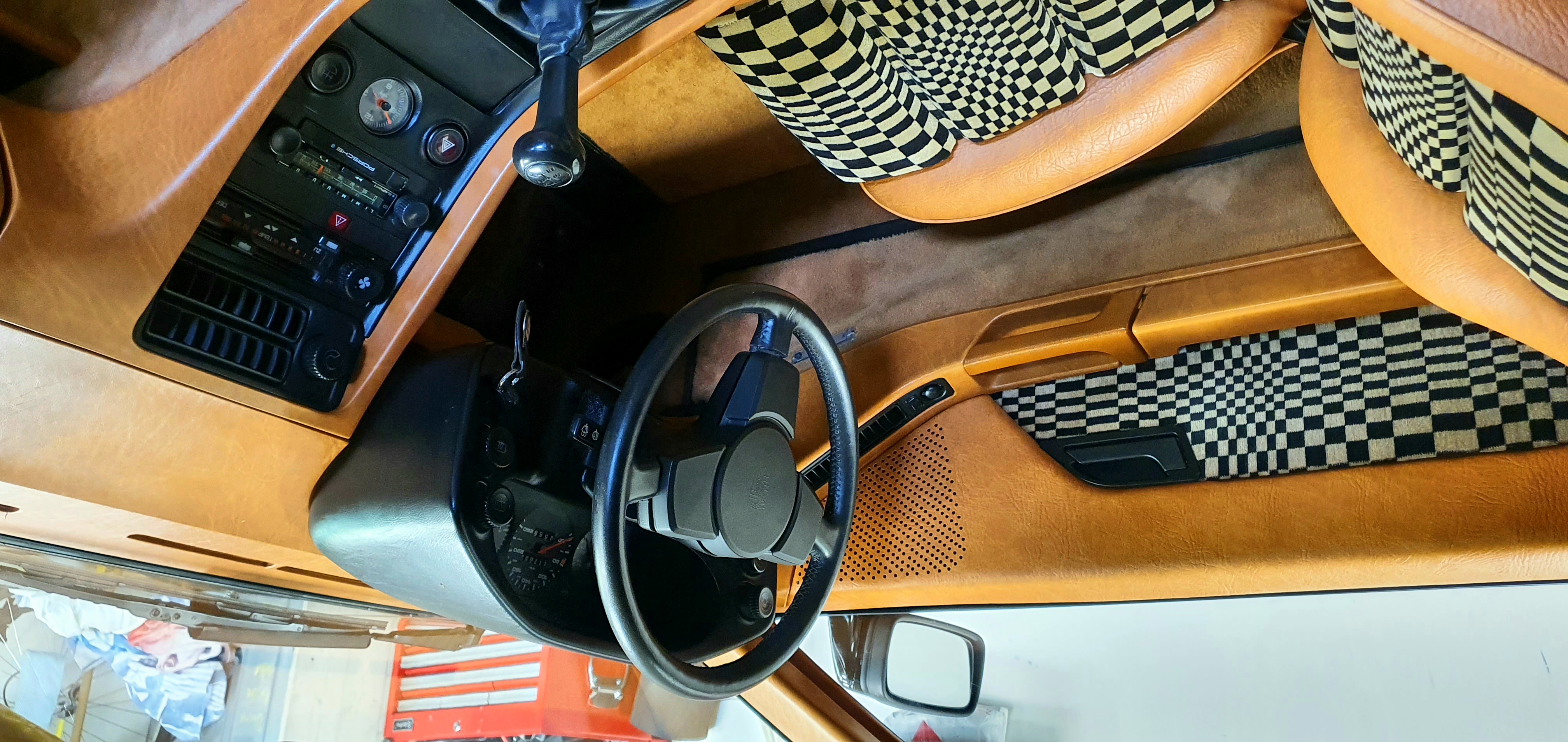

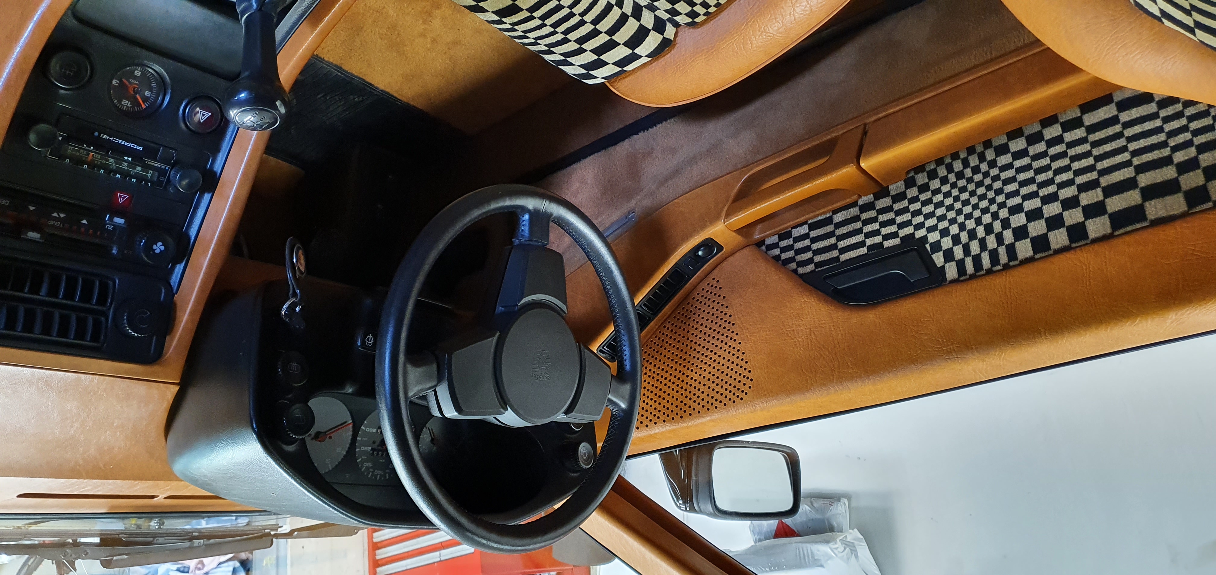

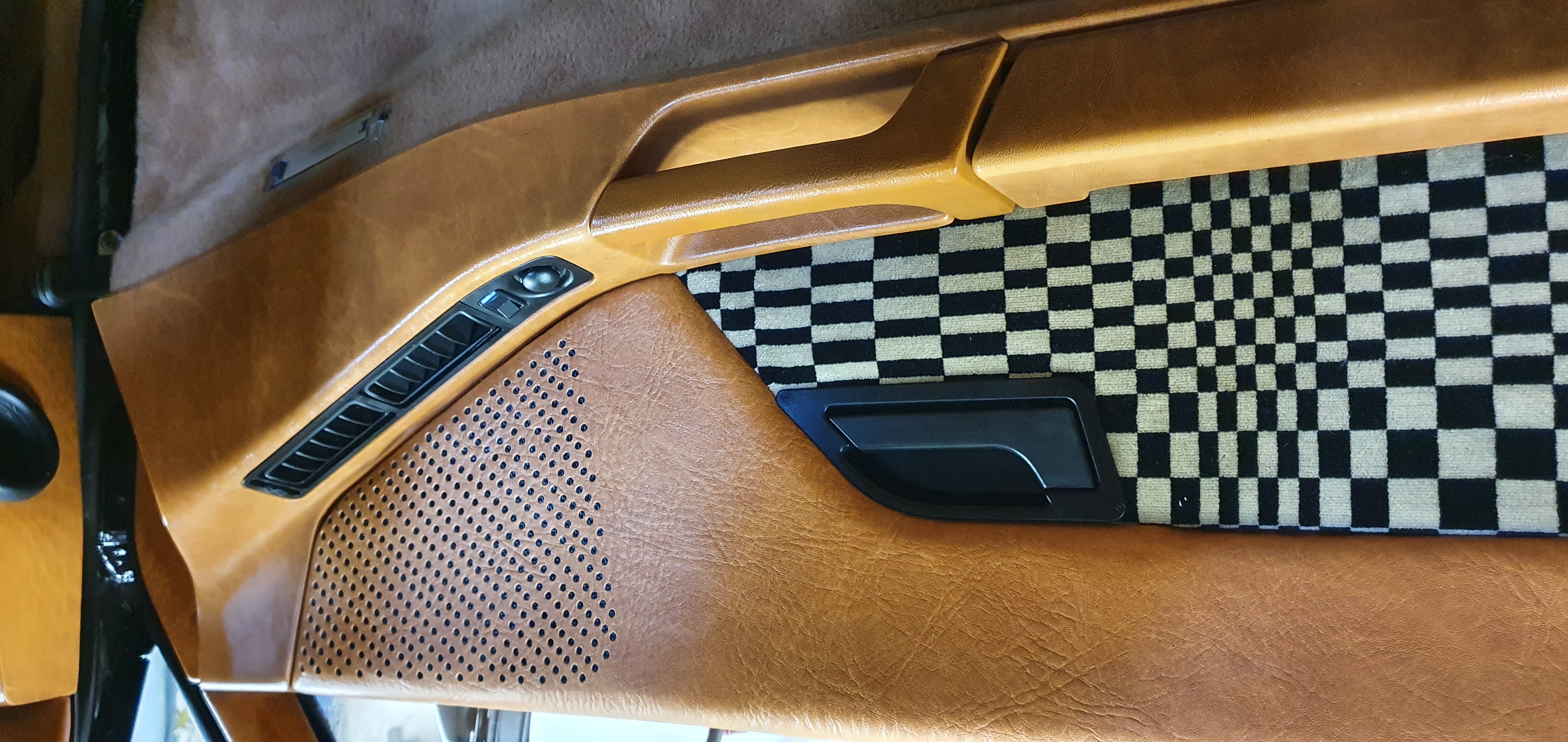

Once I had finished the perforation and cut the vinyl to size I needed to fit them to the doorcards.
I didnt feel confident about it so asked the trimmer who redid my front seats but he was swamped with work and considering that these vinyl pieces I had was the very last I could find in the correct vinyl he wasnt willing either.
That meant I had to do it myself😬
I took it very easy and worked my way around the doorcard not glueing to big areas at the same time. The area that was perforated I did first. It was a pain but I finally got it done and it looks totally as it did from Porsche 🥳 I treated myself to a beer in the backseat once I was finished!🍺
This meant the car was finished apart from oilchange in the engine and gearbox.
Here is the final result of the doorcards and interior. I am very pleased I must say🙂

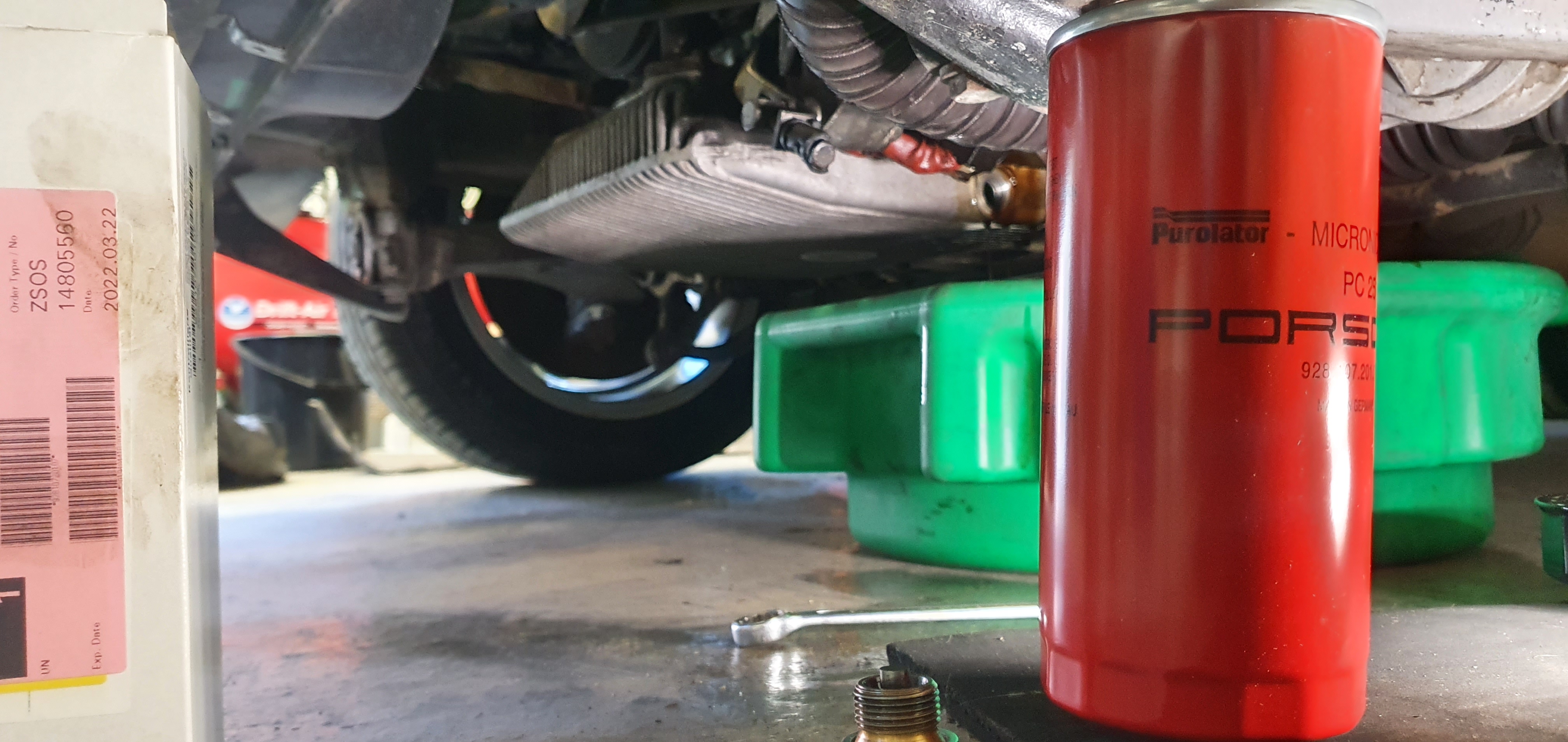

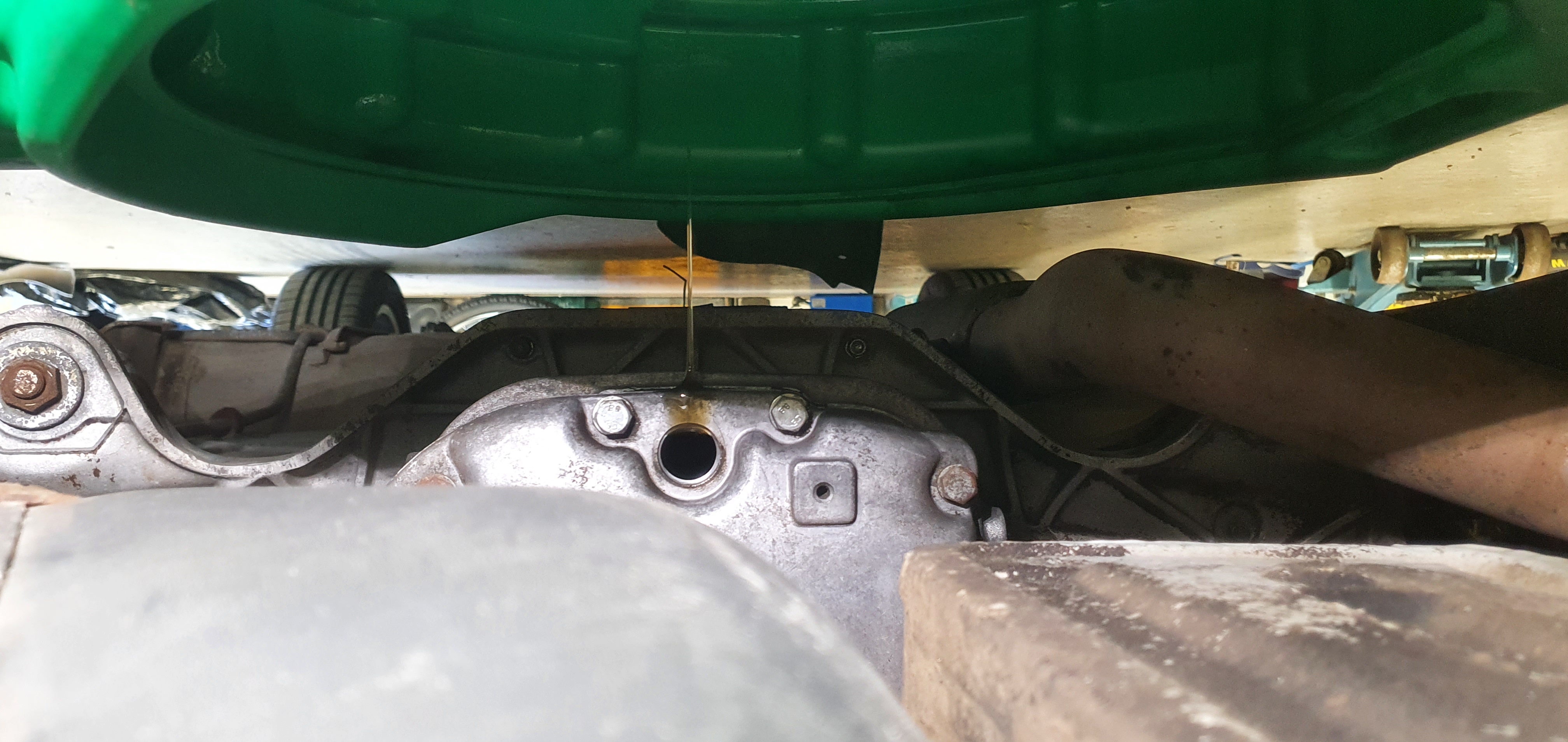

Valvoline VR1 Racing 20w50 and new classic filter from Porsche and Mobil SHC 75w90 in the gearbox.
Next up first drive in 15 months and start of rebuild 🥳🍻

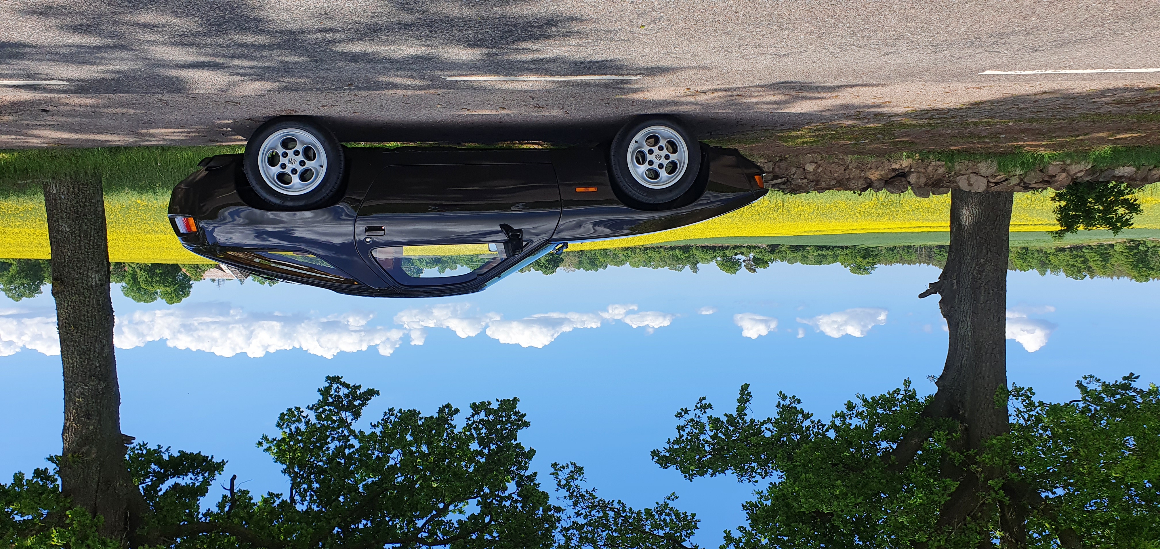

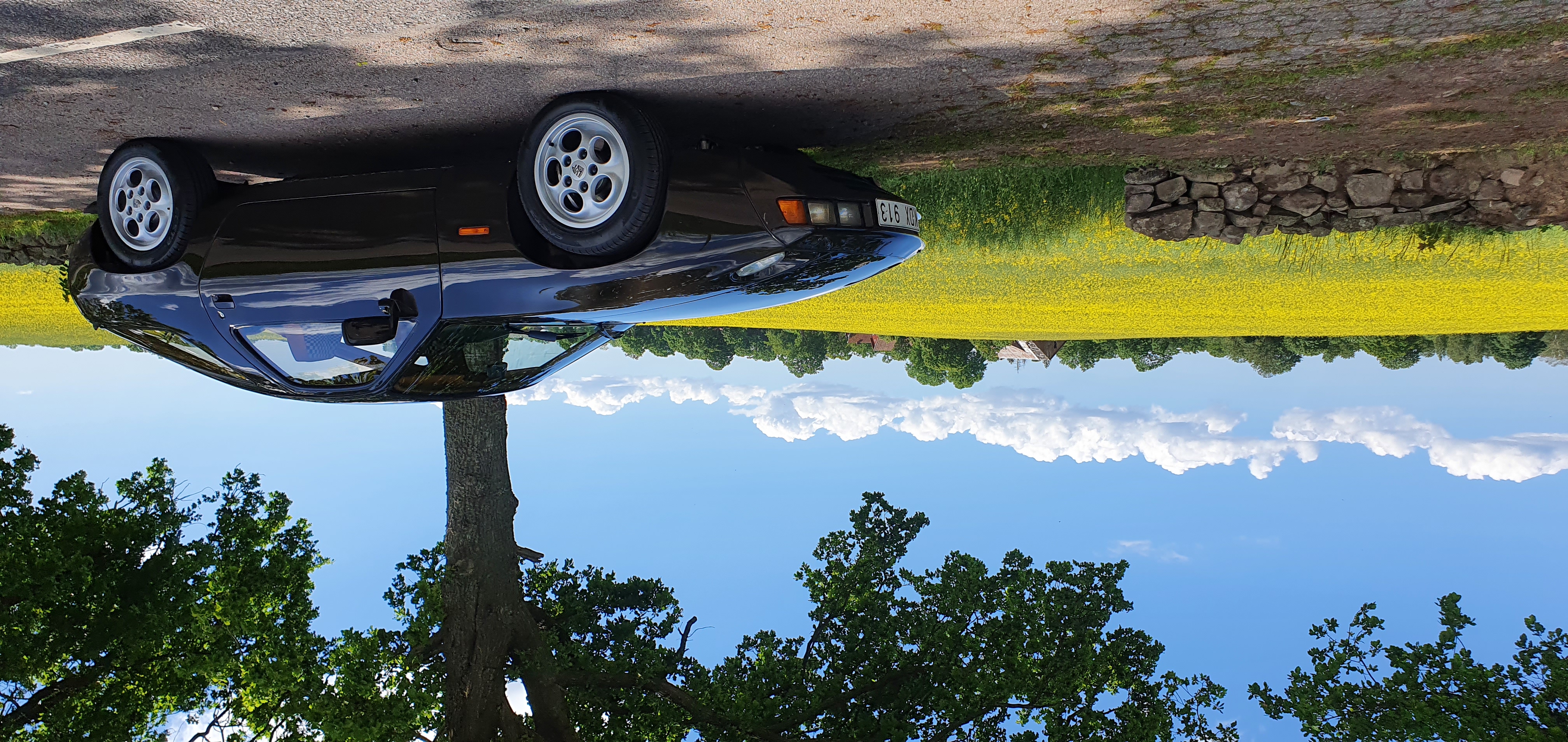

Ok so time for my first testdrive! My 13 yearold son ofcoarse wanted to come and he also wanted to make a video of it. He used his android and made his own fasteners. Next time we will use a gopro so the outside can be shown while driving. Anyhow you get the feeling of it🥳
Also the countryside here in Sweden aint to shabby 🇸🇪🥰

Just spectacular -- I've been waiting to see the whole thing like that, and I love the video with actual sounds. The interior is just so perfect for that car and the paint looks great. Just a great job all around! In honor of your work, I made one of your pictures the icon for the 928 board if that's ok. :)

Tom wrote: Mon Jun 06, 2022 8:48 am Just spectacular -- I've been waiting to see the whole thing like that, and I love the video with actual sounds. The interior is just so perfect for that car and the paint looks great. Just a great job all around! In honor of your work, I made one of your pictures the icon for the 928 board if that's ok. :)
Thanks alot Tom! I am honored that you want to use my car as a icon for the 928 board🙂🤝
I have delibaretely kept pictures of the whole car out of this thread on hold for it to be completed, gets more exiting that way😉
It has been a very enjoyable journey and I have learned alot while working on this car. I still have things on the list "too do" but none are critical and now I just want to enjoy this exceptional piece of engineering that Porsche procuced👏
Today, June 6th is Swedens national day🇸🇪
To celebrate it me and my kids went to a event with "bring your old enginepowered whatever" There were many different cool stuff present including a 993 RS Clubsport and 356 Speedster racecar😀
