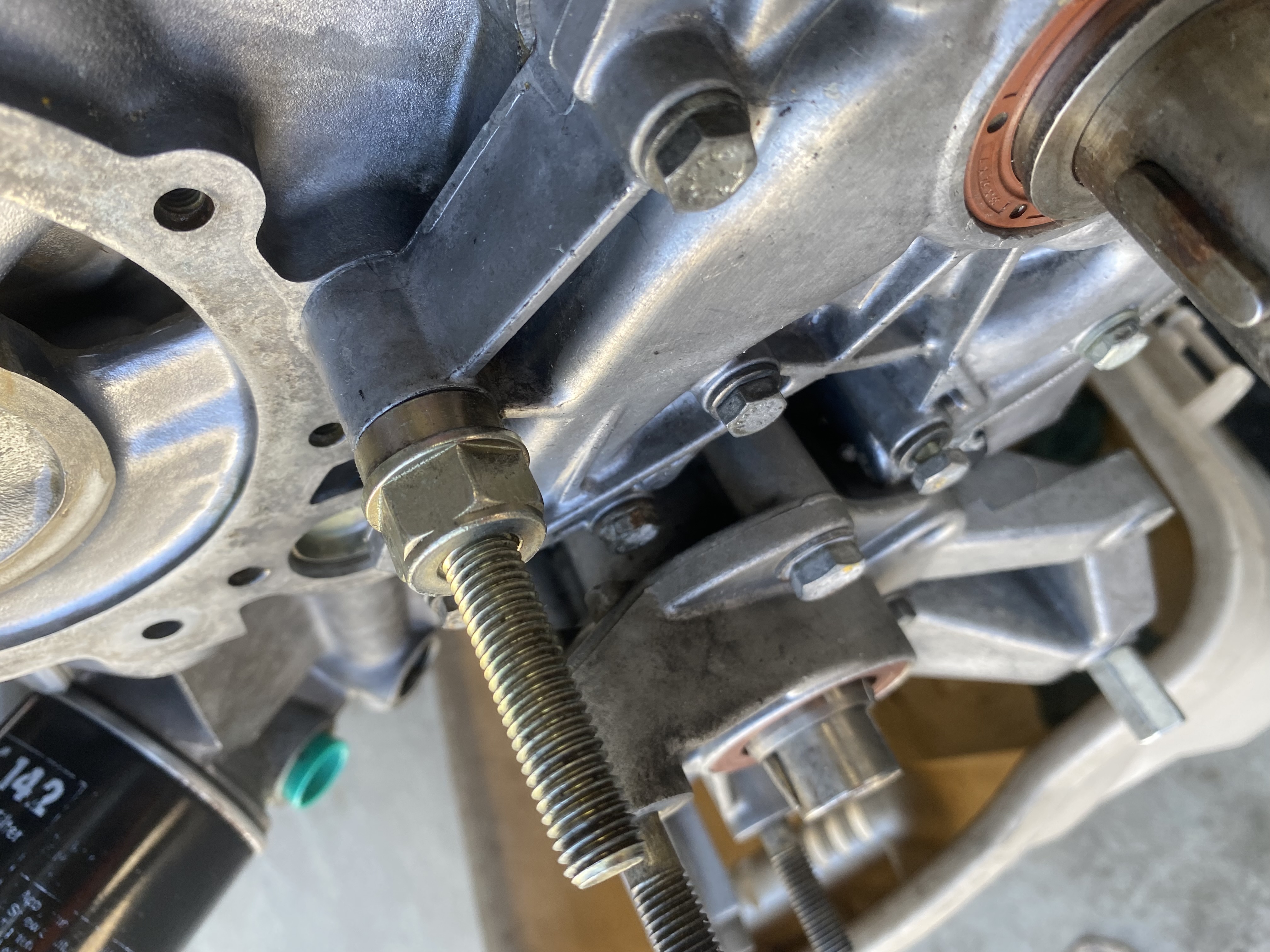

I like it. I've had luck with an impact gun on those too. I like the extra long triple square socket -- is that an off the shelf tool somewhere?
#81
gruhsy
Posts: 534
Has thanked: 48 times
Been thanked: 83 times
Tom wrote: Sat Apr 15, 2023 12:43 pm I like it. I've had luck with an impact gun on those too. I like the extra long triple square socket -- is that an off the shelf tool somewhere?
It’s an SK triple square set.
15.5 in Westward breaker
24 in Canadian Tire Maximum
The Canadian Tire Max have lifetime warranty like SnapOn and I have actually been able to replace them no hassle if they break. 3 items so far.
SnapOn however I have never been able replace because you can’t ever find the SnapOn guy.
I have about 10 items that need replacing and have been broken for 20 years or more.

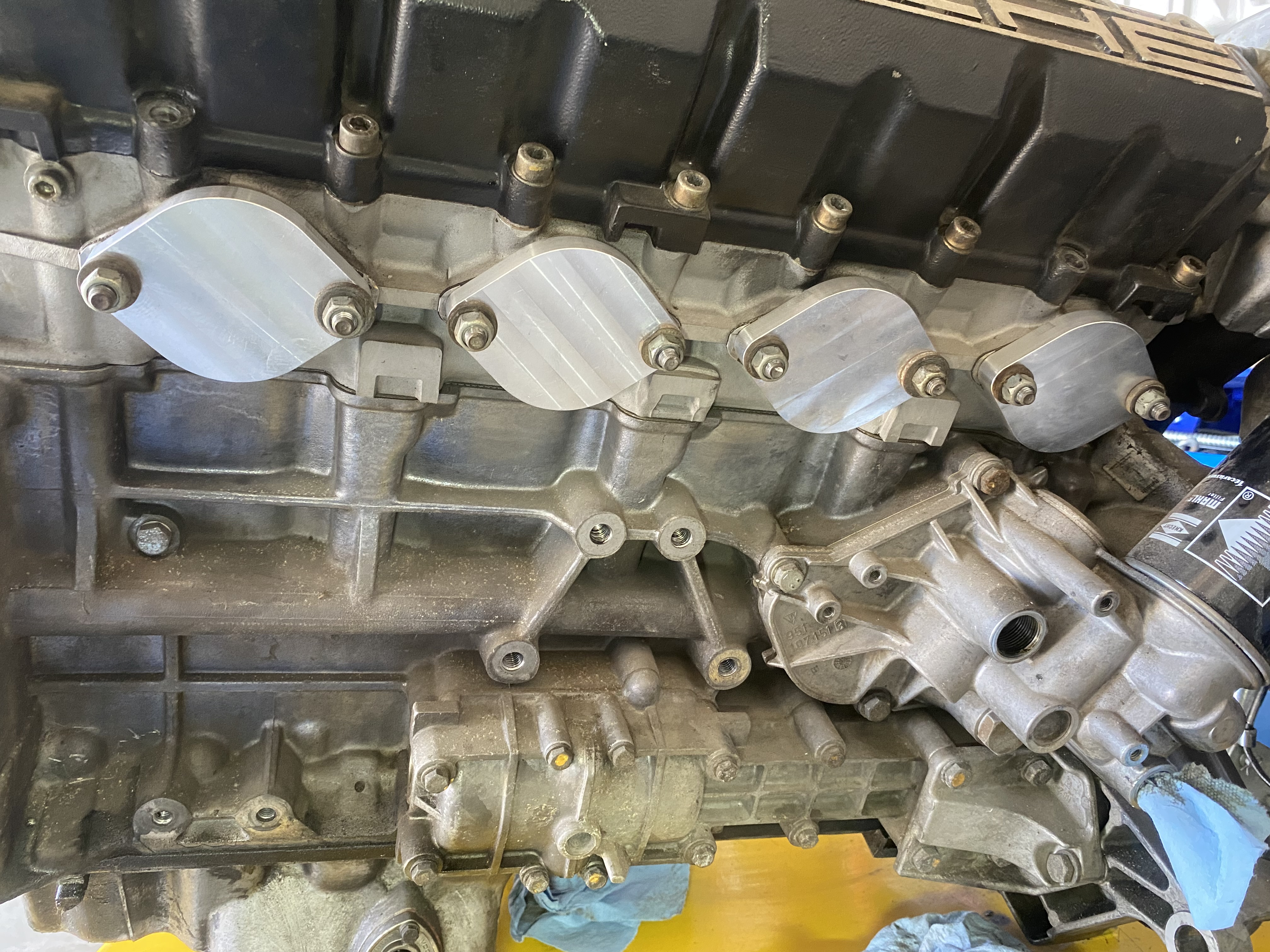

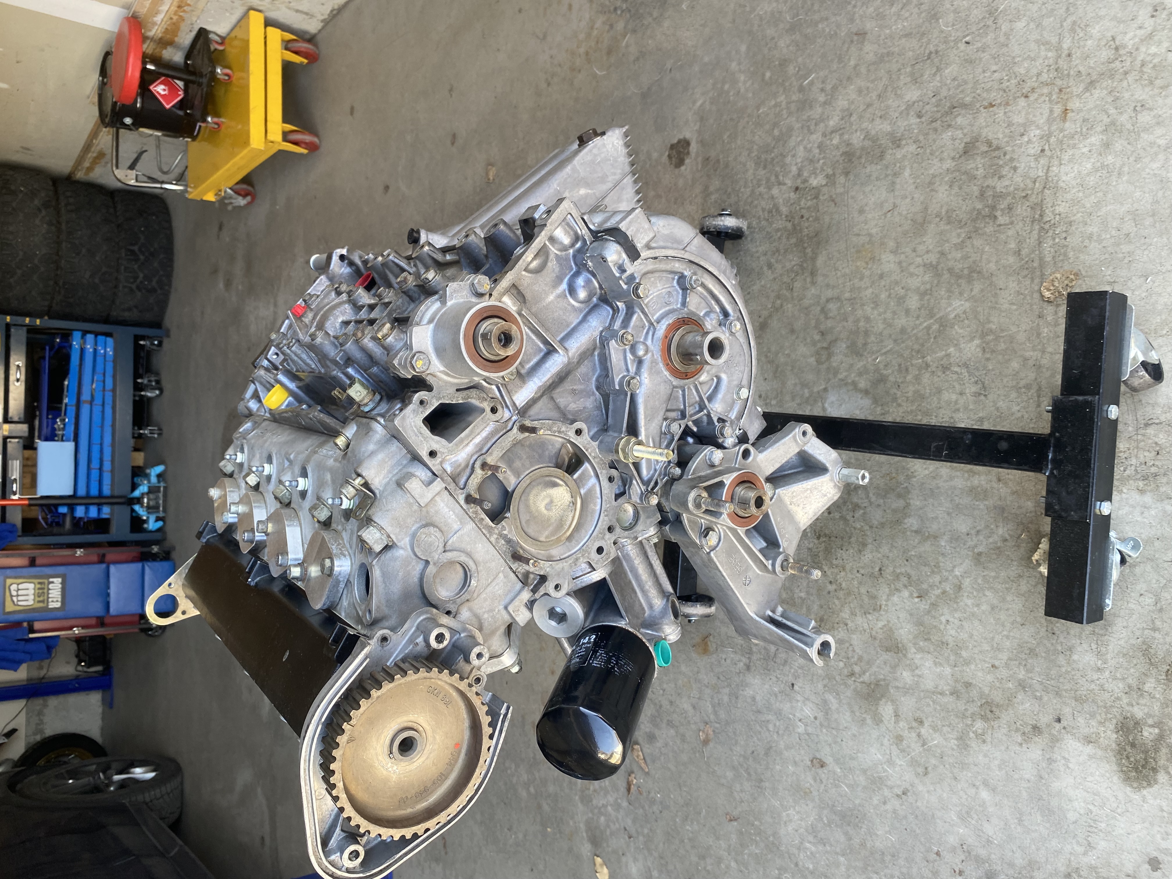

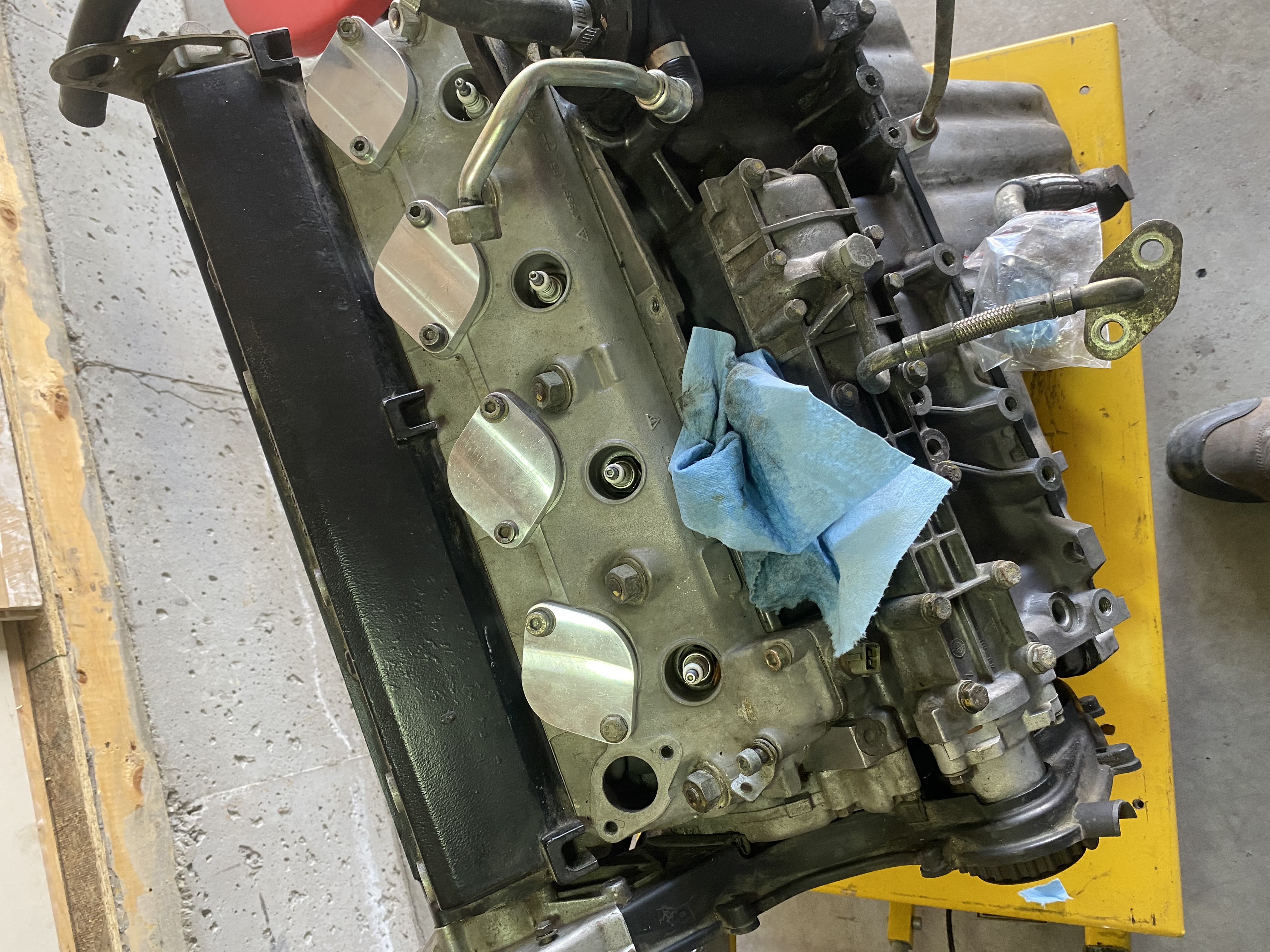

Finally using my block off plates now that I am cleaning the block.

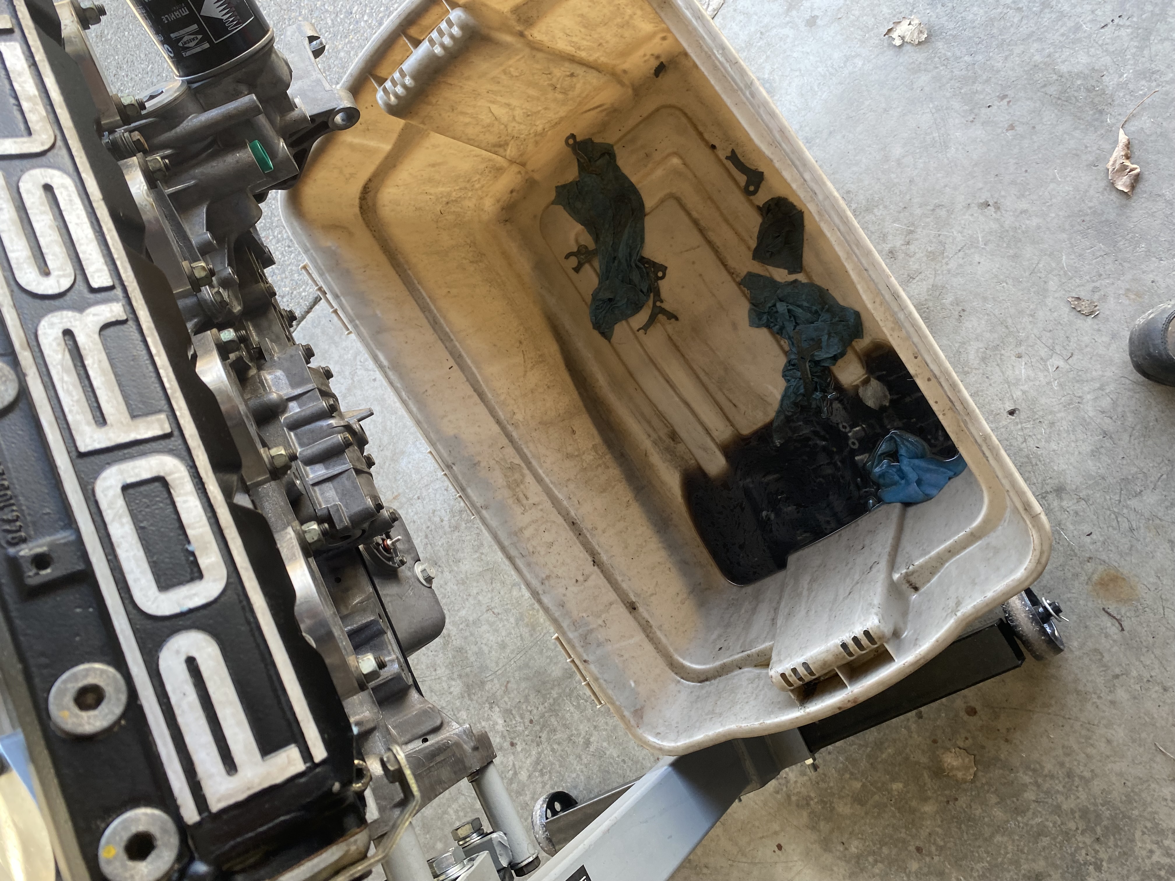

I vote that without a steam pressure washer a 944 951 968 engine are the hardest engines to clean ever🤬🤬🤬🤬🤬

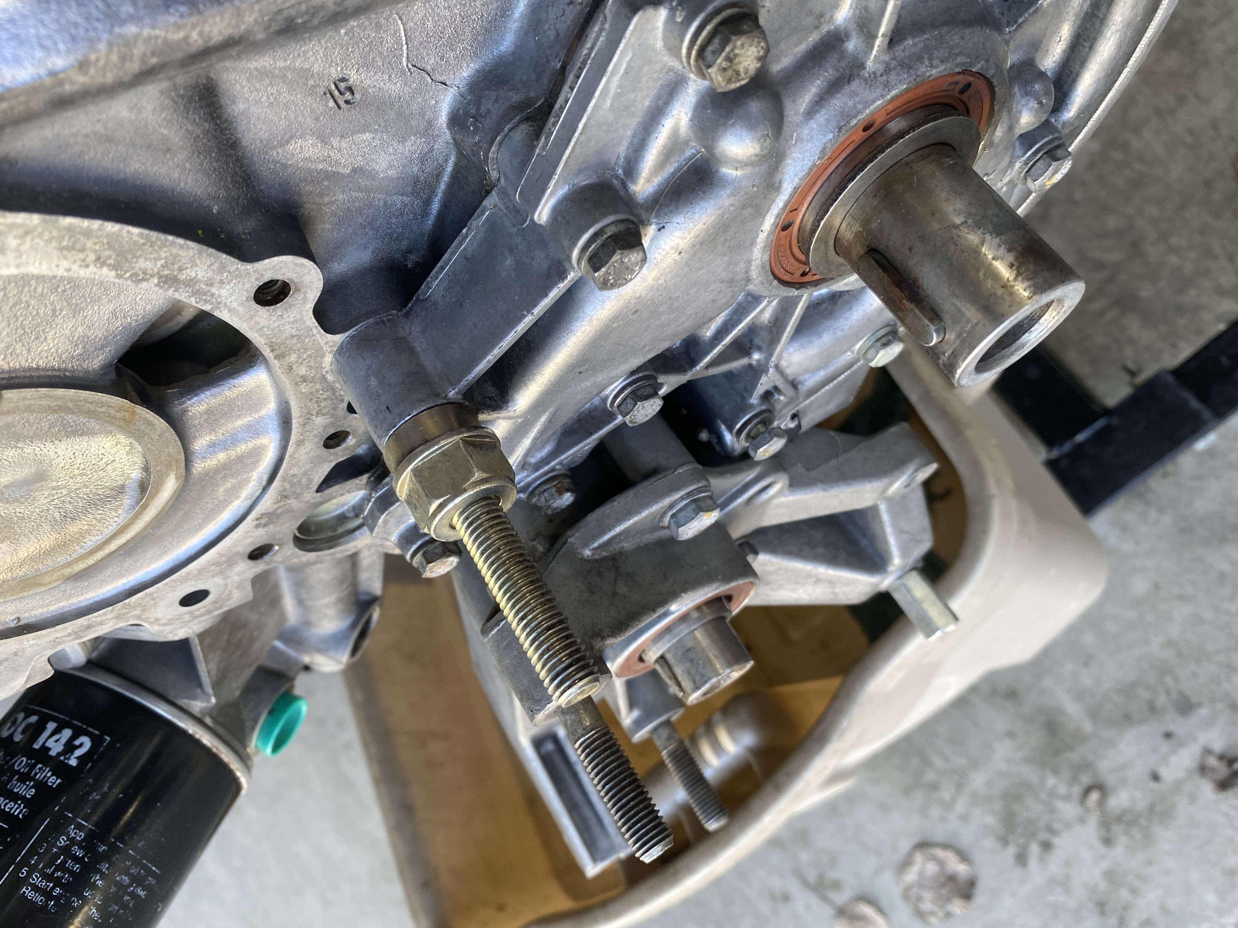

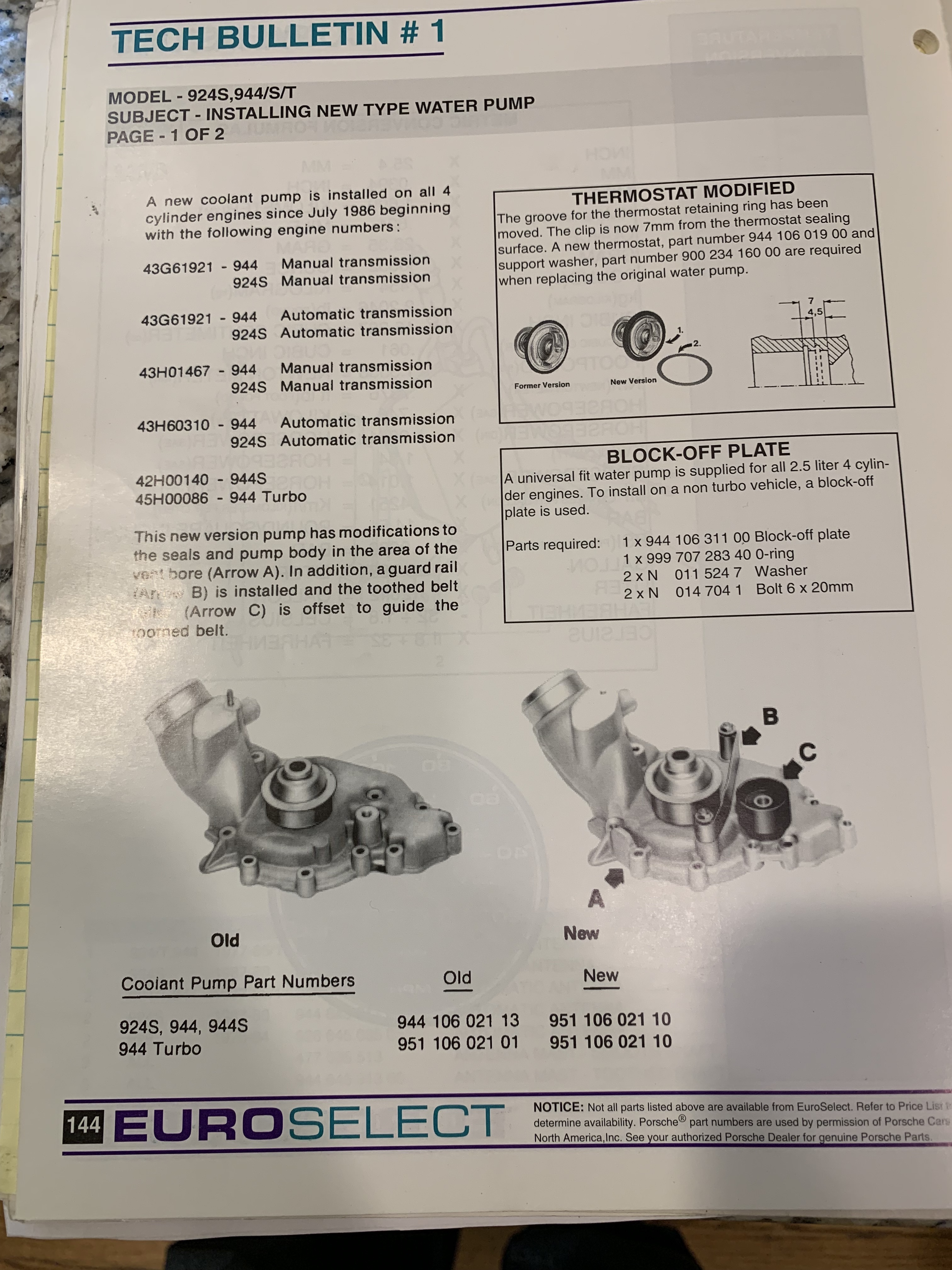

And the famous 86 tensioner tech bulletin mod
#85
Posts: 9095
Been thanked: 4080 times
Wait, what is it? Have a TSB number? I remember struggling to get clarity on that when I built my current motor!
#86
gruhsy
Posts: 534
I will post it when I get home.
I think I have a copy on my computer.
Also I texted Soloracer as he has a hard copy from the Calgary Porsche dealership.
Tom wrote: Sun Apr 30, 2023 8:43 pm Wait, what is it? Have a TSB number? I remember struggling to get clarity on that when I built my current motor!

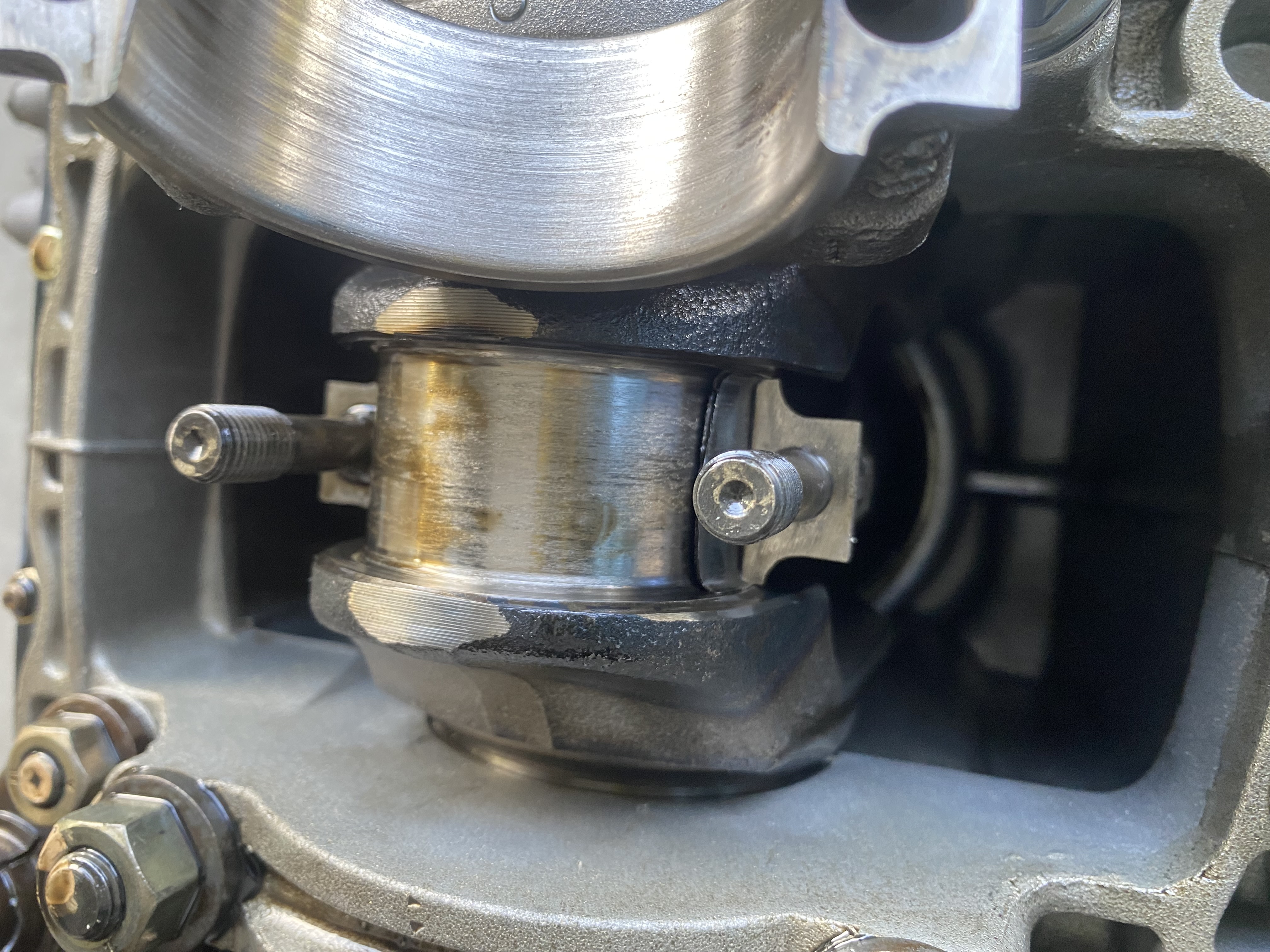

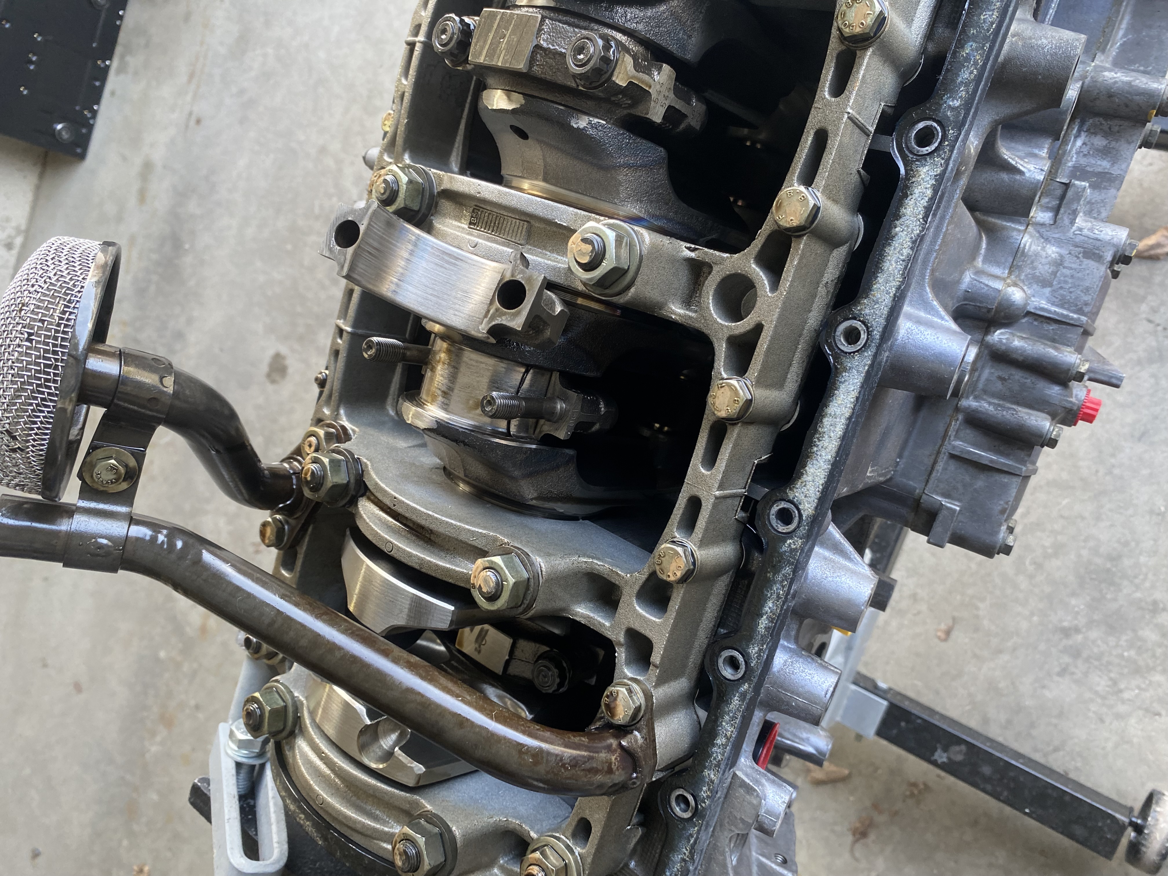

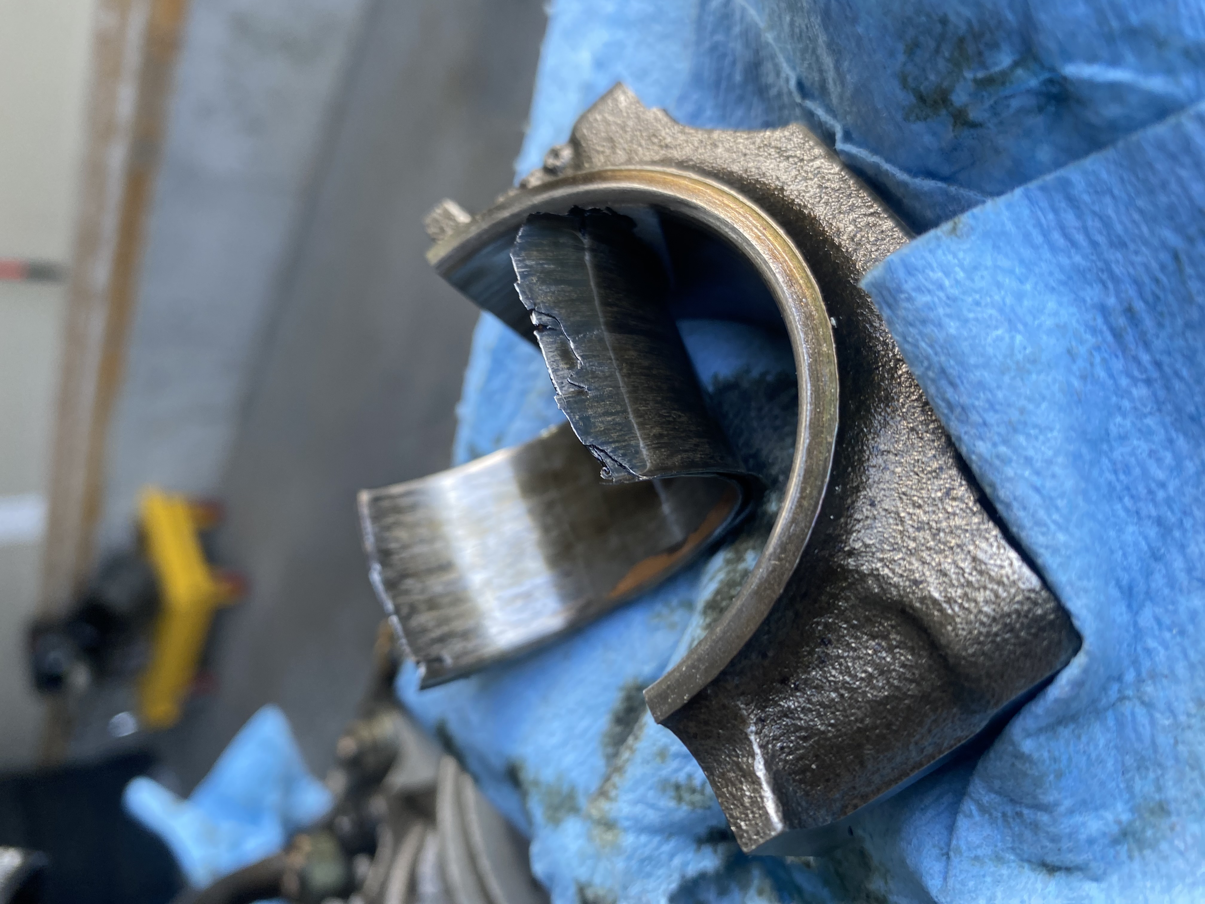

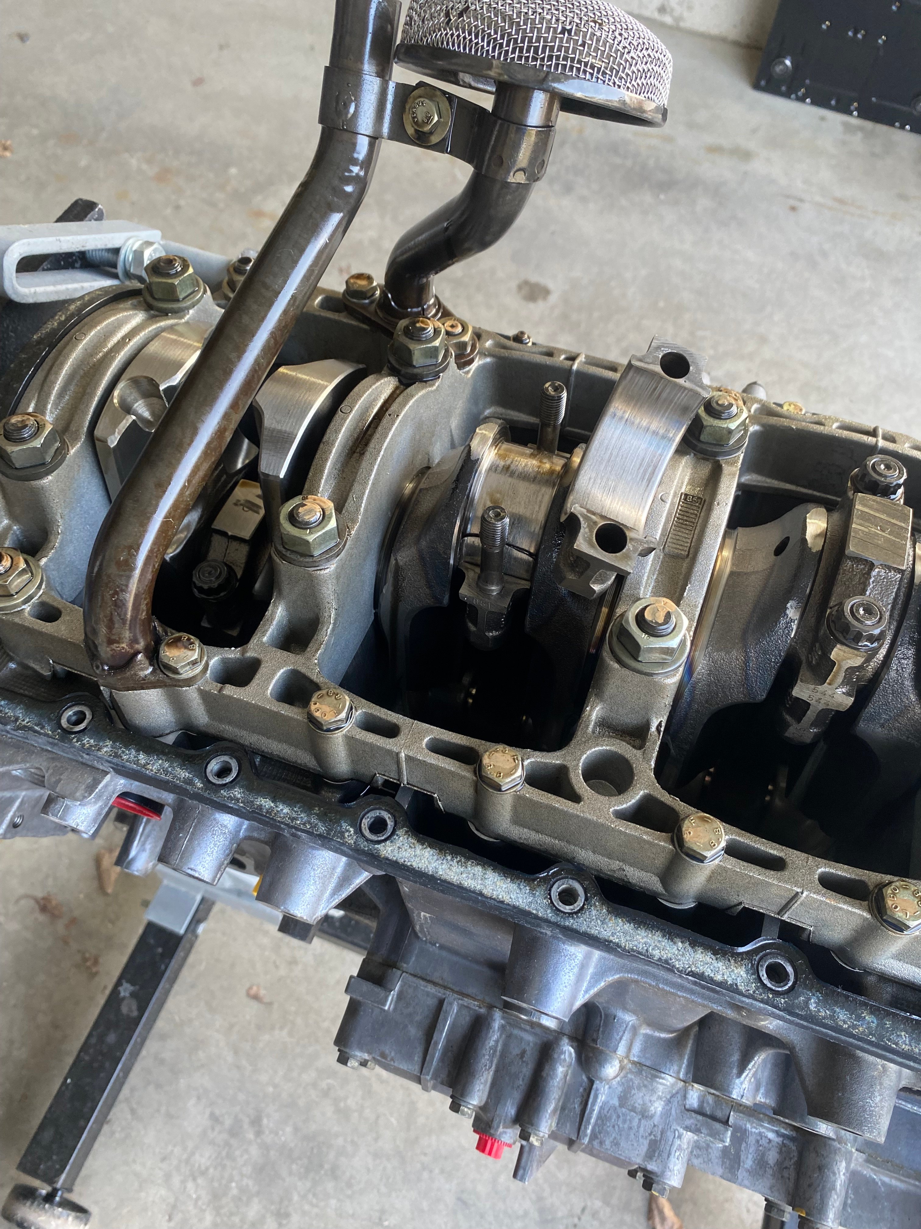

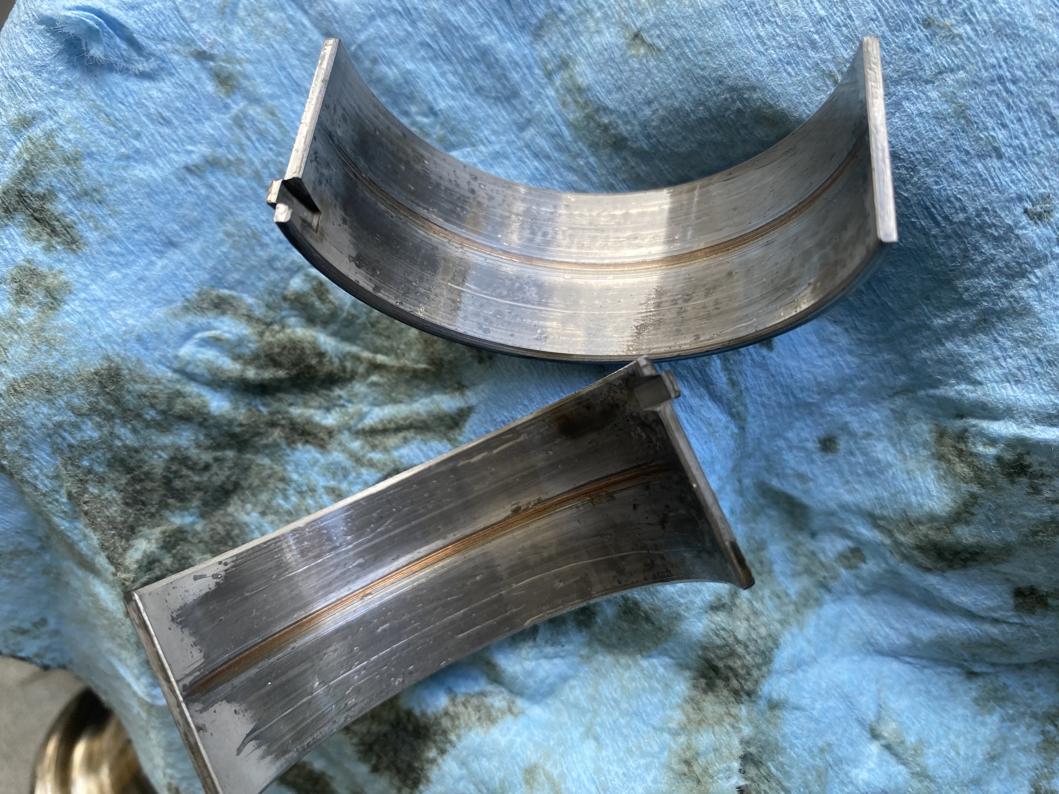

#3 rod bearings high tech machining. Just starve it of oil and the bearings become much lighter. Completely eliminates one shell 🫢🫣🤨😬😆🤮
Very weird crank too???????????????
#88
gruhsy
Posts: 534
#2 bearings kinda f:(:3d

I had the TSB handy:
IMG-2763 copy.jpg (2.09 MiB) Viewed 730 times
IMG-2764 copy.pdf
(12.09 MiB) Downloaded 96 times
