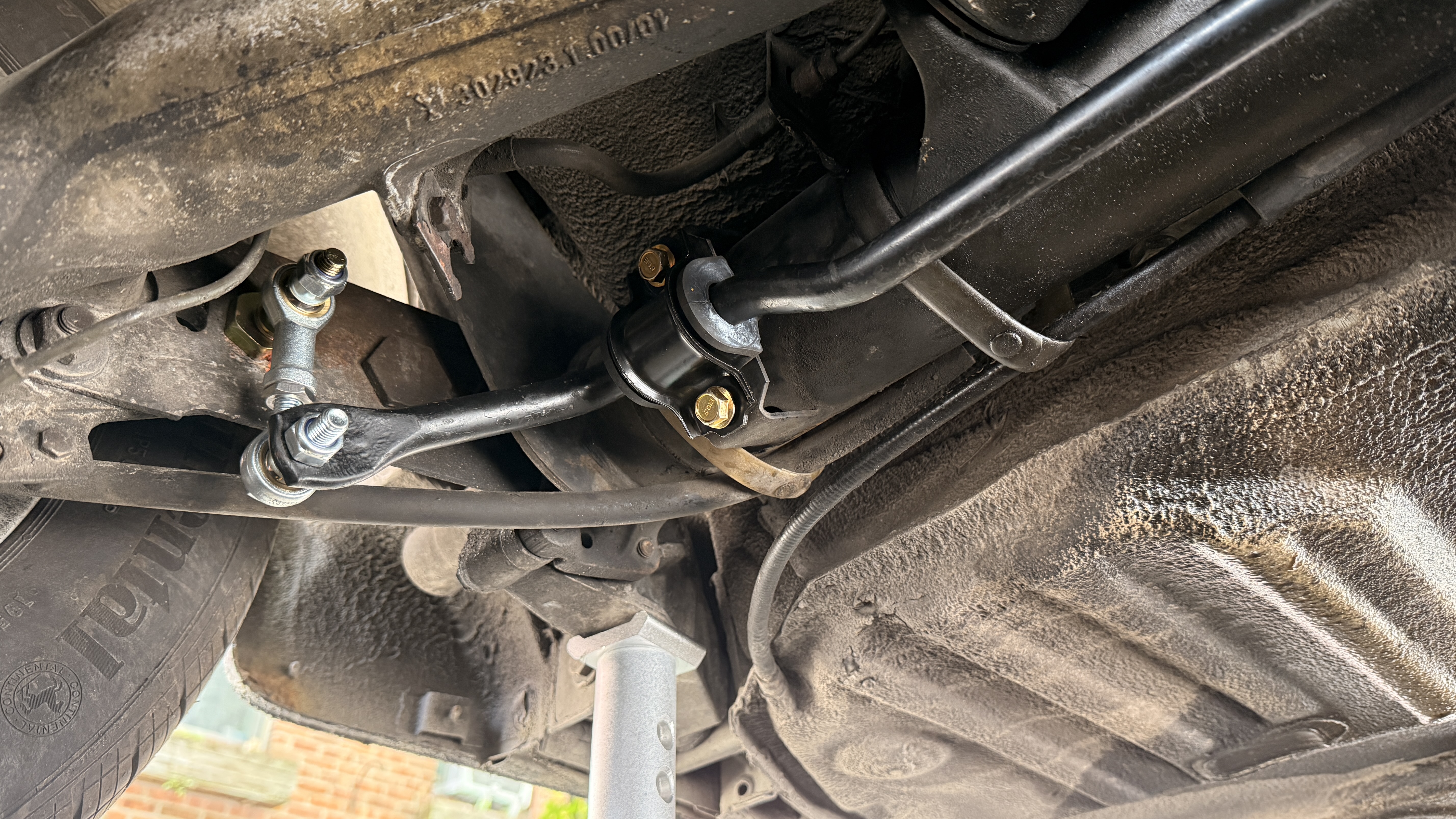

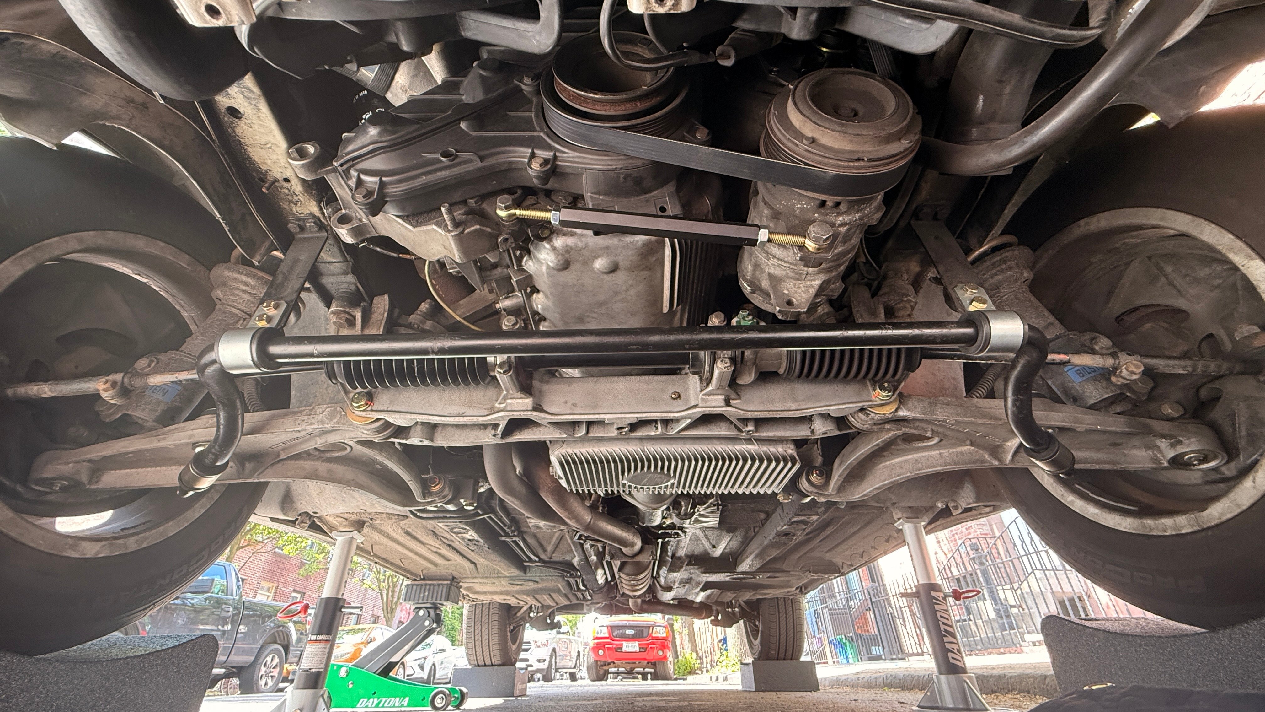

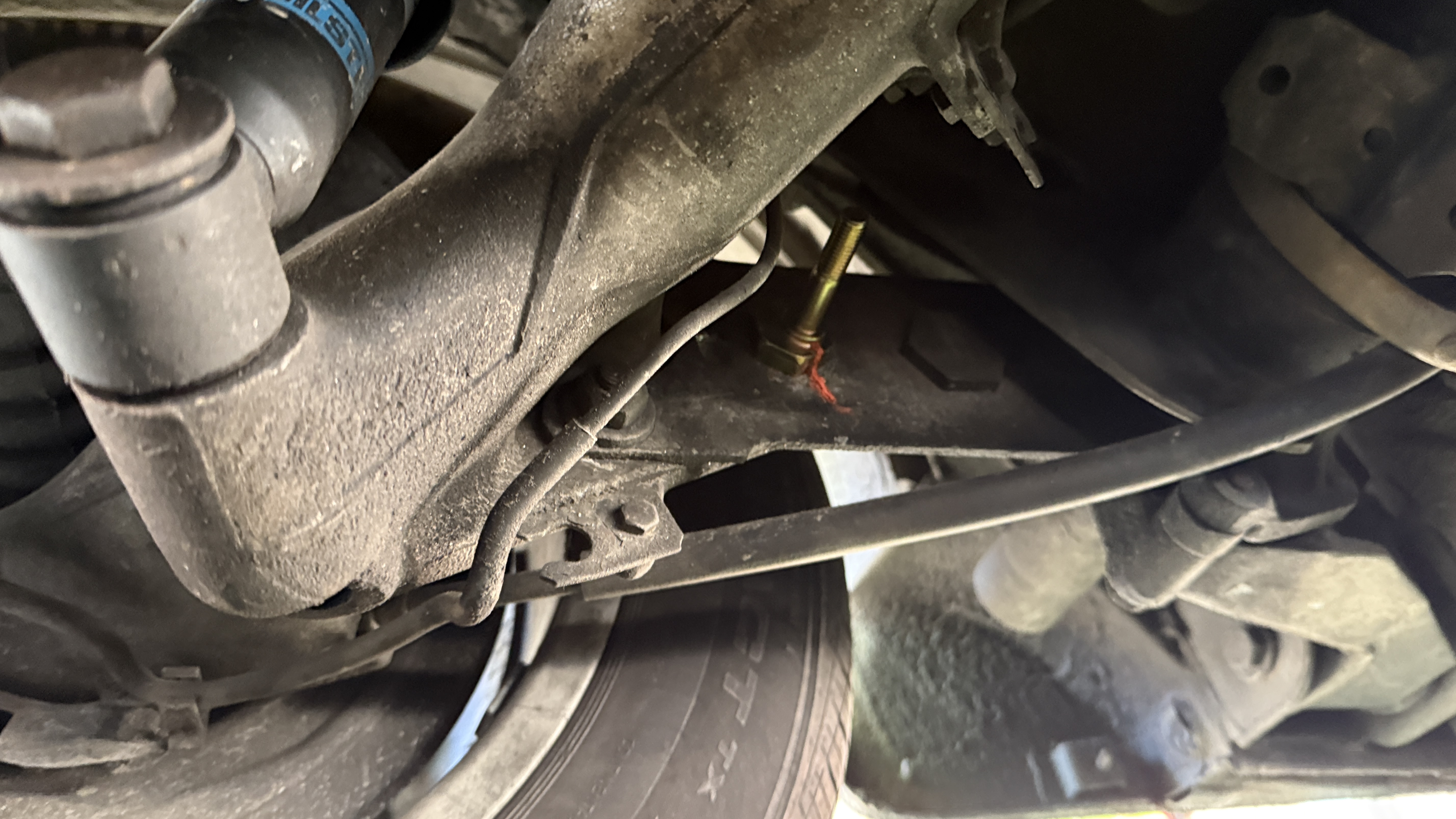

Im still waiting on some parts for the sway bars, but today I swapped the eccentric bolts. Nowhere as bad as I had imagined.
- IMG_2880.jpeg (2.84 MiB) Viewed 309 times
- IMG_2881.jpeg (2.65 MiB) Viewed 309 times

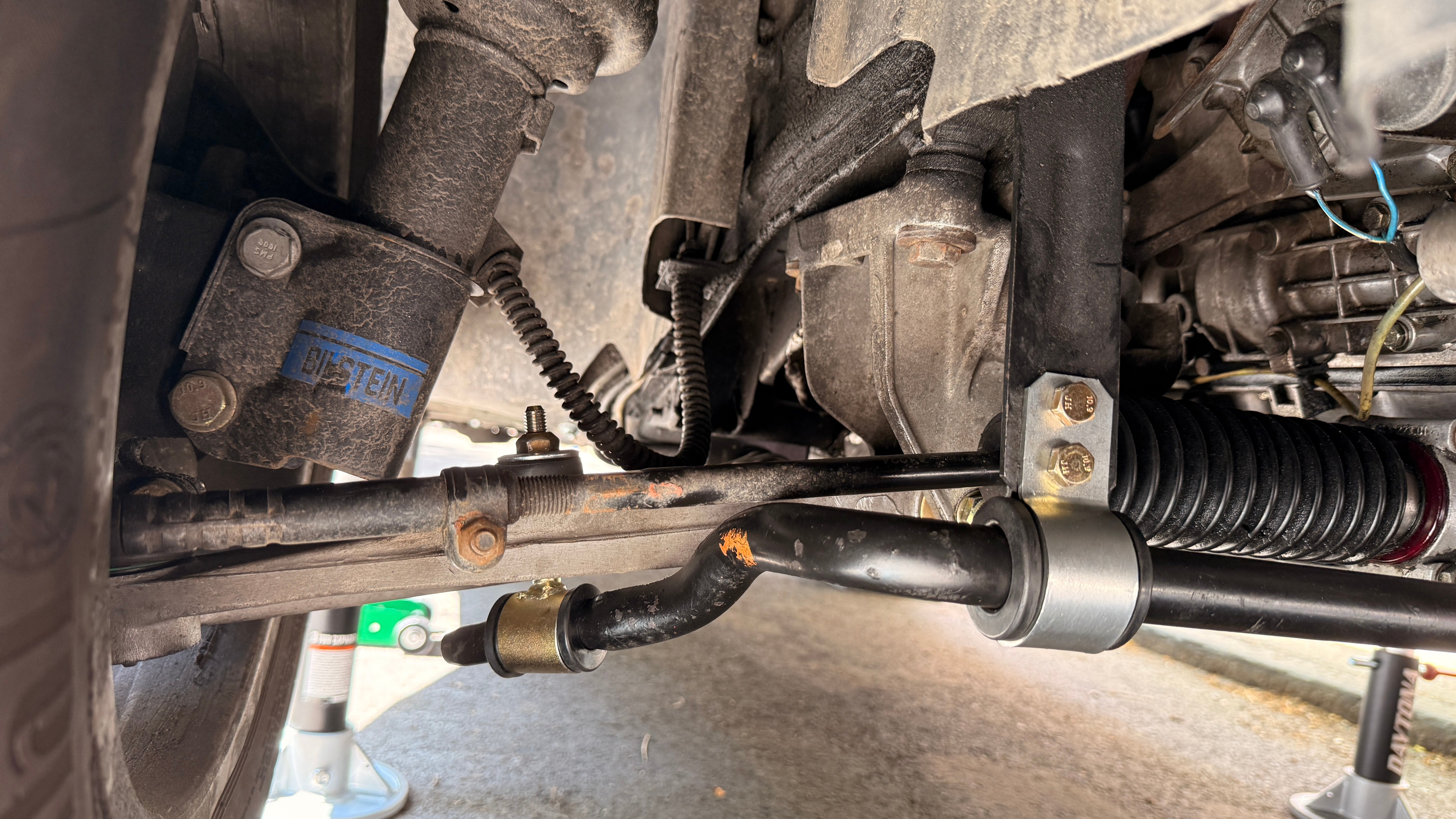

@Gaspowered Sway bars installed.
