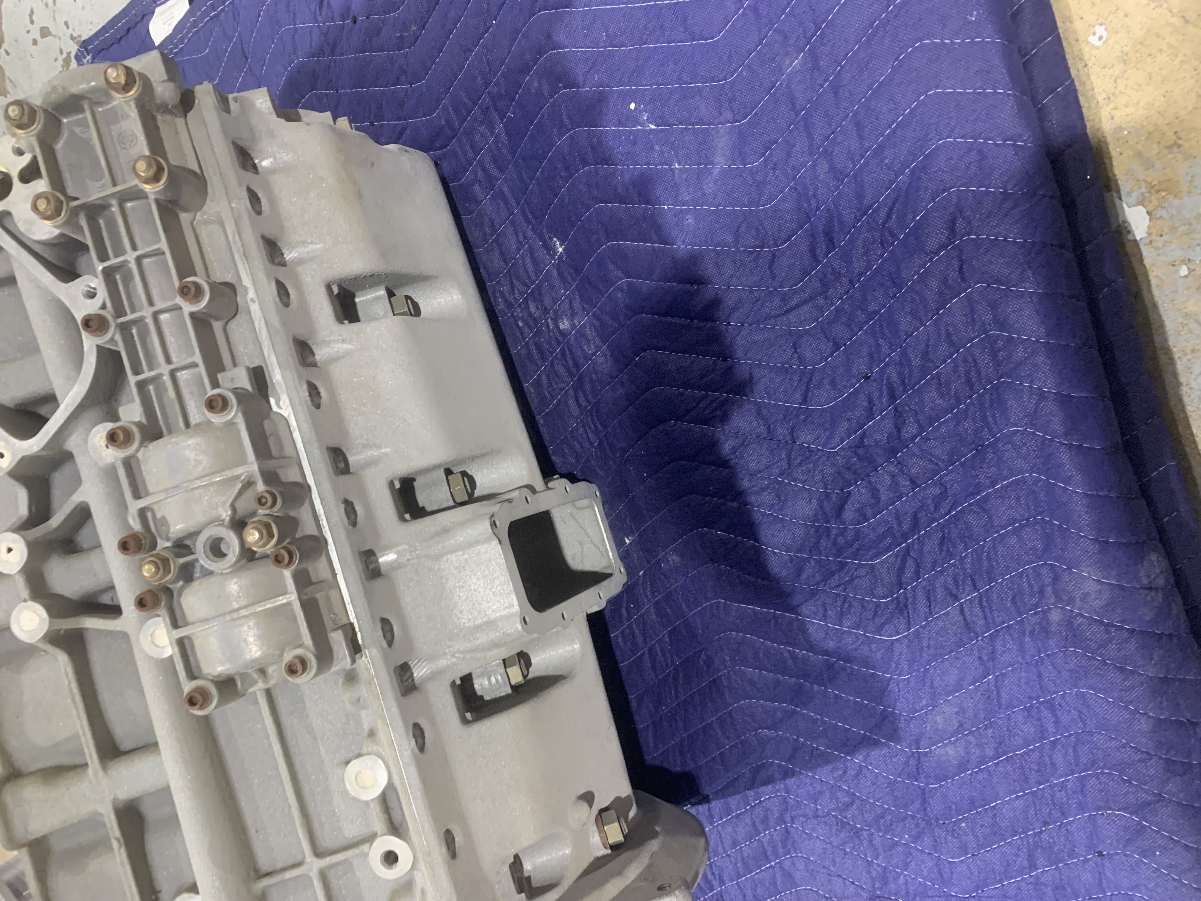

by michaelmount123
Bespoke GTR (only) engine block and cylinder. Porsche put some effort and $ into this project.

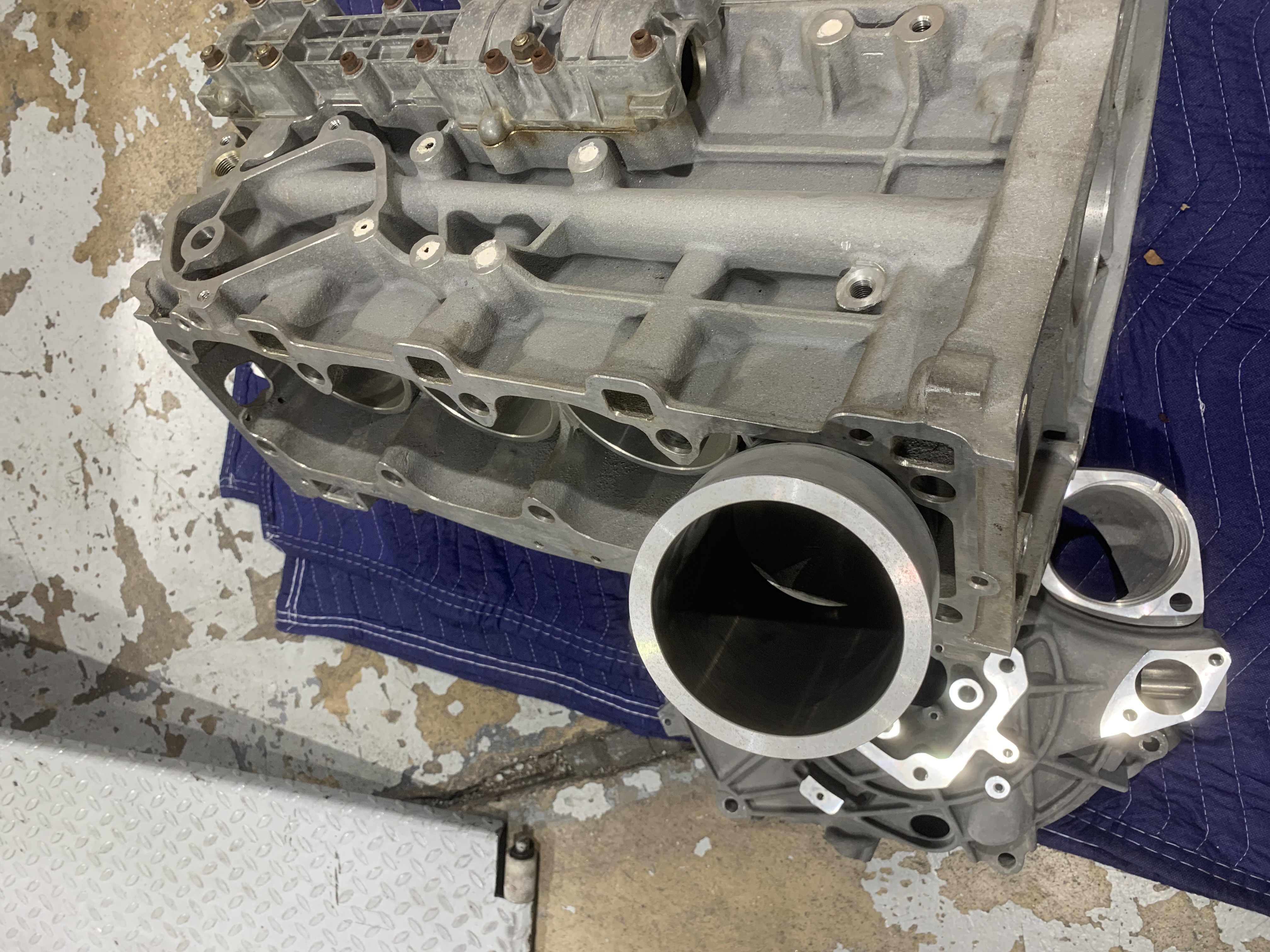

Re: Project status....
Posted: Fri Jun 21, 2024 3:50 pm
by michaelmount123
Tom wrote: Wed Jun 19, 2024 9:36 pm Were the cylinders separate like that from the factory, or are you sleeving it? Fantastic pictures!!!
The photos show a new and untouched factory GTR block and one Nikasil aluminum cylinder. Both are from the spares that were included with the car. The cylinders drop into the lower crankcase and use a cellophane type seal at the bottom. The cylinder head clamps them in place via 14mm head studs. Note that the lower case half is integrated into the oil pan. The 100mm cylinders were manufactured by Mahle, the pistons are Cosworth, and the billet 2.5L crank has the standard 78.9mm stroke. I've brought two cylinder heads back to Maryland, so more pics and flow numbers will follow.
