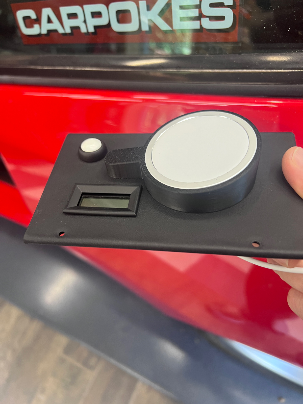

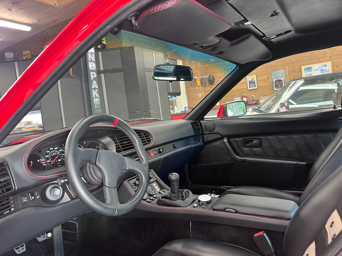

Finally got around to changing the center armrest, and updated the flat panel in front the the armrest to include a Magsafe charger and knock counter. Now I'm starting to wonder if the 968 door panels should be redone too in the same black leather....
