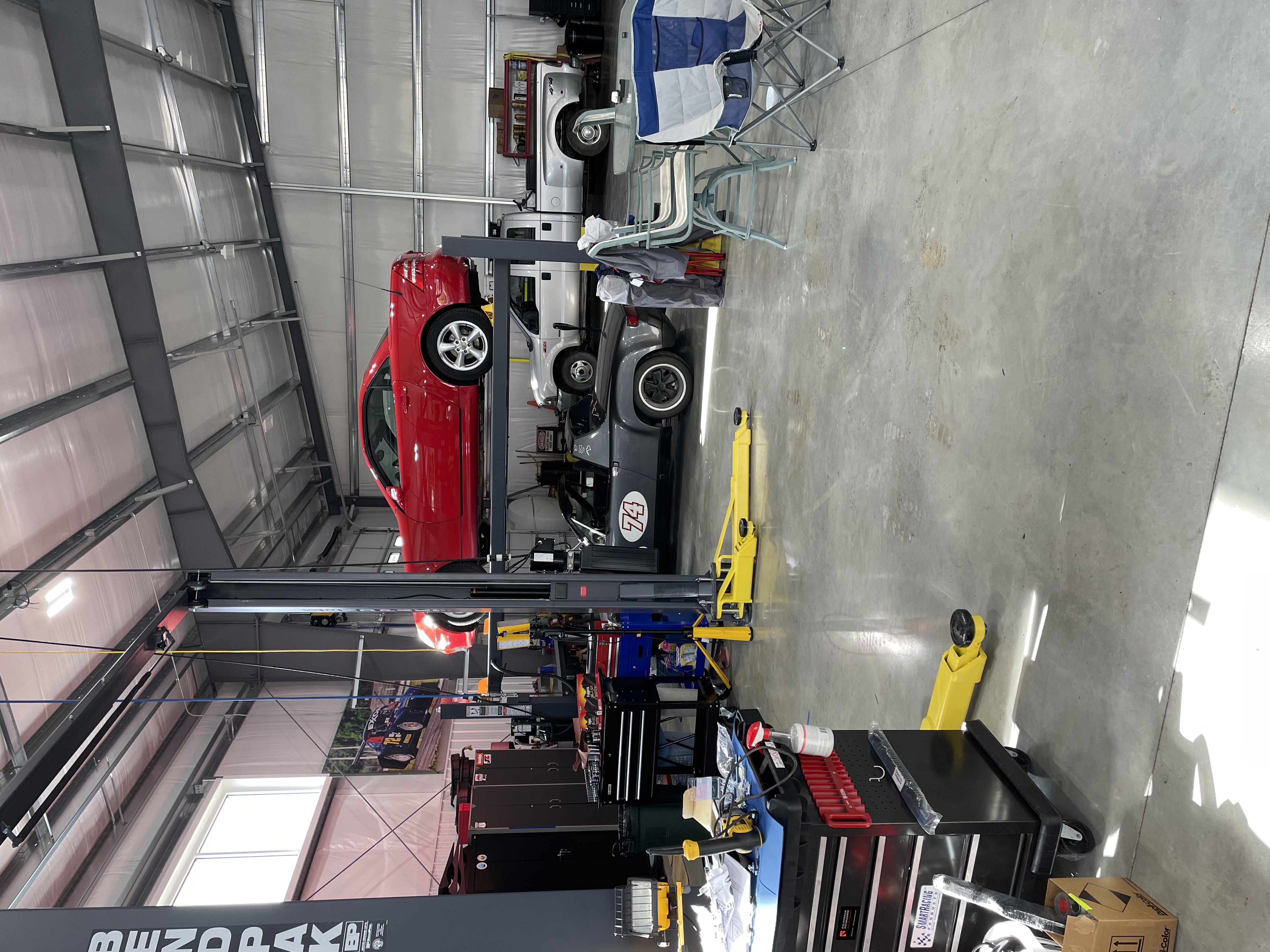

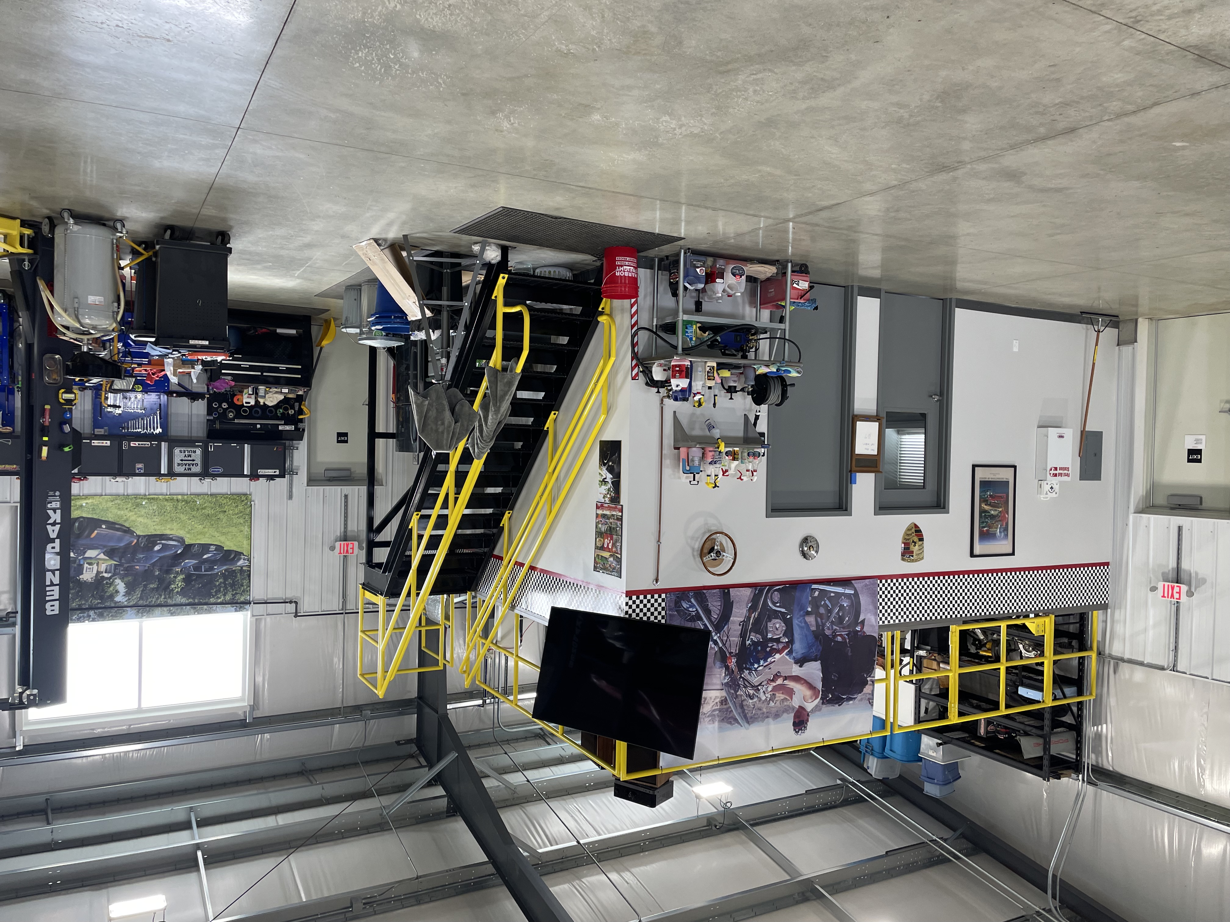

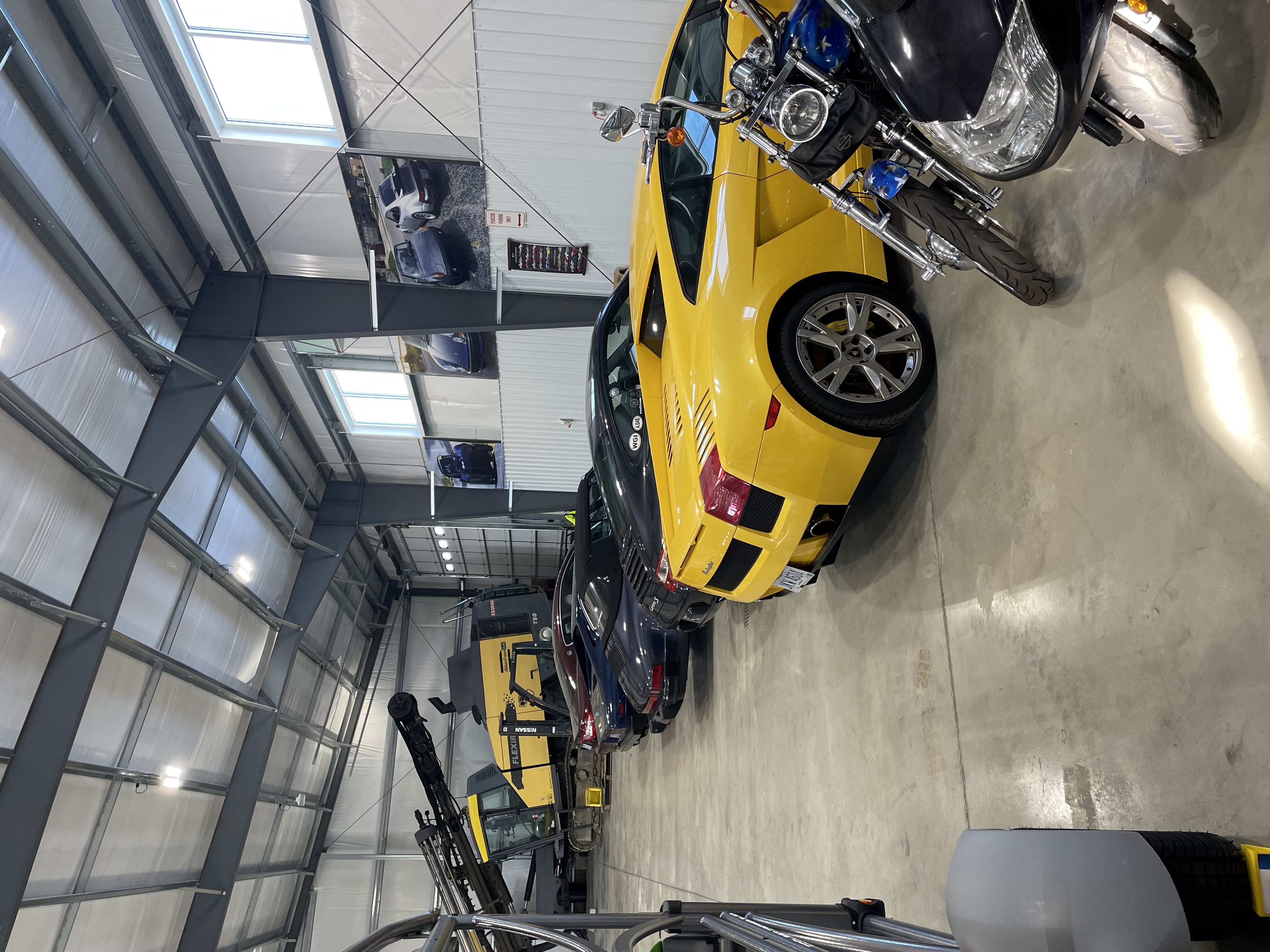

I knew it would be BendPak but couldn't decide on 2 post or 4. Only going to do this once in my life > both. Not easy to see here but I ran electric and air from the overhead between the lifts for projects and separate electric lines for both lifts. The 4 post plugs in and can be unplugged to move. I have a 100' extension cord so I can move it to the other side of the building if I want. Only the HD and the 997 on the other side are mine. I have some good tenants. (Sorry about the MGA. Helping a friend.)

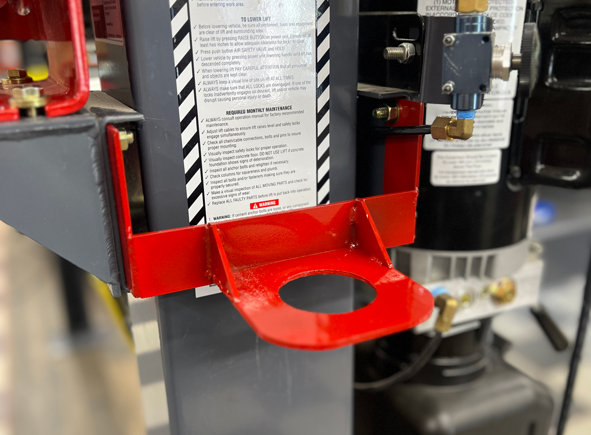

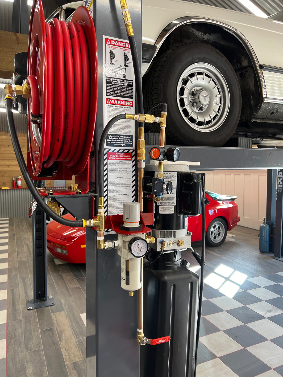

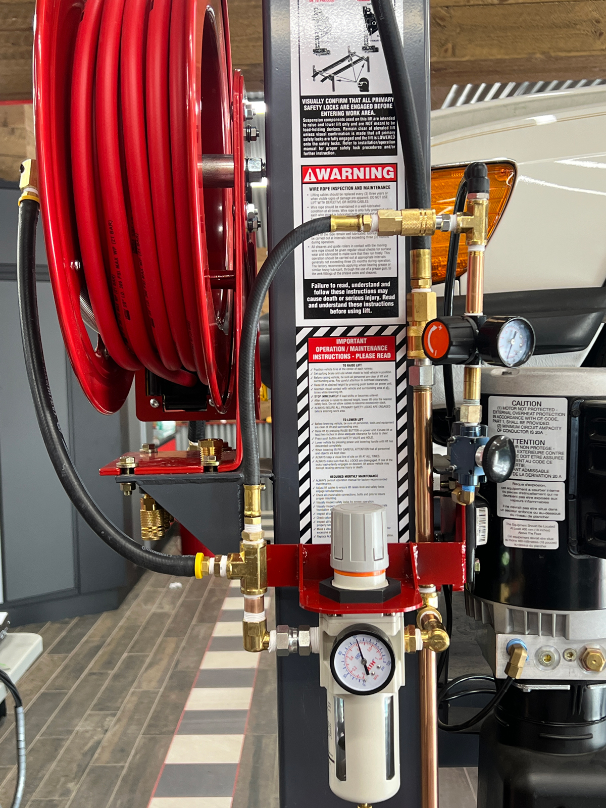

Well, fast forward a few years and it seems hanging the regulator off the reel was a bad idea -- the fitting on the reel snapped in two. After mulling options for fixing it, I concluded that getting a new reel was the practical thing to do. I ended up making a new regulator mount out of 1/8" plate steel, again using the factory brackets on the lift as the anchor points. After powder coating the new bracket red, I realized I had no nut to hold the regulator in the bracket, so ended up 3D-printing one and it worked remarkably well. At that point, all I had to do was order every NPT fitting and hose McMaster sells and try endless configuration until I found one that looked tidy and supplied air to the reel, lift safety locks, and rolling bridge jack. And, yes, I polished the pipes.
