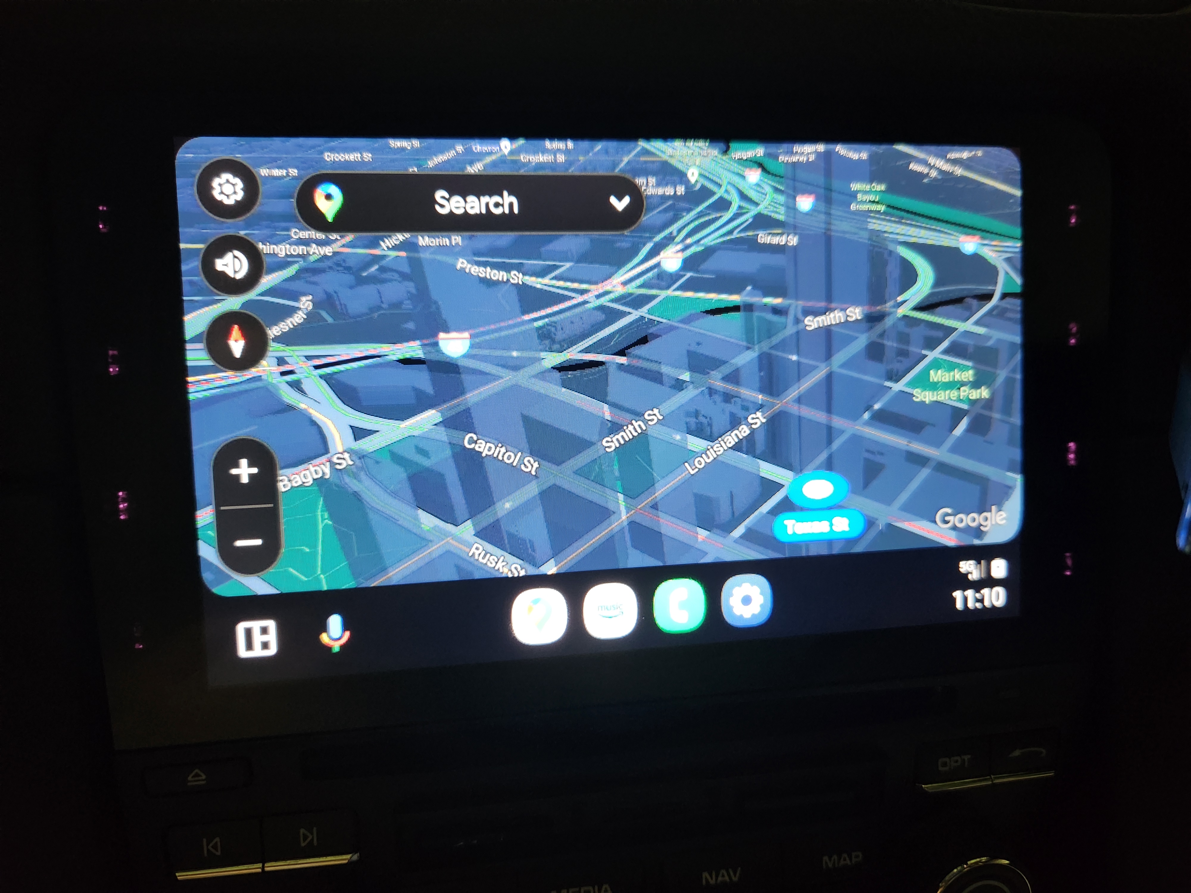

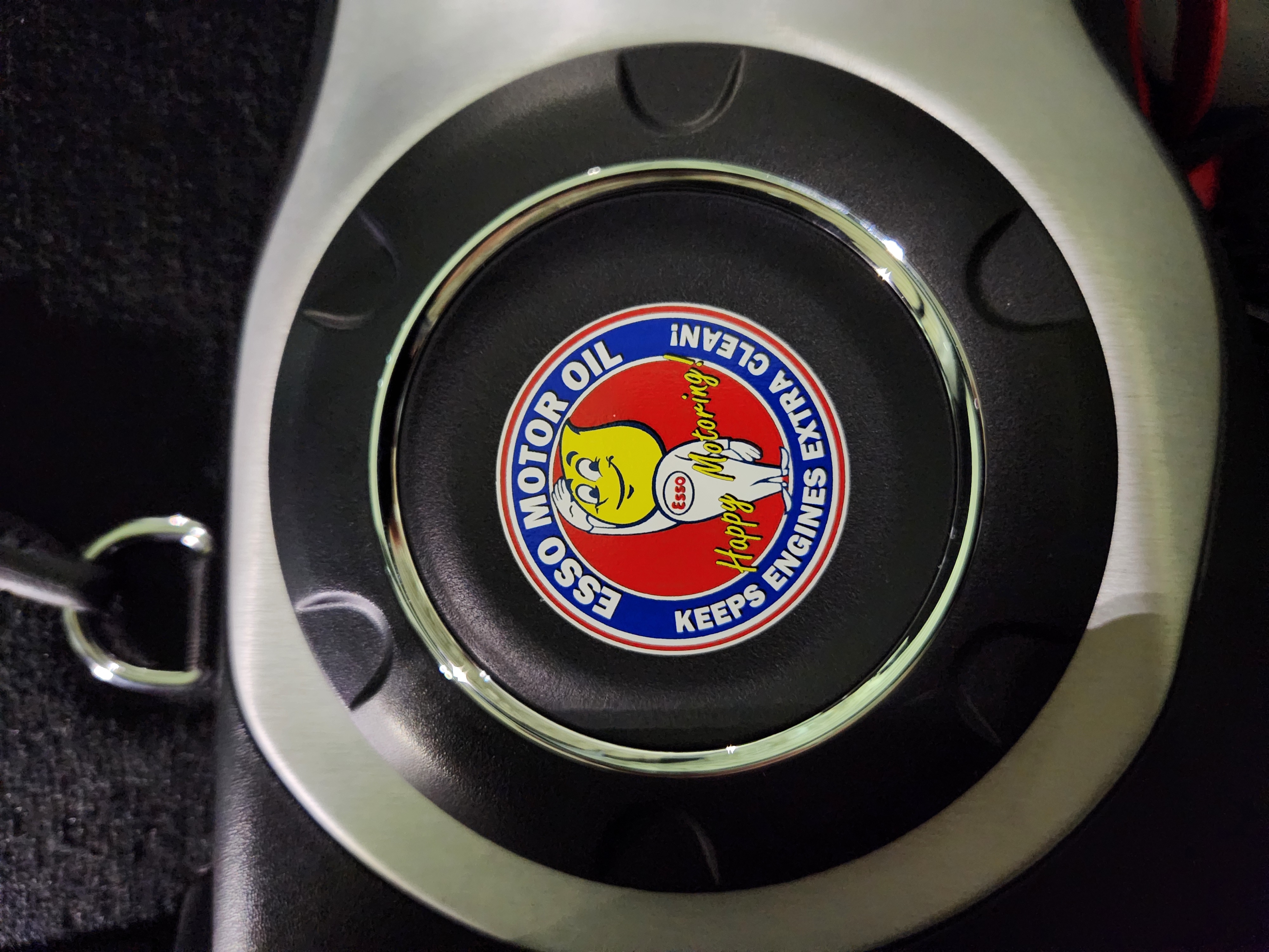

Installed Android Auto and decorated the oil filler cover sentimentally.

ReidMcT wrote: Thu May 23, 2024 1:45 pm Installed Android Auto and decorated the oil filler cover sentimentally.
Making your car your own is what it's all about :thumbup: :clap:

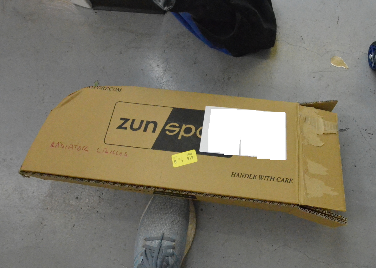

Zunsport box as it arrived. Dinged.
zunsport box
zunsport box

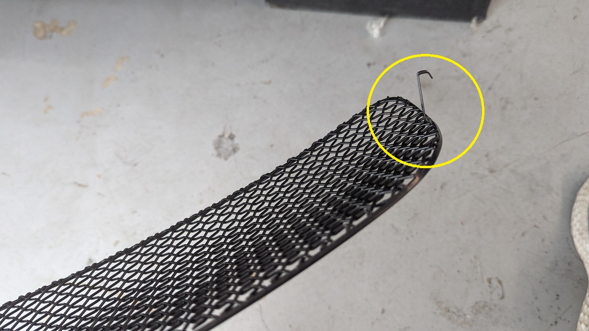

Zunsport uses clips. Other grilles use zip ties or require you to remove the front bumper. Clips looked easier. You need a narrow flat head screw driver to push them into position to clip onto the black radiator trim, and a lot of bright lights to see the clip as you work it.
The Zunsport grilles come with clips on the right and left side. Other grilles from other vendors use zip ties or require you to remove the nose from the car. Clips sounded easier.

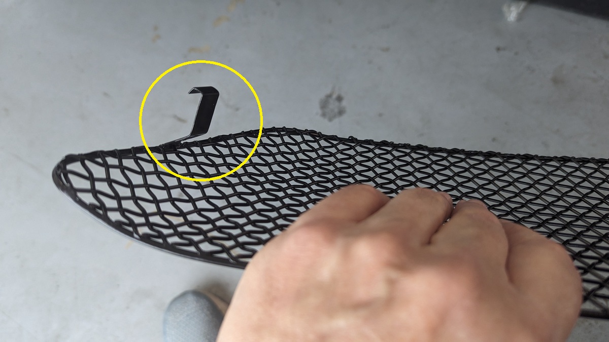

Second clip on the other side of the grille.
The other clip.

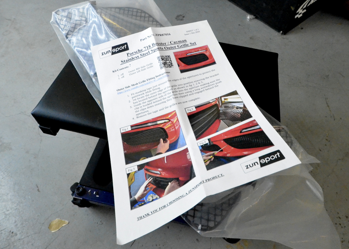

Zunsport instructions. There are several videos online. Watch them. Watch again.

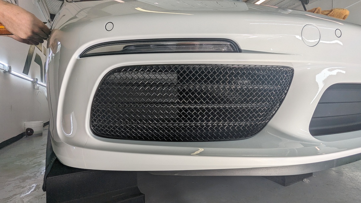

left front grille installed.
Left front done. It took a while. I was N E R V O U S. You need bright lights to see the clips and how they catch the back of the black plastic from Porsche. You also need a narrow flat-head screwdriver that fits between the grid of the grille mesh.
