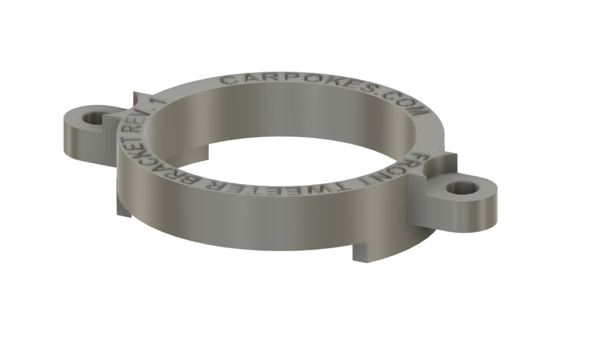

Here is a rendering of the front bracket with the suggested changes. What do you think? I got the strong plastic. Print it?

@Tom looks great! I say print it!Tom wrote: Fri Aug 20, 2021 12:09 pm Here is a rendering of the front bracket with the suggested changes. What do you think? I got the strong plastic. Print it?

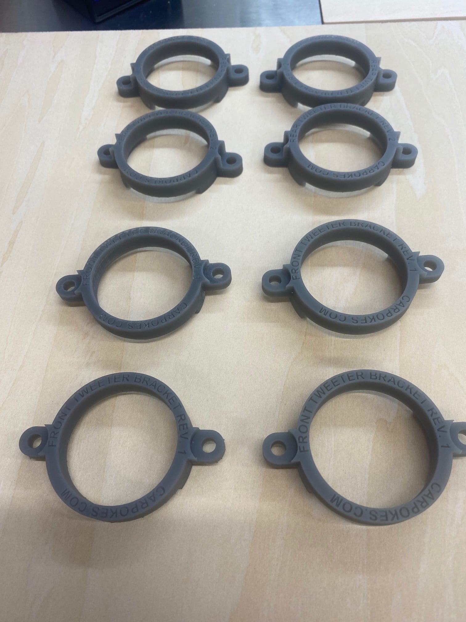

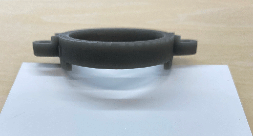

Looks just like the rendering! I did this one in the stronger plastic. I'll print another of these and 2 of the rear version and send them off for the exciting conclusion.

Those look like they will fit perfectly!

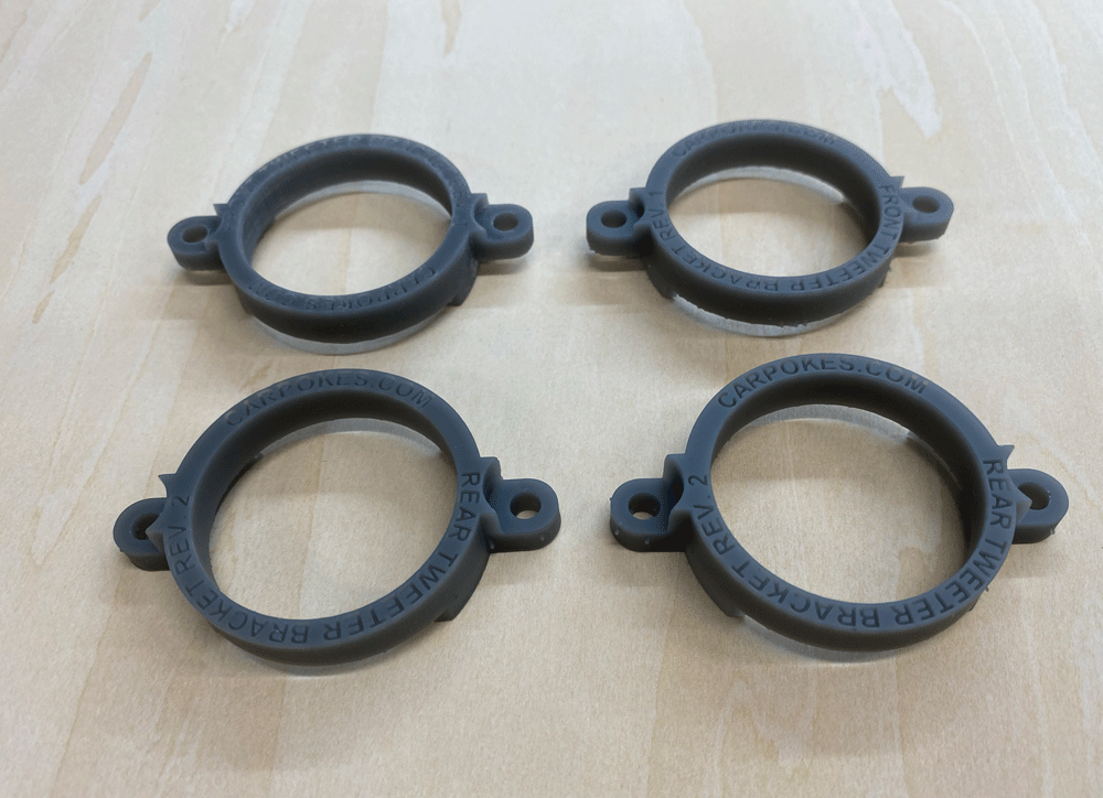

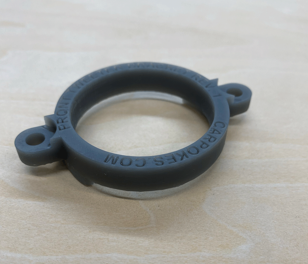

Done! The new plastic (Grey Pro by Formlabs) feels stronger and the brackets seems sharper to me. I'll clean up the support points a bit on these before sending, and I may print an extra one for stress testing.
Once Darwin confirms the fit, I'll post the STL's for anyone who might want them. 3D-printing is a great tool for keeping old cars on the road!

Tom, those look absolutely fantastic! Can't wait to get them and try them out! I also agree that you can tell the difference between the two plastics.

Darwin, I got caught up obsessing on the print quality and learning new tricks on the Formlabs printer. I didn't like some of the pock marks in my first batch, so redid them using new tricks and must say they rival molded parts.
I'll get all 8 out in tomorrow's mail.
