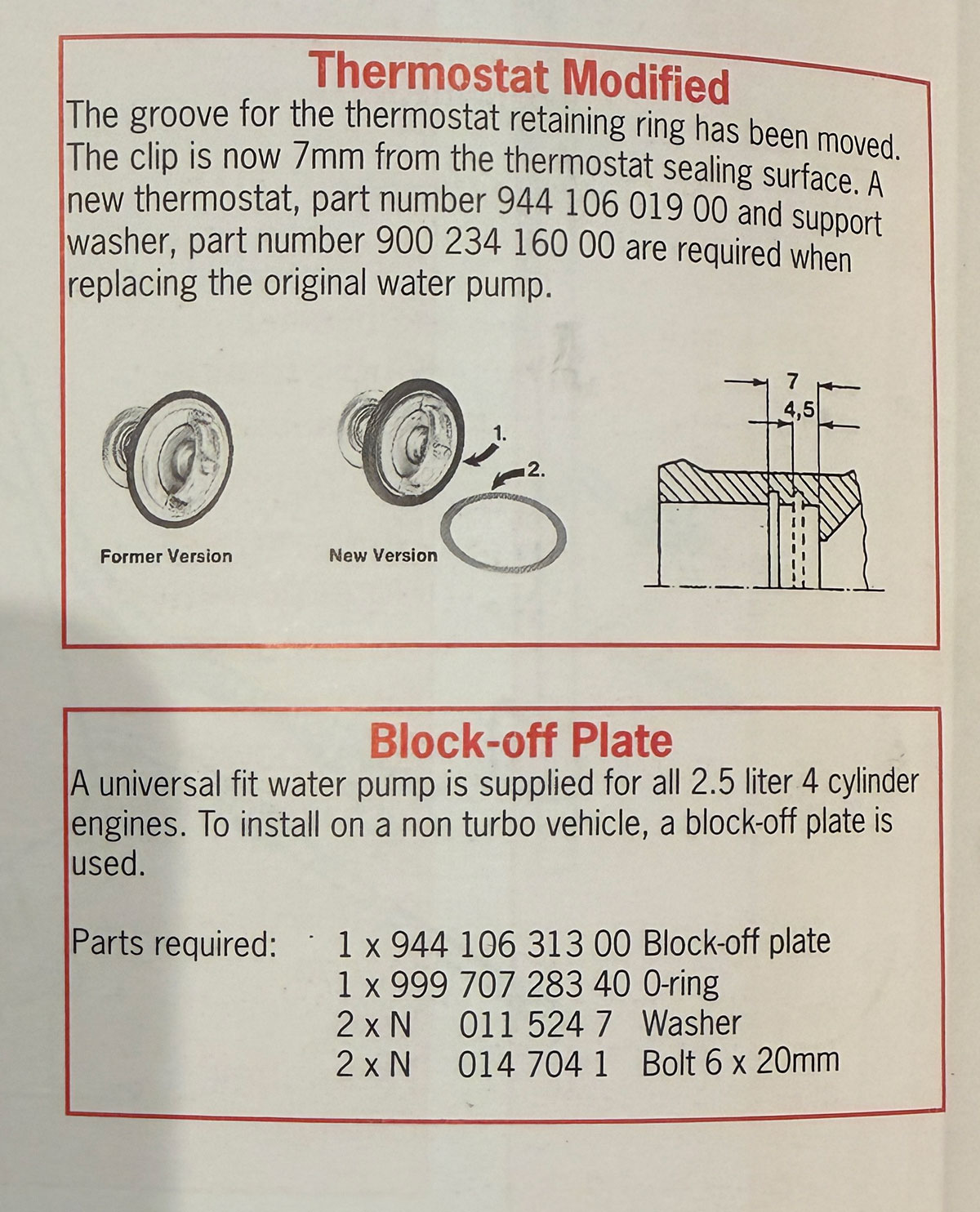

Trying to figure out which thermostat to buy based on the water pump I have, and I could use some help. I have a uro 944.106.021.22 “new” style non-turbo water pump. If I refer to my PET I find the thermostat listed for my car is 944 106 129 05. When I look that number up on pelican parts, there’s a note that says “For all models with updated water pump, (Turbo Style), use thermostat # 944 106 019 00.” My car has an “updated” pump, but it is the non turbo model. the paragon parts page that I bought it from says it’s a non turbo model, which I would assume is correct because I do not have the block off plate. The thermostat PN I have had installed in the car for the past year is the 944-106-019-00-M2. I wonder if I’m not getting coolant to the radiator because the thermostat is faulty, or because it was the wrong one for my style of water pump.

Sorry, it took me a while to find this. I thought it was an official TSB, but it was actually a Tech Bulletin in the back of the old printed spare parts catalog. If you measure the groove in the throat of your water pump, you can confirm if it is the new style, needing the parts listed below. There is a groove in the throat and a lip that the thermostat sits against. I just confirmed on a new style pump that the 7mm is the distance between that lip and the top of the the groove. I'd be quite surprised if you have the old style pump, but this way you can confirm.
