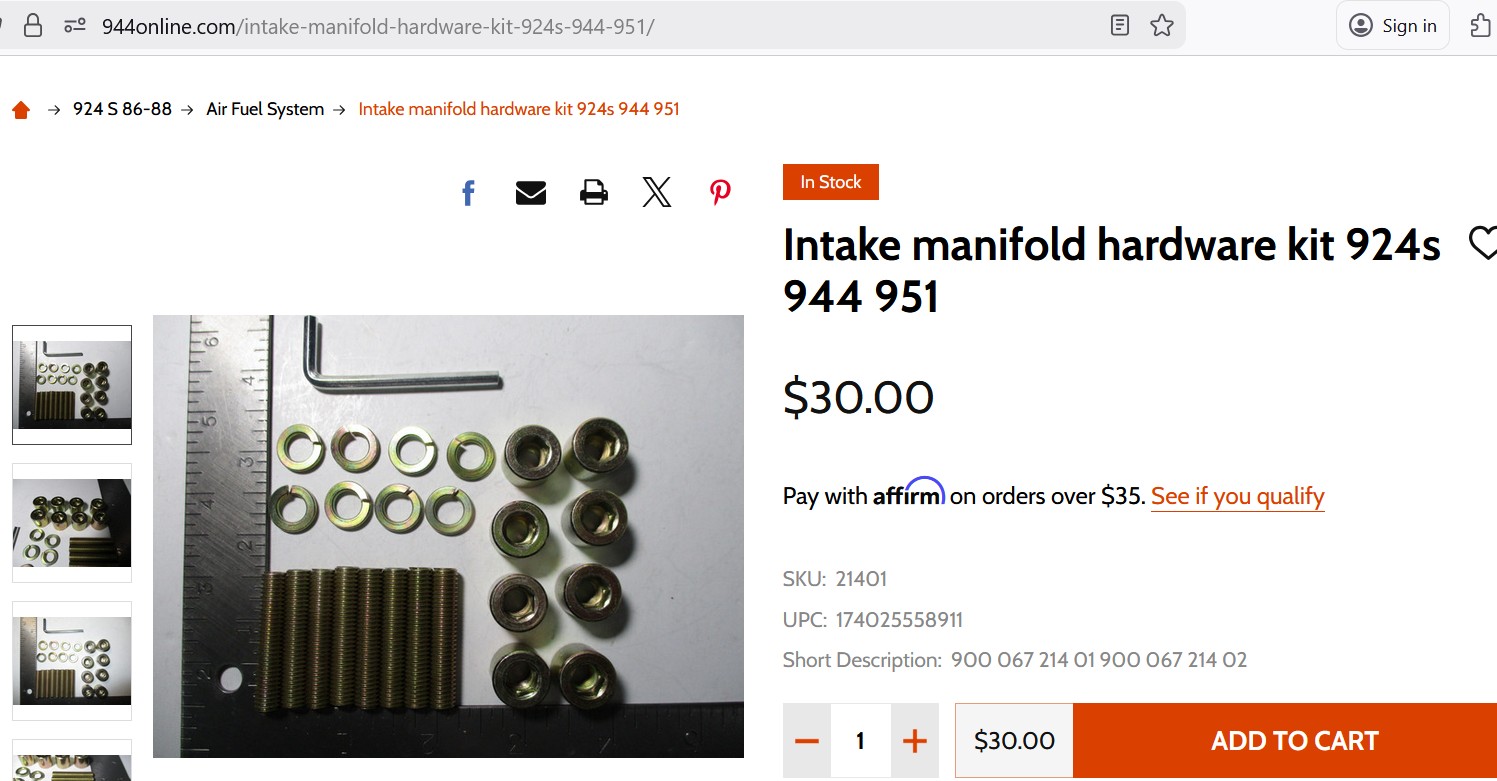

Sorry I can't help with the troubleshooting of your amazing build, but wanted to mention that there is a stud conversion option for the intake manifold that I had previously thought added no benefit. I like the normal stock allen head bolts. However, studs would have kept those gaskets in place.

I had no idea such a kit existed. I may look to do that the next time I have to take the IM off. You are correct, that would 100% removechrischrischris wrote: Wed Mar 11, 2026 10:00 am Sorry I can't help with the troubleshooting of your amazing build, but wanted to mention that there is a stud conversion option for the intake manifold that I had previously thought added no benefit. I like the normal stock allen head bolts. However, studs would have kept those gaskets in place.

944online has a kit.
- Screenshot 2026-03-12 101651.jpg (175.42 KiB) Viewed 525 times
