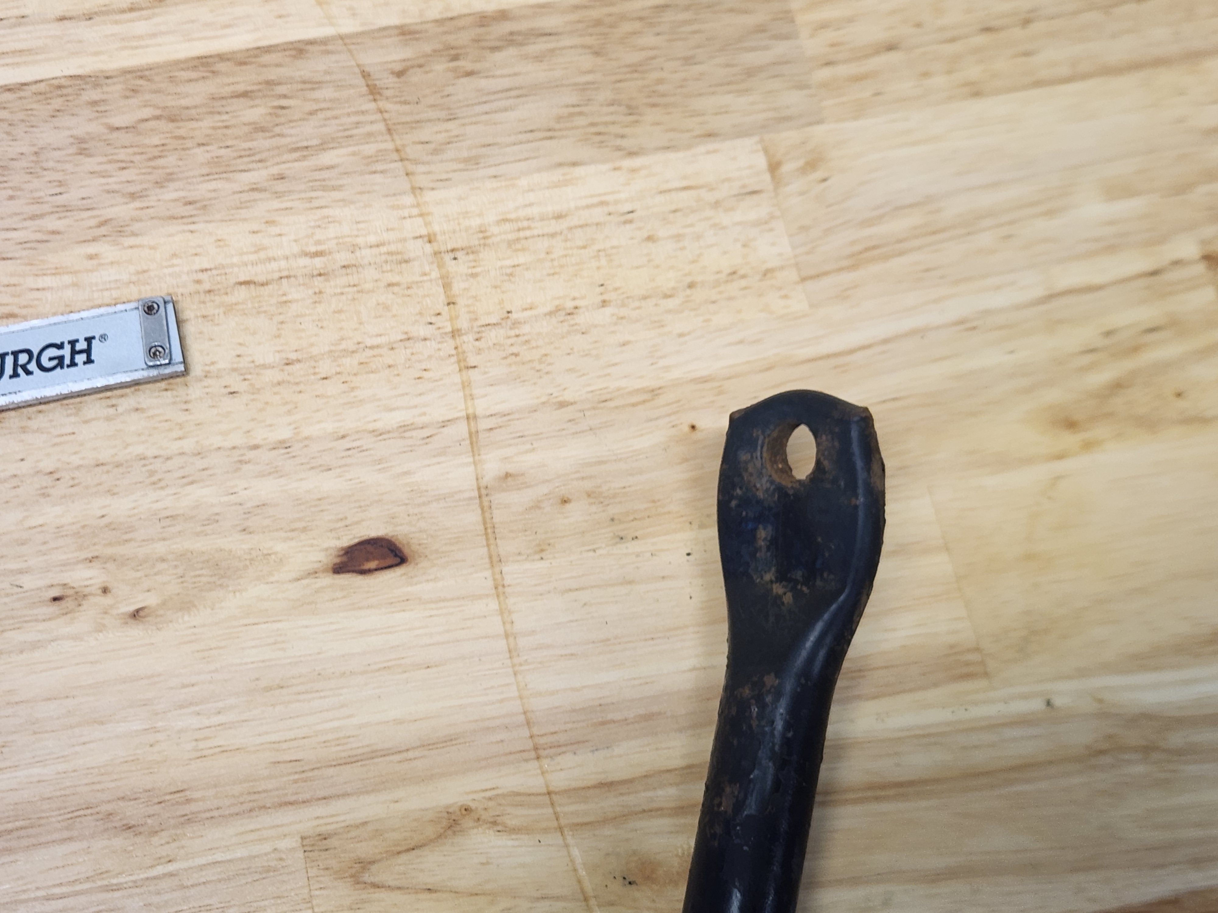

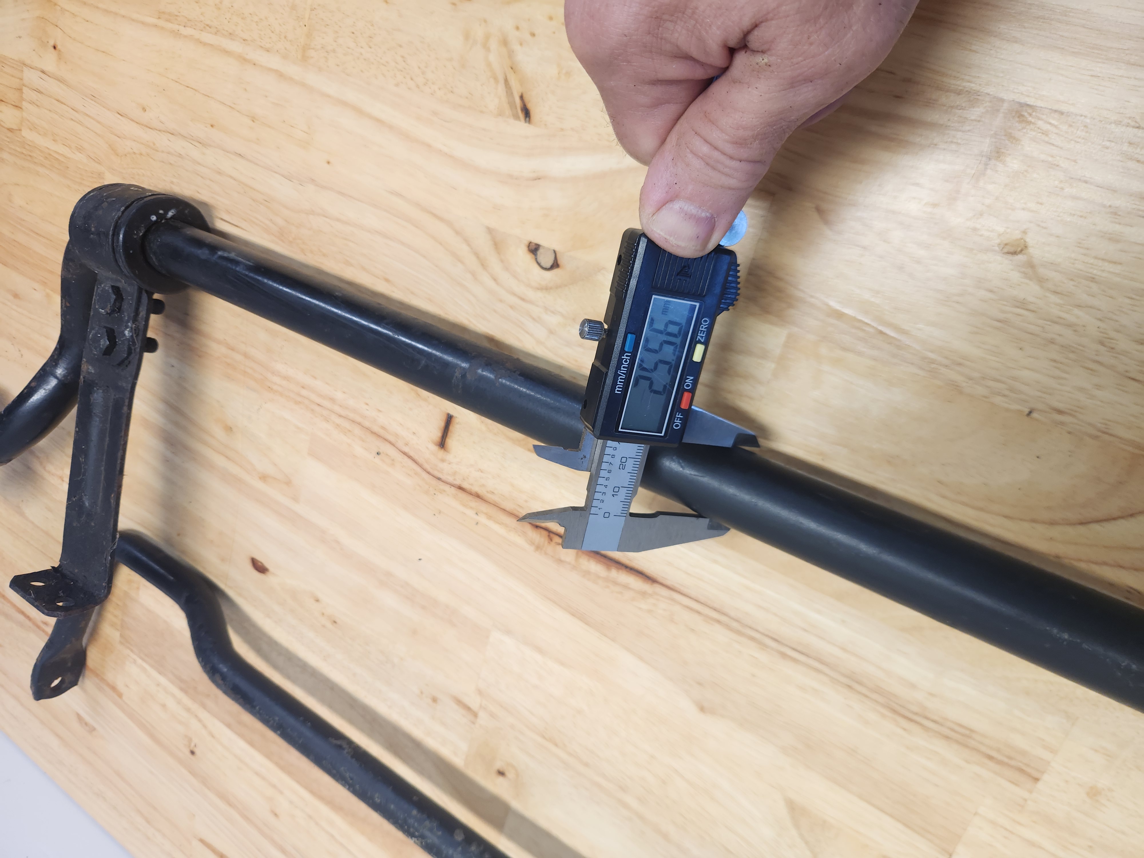

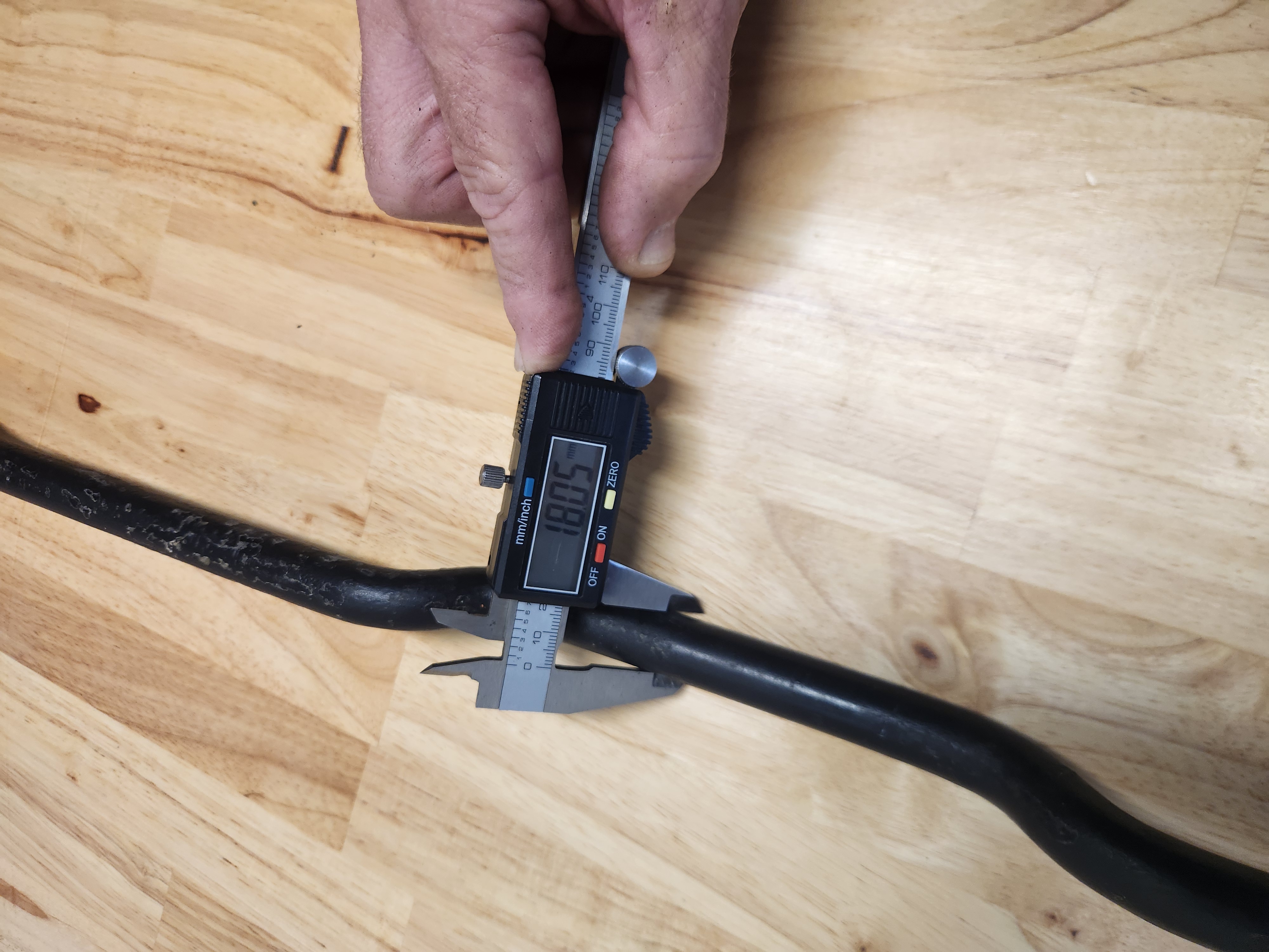

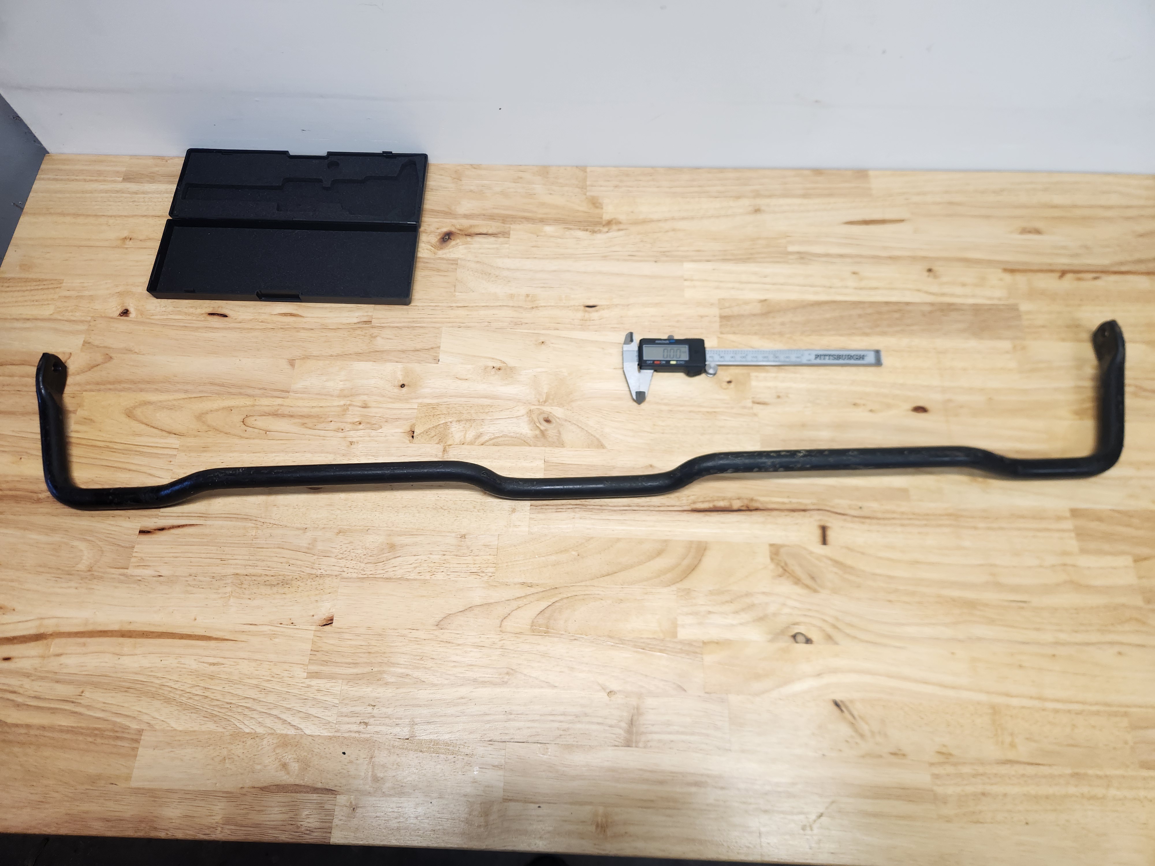

Just got the bars down off the shelf.
There is a small bit of surface corrosion on one end. A wire brush and some Krylon would probably work wonders.
Here's the front... JIC...
Unfortunately, I really don't know regarding the difficulty of changing out the rear eccentric bolts, maybe someone more knowledgeable can chime in.
I bought these 25+ years ago to put on an '88 na I had until I picked up the Turbo S. I never got around to installing them or any others.
How much corrosion do you have on your suspension?
