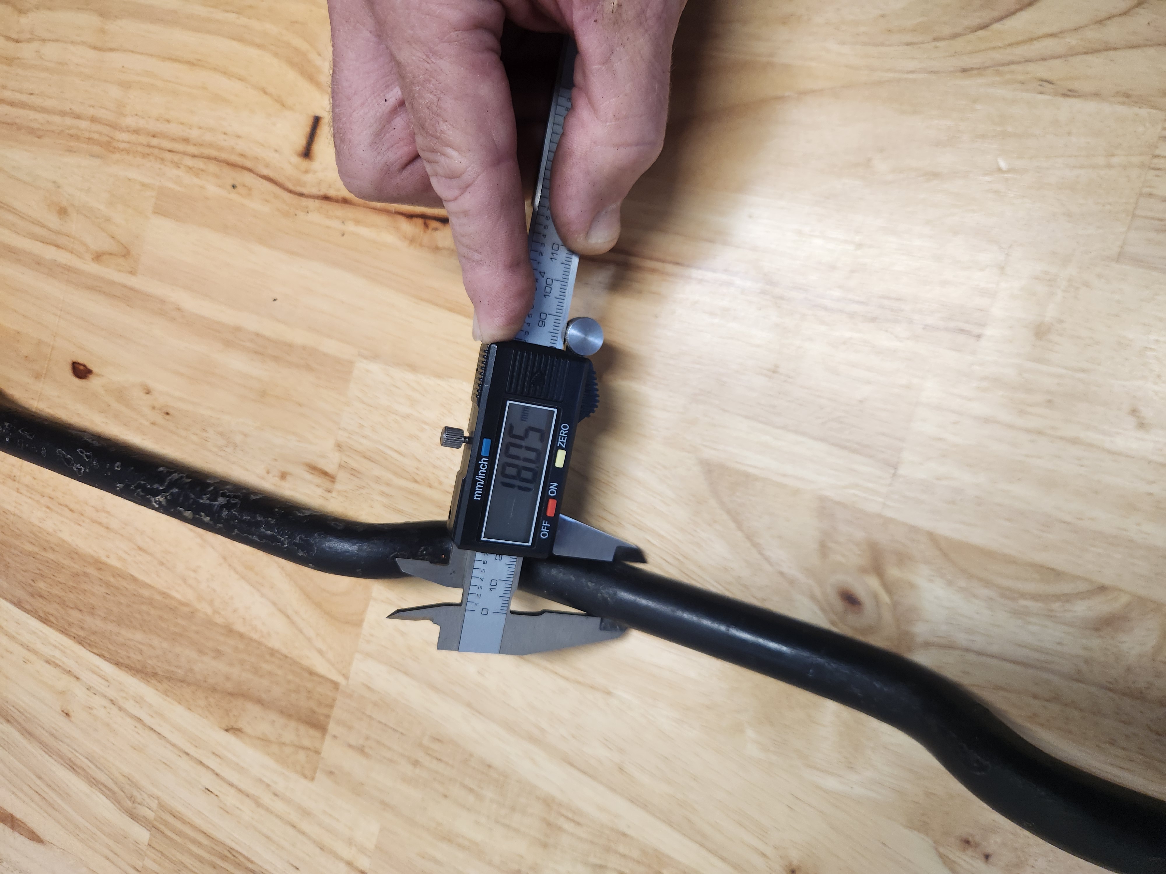

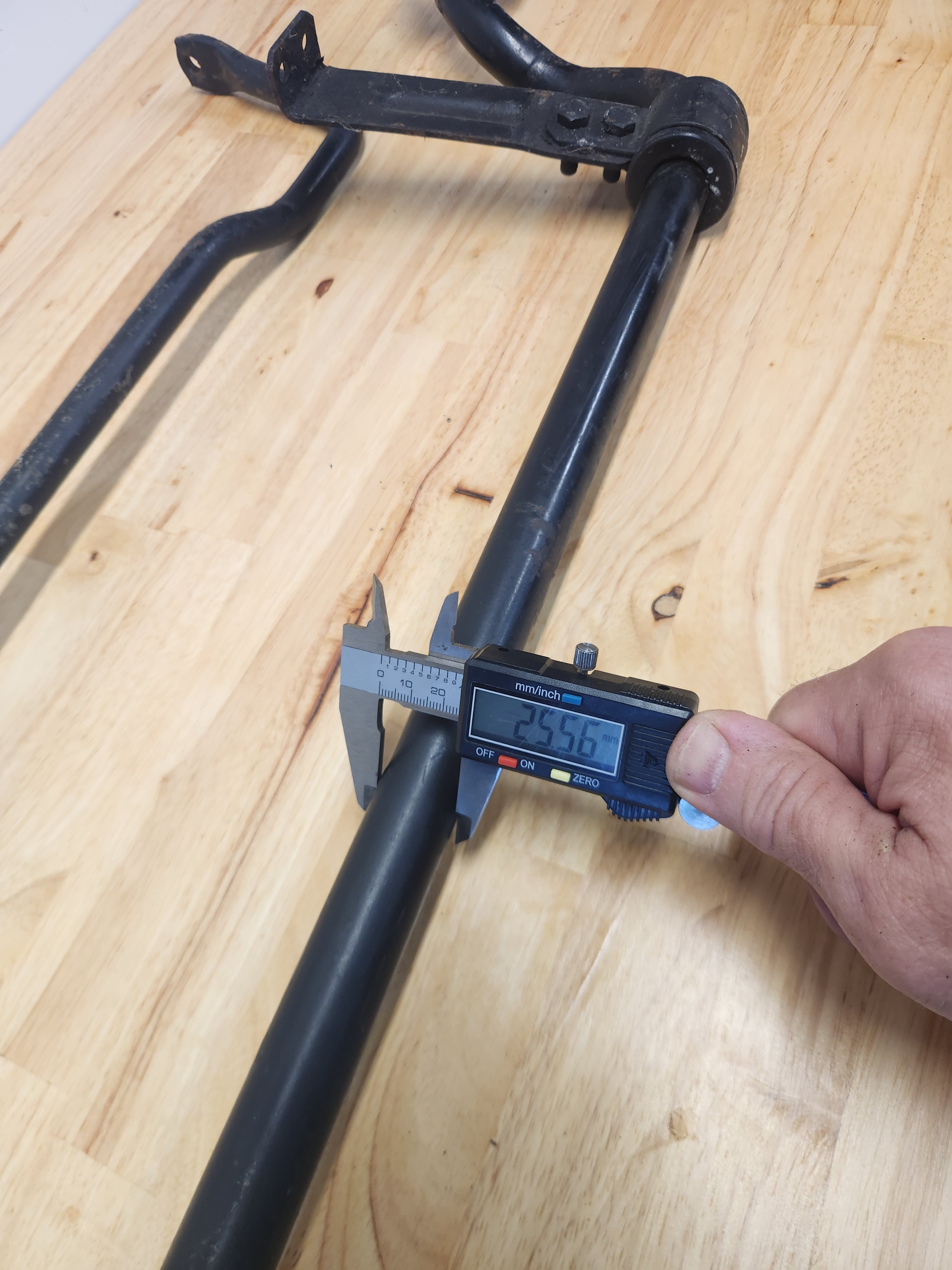

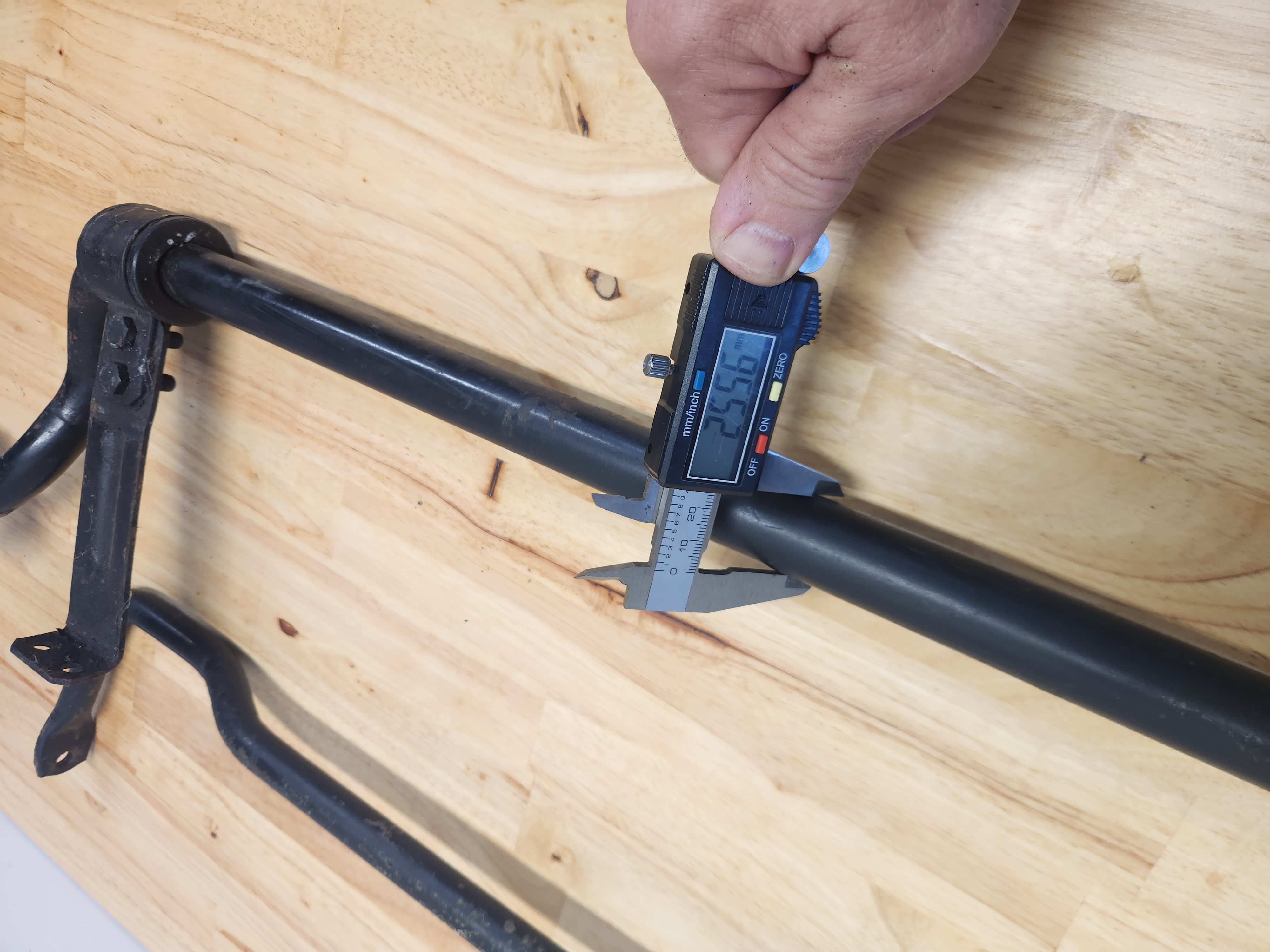

I have a set of bars (25.5mm front and 18mm rear) that you are welcome to. (no drop links though)
I've had them for 25+ years sitting on a shelf in the garage. It'd be great to pass them along if you think you might be interested.

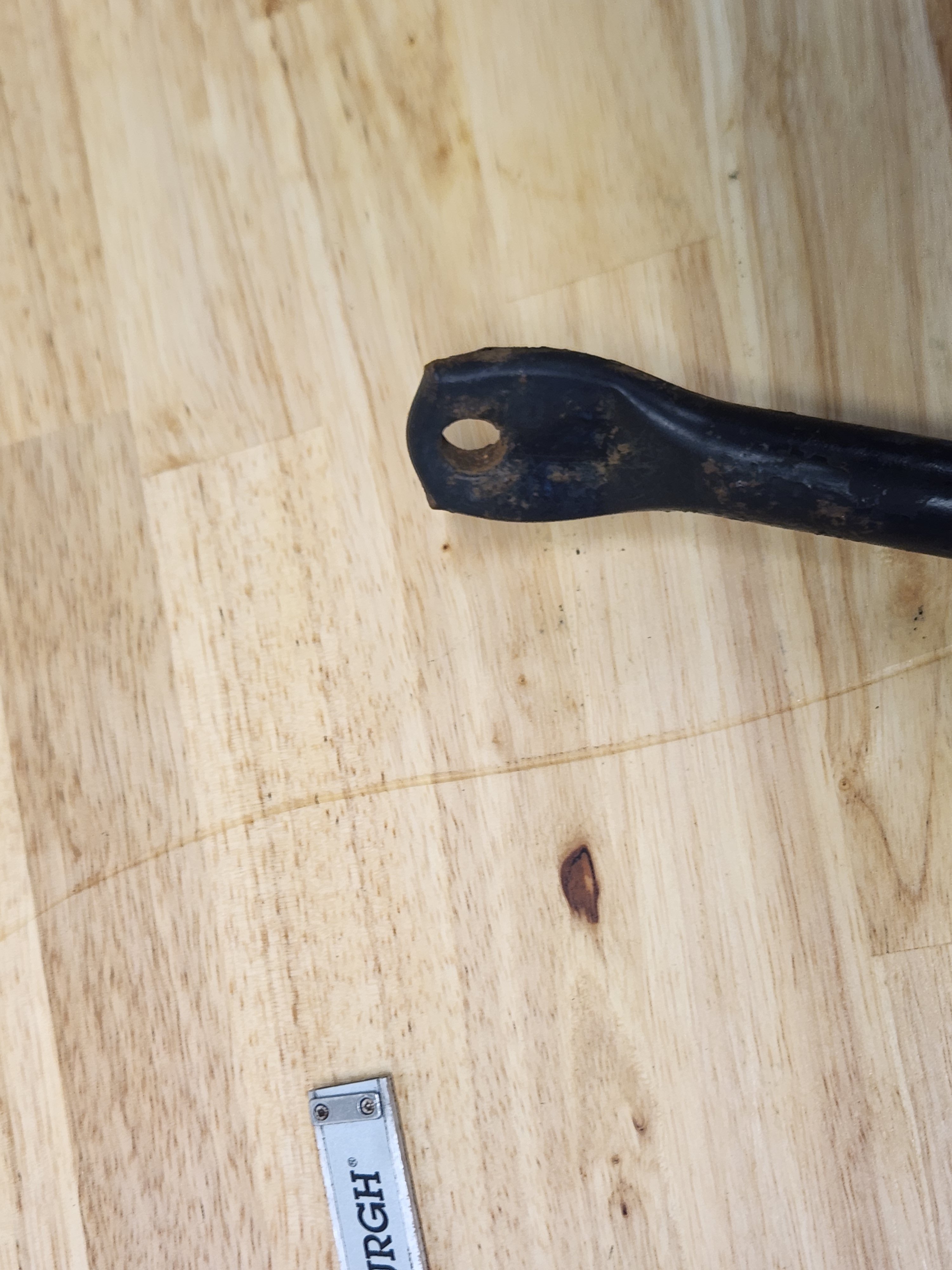

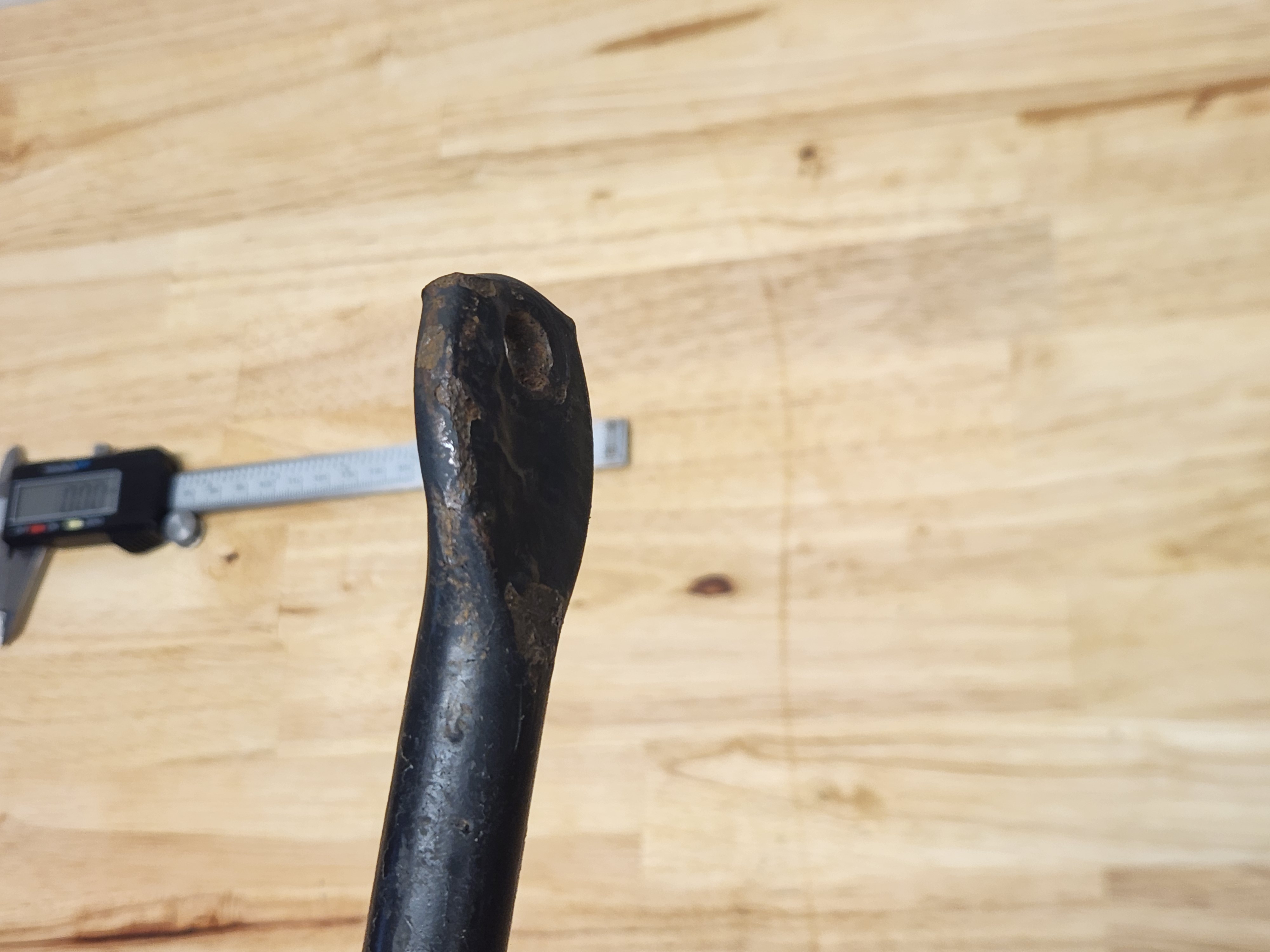

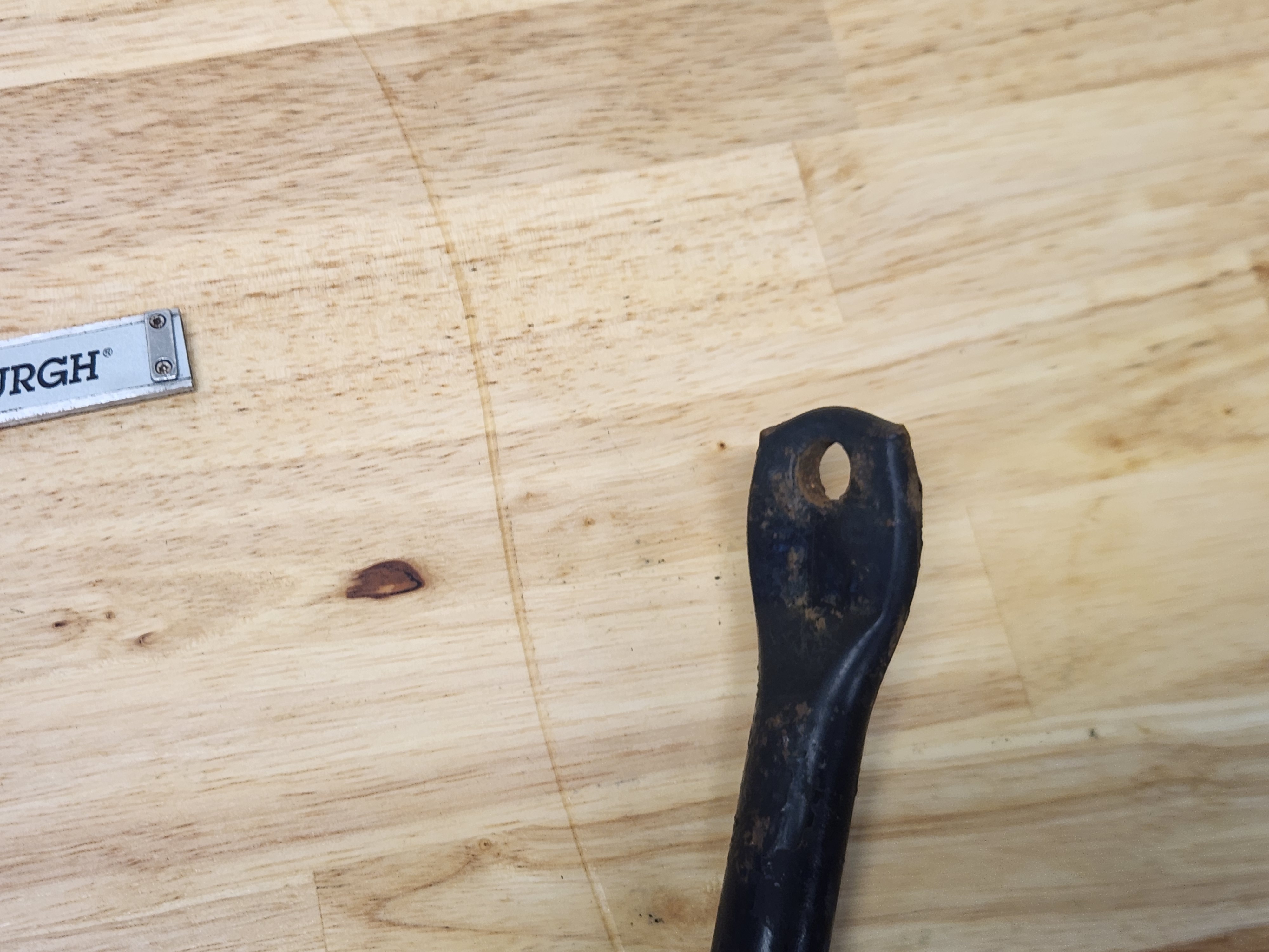

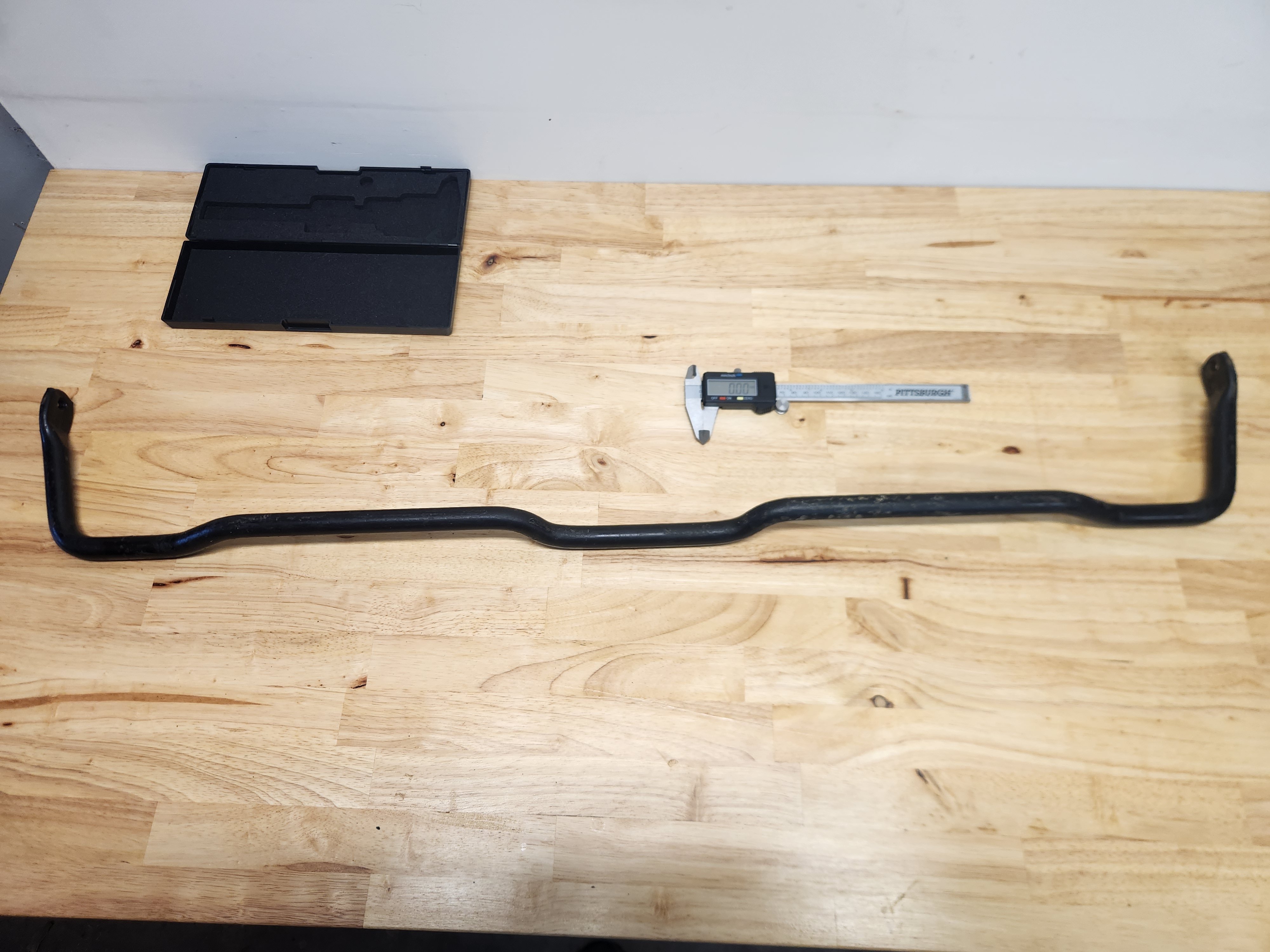

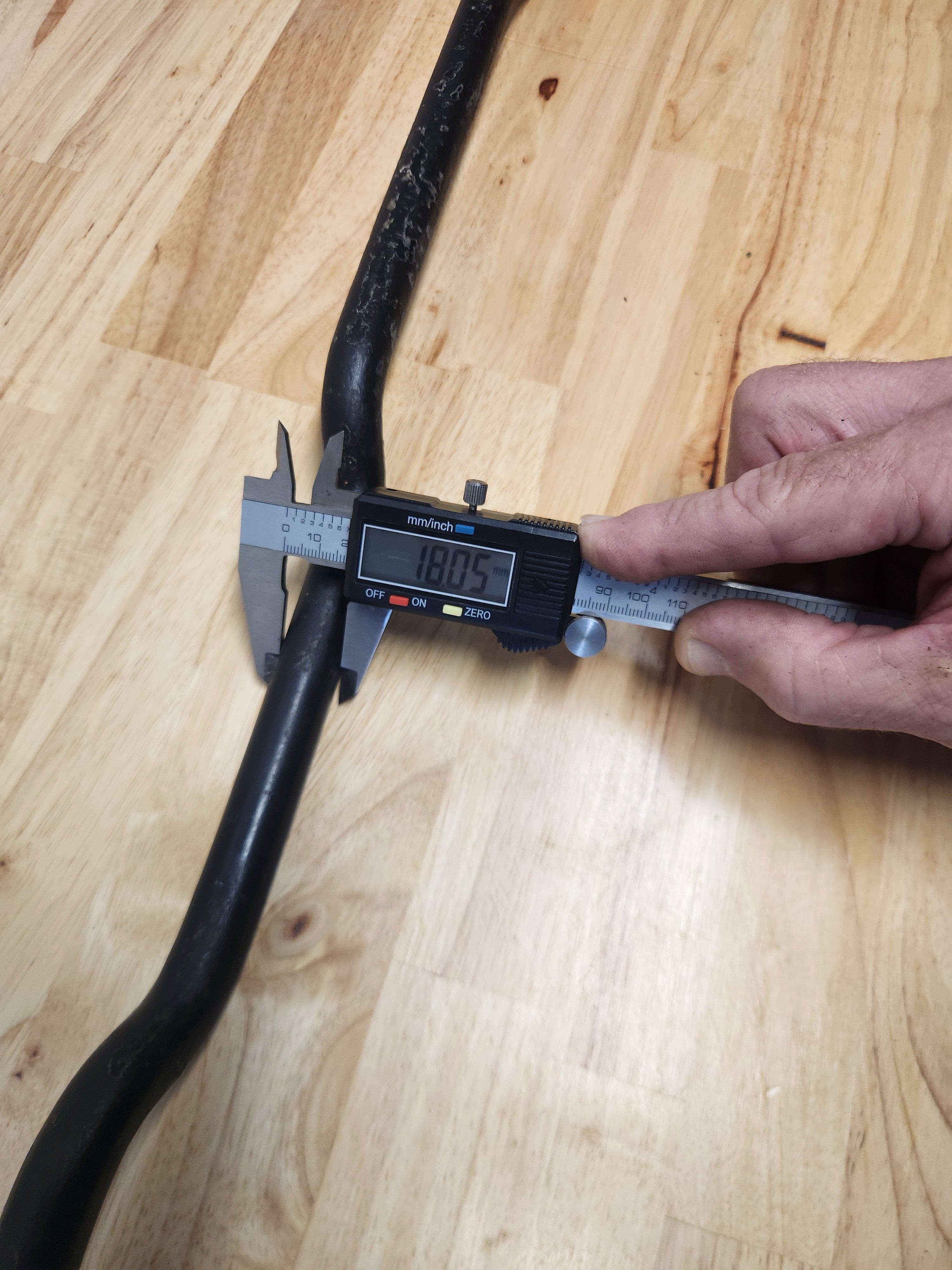

Just got the bars down off the shelf.
There is a small bit of surface corrosion on one end. A wire brush and some Krylon would probably work wonders.
Here's the front... JIC...
Unfortunately, I really don't know regarding the difficulty of changing out the rear eccentric bolts, maybe someone more knowledgeable can chime in.
I bought these 25+ years ago to put on an '88 na I had until I picked up the Turbo S. I never got around to installing them or any others.

@Gaspowered Really appreciate you sharing those sway bars with me. They will have a good home.
I just got myself a new impact gun... I'm mainly wondering if there is a trick to getting the eccentric out without the spring plate miss aligning the hole.
I also just want to say, its funny to see that same caliper I have appear in this thread again. I need to put a new battery in mine
