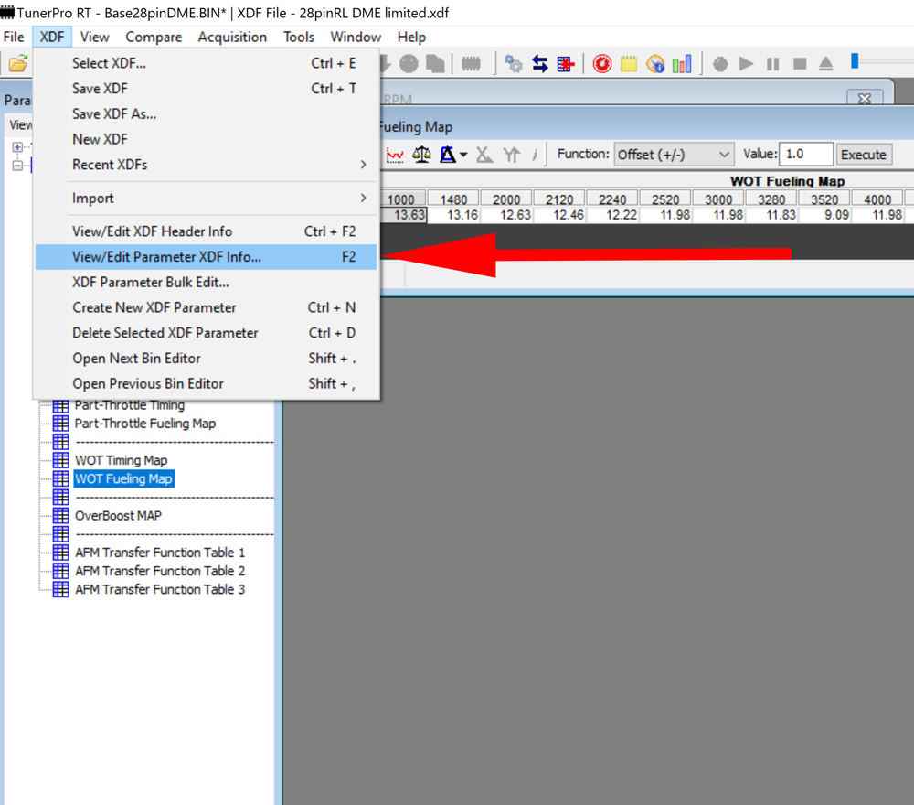

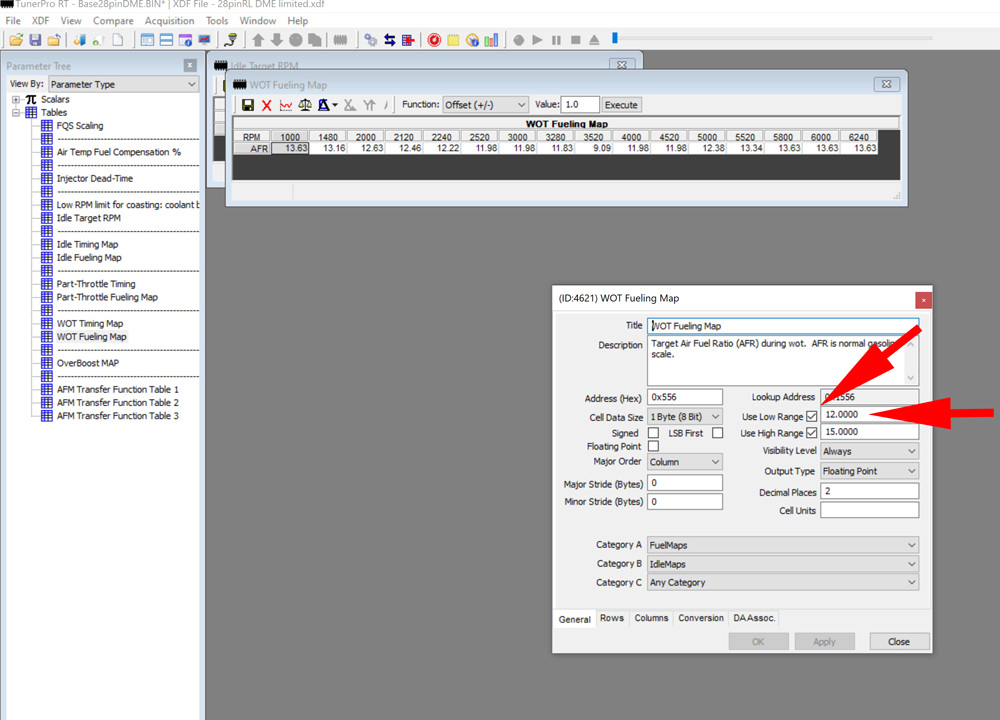

I plan to do a more complete guide at some point, but in the meantime wanted to share something I finally figured out about TunerPro and Josh's xdf files. @whalenlg and I have discussed this in the past, and I was always a bit perplexed why he got different TunerPro behavior than I did.
Josh did a great job setting up the xdf file so that is makes sense to human eyeballs. In the WOT map, for example, the entries are shown as AFR number -- 14.7, etc. -- so when you edit the maps you can put in numbers that make sense to you, rather than trying to calculate the actual value that gets burned in the map. The problem I was having is that I couldn't get values lower than 12 to stick. I'd save 11 or even 10, and it would come back as 12 or so. Inspecting the XDF file, I saw that Josh entered 12 as the minimum value. The weird thing was @whalenlg was using the same xdf with the same minimum, but was able to save lower numbers. Fast forward to this afternoon, and I finally found the toggle where you can turn the limits on and off (or change the limits). Here are screen shots showing how/where to turn off or change the limits in case helpful to any frustrated would-be tuner down the road.
Start by opening the map that has the limit you want to change or turn off. Then go here....
And it pulls up this box where you can make the change.
