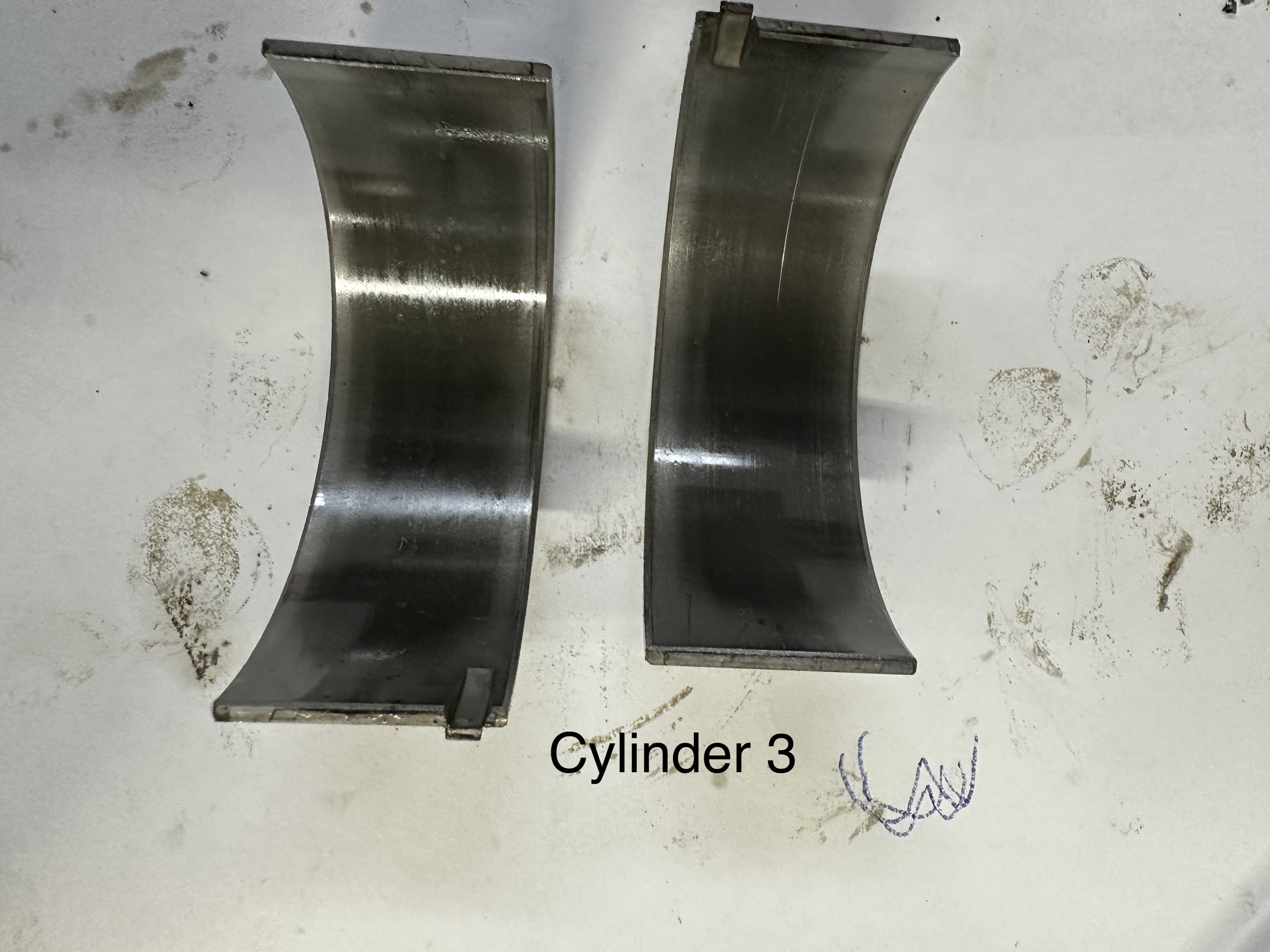

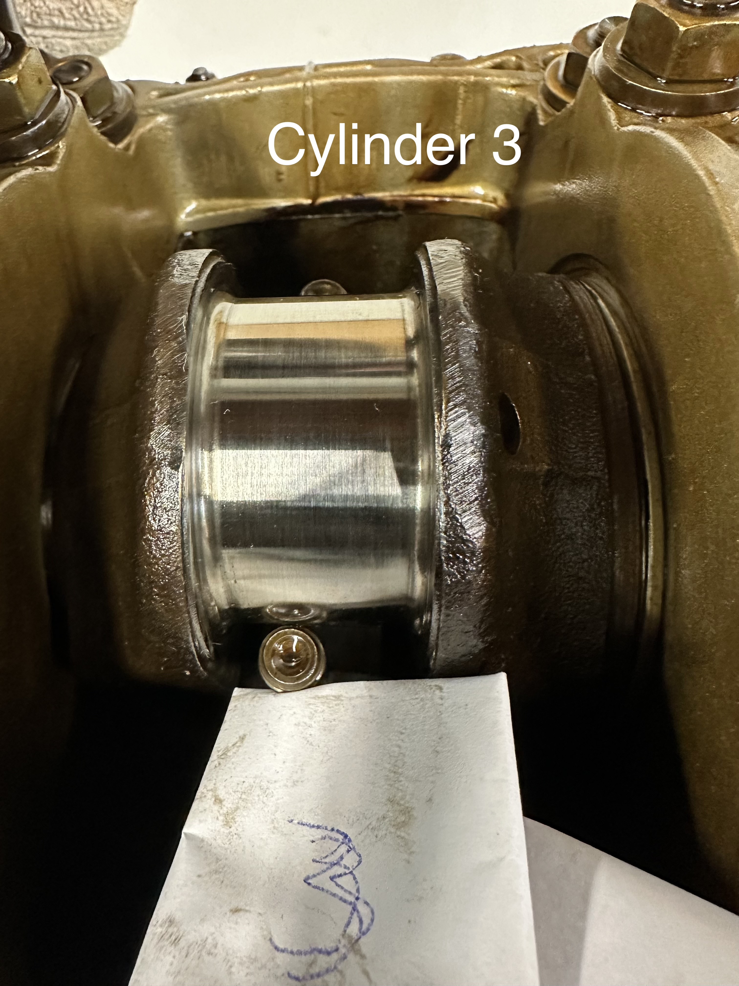

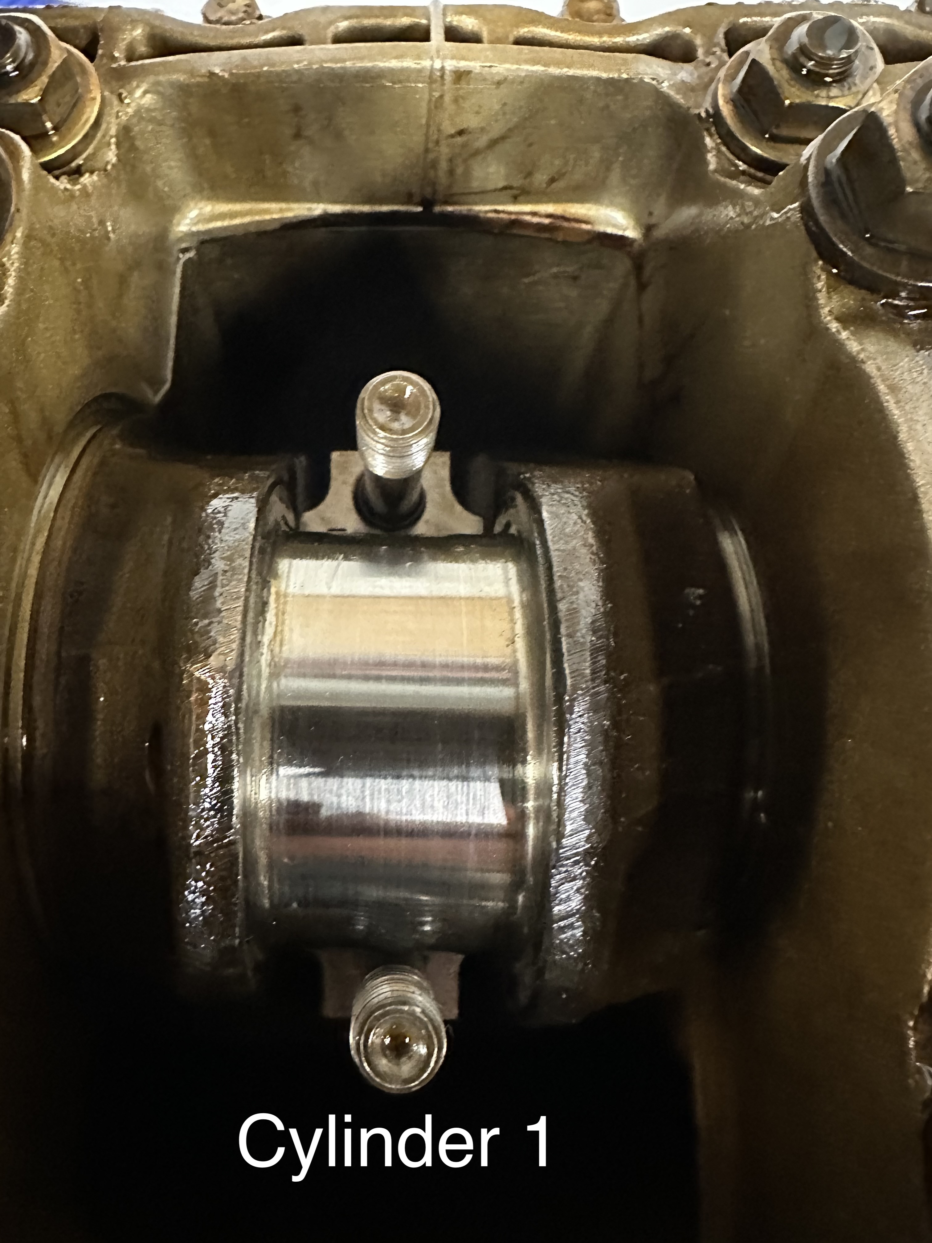

whalenlg wrote: Thu Nov 21, 2024 7:19 pm Will add new pics. The bearing and crank felt smooth. Will pull the rest of the bearings tomorrow.
There was machine shop work done on the crank by the PO during the rebuild.
Looks like these rod bearings came from a Porsche lower engine set. Wasn’t planning to put these back but asking if glycos hold up ok.
Glyco is OEM and I once did a comparison between bearings in a PCNA box and those in a Glyco box, and found virtually no differences. For a mostly street car, thousands of motors say they are good enough. :)
Did the work order for the crank say anything about 'nitriding' or 'hardening'?

New pics attached
Handwritten notes related to head and crank items from 2002 rebuild look like:
Machine Work Head Case and Crank CA 10/10+ Rops $670
Also noted 8 valve guides, 1 intake valve, 8 rod nuts, 4 wrist pin bushings, Rod Bearing set, Main bearing set
1986 951 - Silicon Valley
#62
Black944 turbo
Posts: 221
Has thanked: 14 times
Been thanked: 128 times

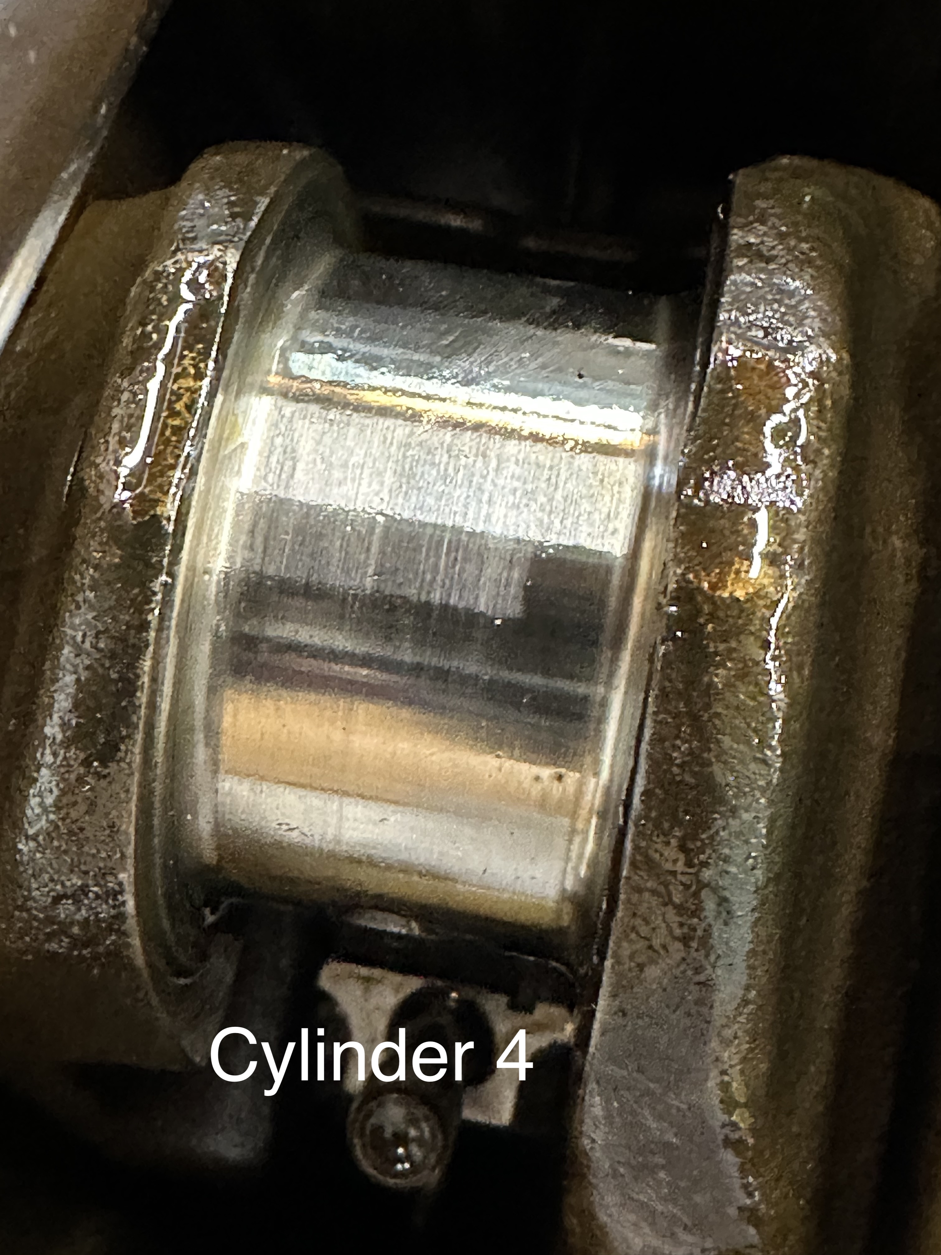

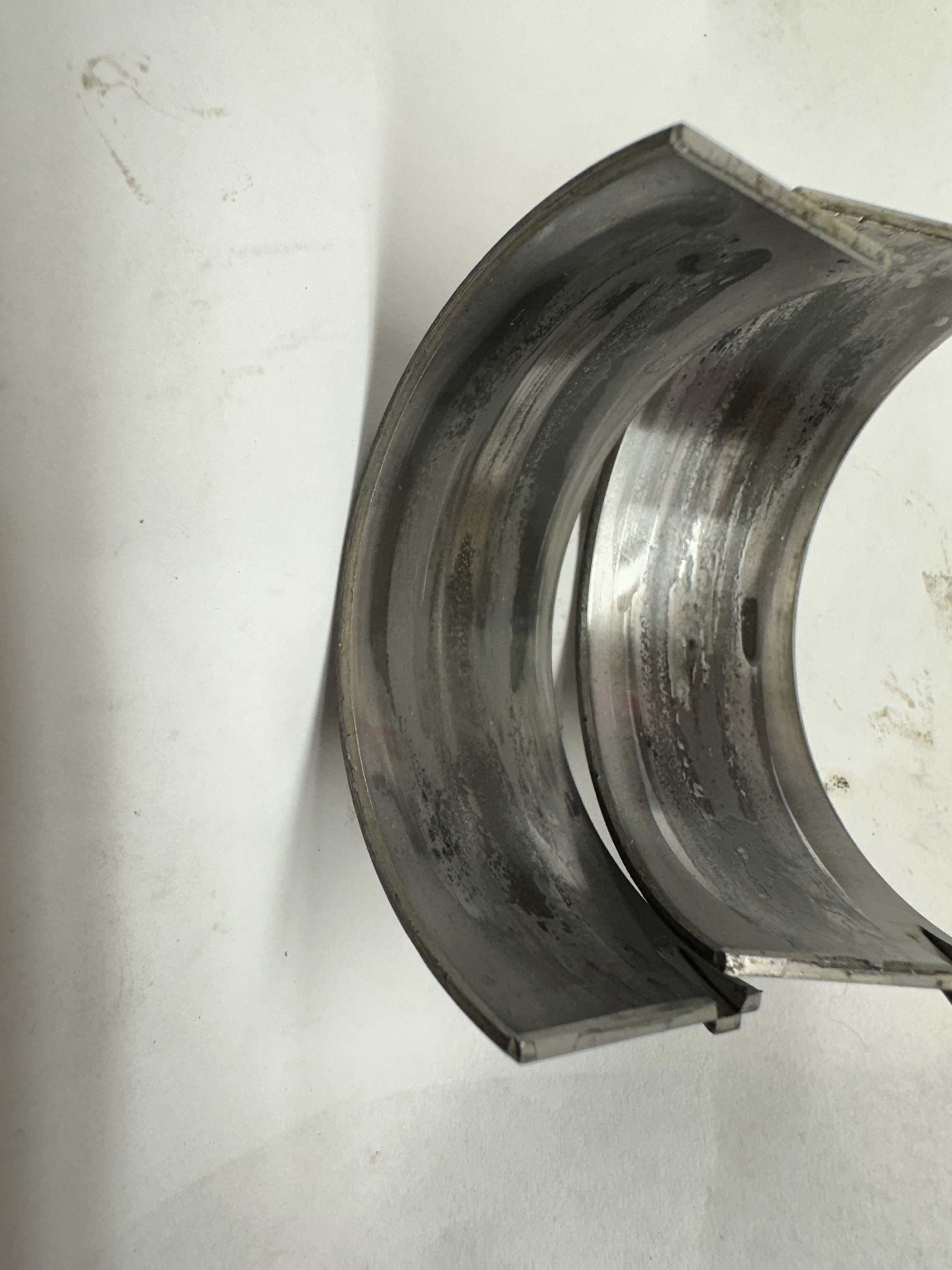

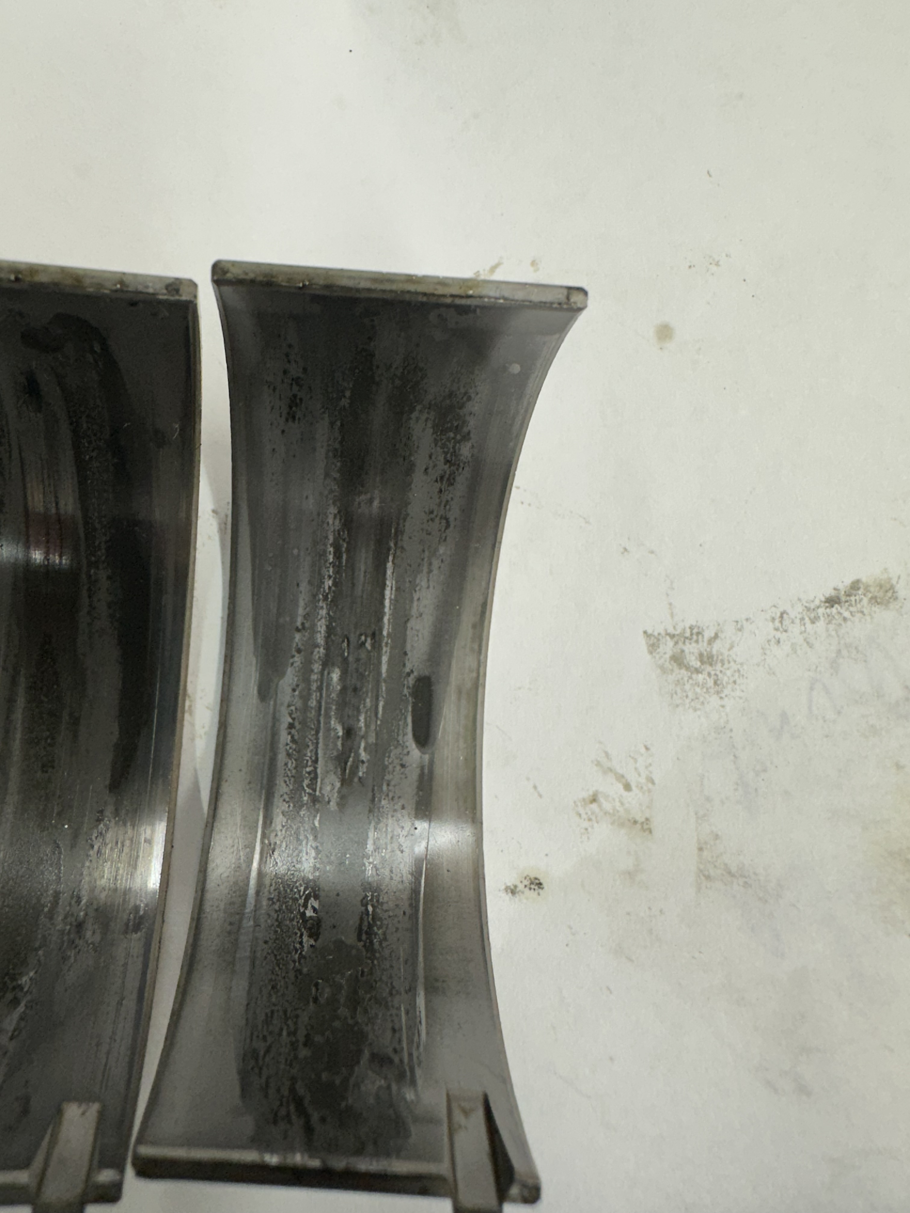

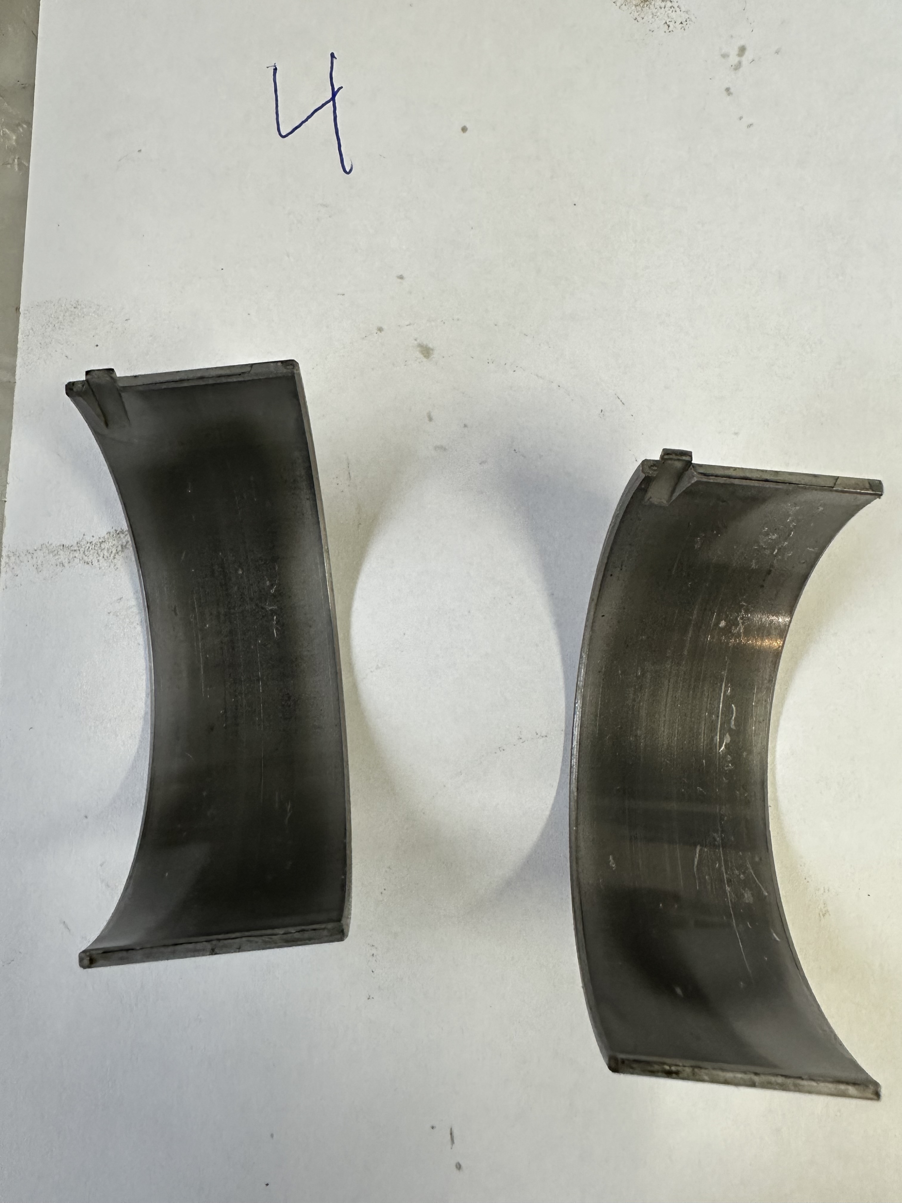

Those bearings look pretty rough. I agree with everyone, measure, measure, and measure again. Glyco bearings in mine and have had no issues knock on wood.

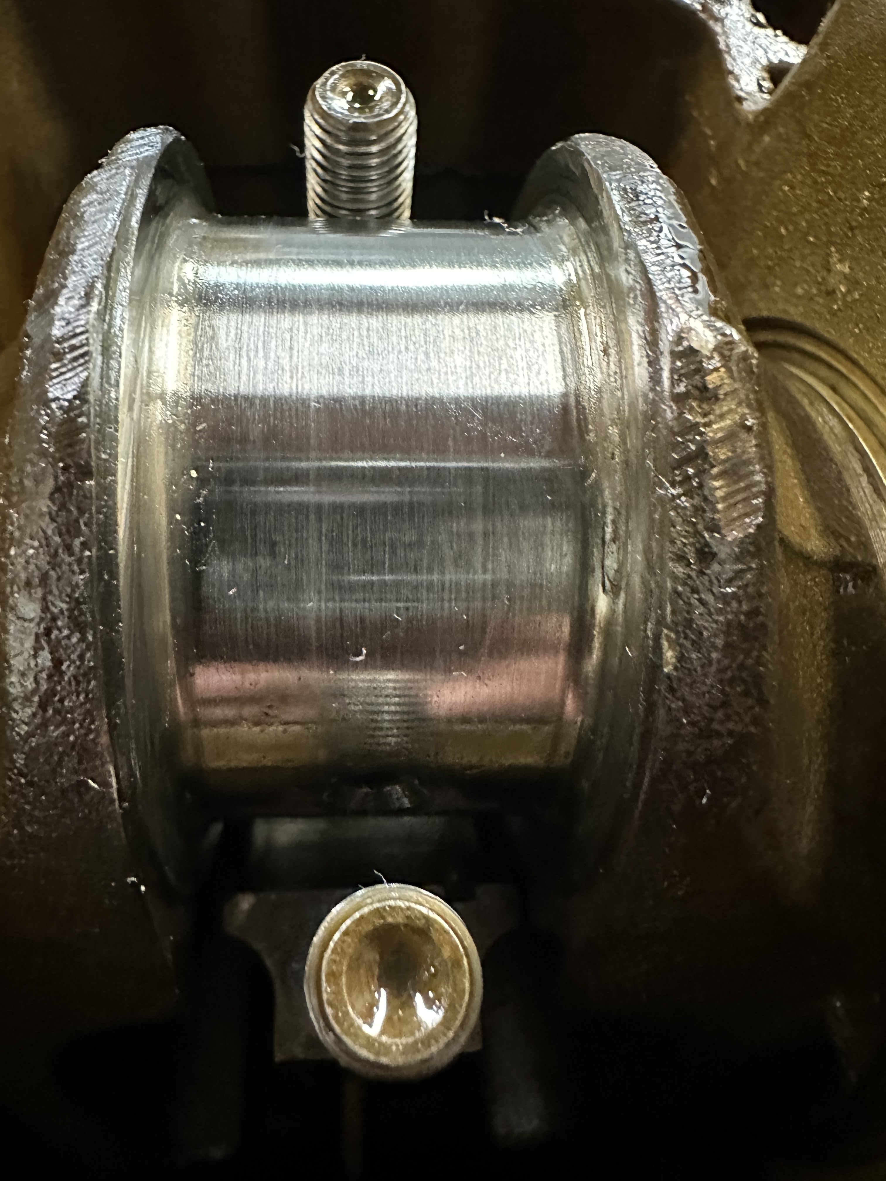

The crankshaft does not appear to be useable as it is but photos can be misleading.
Rod bearings by ACL are worth considering. They are better suited to performance applications, like in a turbo, and are available in some incremental sizes to allow tailoring of oil clearance. Starting with a good used standard / standard crank is a viable approach.

Ok - the search is on for a good, used, measured crankshaft that just needs a polish. Any leads would be great - I'll check plyhammer, dcauto and carquip.
Just to finish the documentation, attaching 1,3 and 4 bearings and crank photos.

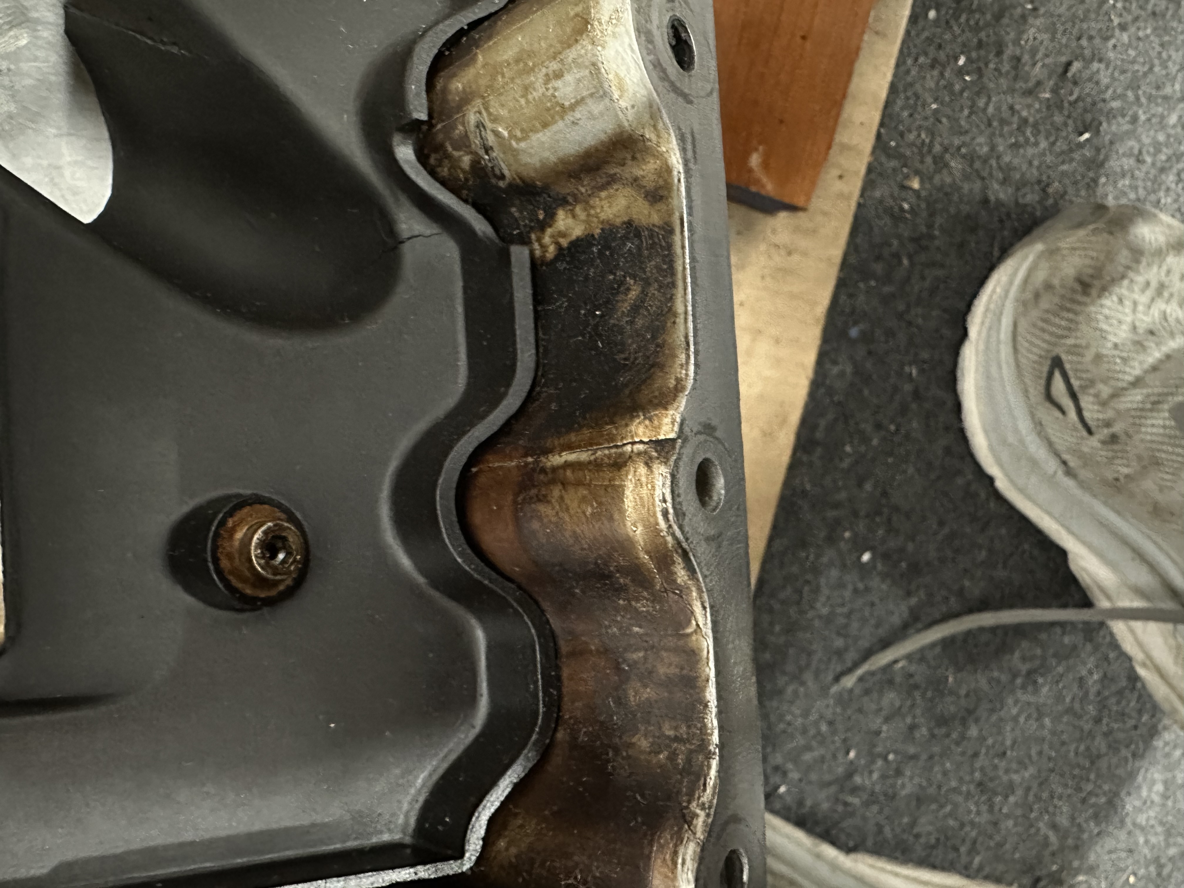

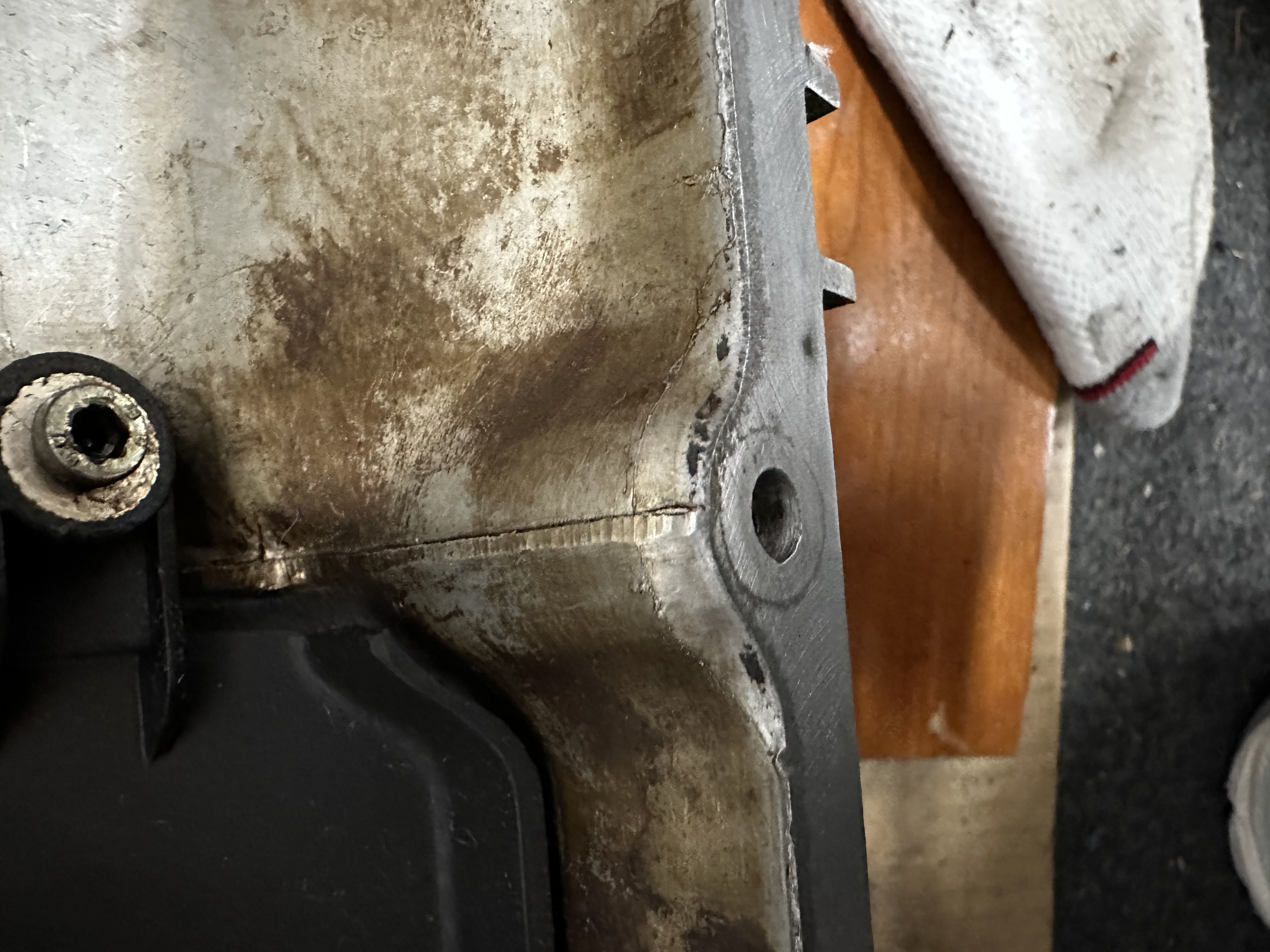

Getting to the end of the cleaning phase. Found a few bonus washers and nuts in the tarp it’s.
Noticed these 2 cracks inside the oil pan. Not sure what to make of them since a few that are on eBay right now have the same. They don’t go through to the outside.
Looks like the baffle has cracks I didn’t notice before as well.

I think those are casting marks, as you can see the "crack" doesnt penetrate (where the bolt threads are). Very common on these oil pans.

walfreyydo wrote: Wed Dec 11, 2024 7:51 am I think those are casting marks, as you can see the "crack" doesnt penetrate (where the bolt threads are). Very common on these oil pans.
Thanks - looks like I’ll just need a new insert.

Measured the crank and all journals are within spec for a .25mm grind. Dropped it by machine shop and he confirmed it really just needs polishing. Will have it back this week.
