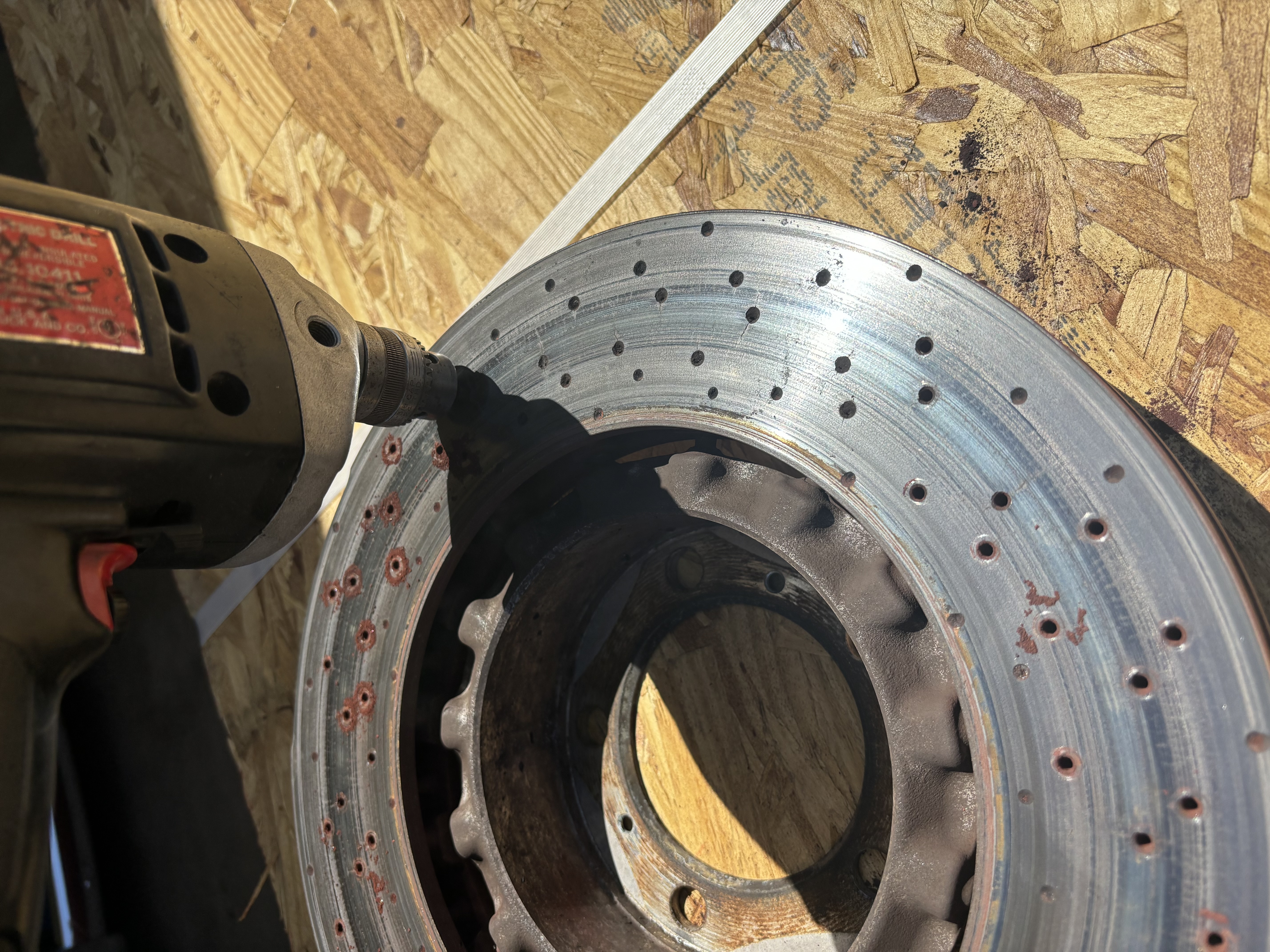

Brake inspection today. Back story: for the last few months my brakes have been making a weird noise from time to time. Sometimes it would happen the first brake application when I come off the track, sometimes the first brake application when I leave the house in the morning. It always sounding like the heat shields behind the front rotors were loose, rattling or something was grinding on them. Took a rotor off and found this:
Thinking about running no heat shields anyway because the front brake cooling duct aims right at the back of the shield. Noticed the GT4 does not have a heat shield, just a little cover to protect the tie rod end. So I safety wired some heat shield fabric around the rubber boots on my lower ball joints and tie rods just as a precaution from the radiant heat from the rotor after a spirited drive.
And well why the rotors are already off the car may as well clean out the holes that are all clogged up with brake dust. 1/8” drill but was a good fit.
Speculation: I have only heard this noise on my GTS and another GTS at the track. It could be something with the particular rotor and heat shield that were used on the GTS, not sure. As previously mentioned, GT4s and Spyders don't have heat shields and those are the common 718s during the track days I have attended.
