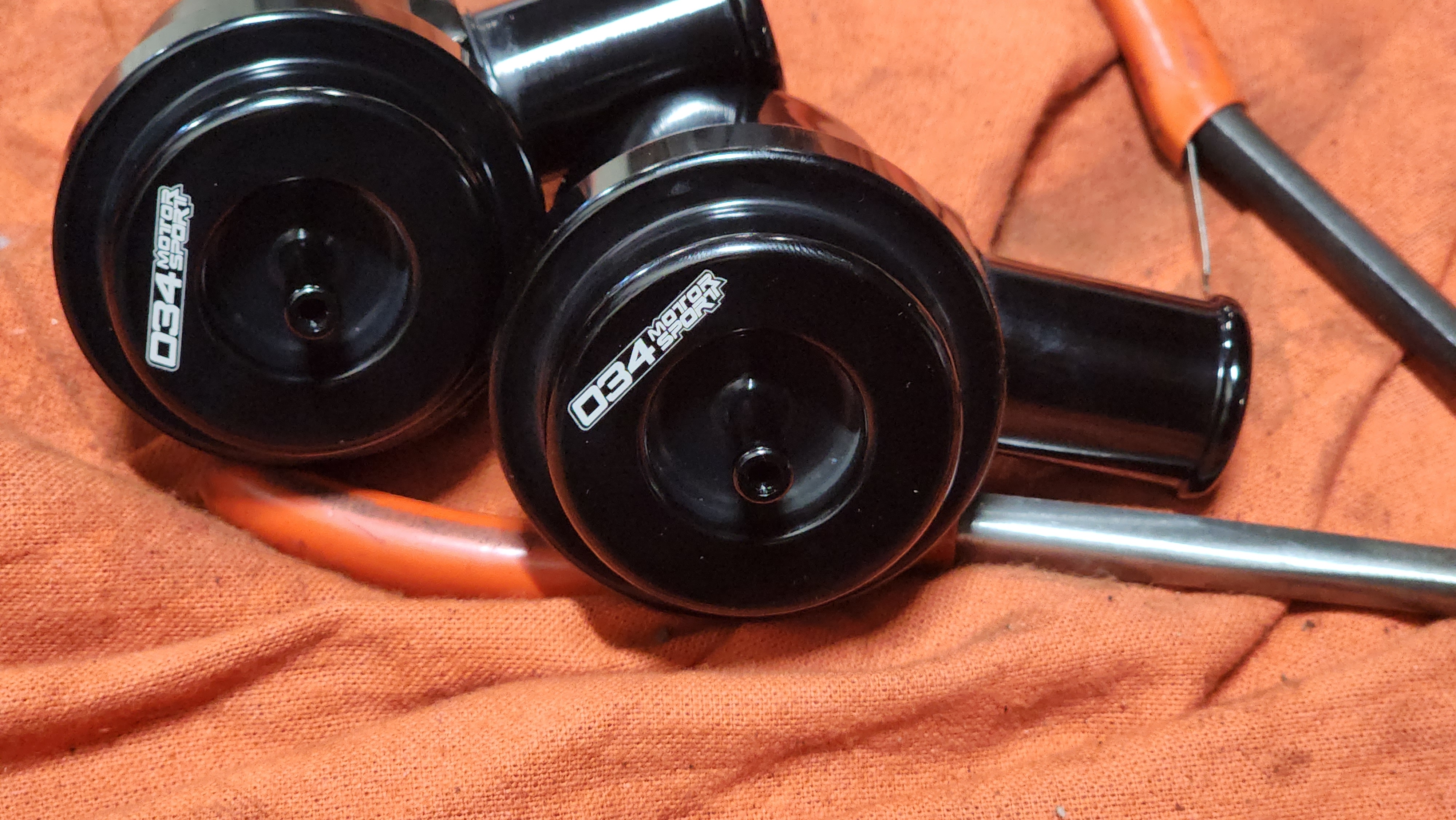

@Teddis & I installed 034 motorsport diverter valves as my stock ones had failed(car was only making 15psi of boost at WOT). Thanks to @GASBill for letting us use a hoist at his shop.
