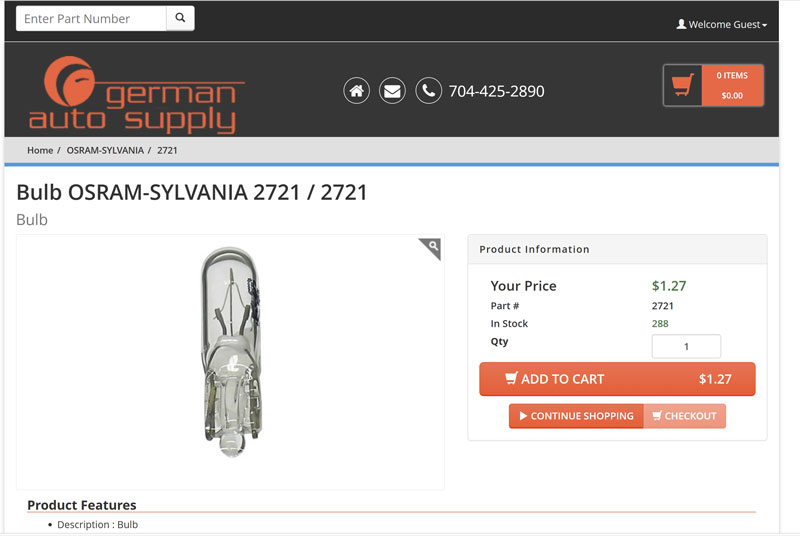

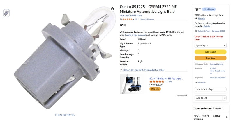

I just looked at one and agree. The warning and turn signal lights look to be 1.2 Watt T5 bulbs, which come with and without the holder. Search for Osram 2721 for example...
