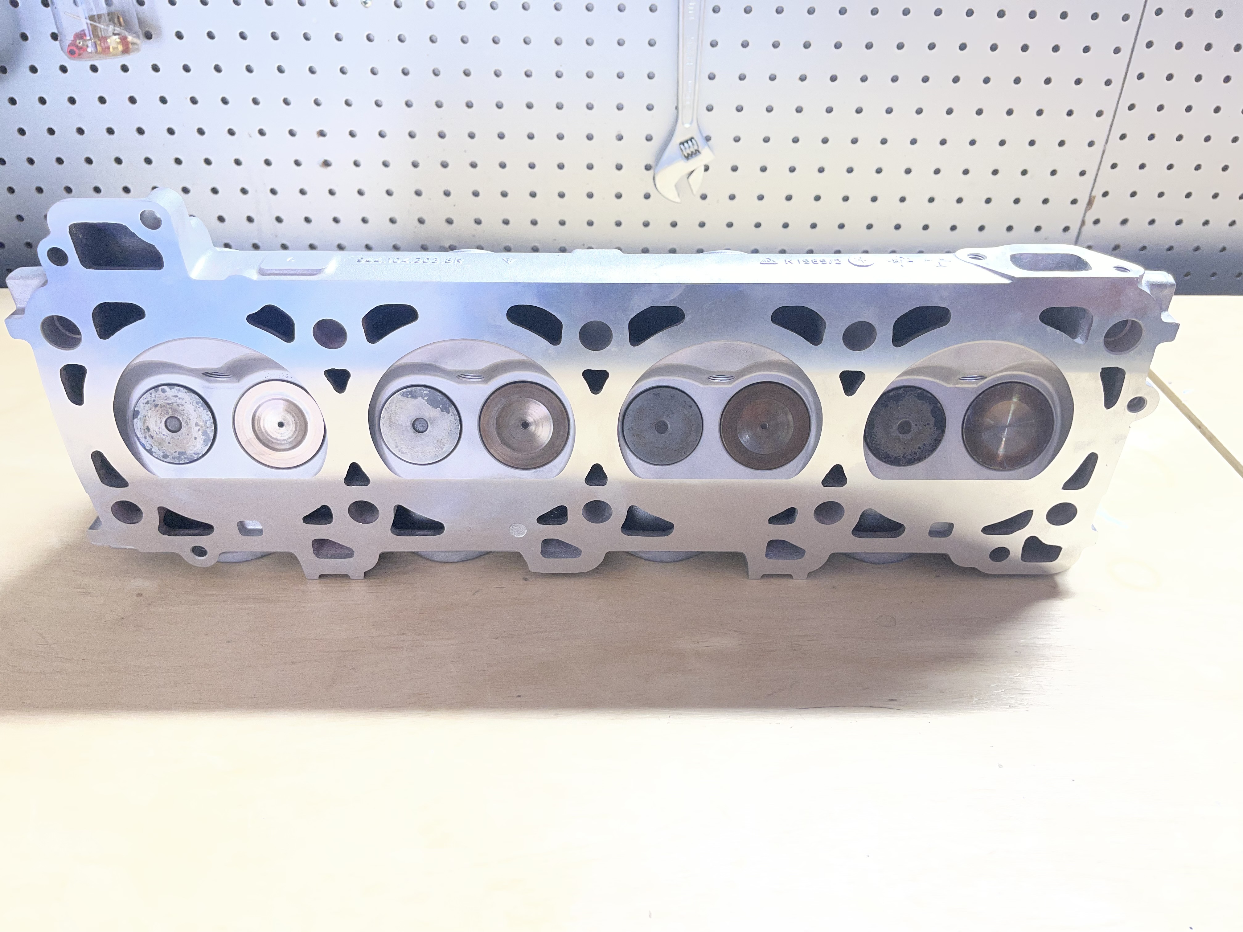

libarra82 wrote: Sun Mar 22, 2026 1:33 pm Head almost ready :)
All is well, just needed a new intake valve and seals.
How much did you shave the cylinder head?

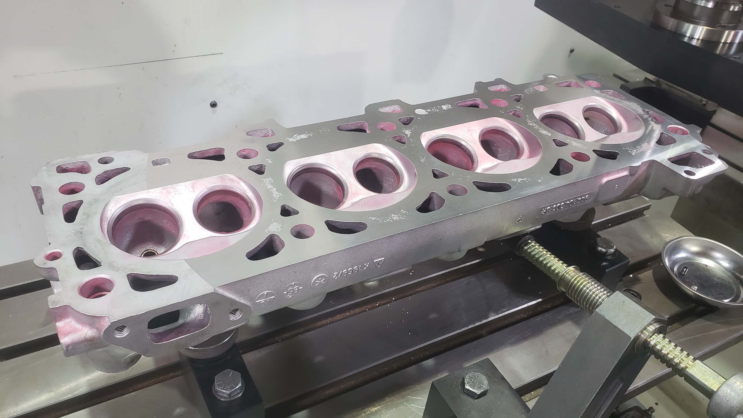

Posted: Mon Mar 30, 2026 1:06 pm
by libarra82
Not sure yet, head still at the machine shop. I don’t think much, though. Here’s a picture after the first pass, it already looked good. Hopefully I’ll get it back this week.

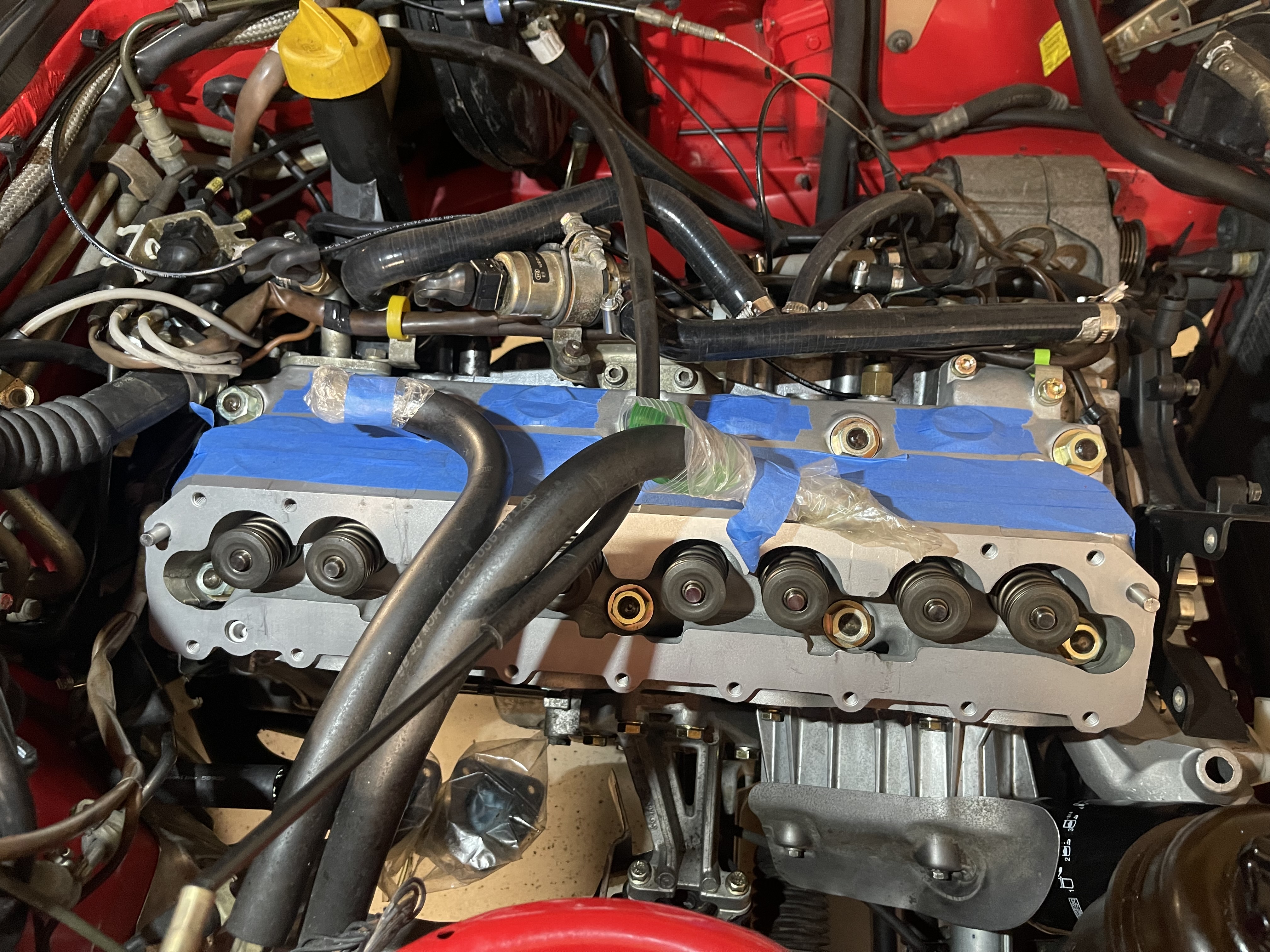

Re: Cylinder Head rebuilt recommendations
Posted: Wed Apr 15, 2026 10:15 pm
by libarra82
The cylinder head is back on the car. Leaving the head out in the sun and putting the dowel pins in the freezer worked perfectly. The pins slid in easily with thumb pressure, and a few light taps with a rubber mallet ensured they seated fully.

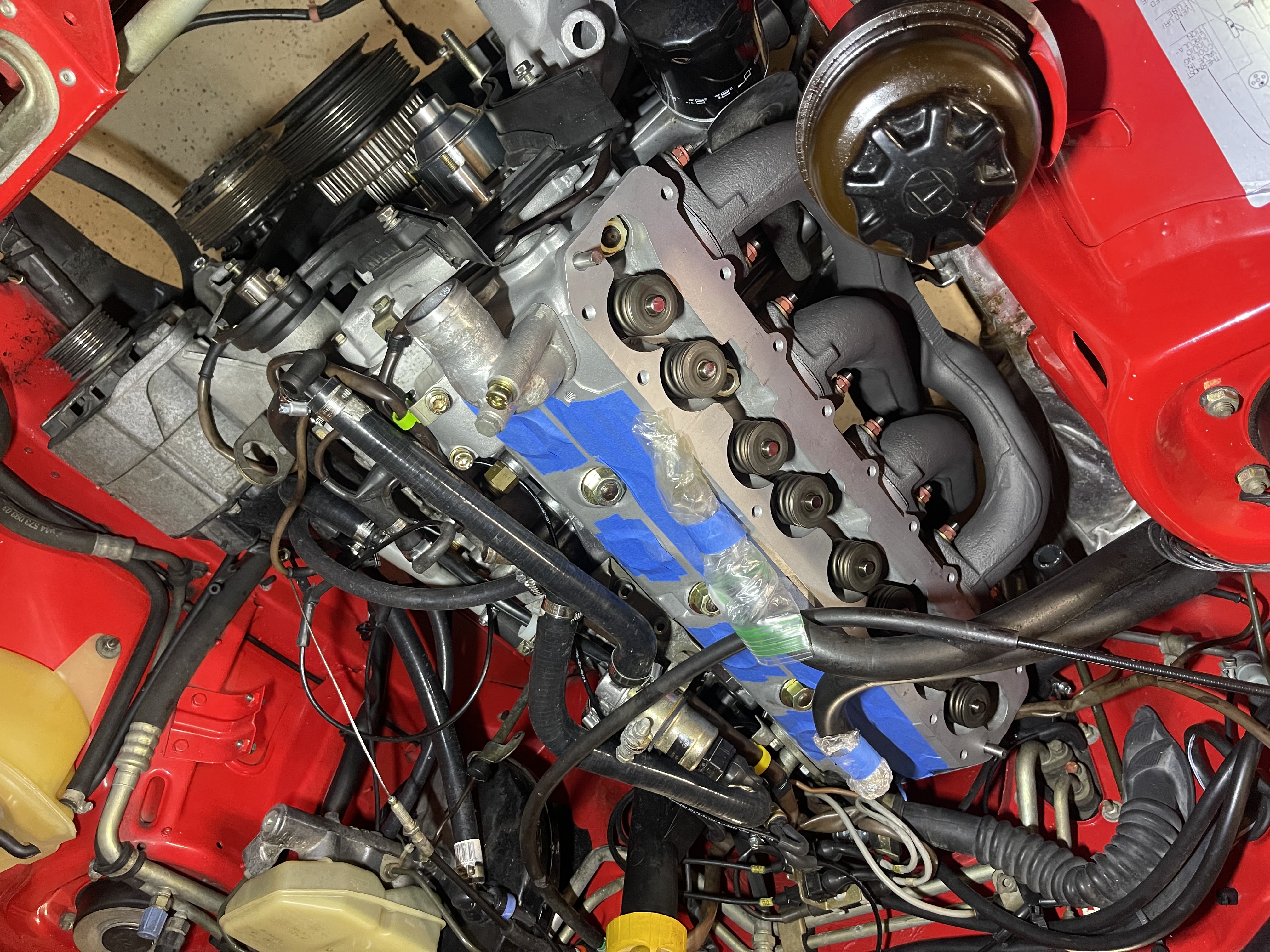

Posted: Thu Apr 16, 2026 9:52 pm
by libarra82
The exhaust manifolds are installed. They were nearly as difficult to install as they were to remove. The fit was very tight with the new Allen-style bolts, and I had to slightly drill out the bolt holes in the manifolds to get everything to line up properly. If I were to do this again, I would pre-install the manifold and the rear coolant neck onto the head before installing it in the car. The rear coolant neck was also a challenge to install with the wiring and the air-oil separator in the way.
