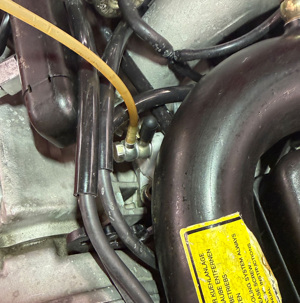

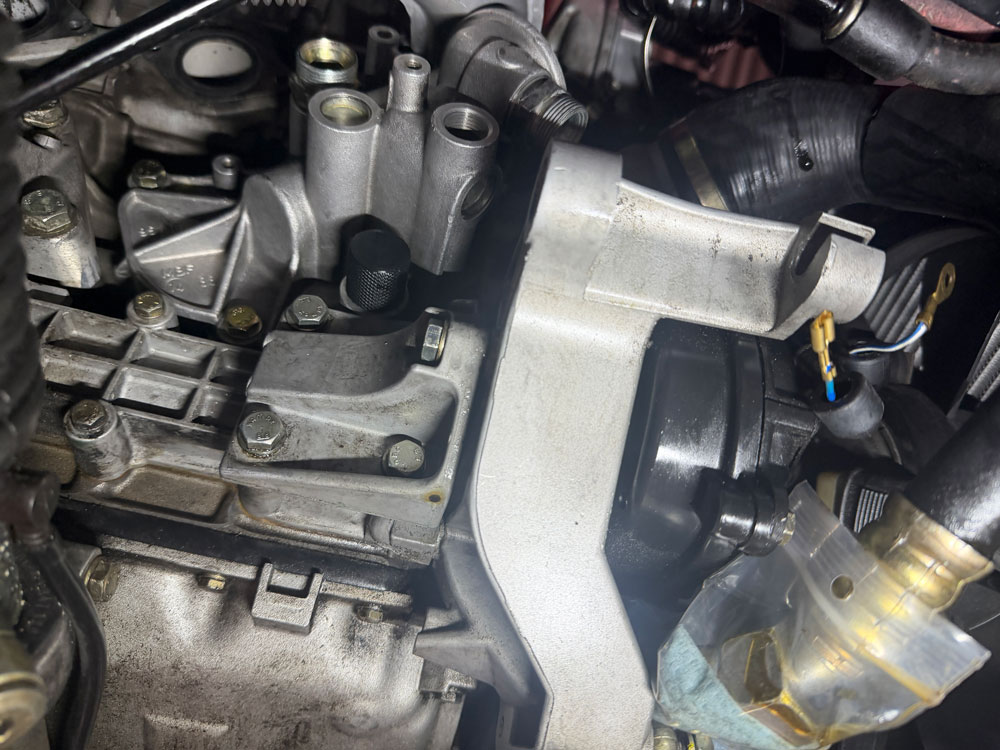

Today's update... I installed the oil console with a new Victor Reinz gasket and a thin film of Curil T2 on both sides of the gasket. (new connector pipe, o-rings, OPRV o-ring, etc.) I then temporarily re-installed the coolant pipe and filled the system with distilled water. It pressure tested great -- held 13psi for 10 minutes without a drop anywhere, so I think it'll be fine. Onward and upward!
I used my updated, 3D-printed OPRV alignment tool and it seemed to work great. After torquing the console in place, I removed the tool and the actual OPRV screwed in nearly the whole way by hand, so it seems pretty well aligned.

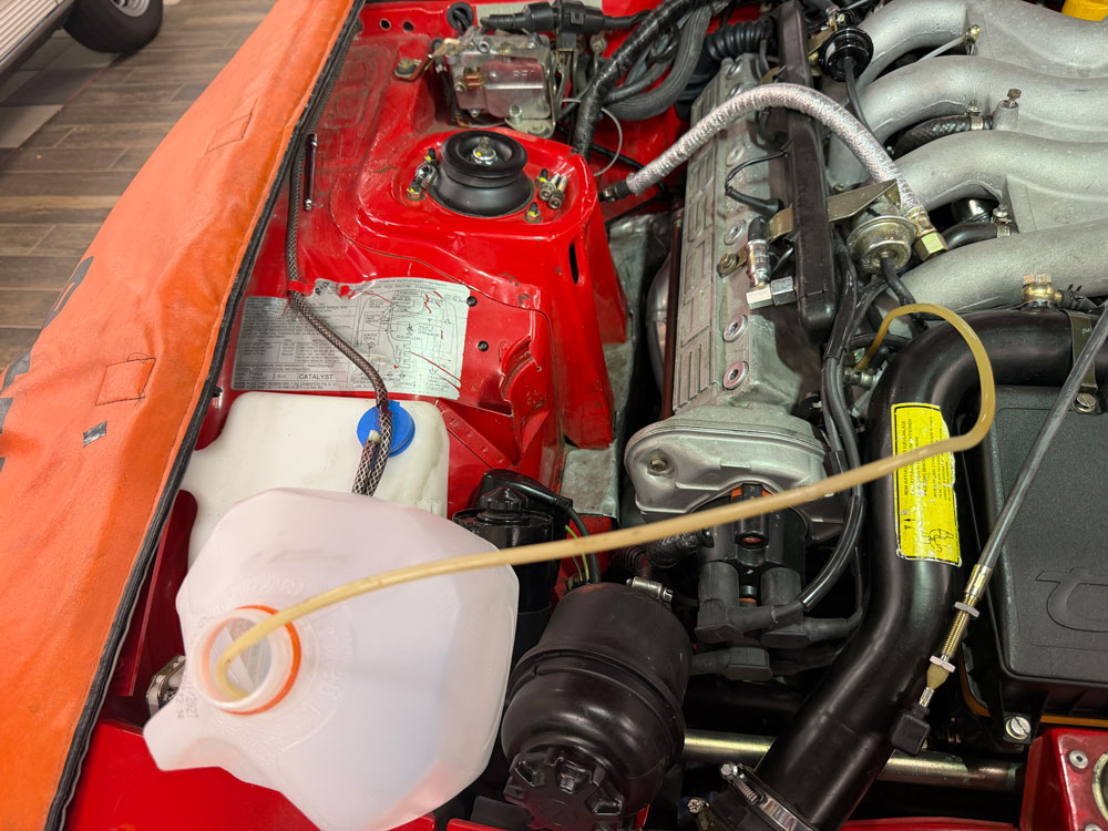

To vent the system, I didn't want to just open the vent bolt and let water drip down the motor. That would make it hard to detect leaks, so I really wanted to keep it all dry, yet still fully vent it. So, check this out. I used the banjo bolt from the intake manifold, which normally has the FPR and KLR banjos attached. I pulled that out and borrowed one of the banjo fittings to use as a spacer (capped off). Then I took the KLR bajo and line (from my old harness) and use it as a vent tube/drain. With this set up, I was able to use the pressure tester to fully fill the system and force water out the vent without spilling a drop -- all with parts already on the car. :mrgreen:

Genius method!! I hate the positioning of the vent. Awesome way to bleed it away from the motor!

t36 wrote: Tue Jan 13, 2026 6:38 pm Genius method!! I hate the positioning of the vent. Awesome way to bleed it away from the motor!
I was pretty pleased with that myself :) I might have to make up little kits (ya know, to give certain 944 stores new things to copy :lol: )

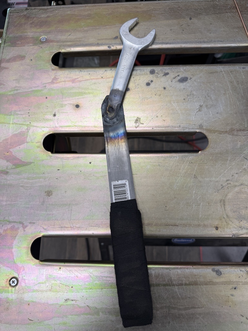

Before ever getting to the heat shield I noticed I neglected to install the little M6 bracket bolt that holds the oil cooler hose to the oil filter console. And of course, with the hose torque tight, the bracket didn't line up close enough to get the bolt in. So, my choice was to leave it without the bolt -- which I'm sure would have been fine but for all the lost sleep thinking about it -- or (gulp) loosen the hose somehow in situ. Getting to that coupling nut is impossible with standard wrenches, and I seriously cranked down on it when I installed it, so a stubby was never going to work. So, I took matters into my own hands and sacrificed a HF 'thin' wrench to make a tool that allowed me loosen the nut 10-15 degrees (so I could align the bracket) and then re-tighten... I present Frankenwrench-3... (yes, I've done this before...)....

Well fast-forward a month or so, and I was able to fire up the motor this afternoon with no apparent leaks. Still need to put the sway bar back on, with the new bushings, but looks like the new oil console gasket with Curil T2 is holding. :thumbup: Also pleased to report my oil pressure is fine/normal, meaning my 3D-printed Oil Pressure Relief Valve alignment tool worked! Will give it a full shake-down after getting the sway bar back on, but for now I'm just happy nothing is squirting out of the motor anymore. :)
