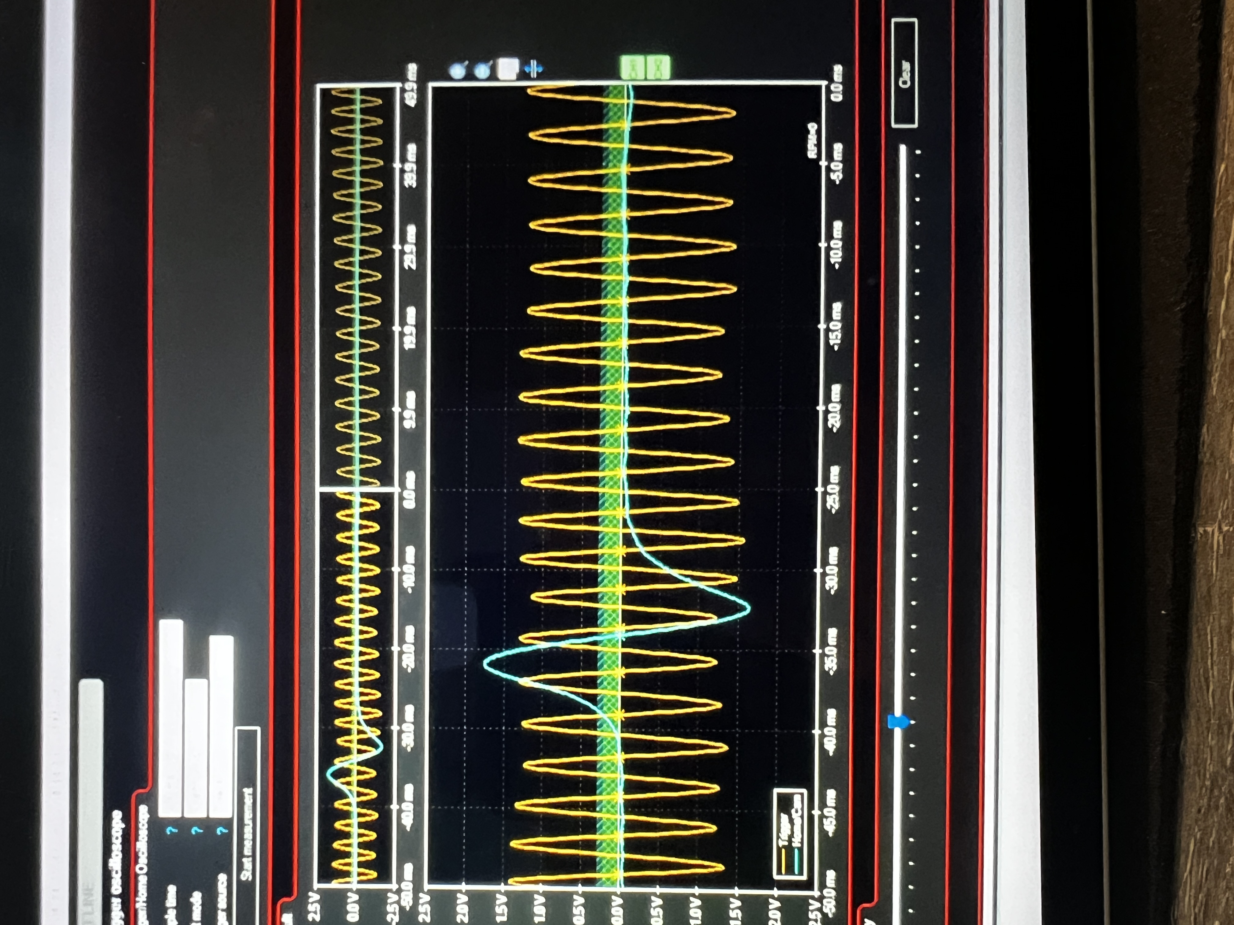

Hard to tell from your screen shot because of how zoomed out the display is, but does look a bit noisy. The TDC areas in particular look a bit odd. Would be easier to see the actual data though. If you can attach a log file we can look more closely. Think it should be a .MaxxECU-log file or .MaxxECU-Zip-Log file. or just export as .csv.944m3 wrote: Fri Apr 11, 2025 5:35 pm Going to need some time to digest that lol but great info.
I’ve added a picture of what I’m seeing. To be crystal clear, I have no idea what I’m doing and I’ve hadn’t had time to troubleshoot. I’ve literally spent half an hour or less with the ECU. So I don’t know if I’m graphing the right thing. I do want to study up so that I know what to ask.

Short update. I was able to figure out logging a little bit. At this point the trigger sensors seem to be working fine as we can tell in the picture. I’m getting steady RPM reading of mid 180. I did also try different Arming voltage but didn’t seem to make a difference. Started .2 at 200 RPM and tried .5 and .6 and also .7 as I’m seeing about 1.3v output from the trigger sensor. I think I have that logic right.
So now it seems no spark or signal to coil. I’m digging into that now. I used an inline light to see if I’m getting spark. The light did not go on as far as I could tell. I used the ECU test feature and interestingly the light goes on very very dimly. At first glance it doesn’t seem like it’s on. Last time I used for another occasion the light was nice and bright when cranking. So trying to figure out why the spark is so weak or if that’s normal for test from ECU. The vendor has assured me other customers have successfully started their cars with the base tune he provided. I’ll keep plugging along and learning as I go.

Now those look like proper speed and ref signals. Was I right to think that earlier scope shot was a configuration issue with the ECU or scope -- or did you have to fix something on the car to clean up the signals? As for the spark, if you are using all the same parts that ran ok on the DME, then my guess would be a configuration issue in the ECU set up.944m3 wrote: Tue Apr 15, 2025 1:59 pm Short update. I was able to figure out logging a little bit. At this point the trigger sensors seem to be working fine as we can tell in the picture. I’m getting steady RPM reading of mid 180. I did also try different Arming voltage but didn’t seem to make a difference. Started .2 at 200 RPM and tried .5 and .6 and also .7 as I’m seeing about 1.3v output from the trigger sensor. I think I have that logic right.

@Bergerac Will send a screenshot of the ignition config tomorrow. And yes the software does record sync errors. But not reporting anything in my case so I’m going to assume it’s happy.
@Tom I changed the Sample Time, basically zoomed out. Made no changes to the triggers, such as adjust the gaps. Meaning that it seems the adapter harness is working correctly.
