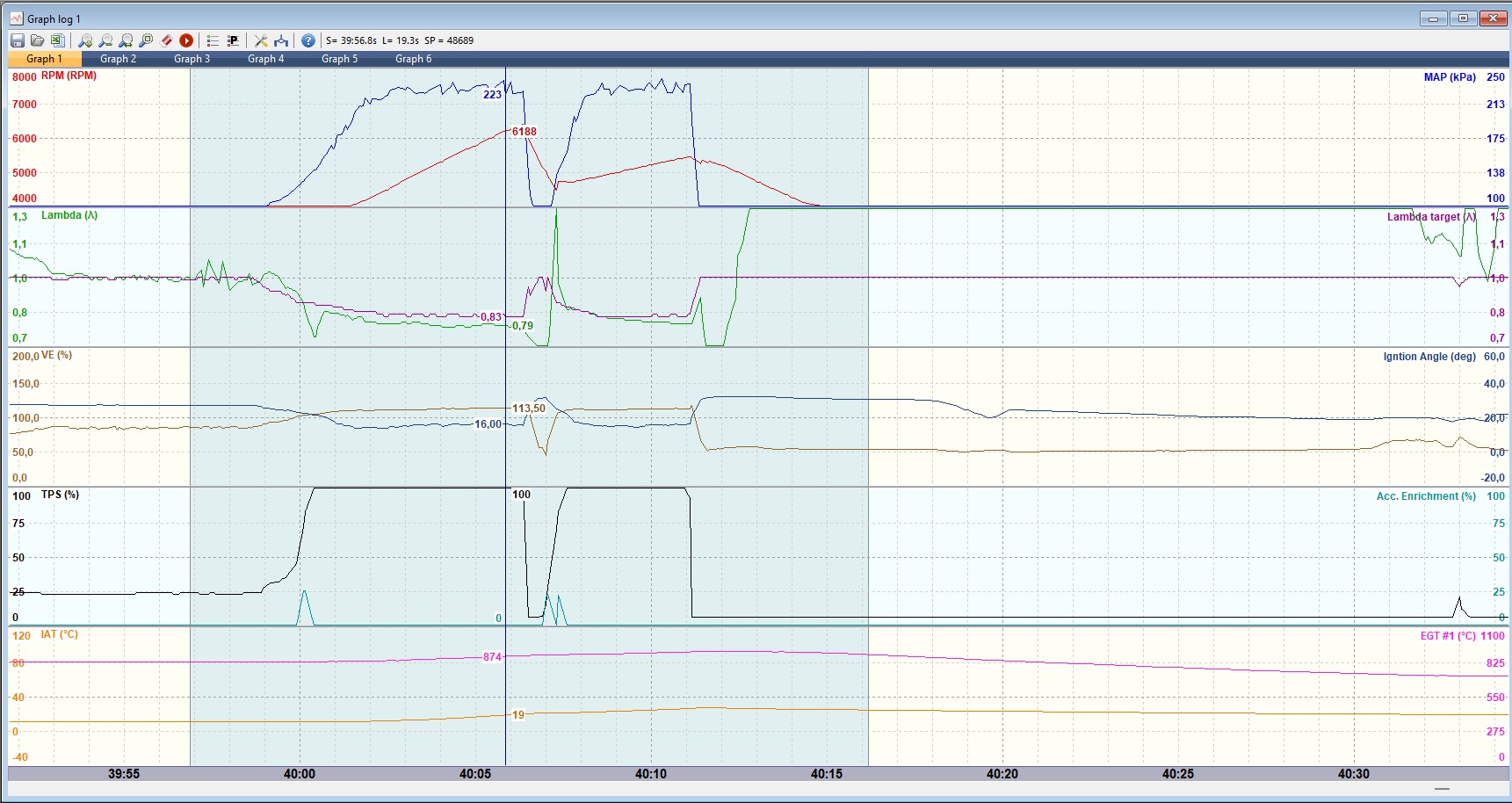

ealoken log.jpg (320.16 KiB) Viewed 2258 times
Here is my log from last night.
OE IC is the next choke point, see the IAT and EGT rising.
GTX3576 G2 turbo, full boost by 4000 and out.

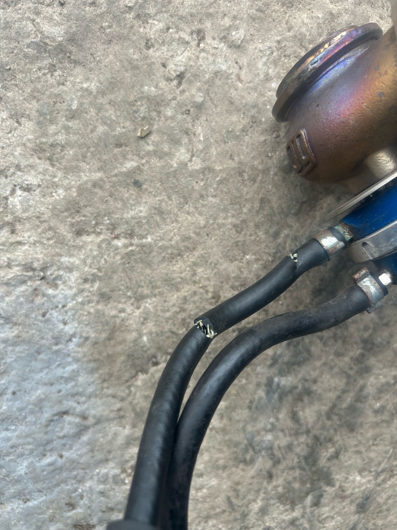

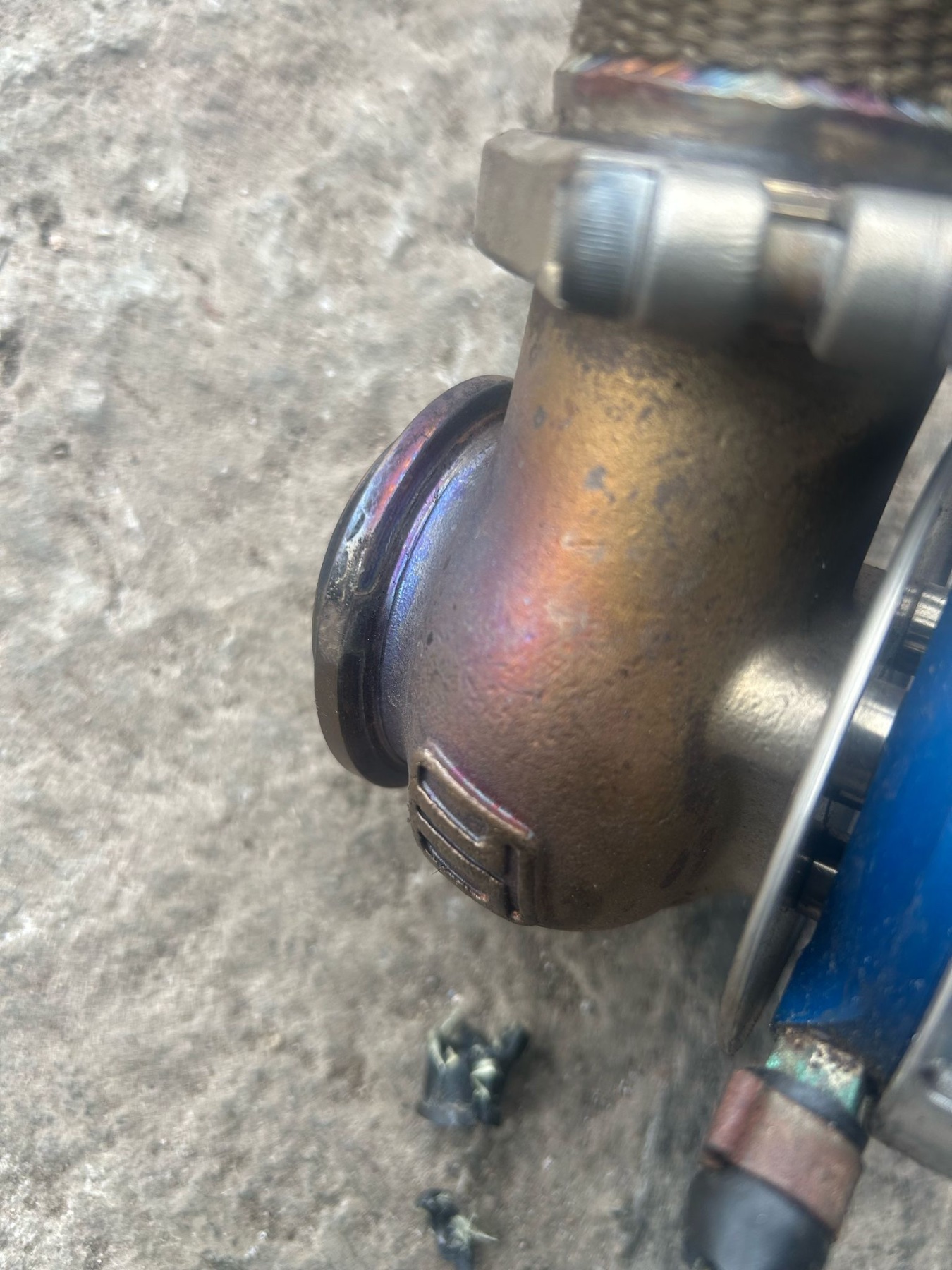

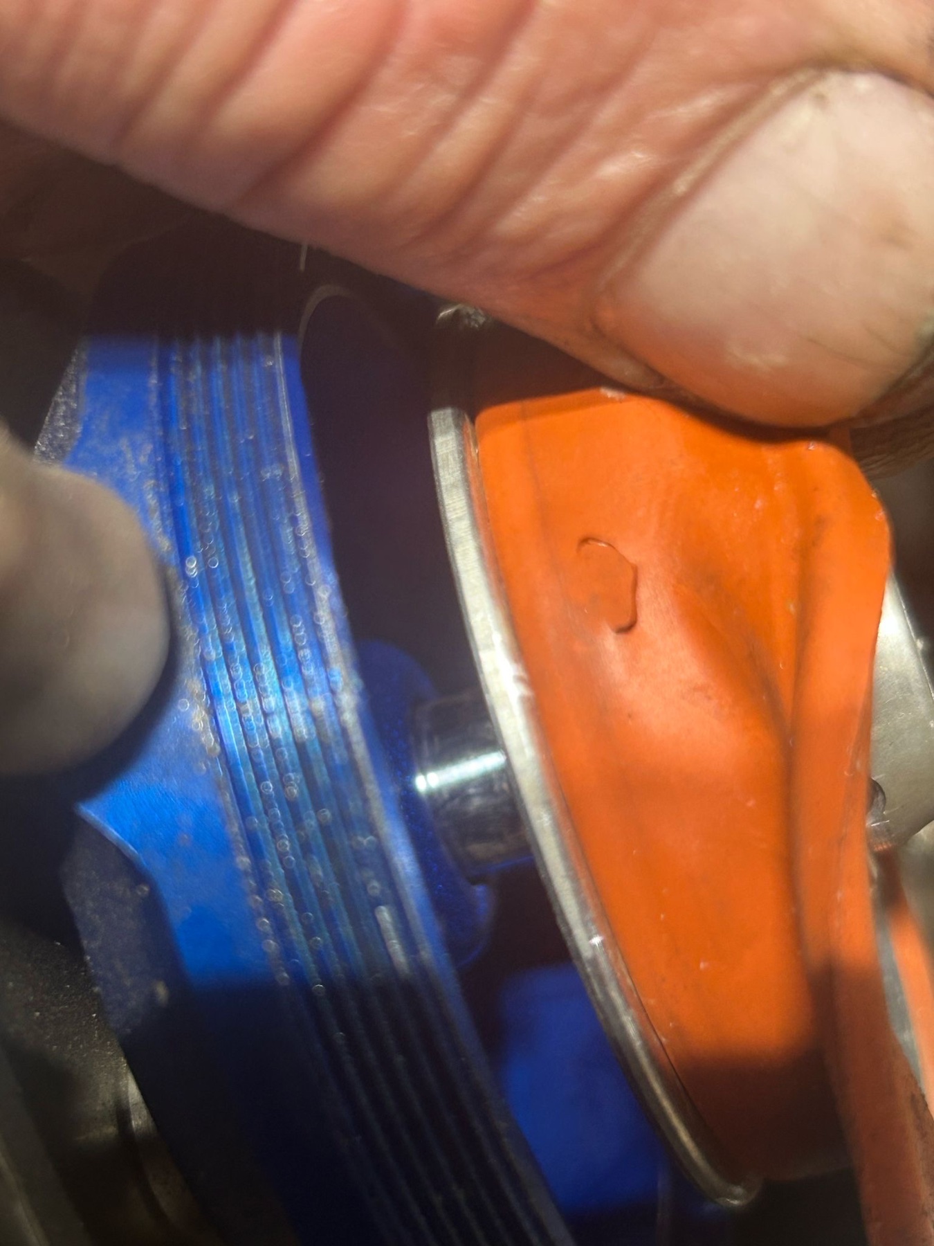

After taking the wastegates off Will found that one of the diaphragms has a tear and the other wastegates which looks has heat resaltes damage to the control pipes as you can see above. This obviously is affecting achieving boost. Will has ordered new silicone hoses and a new diaphragm so hopefully we have resolved the problem. The only other thing is one of the wastegates is obviously getting a lot hotter that the other with the citation of the metal body which could be related simply by its location the other wastegates is lower down the manifold and has more air circulation. Any thoughts on this?
