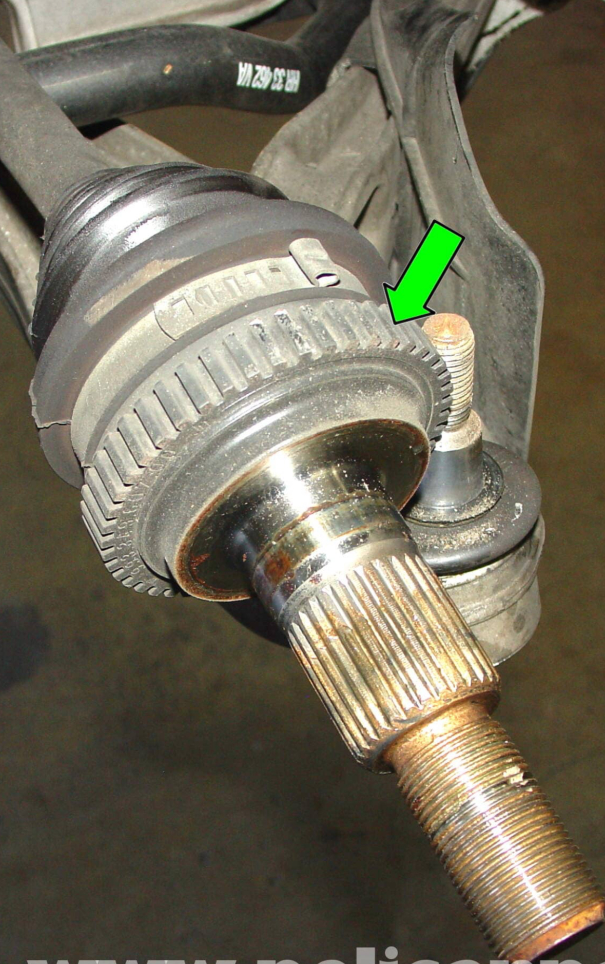

Parts ordered:
Do those stub axles work on the 4wd upright? My understanding is the 4wd has the abs pickup on the larger diameter of the cv joint, not on the spindle.
Re: 997.1 C4S RWD conversion
Posted: Wed Jun 18, 2025 7:37 am
by Maruscmn
Mark,
Yes those stub axels work on my 997.1 with no problem. I think the confusion is in the difference between the model years. For example here is a pic of a 996 turbo (from pelican) front axel. Notice the "teeth" on the axel.
And now look at my front axels:
Notice how mine are smooth which matches the stub axels purchased. The wheel speed is picked up in the bearing (I believe) hence the reason I do not get any ABS codes. If this didn't work, my car would be very upset thinking the wheel was locked.

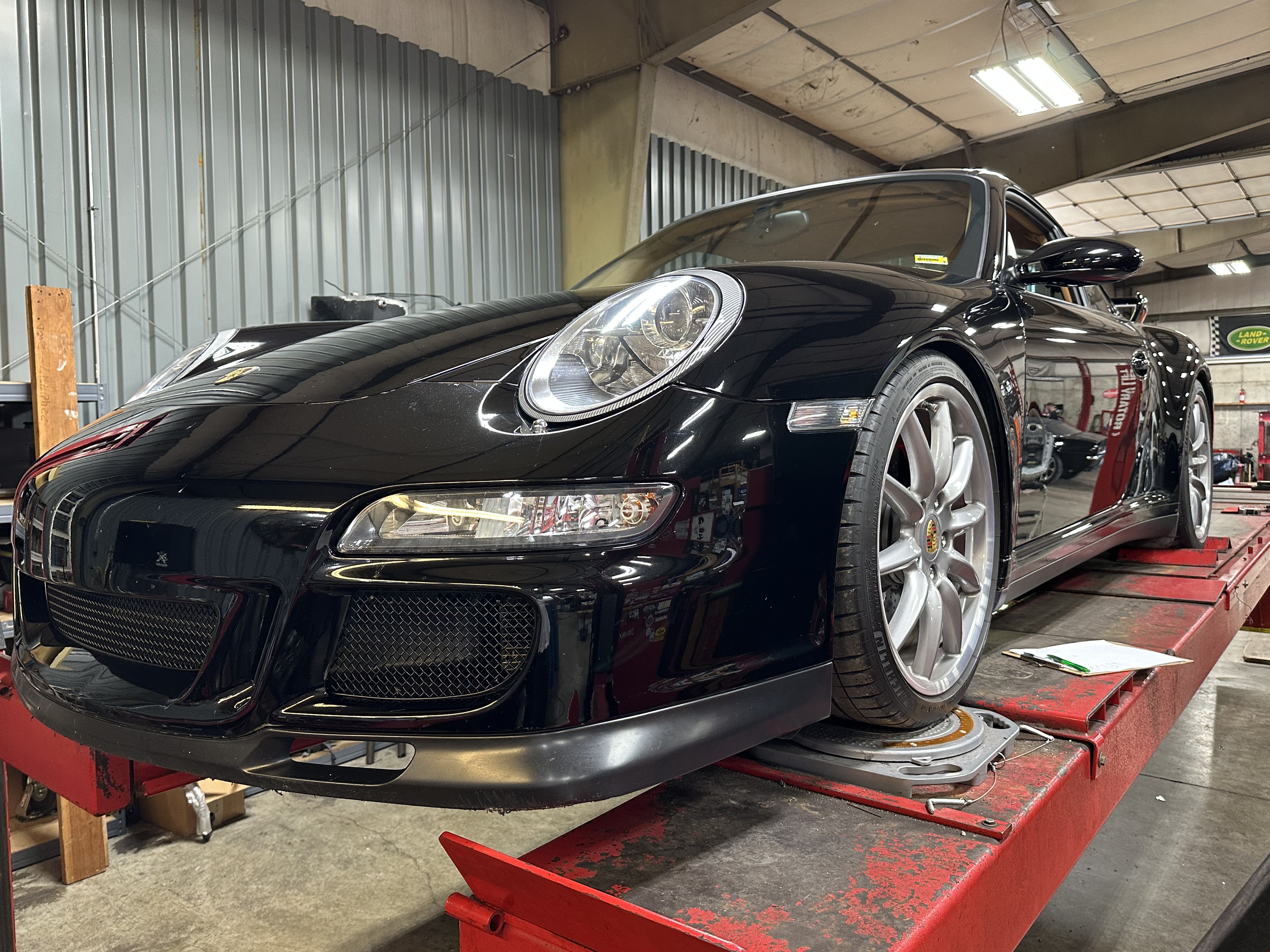

Posted: Thu Jun 19, 2025 4:06 pm
by Maruscmn
@ROB III , Thanks! Now look how bad my toe was! Im supper embarrassed to say I have never had an alignment since I bought her in 2018!

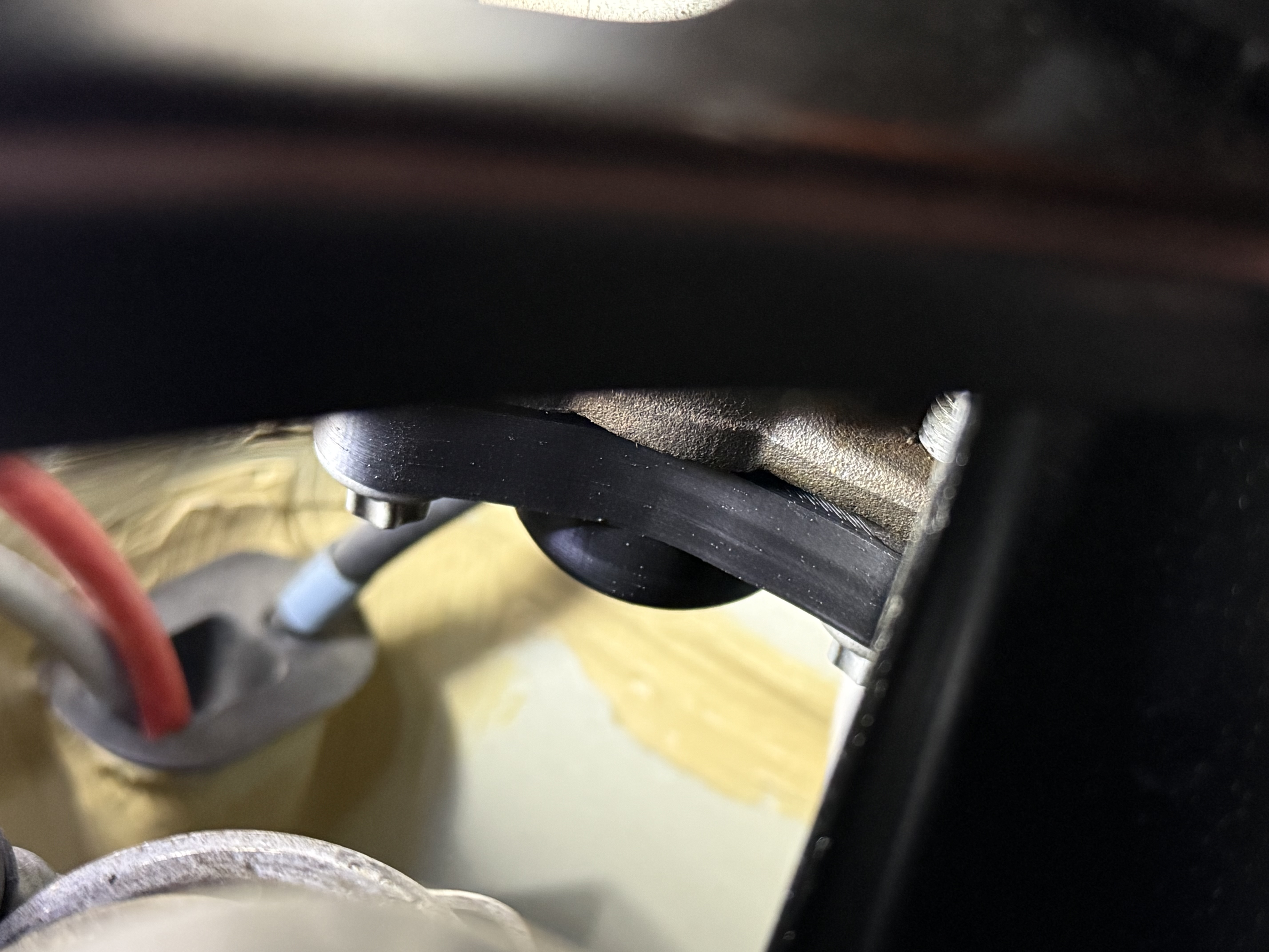

Another update! Toms 3d printed cover is working like a charm and is in perfect condition!
