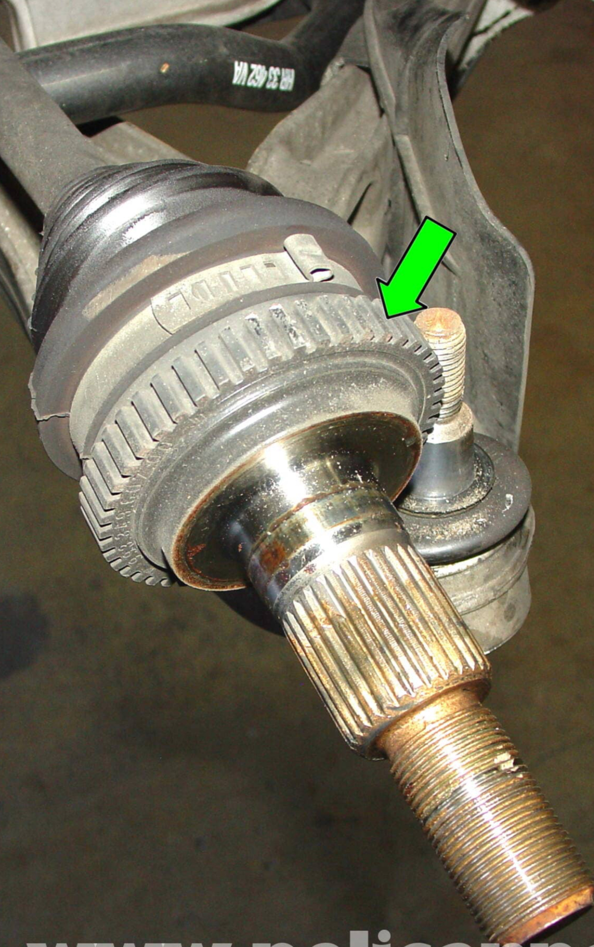

Do those stub axles work on the 4wd upright? My understanding is the 4wd has the abs pickup on the larger diameter of the cv joint, not on the spindle.

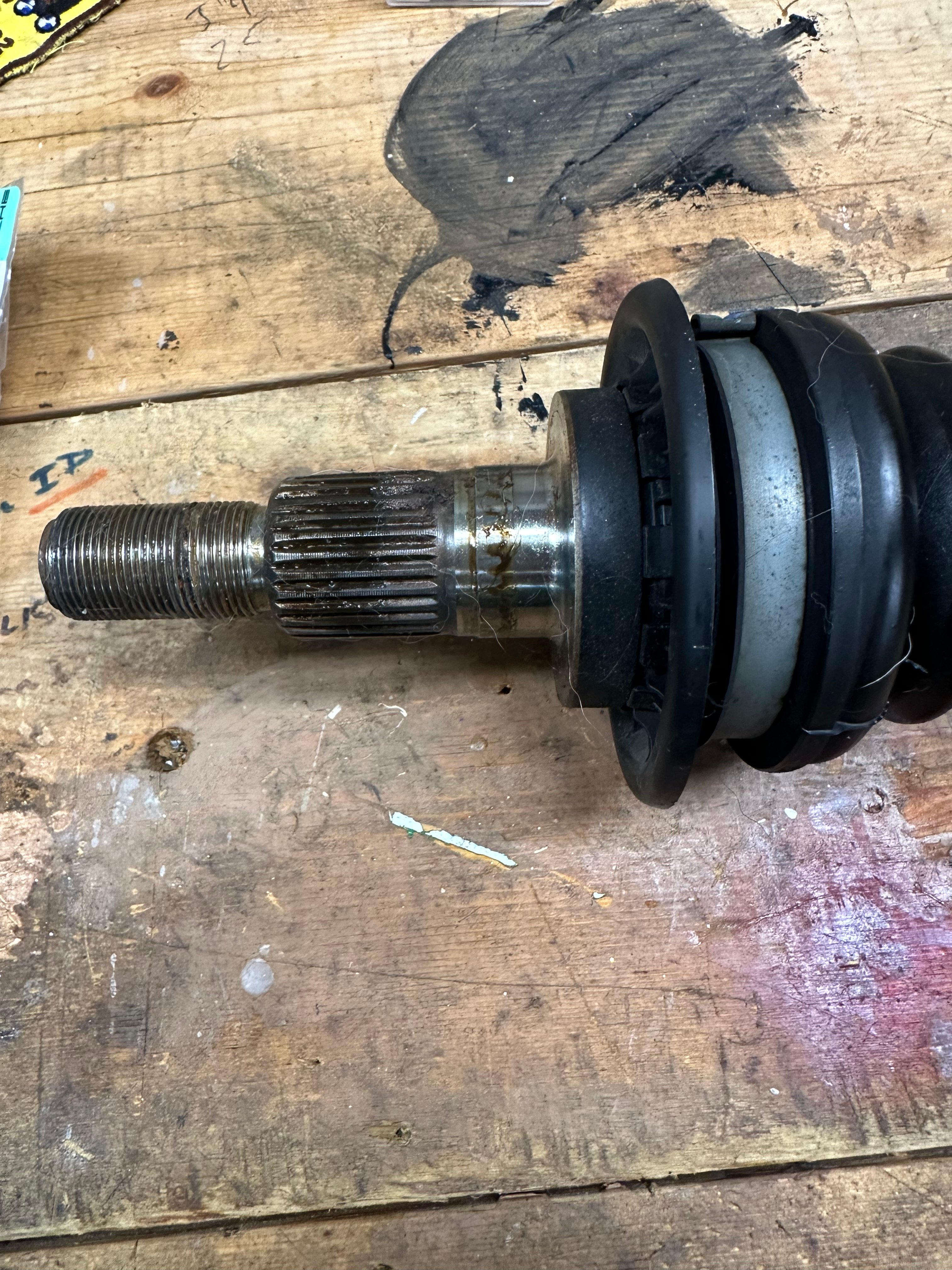

Yes those stub axels work on my 997.1 with no problem. I think the confusion is in the difference between the model years. For example here is a pic of a 996 turbo (from pelican) front axel. Notice the "teeth" on the axel.
And now look at my front axels:
Notice how mine are smooth which matches the stub axels purchased. The wheel speed is picked up in the bearing (I believe) hence the reason I do not get any ABS codes. If this didn't work, my car would be very upset thinking the wheel was locked.

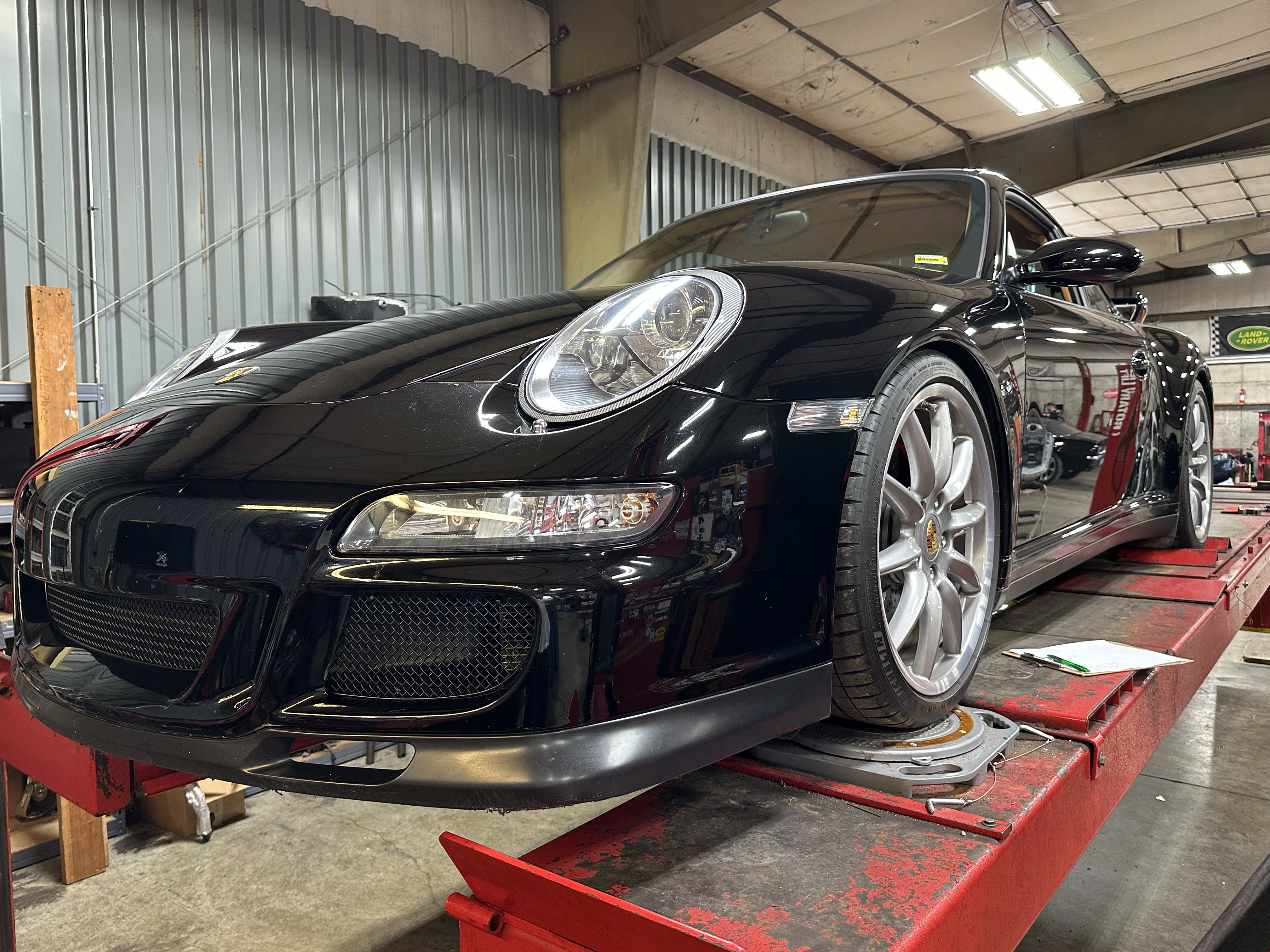

Today I am getting her aligned!
Mike

@ROB III , Thanks! Now look how bad my toe was! Im supper embarrassed to say I have never had an alignment since I bought her in 2018!
