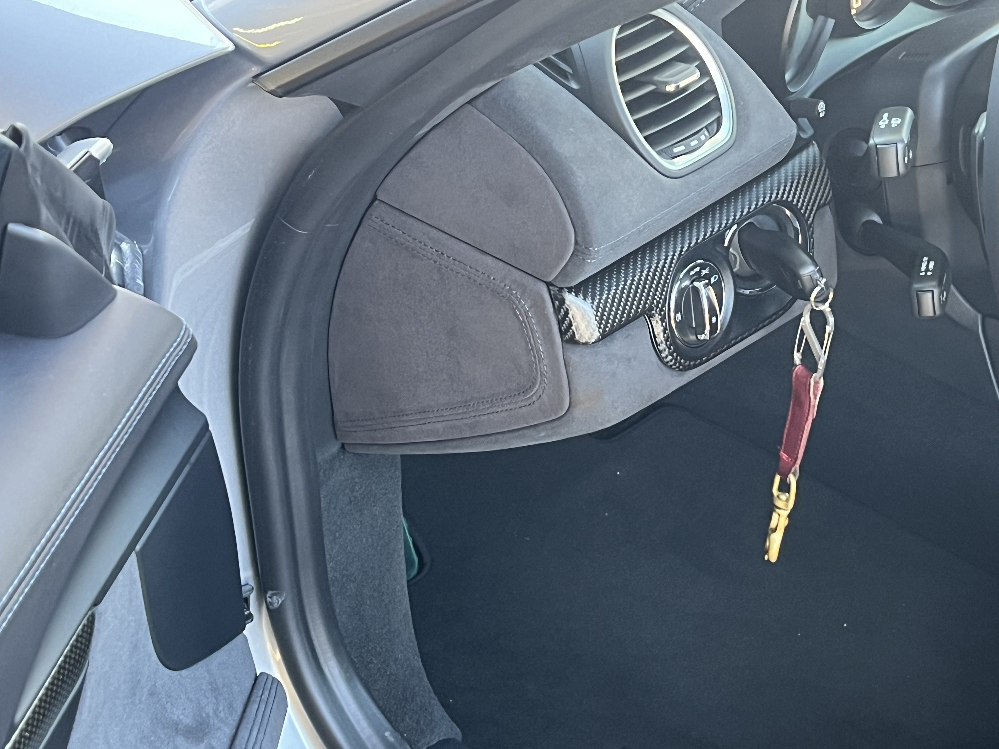

71eh wrote: Sat Oct 19, 2024 9:12 am Long over due... Some pictures of the completed French Stitch fuse box covers and Alcantara dash ends, made by none other than our very own @Crazy Eddie !!!
Wow. The lower dash end caps and fuse box covers came out very nice. FWIW, Crazy Eddie can also do the dash upper end caps in Alcantara to match your lower end caps. He doesn’t do stitching on those because it gets “too busy.”
Attached is a photo showing the upper end caps on one of Ed’s GT4’s. He’s making me two in leather to match my leather lower end caps.

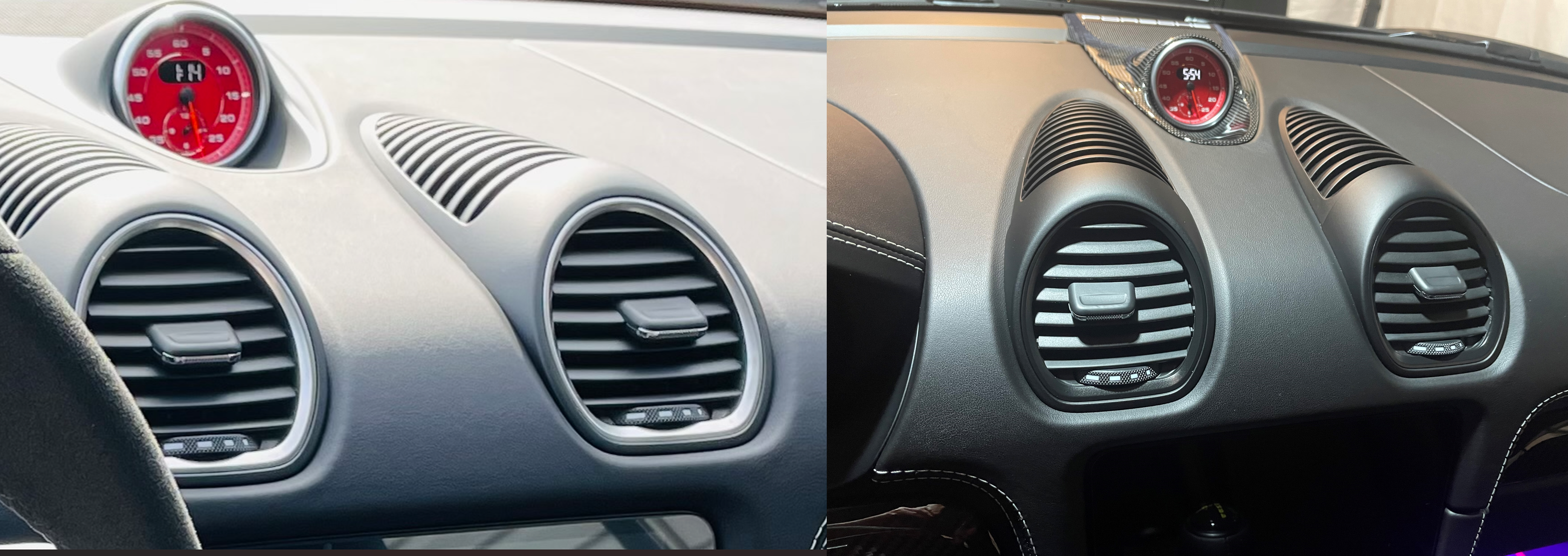

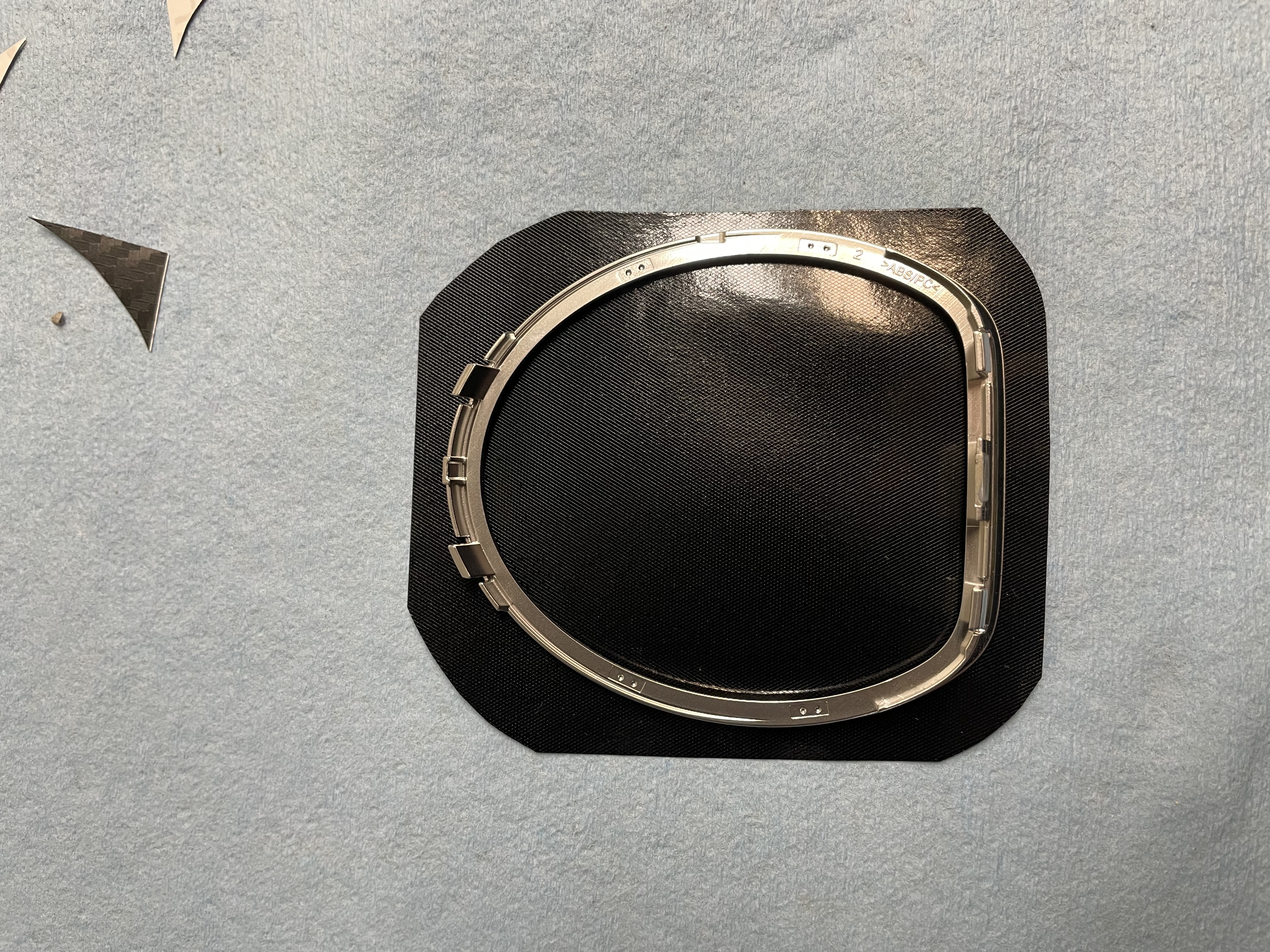

De-Chrome Air Vent Rings: I forgot to post this....
While I continue to modify my interior with the goal of getting rid of all plastics and shinny silver "metal", I kept coming back to the idea of the air vents. It does not bother me enough to change out the whole air vent, but I have always been curious if it was possible to just pop out the silver/metal ring, and paint it black...
So I did... Was easy, and LOVE the new look.
All you need is a thin pry tool and just work your way around. They pop out quite easy. I used VHT spray Paint "Roll Cage and Chassis", satin finish.
Before and After
