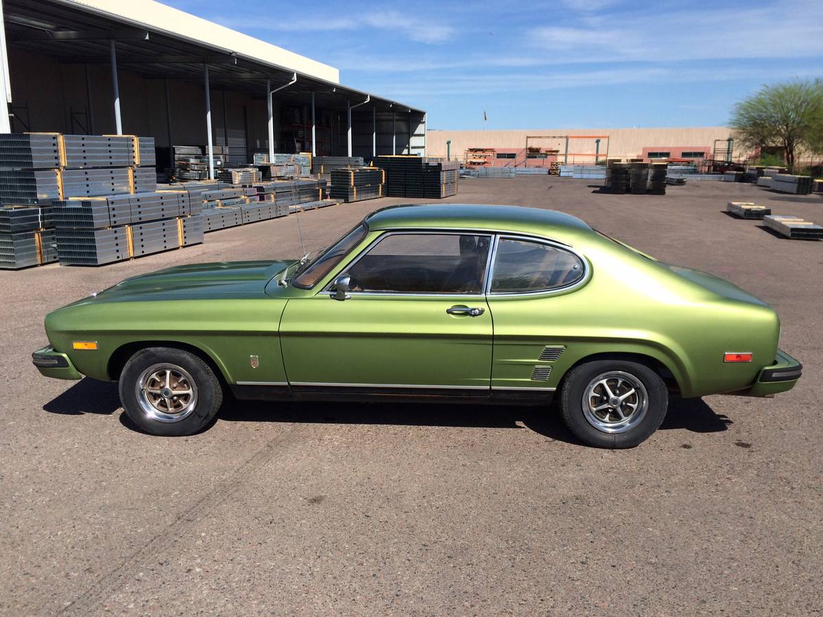

A 1974 Ford Capri was my first car that I ever owned. I bought it used in 1977 and it came with the 2.0L in-line four with the twin-barrel carb. The shifter linkage (all rods were exterior to the transmission) and the front suspension bushings were nothing to write home about. Made in Germany which meant it had Bosch electrics...good thing too.
But the car for its time as well as now, had great styling. A nice car.
Not my actual car, but the same color with the tan interior. I bought it off a Shatner in Montreal. I said, "are you related". "Yes, William Shatner is my uncle".
