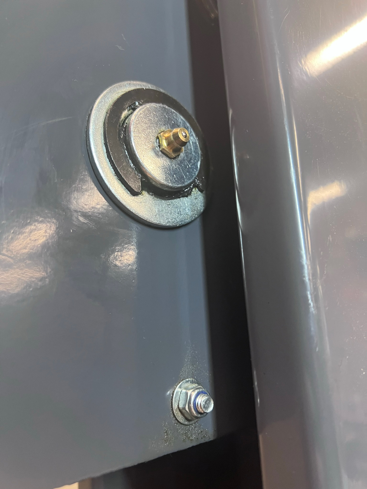

At any rate, if helpful, here are the parts I lubed to make my BendPak quiet....
I used regular old bearing grease on 8 Zerk fittings....

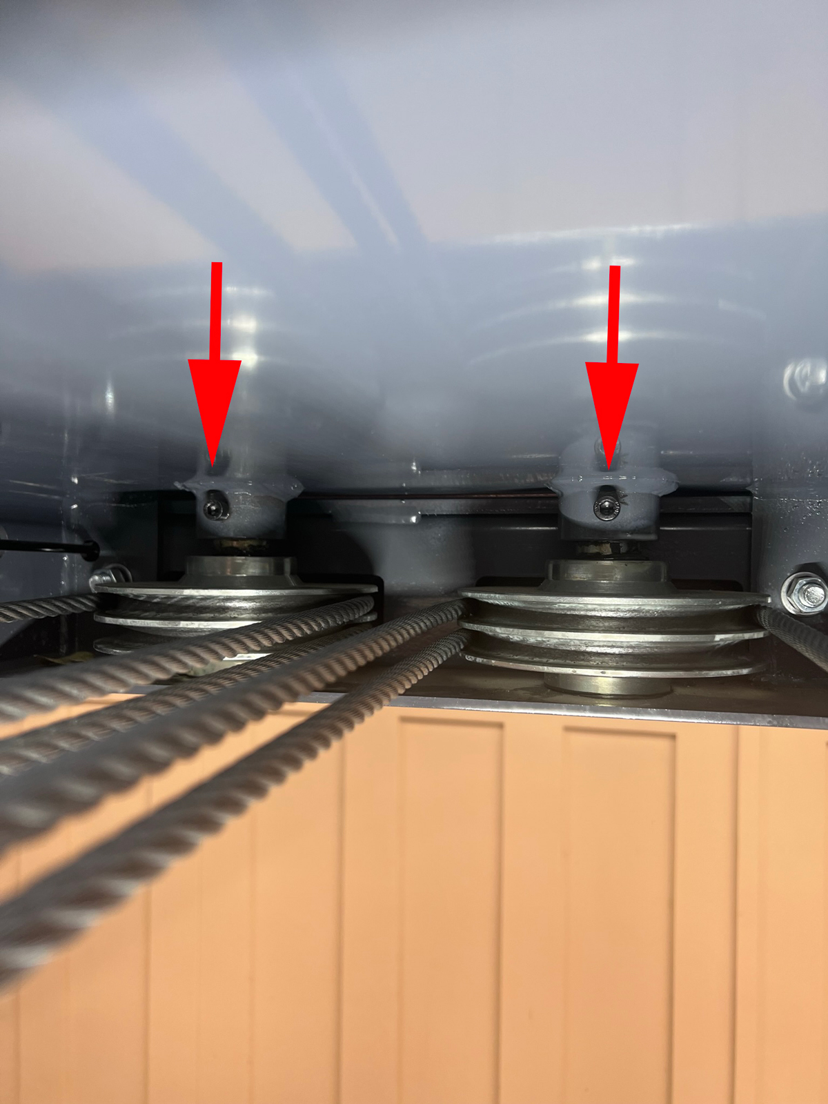

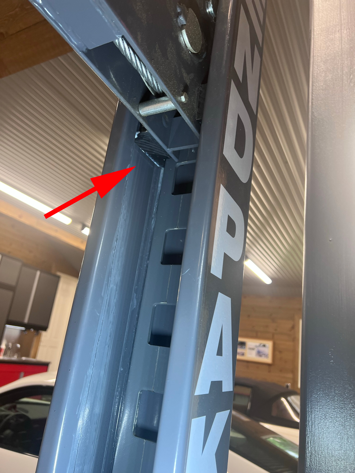

I sprayed white lithium on the plastic blocks that rub against the post, and on the pulleys (sheaves), and rubbed the cable itself with 90weight oil -- per the manual.

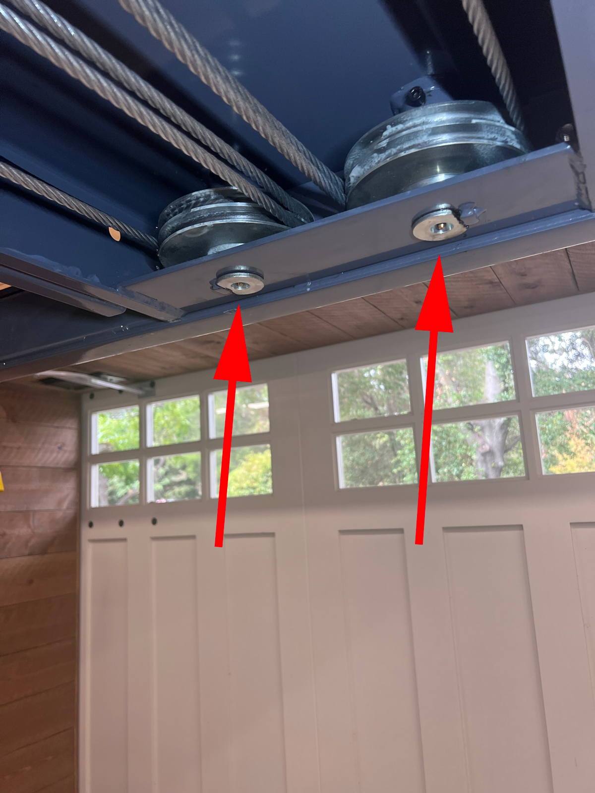

Not sure if all lifts have these Allen bolts holding the pulley axles in place. But mine were finger tight at best. Tightening them down cut the groan by half I'd estimate!
