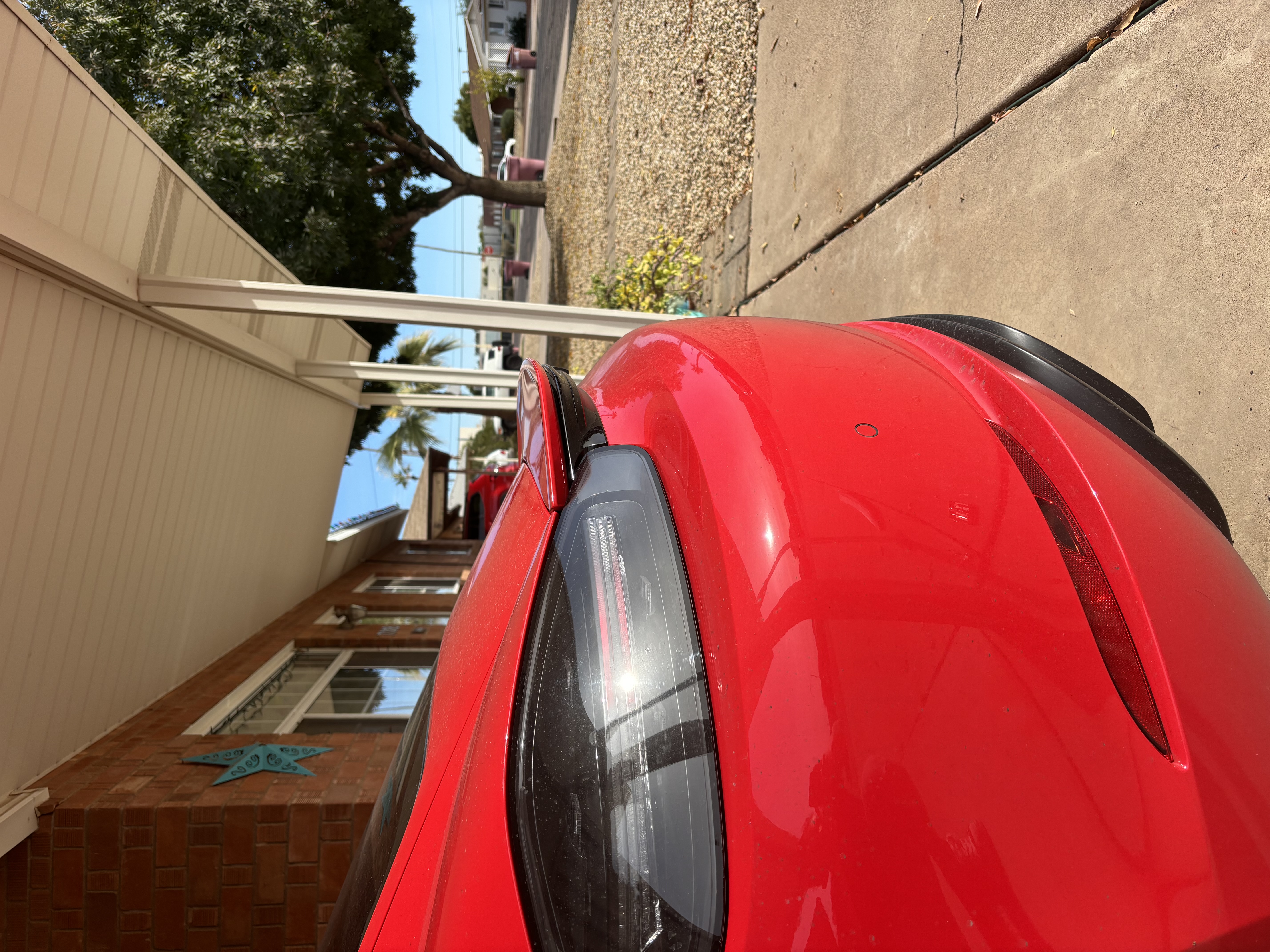

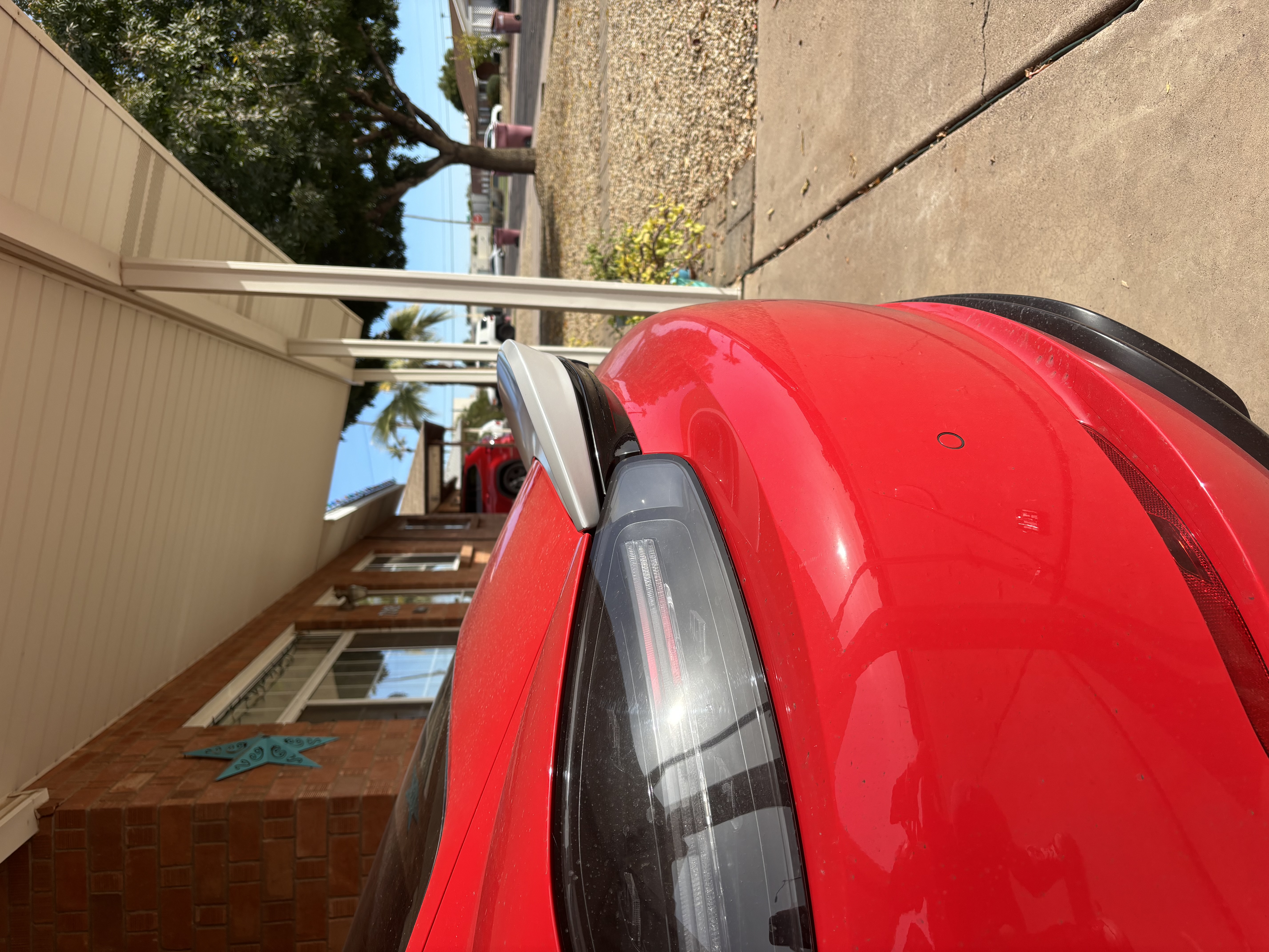

Mock up of the Frog Venom rear spoiler
Frog Venom GT4 style Carbon Fiber Duck Tail
Stock GTS
Left both spoilers with the paint shop today so they can match it as close as possible.

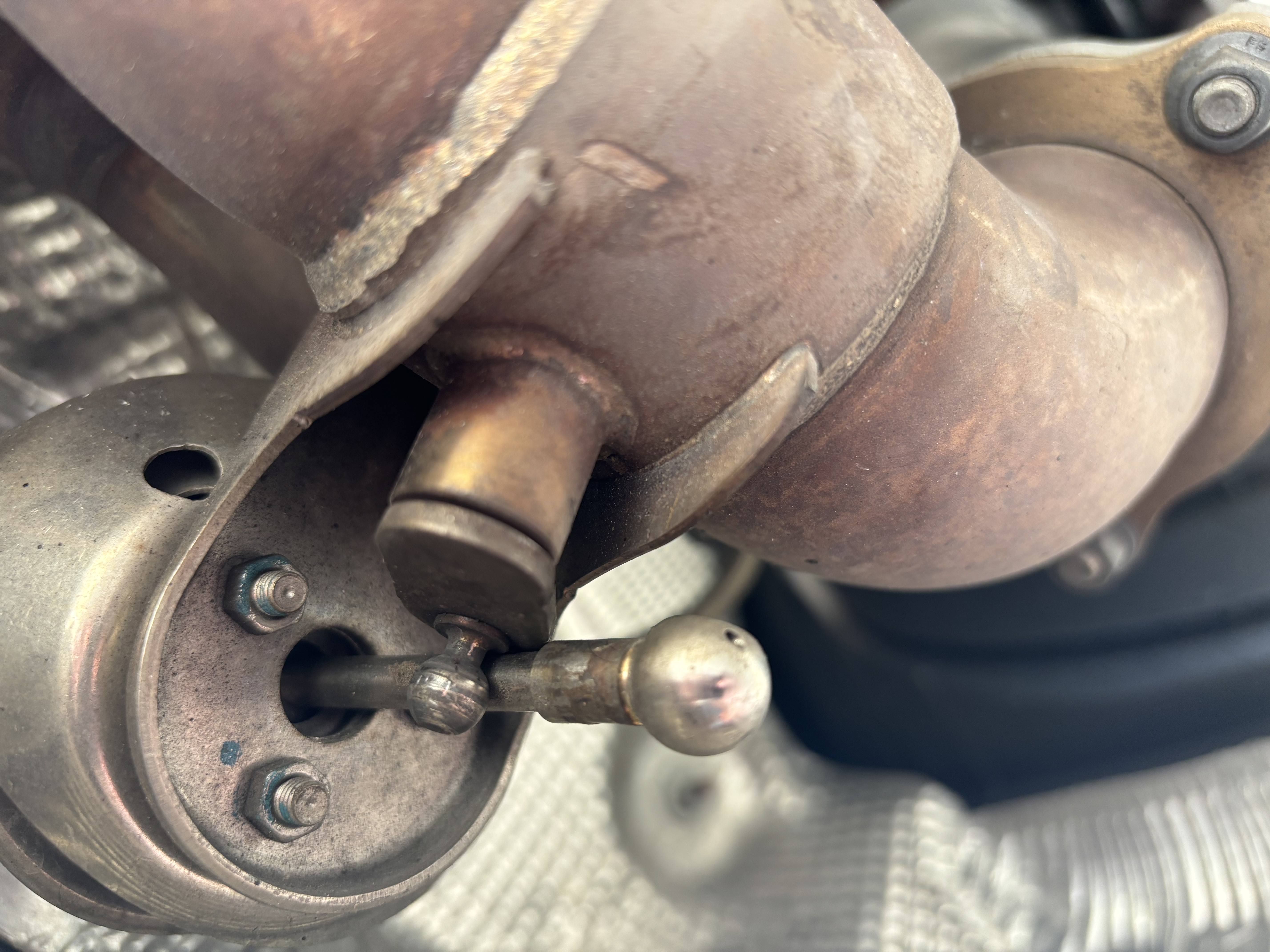

One of the tracks that is hosting the next track day has a sound restriction so I wanted to practice forcing the valves closed. I found if you simply remove the spring clip and remove the ball socket you can tuck the lever behind the actuator arm and put to to always quiet mode quick, simple and free
Will try this for a few days and also play with the Sound Symposer on and off to see if I can notice that at all.

Can't find it now, but I read something several months ago that stated tracking with the exhaust valves closed could possibly damage the engine. Allegedly, it had something to do with excess back pressure. Regardless, I have no actual proof, no direct knowledge, and I'm not an engineer, but thought I should mention what I saw.
Perhaps someone here with first hand info can opine and set the record straight.

Seems like I've heard something similar, but mine is a vague recollection with zero attribution or confirmation. :think:

That's going to look great Jeremy!

Regarding running with the valves forced closed causing engine damage, overheating the catalytic converters I have read similar things on the forums. Part of me was skeptical because every other vehicle on the road has an exhaust manifold, a catalytic converter and then a muffler. I have not seen any proof of a problem, I can't tell of it is an old wives tale or internet folklore. If someone has proof please share. I asked Scott from Softronics tuning and he said it is a false fear and there is no danger of me running with the flaps closed. The only way to overheat the cats is to run the engine way too rich so that the excess fuel is burning in the catalytic converter.
On the other hand, I did not notice much difference from the sound symposer, not enough for me to attempt to defeat it. I did notice that the exhaust valves do add a lot to the experience and personality of the car, I am going to go put the valves back shortly.
