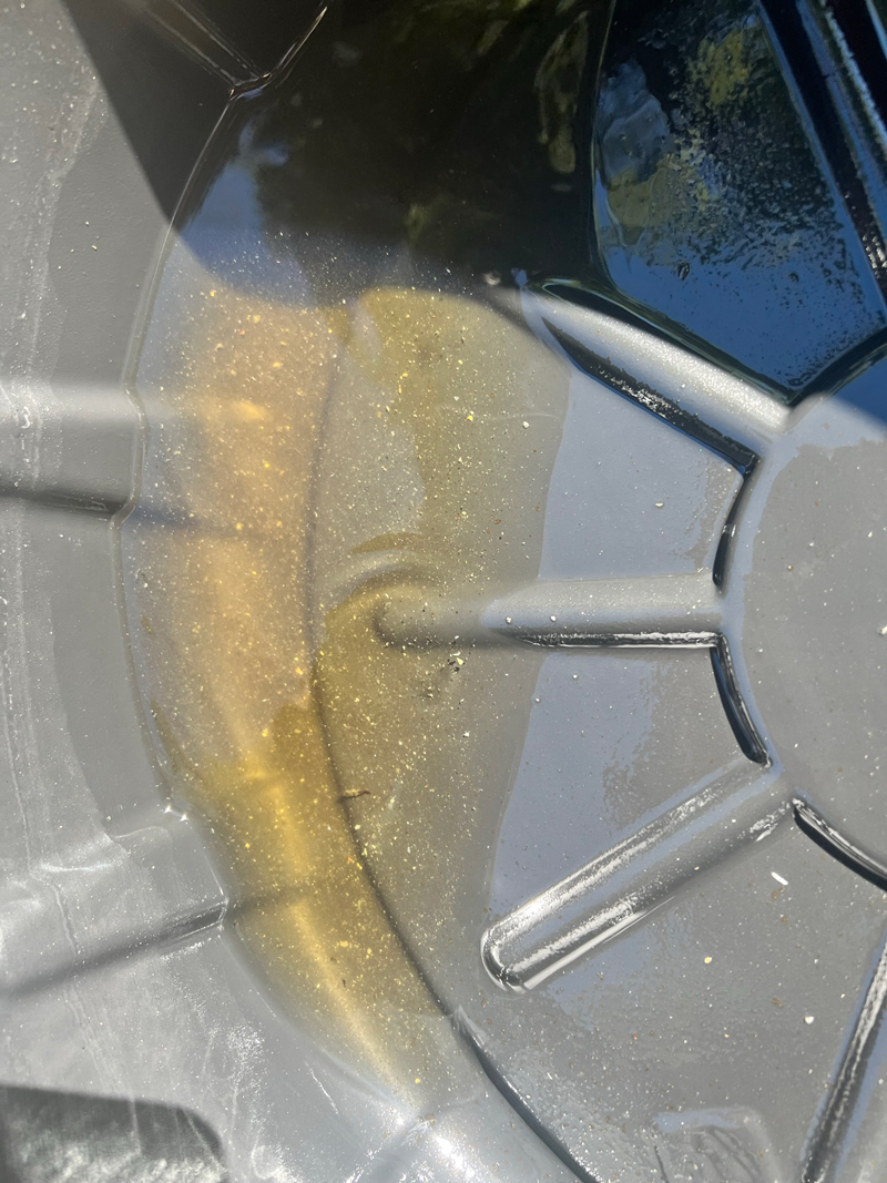

Fast forward 3 years, and the fuel pump is screaming again on the first really hot day of the year - about 96 degrees here today. Since my car is no longer pushing big HP numbers, I'm going to go back to a factory pump and I guess change the filter and strainer again. Not really sure what else to do. If fuel system contamination is the cause (see metal flakes in the gas above) then maybe each time I change the pump I'm getting more out. This one did last 3 times longer than the last one. Fairly stumped on this otherwise. It's not a problem 944's are known to have, so I doubt it is an inherent issue with the design, but I really don't know.

Thanks Michael. Since I've detuned the car over the last few years, I am going to go back to a stock pump in case the big pumps are straining the factory lines. That said, I ran my first 044 pump for a decade before it started doing this, then three pumps in a row have failed. I'm also going to try to flush the tank this time (somehow?) as I saw a distressing about of metal flakes in the gas last time this happened. Among my many theories is that I picked up a load of bottom-of-the-tank debris at the e85 gas station when this first started. I work at a gas station as a kid, and the owner always told me never to get gas right after the truck delivers gas because it stirs up all the junk in the underground tanks. He filled a pan with gas right after the tanker truck left and it was pretty horrifying. Of course, that was during Hoover Administration, so I'm guessing things have gotten better since then...
