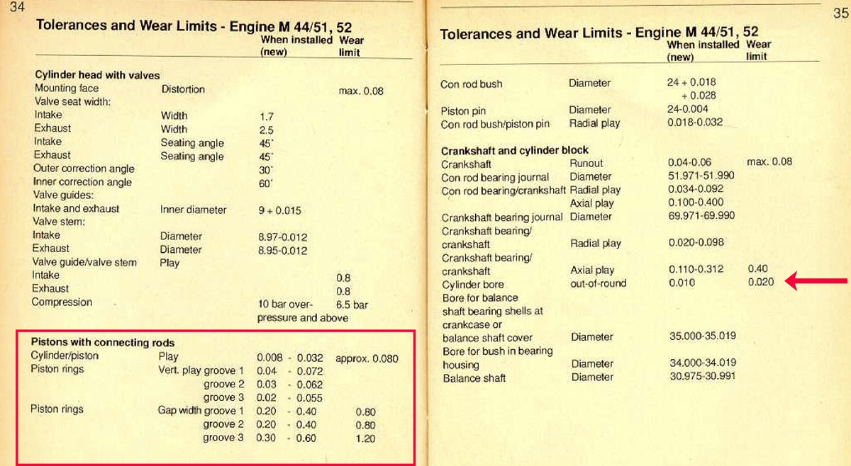

re: pistons and bores - How do those numbers look wrt taper? Additionally, is it insane to mix-and-match pistons/bores to chase more even clearances?
I keep going back and forth on just getting new pistons.

Translating those clearances to metric, it looks like you are under the wear limit, but getting close. I'm sure there are a few good miles left in those parts, just hard to know how many. Was it burning oil before you took it apart? I'd check the ring grooves too before deciding. I'm a broken record I know, but I'd either suck it up redo the bores and get new pistons, or do neither. If you re-use those pistons in those bores, I wouldn't swap pistons and cylinders. It doesn't look like it would reduce the clearances in any meaningful way, and the mismatched wear marks might speed up further wear. Sounds like you have the specs, but here is a page from the tech spec book if helpful....

Oh, duh. I should've looked for that...I actually didn't give you guys the measurements needed for that. Nor did I take them...Everything listed is perpendicular to the crank axis. Out of round requires I measure all those rotated by 90 deg! I should've done that today, ack. That plus the ring clearances will be the last bit of data I feed into whatever decision I make about the pistons.
re: ring clearances - Wasn't noticeably burning oil. #3 had a worryingly high leakdown number (somewhere around 20%?), but I meant to give a double check on the stand. Forgot in my excitement to crack it open, so here we are. It is the most egg-shaped cylinder of them all, no idea if that is related.

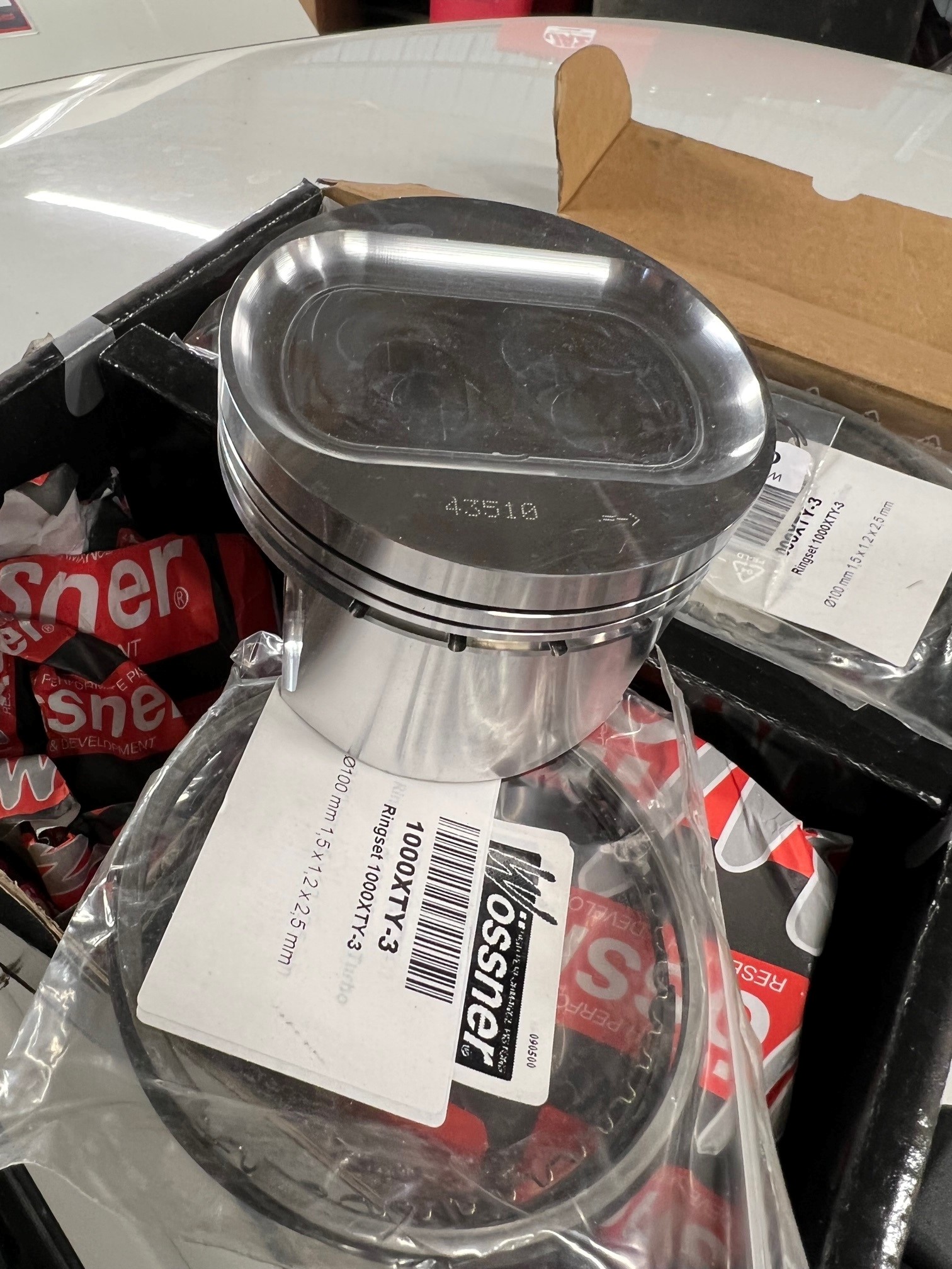

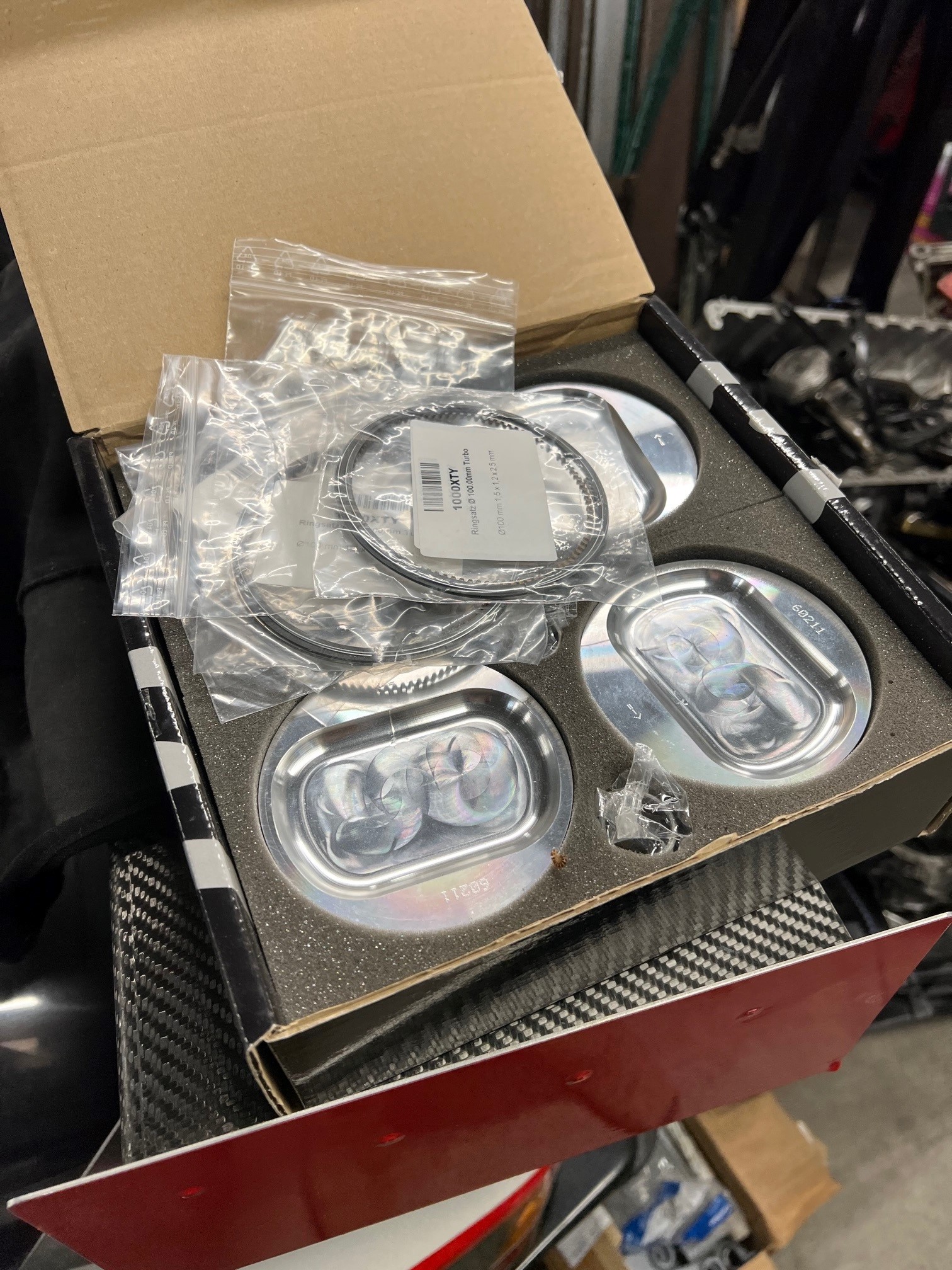

just for fun I took a look at my parts shelf and found some stuff that you might be interested in -
Two sets of 100mm wosners - one for Alusil and one for Nikasil!
Wossner wants $800 a set, I have had these here for a while (almost forgot I had them!)
Take your choice for $600. :)
Ooh, well that's a pleasant surprise! I'll surely take you up on it, let me figure out what's gonna happen to these bores first though. Go ahead and re-forget about em for a few days ;)
...I'm assuming these are from before Wossner had their little coating incident?
