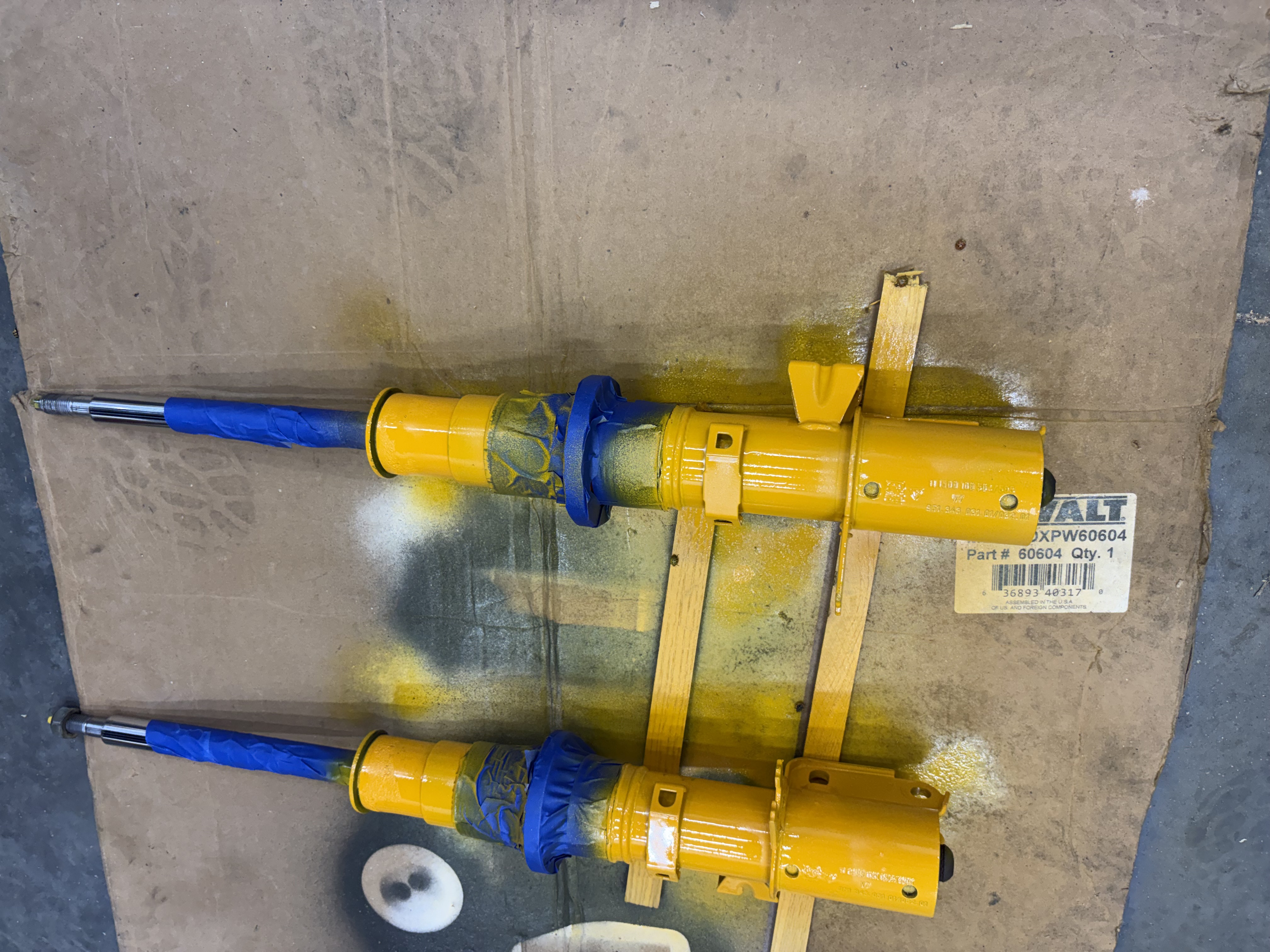

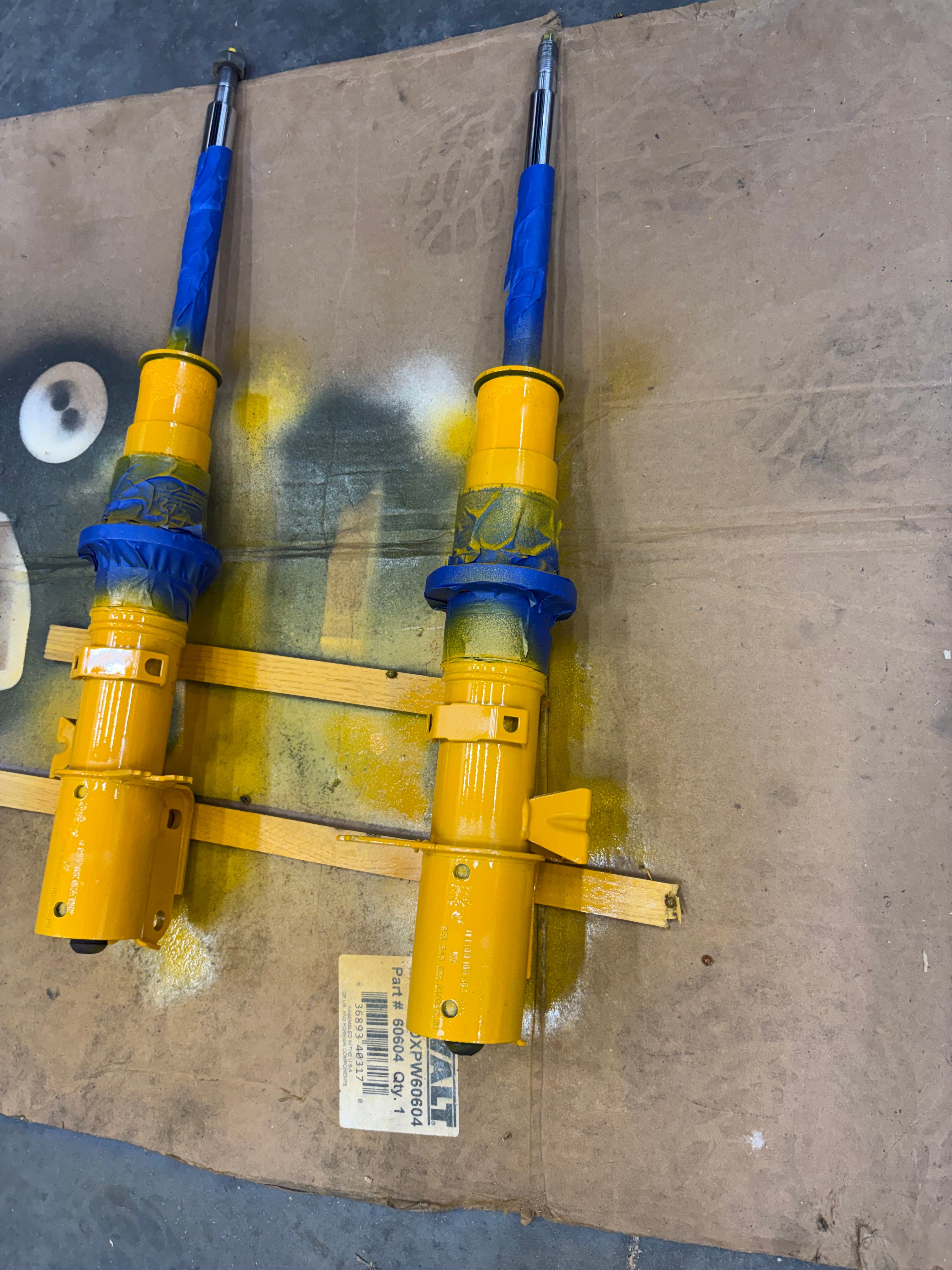

Those look great. I went down the Koni route and added adjustable perches. The picture shows them after cartridge and spring perch install where I am touching up the paint (school bus yellow). I will post more pictures once fully assembled.

zooklm1 wrote: Wed Feb 18, 2026 8:11 am Those look great. I went down the Koni route and added adjustable perches. The picture shows them after cartridge and spring perch install where I am touching up the paint (school bus yellow). I will post more pictures once fully assembled.
I also need to touch up my black. I used cardboard and towel to protect the struts while torquing the retraining nut and on one strut it rubbed off a little. I also plan to clear lacquer them.

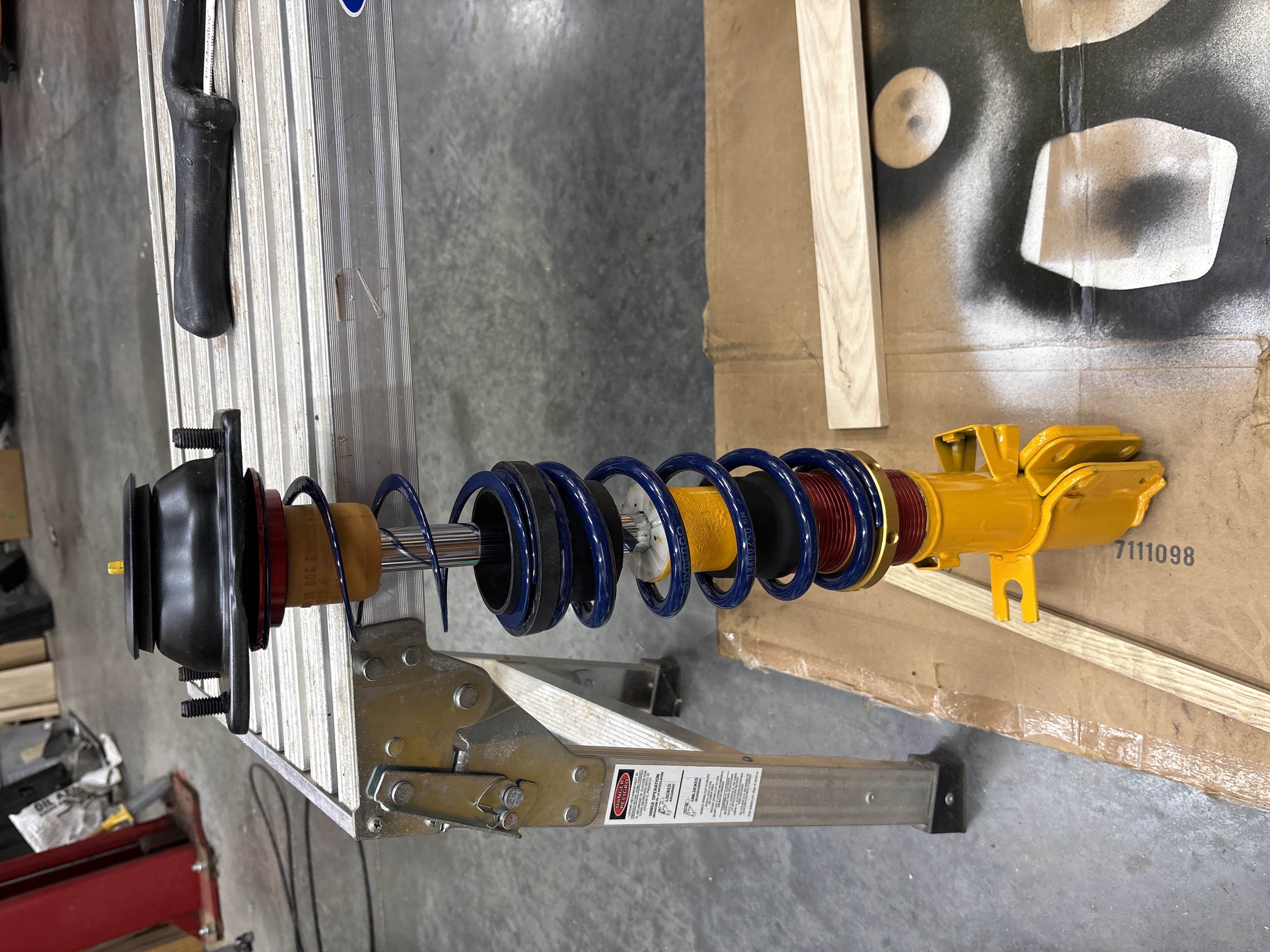

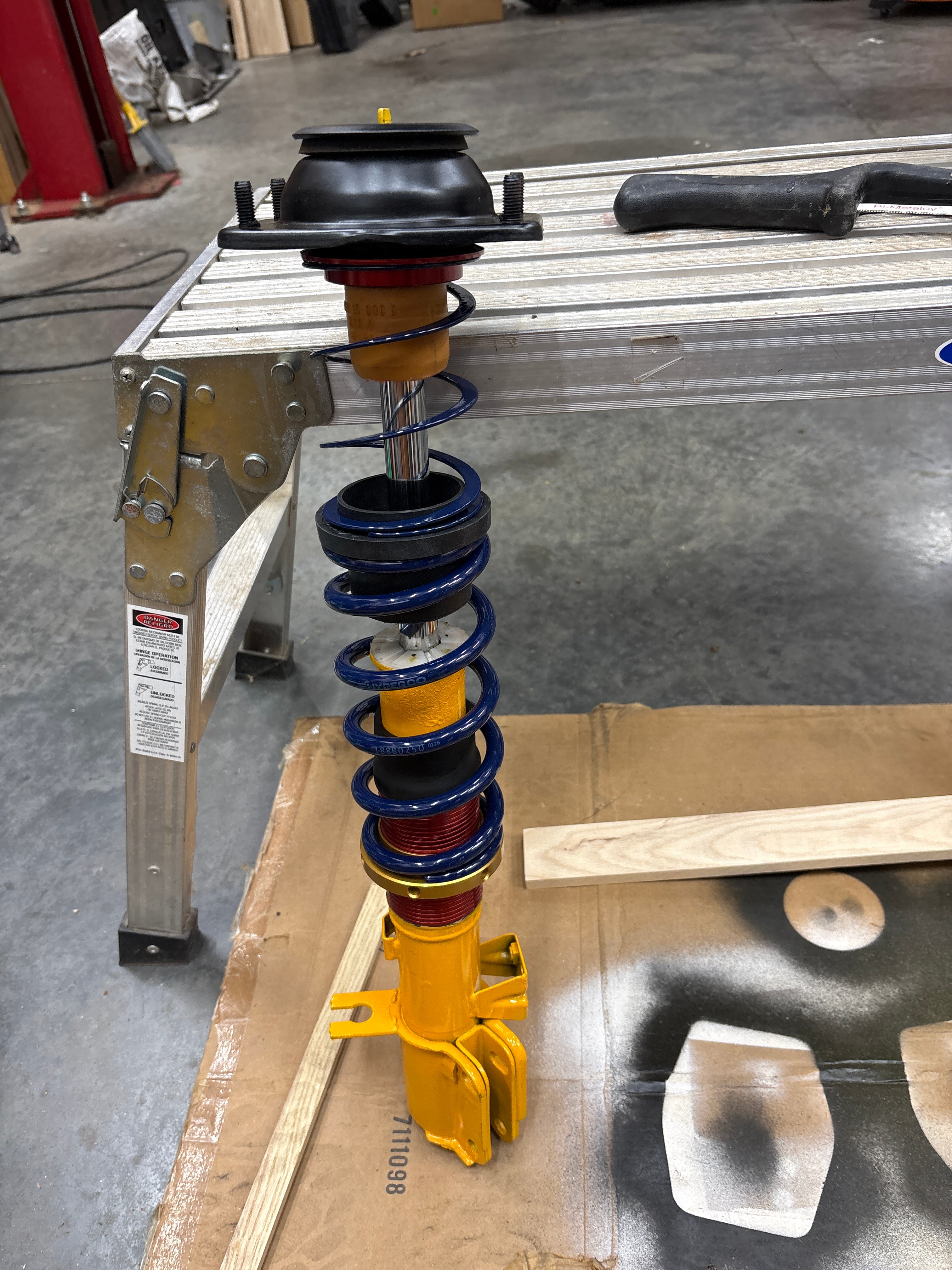

Here is one of my struts assembled but not torqued down.

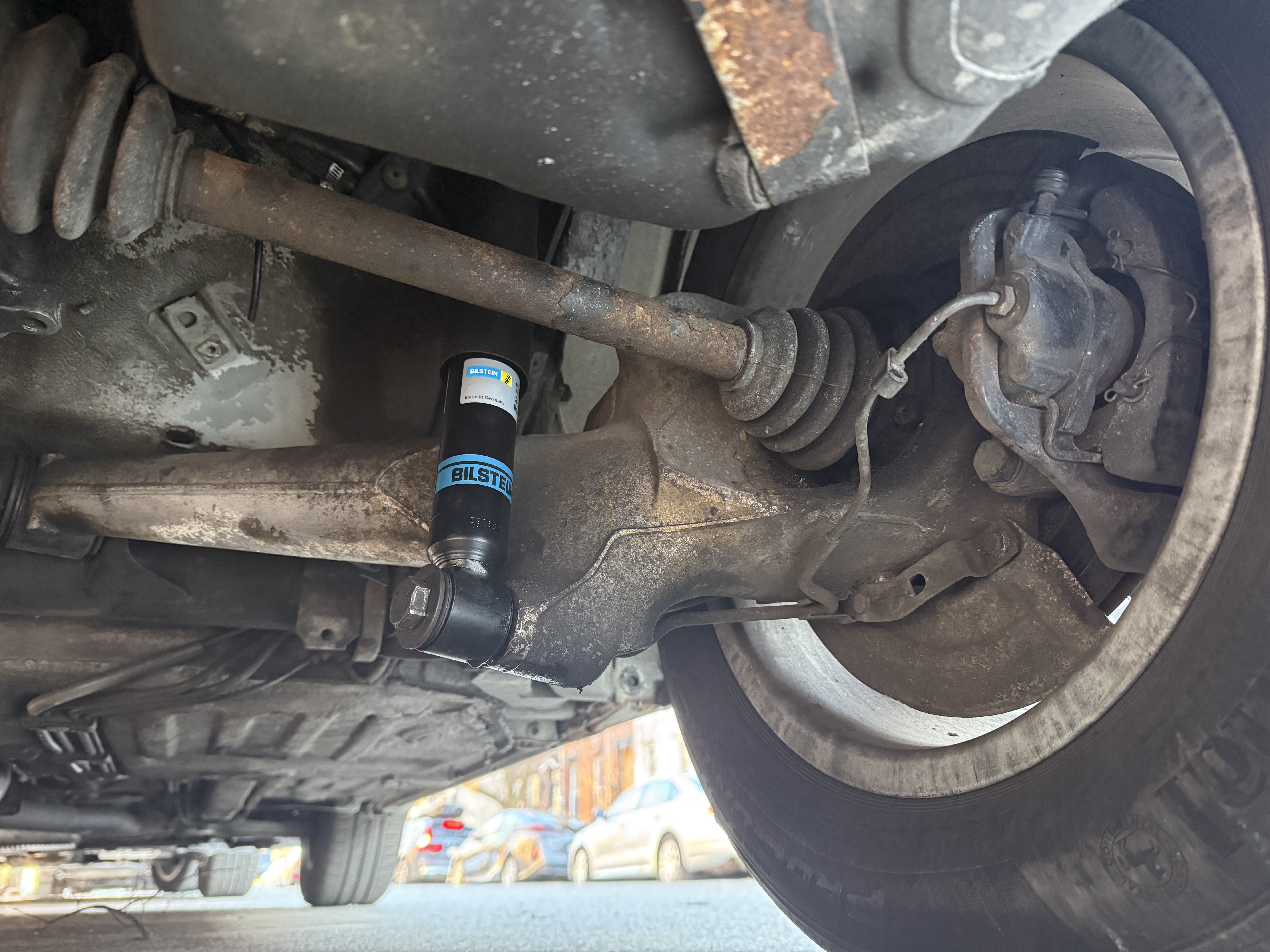

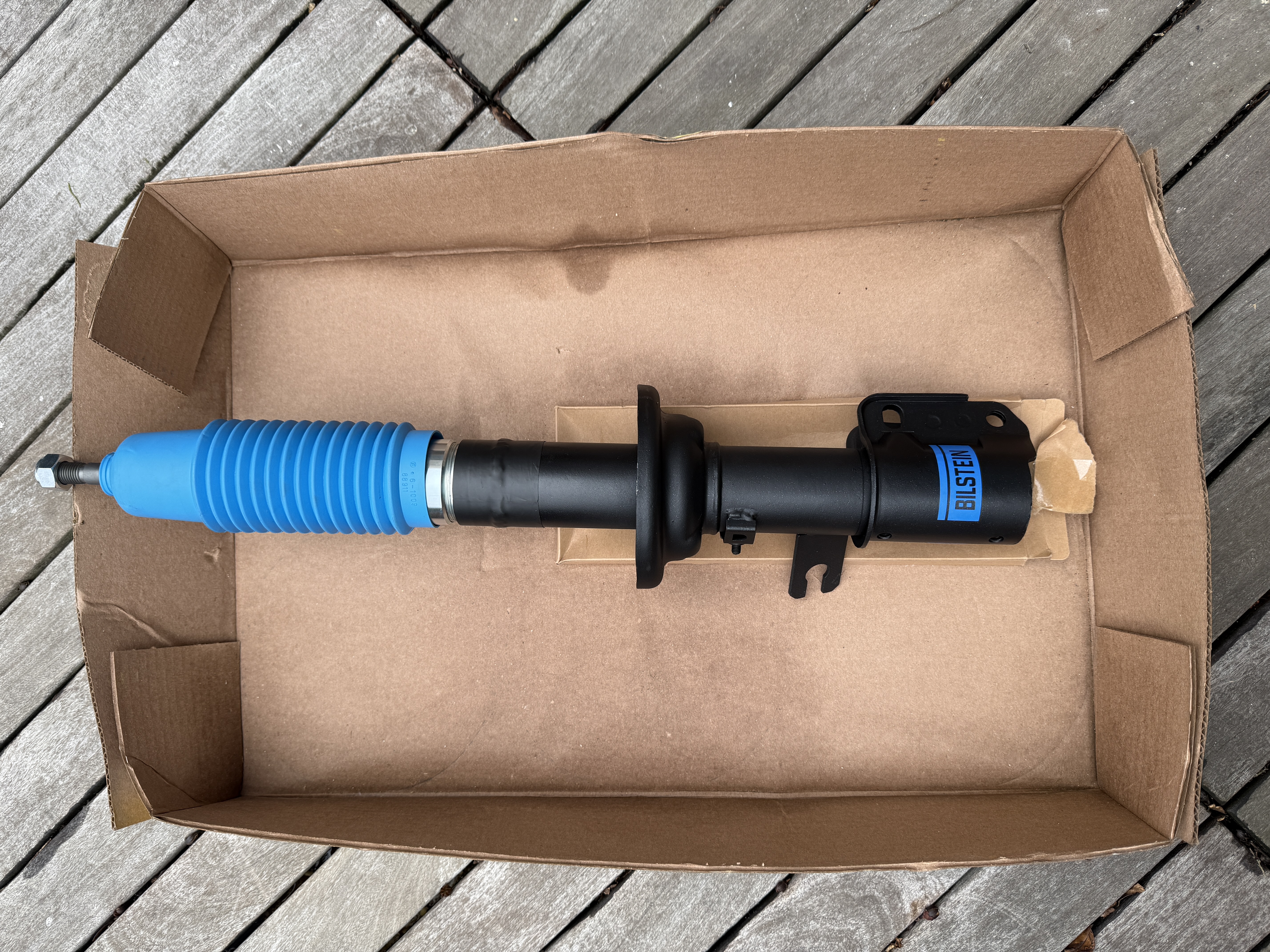

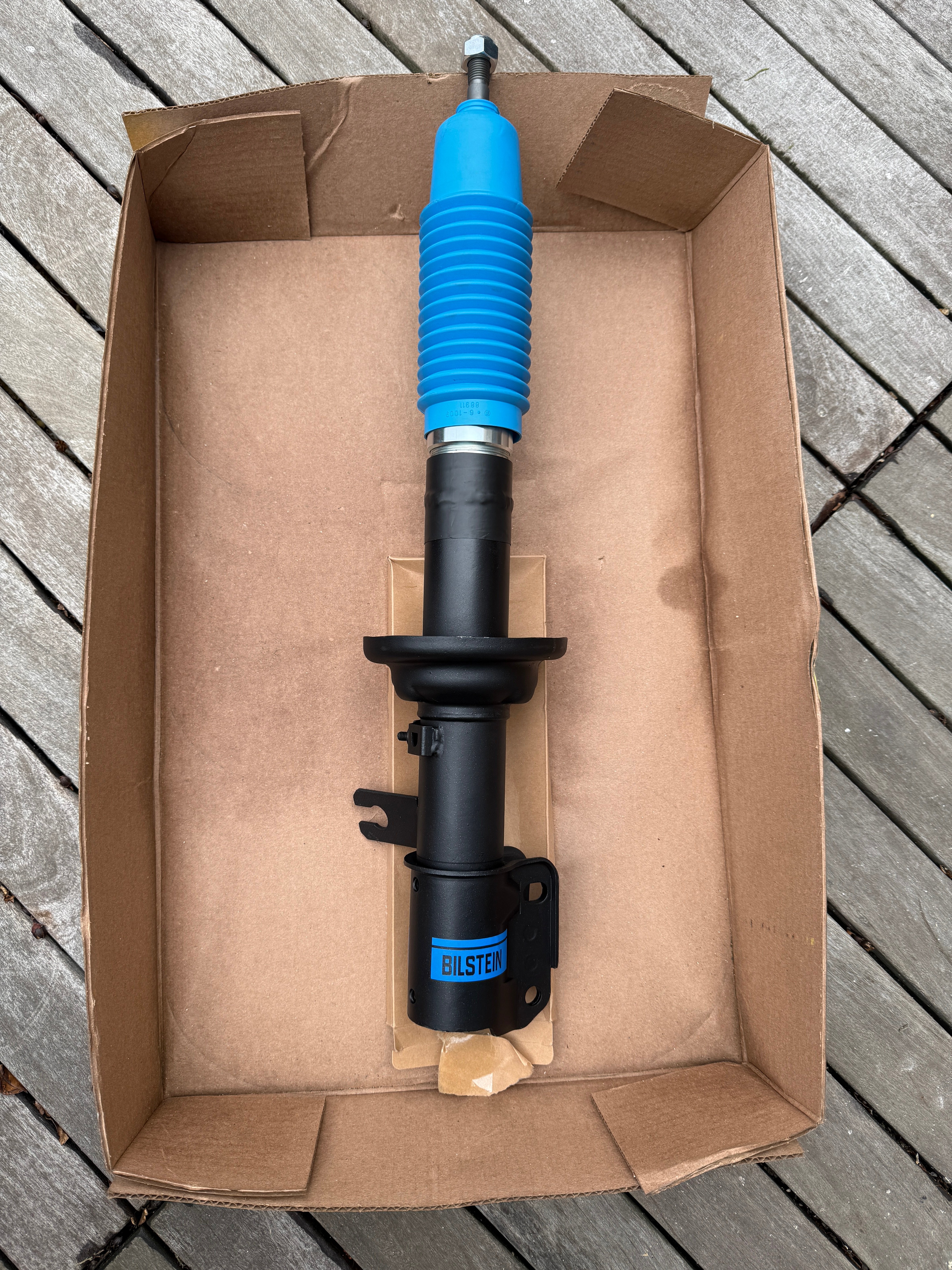

I put the rear Bilsteins in today, from the photos I assumed they were yellow/black, but turns out they match my fronts. Pretty happy I stuck with black and blue decals.
As for the fronts, in the end I decided to go coilover conversion and ordered kits with adjustable camber plates from Ground Control.
