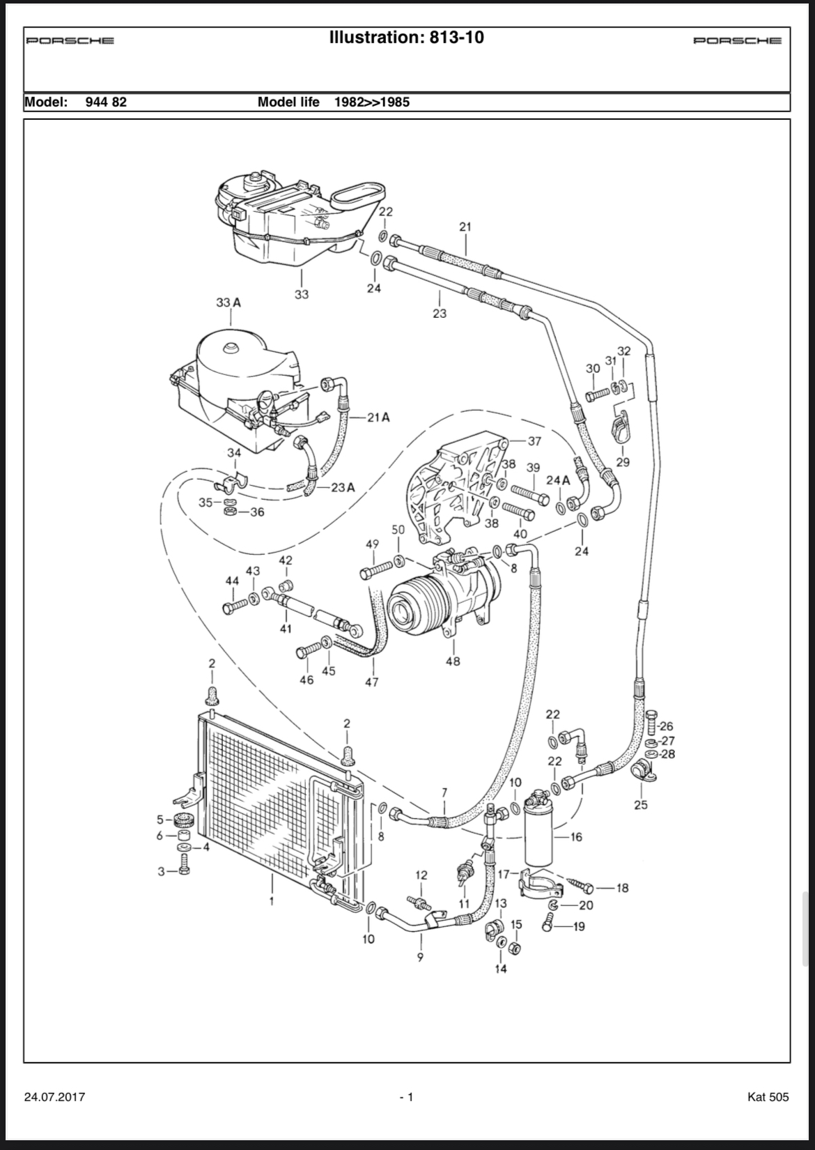

Also, examining my PET diagram I’m seeing 2 units (33 and 33A) that are both referred to as the “air conditioner” and I’m a little confused regarding that. The BOM list doesn’t even show a “33A” part

I forgot you have an early a/c system, but looks like you found the right PET. What year is your car? My comment about the o-rings being hard to get to on the evaporator were based on the later cars. Yours might be easier and worth changing. PET has a lot of translation quirks -- that part 33/33A appears to be the blower/evaporator housing on the early cars -- calling it the 'air conditioner' is probably a translation thing. And it looks like they missed listing the 33A parts, maybe because it was superseded?
Here's what Giffith's says about the hoses: "The original rubber a/c hose lines in your car will leak out R12 through the hose’s lining. R134a has a smaller molecule than R12 so R134a will leak out sooner than R12. So if you car has a large amount of rubber hose, such as a 40 feet with the 911, then you will be re-charging the system often and that is expensive no matter which refrigerant you use. To prevent refrigerant loss you should consider replacing your old hose lines with “barrier” type hose."
I changed the easy ones on my car, but still have some original non-barrier hose left. It's not an all or nothing thing. The less original hose you have, the less seepage (aka, leaks you don't feel like fixing as dr bob points out). And the less seepage, the less often you need to refill the refrigerant.
My car is an ‘83. I’ll dig around to figure out the accessibility of the condenser/evaporator connection points. Since I’m still waiting on the low side fitting I have a couple days to assess what I want to do depending on if and how much the system leaks pulling vacuum today. I will probably proceed without replacing the hoses right now, but if it proves to be a problem I will just end up replacing them.

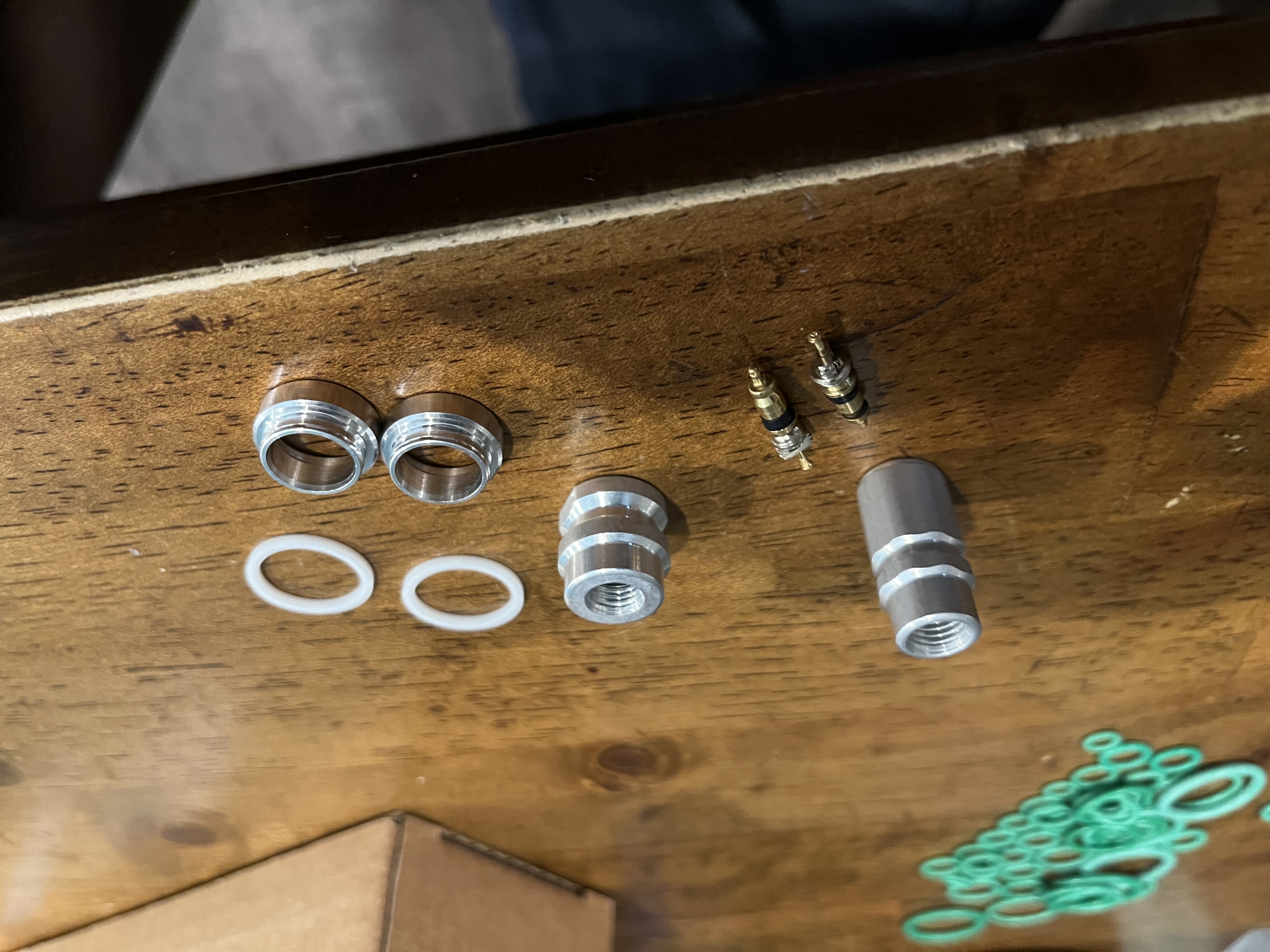

Just received my conversion kit in the mail, and I’m wondering what these silver and white pieces are for on the right?
