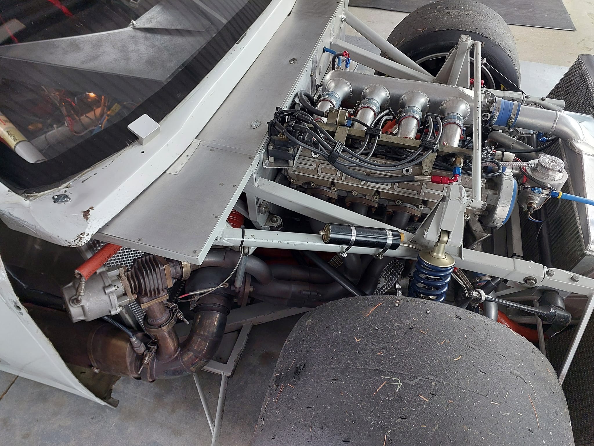

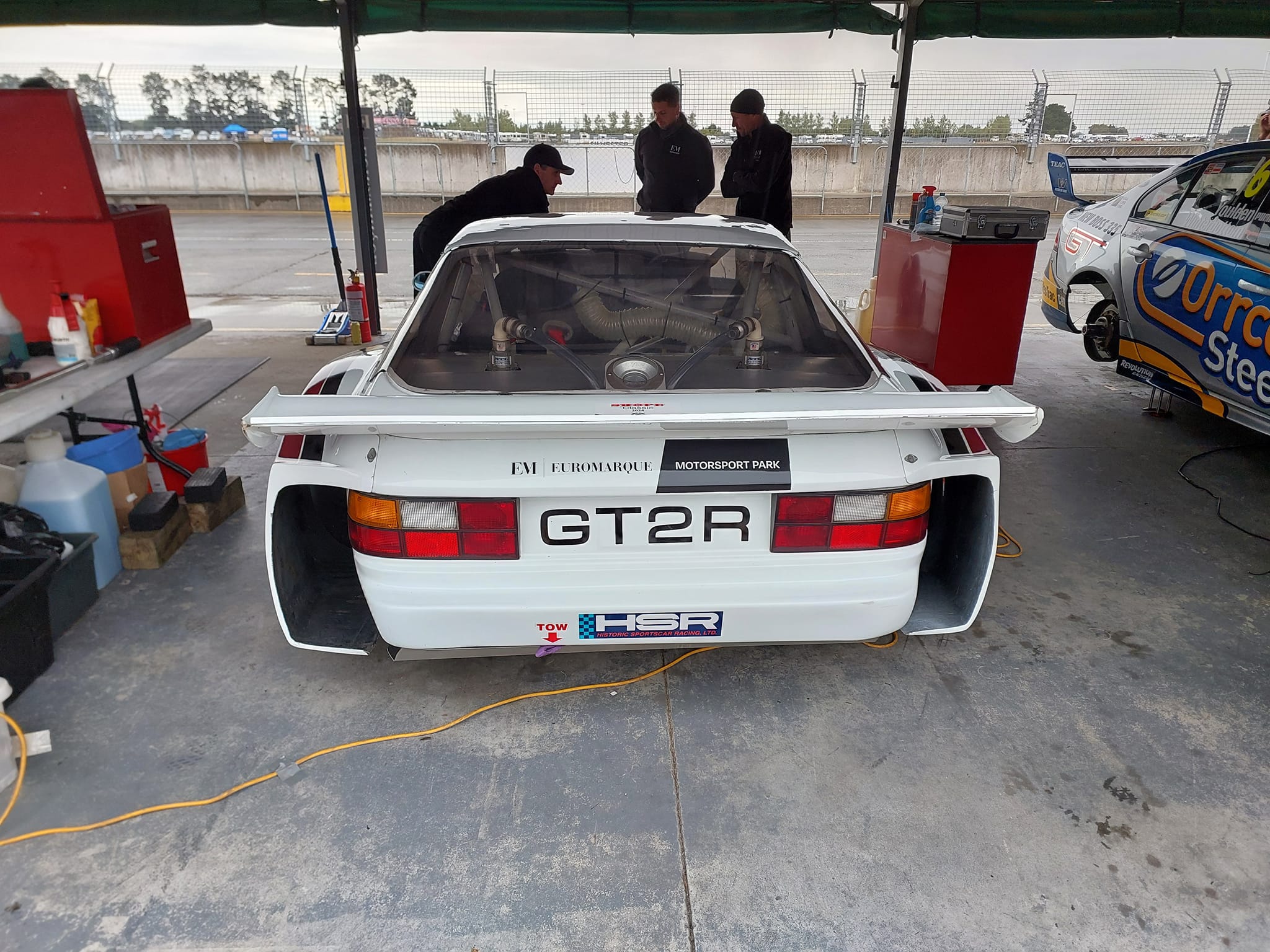

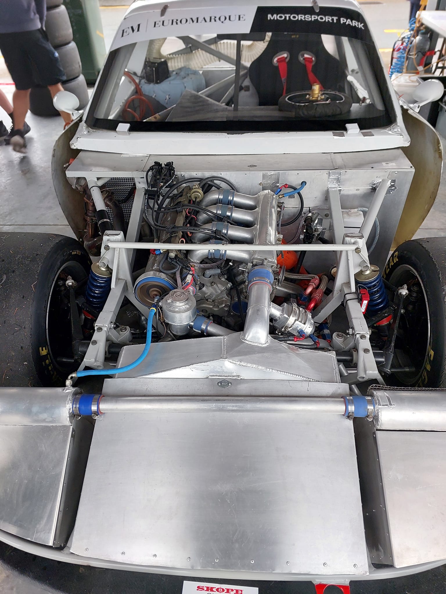

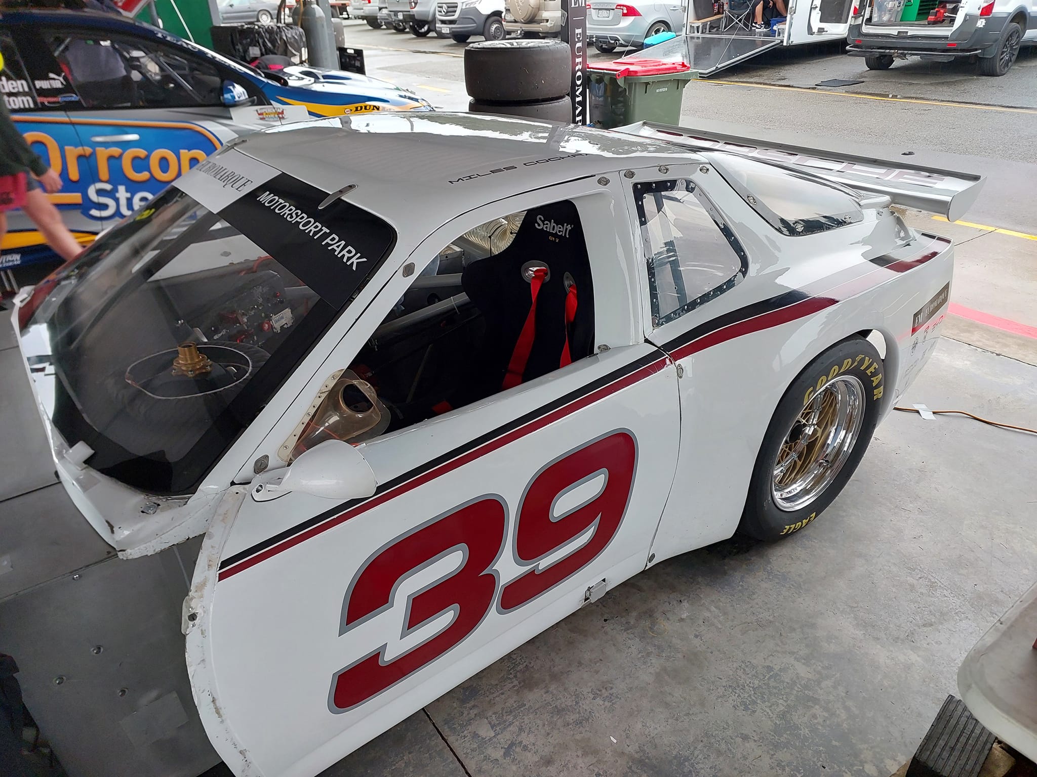

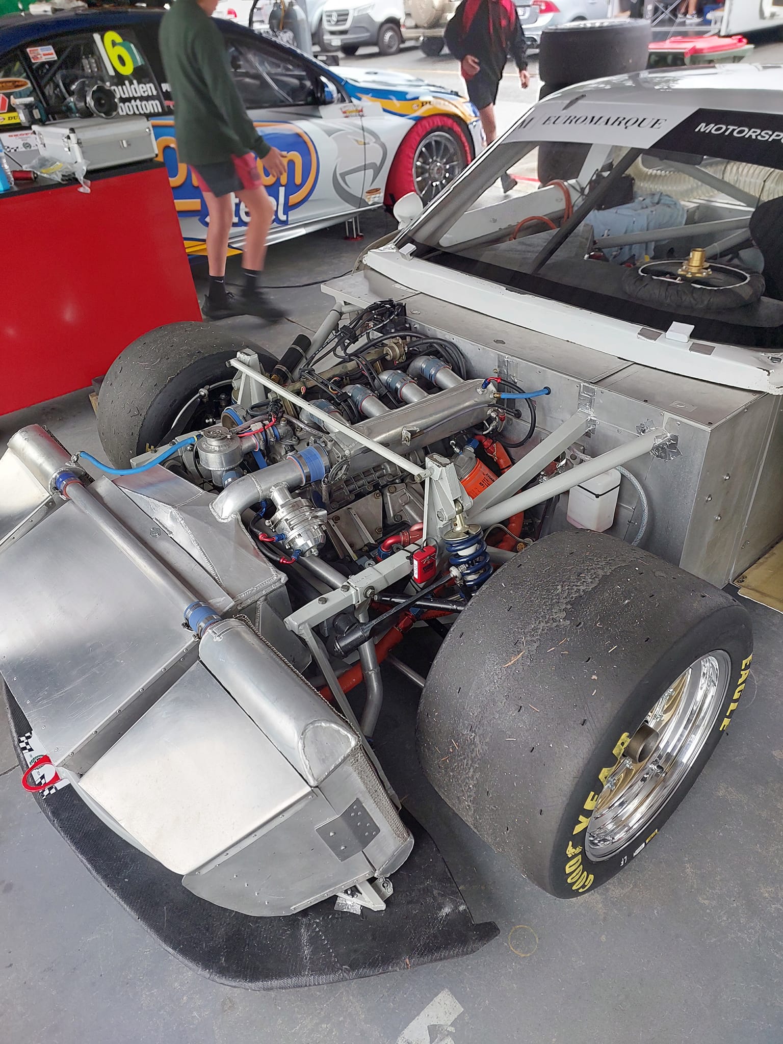

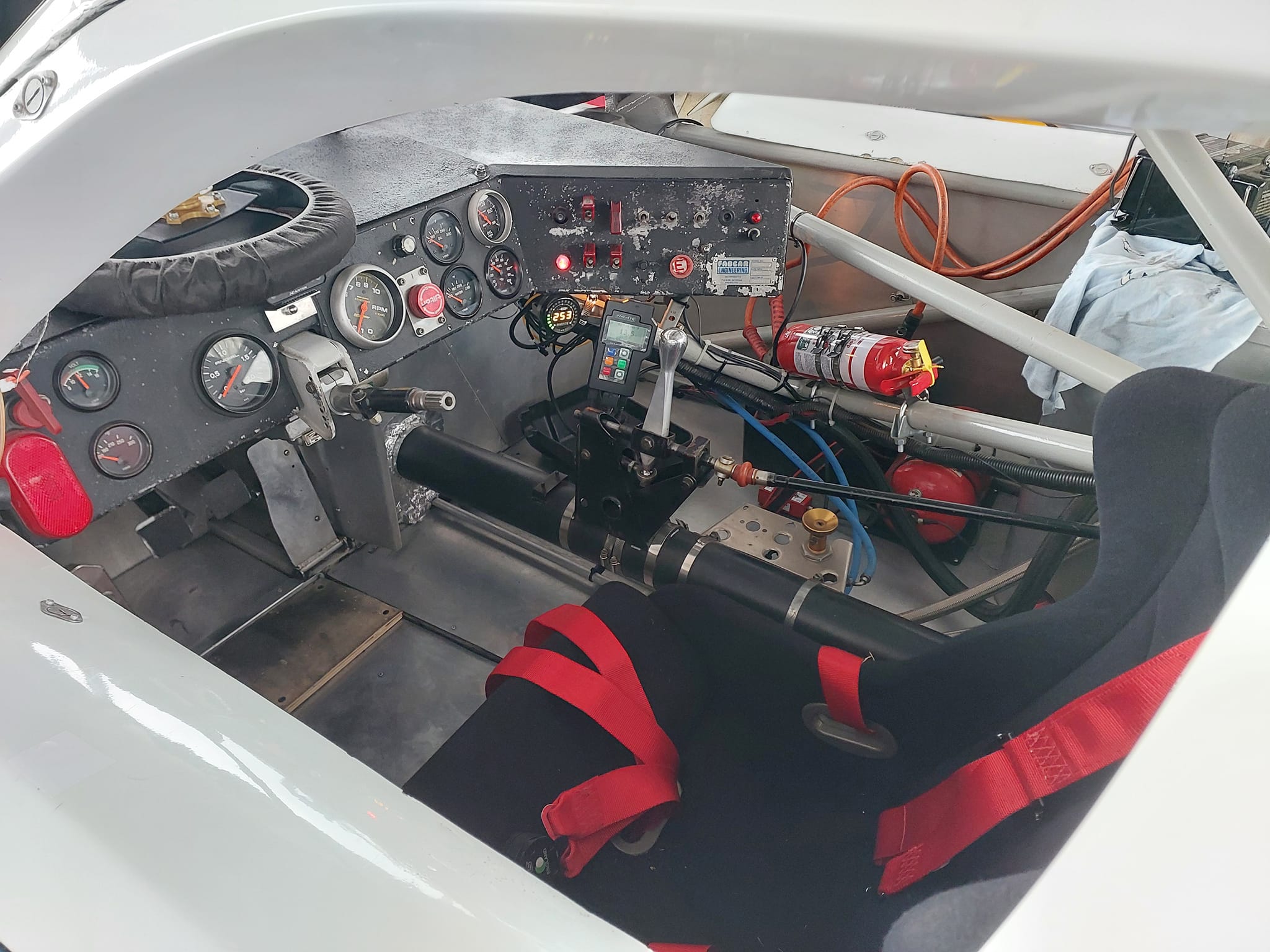

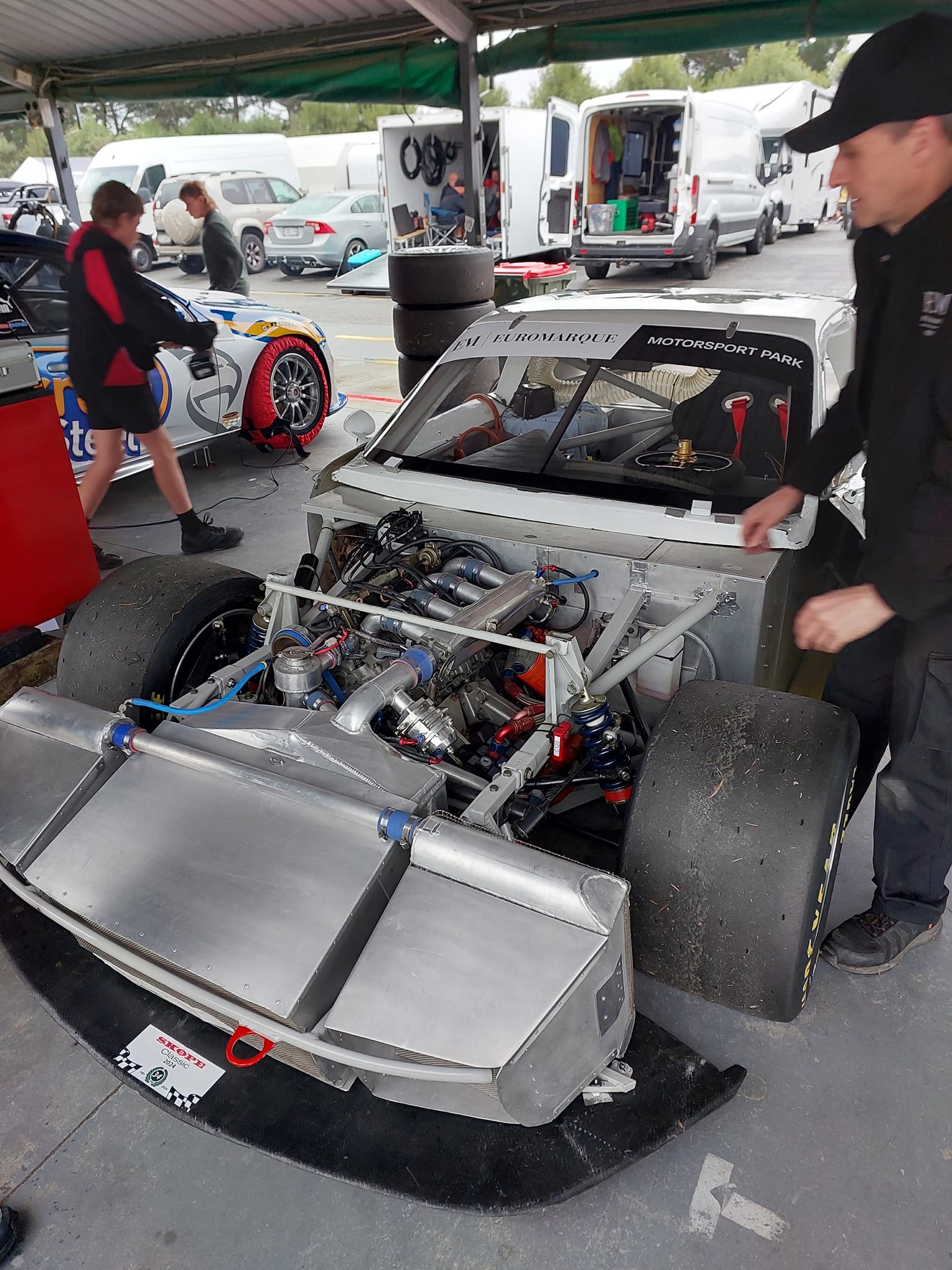

MM, you may recall this car. It has been based here in New Zealand for the last few years. These photos are not mine. These were taken at the 2024 Scope Classic in Christchurch last weekend.
https://www.skope.com/about-skope/skope-classic/
R2
Photo credit R. Hooper

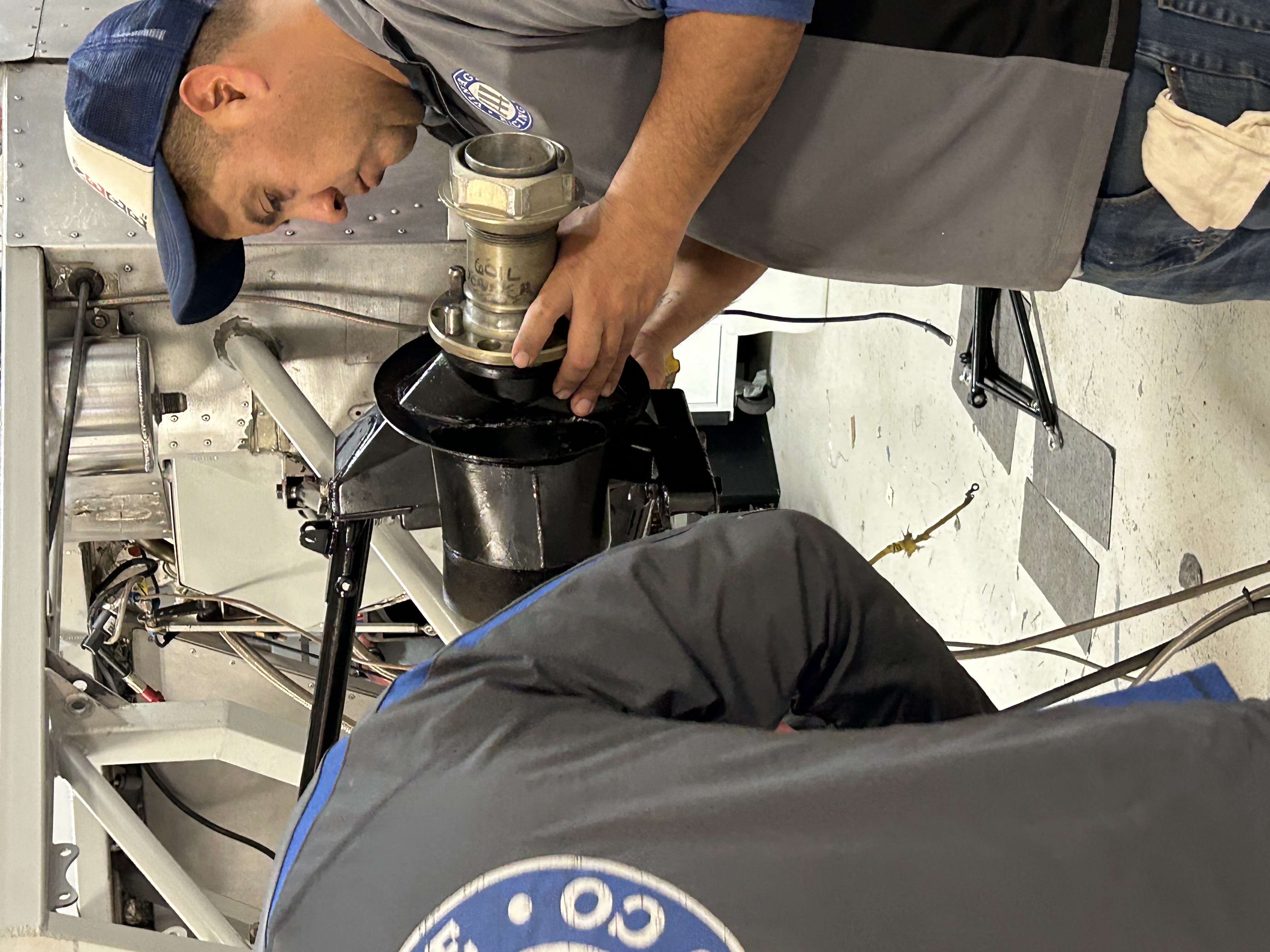

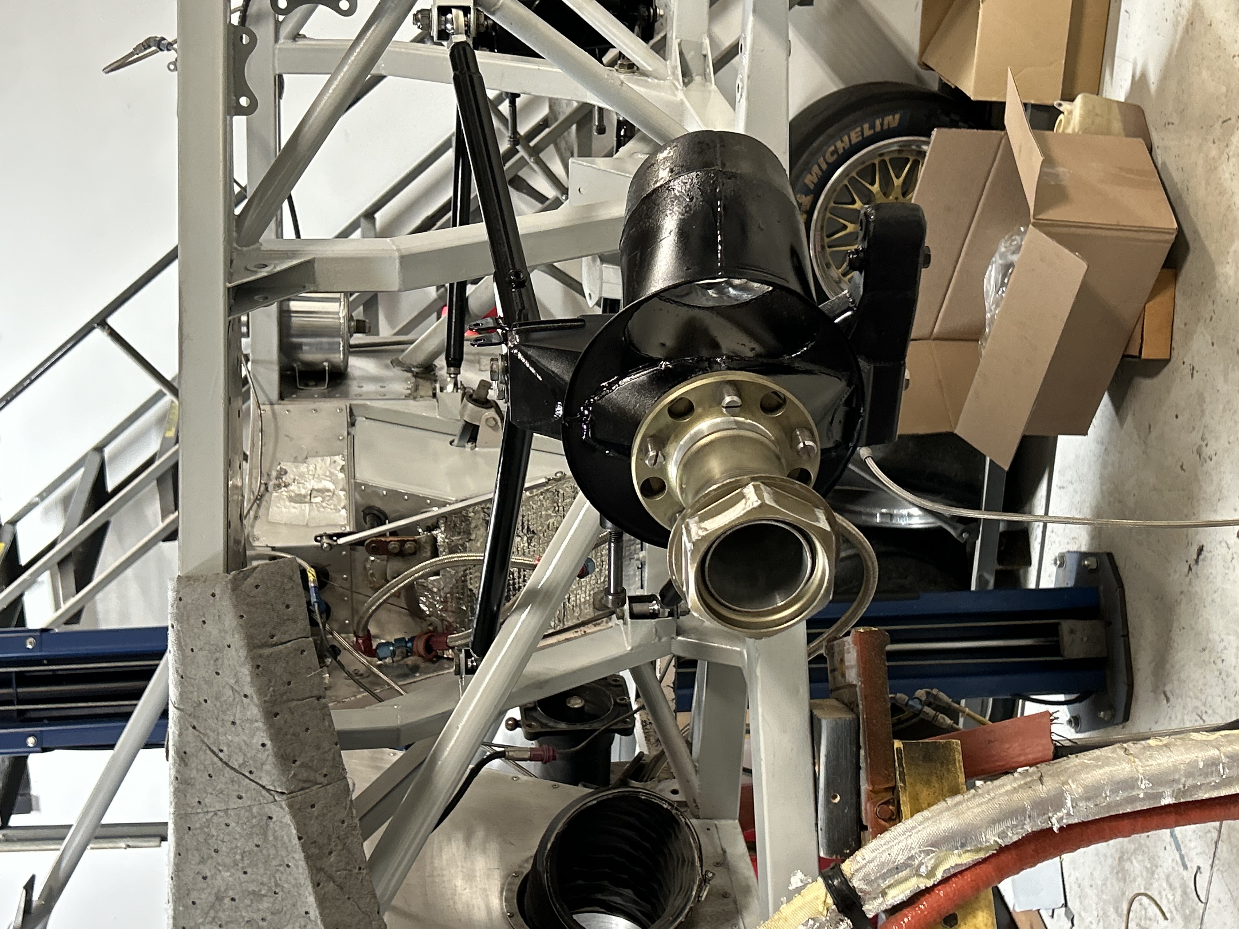

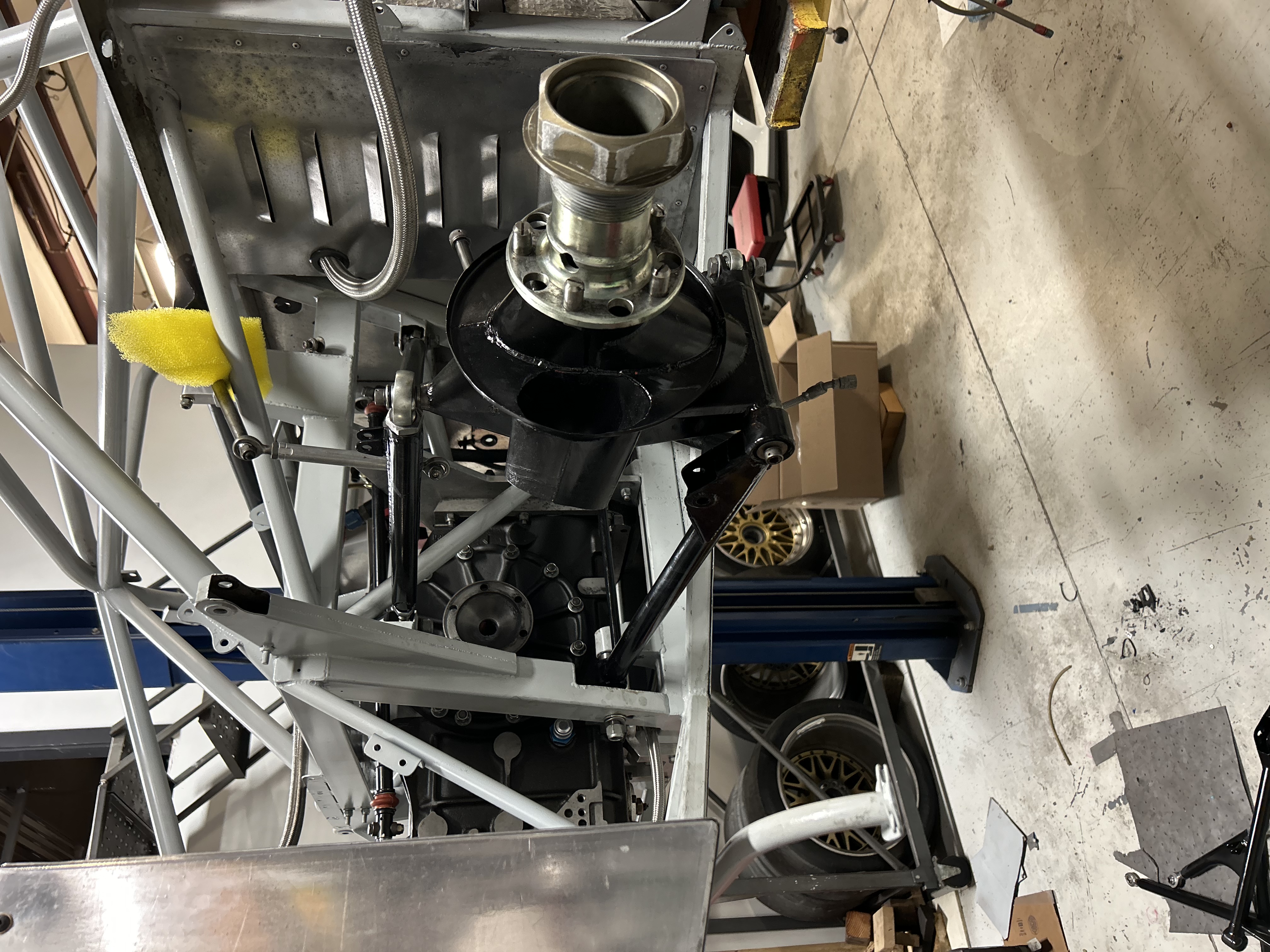

Suspension going back on, but still waiting for Penske to rebuild shocks. Interesting fabricated uprights, eh?
The Hewland trans shifting is all mechanical; no engine cut for shifts. I would always stab the clutch for upshifts, but all that's needed is a quick pause on the throttle and the next gear can be found. The clutch is needed for downshifts. Shifter and linkage by Fabcar are excellent.
That's an interesting GTR in New Zed! I recognize it from my old PCA race days here in the US. The engine is no longer a GTR, but clearly much of the car is. The car belonged to Dick Howe and was prepared by Eric Barrett.

Whoa...nice! So what is the format for that event? Was 'our hero' the fastest car therefore had the biggest delay on the start? Did it win? Scooted past that old Commodore Supercar V8 easily enough.
