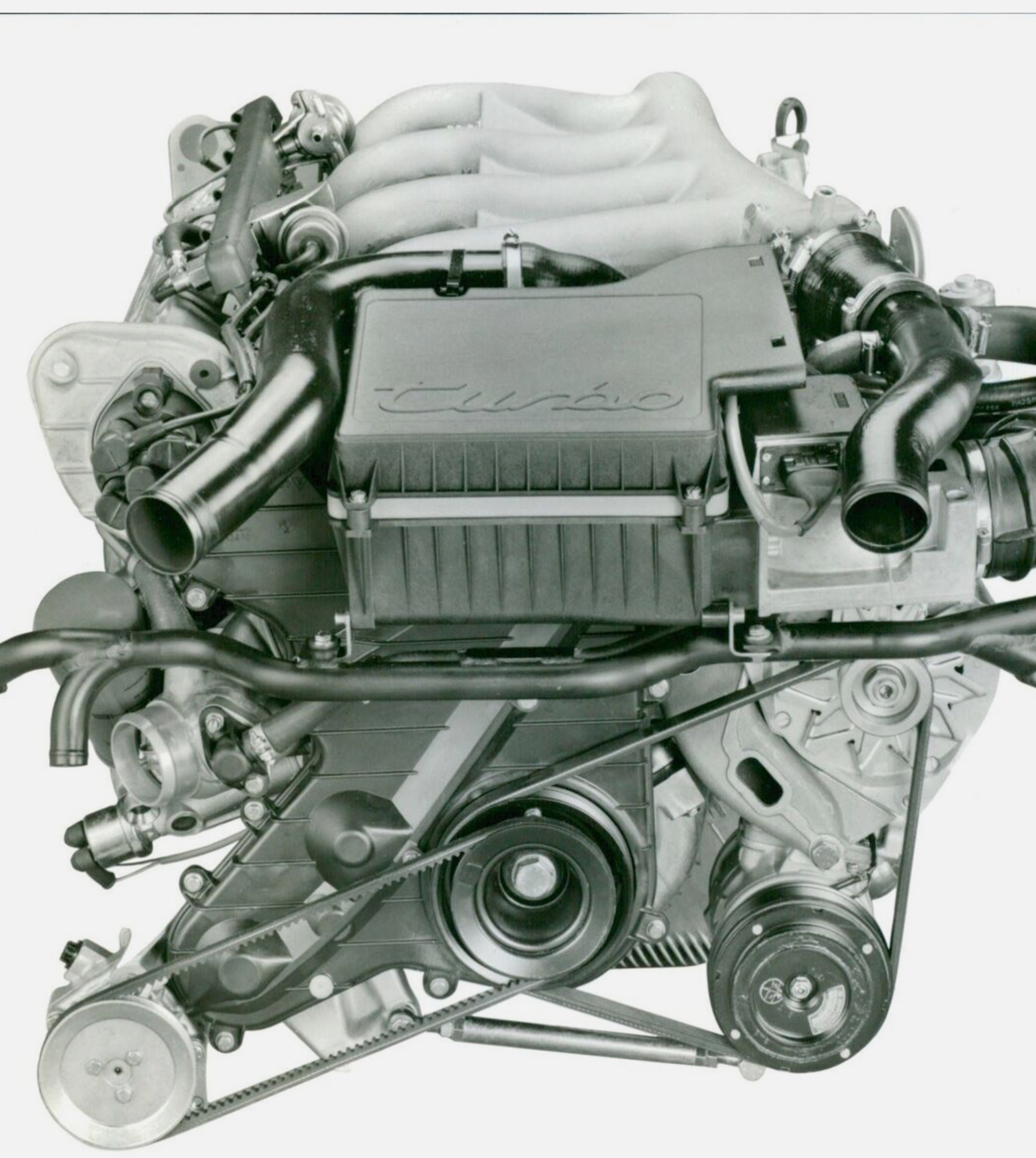

I found this vintage picture, which I believe is from the factory, which would seem to confirm that the brackets go under. Fingers crossed that's the root of your issue!

I don't know if you believe in God but God bless you!!!!! Life savior! Where did you find that picture?

I had actually thought about suggesting that earlier, but it felt like a hack to me-- akin to lengthening the slot with a Dremel -- so that's my bad. And here just when I thought I knew everything. ;) I "think" that picture also shows the slots pointing up, assuming the slotted legs are the longer legs. I also found the picture below in the factory manual, which also shows it below. However, to keep everyone on their toes, it seems to show a different mounting hardware (stud encased in rubber, rather than bolt and nut?) and a hole in the vertical part of the bracket. My strongish guess is that the factory changed the mounting set up after the prototypes and/or super-early '85 cars, resulting in inconsistent factory images and illustrations. I never got into Star Trek trivia or the correct way to pronounce 'nerd' in Klingon (venwI), but I'm weirdly drawn to unearthing Porsche history/originality, etc. :shock: :lol: :shifty:

Thanks!! It's crazy to see what minute details they changed over the model years. The pics also show an allen head bolt, while the PET shows a hex head bolt!
Tomorrow, I'll remove the filter box again and put the brackets under the tabs. And then, hopefully I can readjust my cone lock pin and have a nicely closed hood.

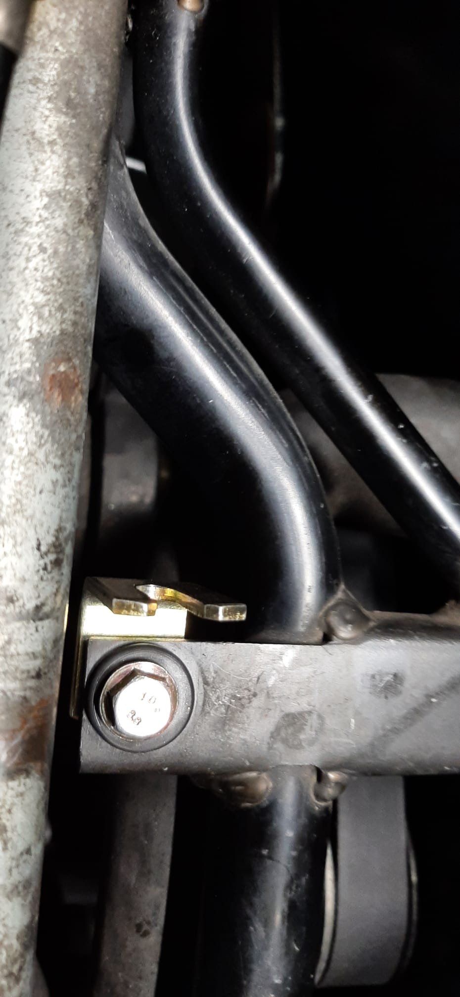

Ok, I just finished getting the filter box out and in again. I put the L profiles with the open slot up, but the tab itself on the underside of the rubber grommet.
So it looks like this: 10 mm hexagon bolt, washer, rubber grommet with metal insert, L profile, washer, 10 mm nut.

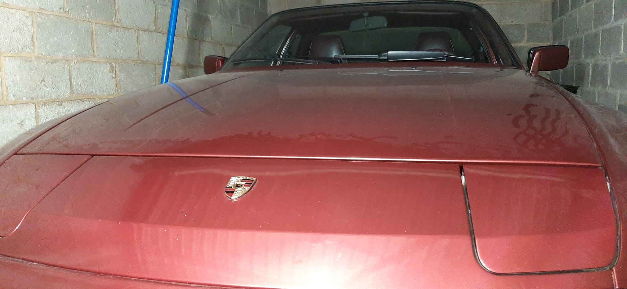

After readjusting the cone lock pin to - probably - where it was before I adjusted it the last time, the hood now closes perfectly! :thumbup:
@whalenlg I think it does make a bit of a difference, my AFM was almost hitting the cross pipe, but was still hovering a bit, so this eliminated the 'hover'.
Thanks everyone! I'll post the full write-up for an air filter box installation on my site 951werks, with credits to you of course!
